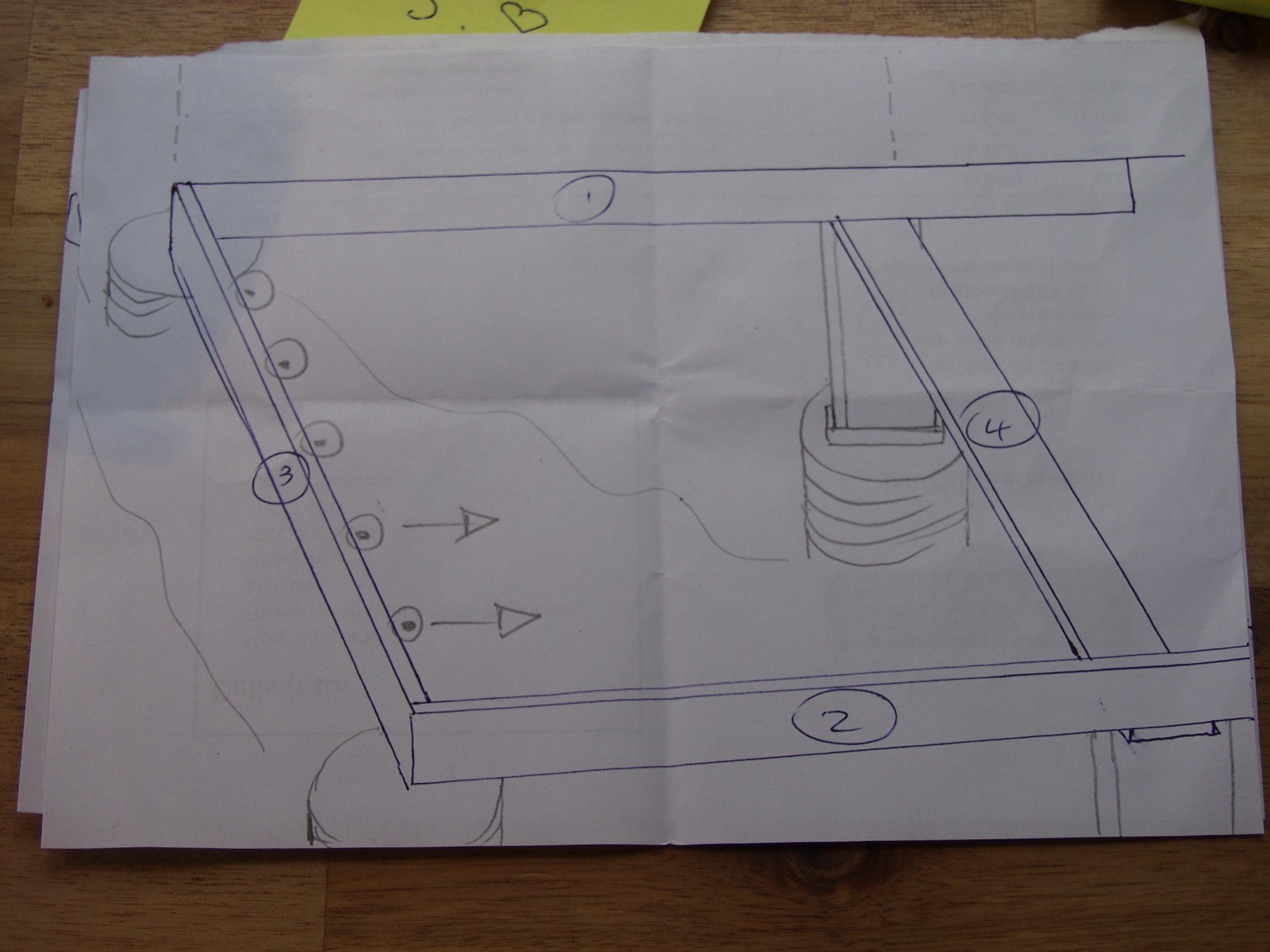

christ I'll get nothing done then. Onoff that's very honest!! Now look back on track: I've got my plan & will see what "tannalised" timber Jewsons have/ what lengths. Spoke to my chap & mentioned 6x2 advised (on here) for outer beams: he said 'mmm maybe double them up, gotta account for +snow load etc'. Because I've gone for only 4x support pillars (not 8x as would be if 3x pillars along each wall/ orig idea), I need to make sure the four load-bearing perimeter beams are perhaps OTT engineered a bit, like my plinfs are. So with this in mind is the way to go doubling-up of 6x2's, or am I better going a bigger guage for my four perimeter beams?

Hi PeterW- so you'd go joists from beams no.1 to no.2 instead you mean?
This is the idea my chap sketched. This is the base four beams (my shed perimeter walls ontop of these). No.4 is lying flat: ontop of this he suggested joists running from beam no.3 > across beam no.4...... & onward a bit too (as much as I can, for a walky bit this extra bit). The joists [not yet shown] will go in & attatch most critically via joist hangers @ beam 3 (where my series of 'o' zits & '>' arrows are), & to the flat beam no.4. 2x 85cm H full sleeper thickness, for ontop of lower 2x plinths & up. 85cm is the difference in height between lower two plinfs & upper two. Thing is I can't see what beam I can my that's ~3.4m long. The hardwood ones are 2.4m long.

My pro chap outlined a basic plan for the base- wonder what you think: 2x full sleeper uprights for lower plinths H ~85cm. A beam(A) to lie flat on the upper 2x plinths (parallel to stream) joining these two. Obvuiously resin-bolted steel bracketed to my plinfs. Then a series of joists across (perpendicular & fixed by alu metal hangers to beam(A), @ 400mm centres (IE celotex between).. to rest upon/ fix to another beam(B) joining the sleeper uprights, & joists continue on over twds the stream by 20% (a common figure in his work for cantilevered overhang/ anyway whatever's max I can go for an added side walky bit). Noggins too? Lastly: 2x added 45* inside brace timbers @ the sleeper pillars > beam above, for added rigidity/ to help prevent racking. ----------------------------------------------------------------------------------------------------- That's his basic suggested plan, kindly & quickly sketched in 5mins after our hard work. Thinking on whatever base I go with, the main thing of concern to me is the wind channels down the gdn & hits my 'shed' front on, hard: like my extention it'll whack the end of, often at 90*. So alot of pressure will be put on my 'lower side', my 2 sleeper uprights will want to domino one another -backwards- I assume.. if say a storm puts wind at max.
