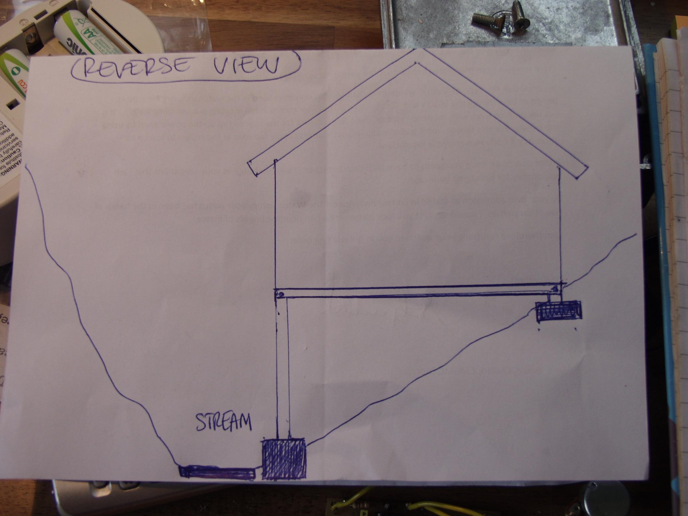

  1. Ok there's confusion I understand now. No Id never planned to access the overhang from inside, only from another front deck. It was always a side walky area addition, my pro chap's idea. I've given a huge ammount of thought on how to construct it, you've seen this. But its only just dawned on me that once I made a separate front deck area, this would need to go right out sideways, in order to meet this overhang area, to be able to walk from the front deck onto it. Tricky. This is why I'm now thinking put the overhang -frontwards orientated- instead/ forgetting the side walky area.. altho it would be useful addition.
  2. As a reminder. This is my front-door-view.. looking back up to house (very long to house, but narrow L to R). My property is a cigarrette. My house is the butt. Once lit @ the other end is my cabin, its side 2m to stream centre. It's other side 5m to road above, ground goes up steeply here. The stream runs all along one long side, 50m. Gdn narrows at cabin end, plus, the damn slope also steepens too widthways down to stream. N'bors across stream. High bank other side of stream. You can see here my front plinth. Between the white bag & rickety post = my door here. To the RHS of bag is my upper plinth (not yet done here). I'm standing midpoint of cabin with camera. If I step off my deck here, at its LH edge, there's a 1.5m drop. If I step off my deck RH edge twds mixer.. I take one step down onto ground.

  6. @De Hi Declan- bingo that's it.. even window's correct LHS (stream is opposite, RHS, & n'bors too). Very grateful for that. Ok this green front area is what I'm considering at the mo: I'm obviously gonna need a deck here. I have 3 options afaict. 1) Swizzle the cantilever area round to the frontside forming my front deck/ not sticky-outy out RHS. 2) Keep cantilevered walky bit as planned (on RHS, orig idea).. & build a separate front deck later. 3) Ditch the cantilever altogether, make a 2.3m square base.. & build separate front deck later.

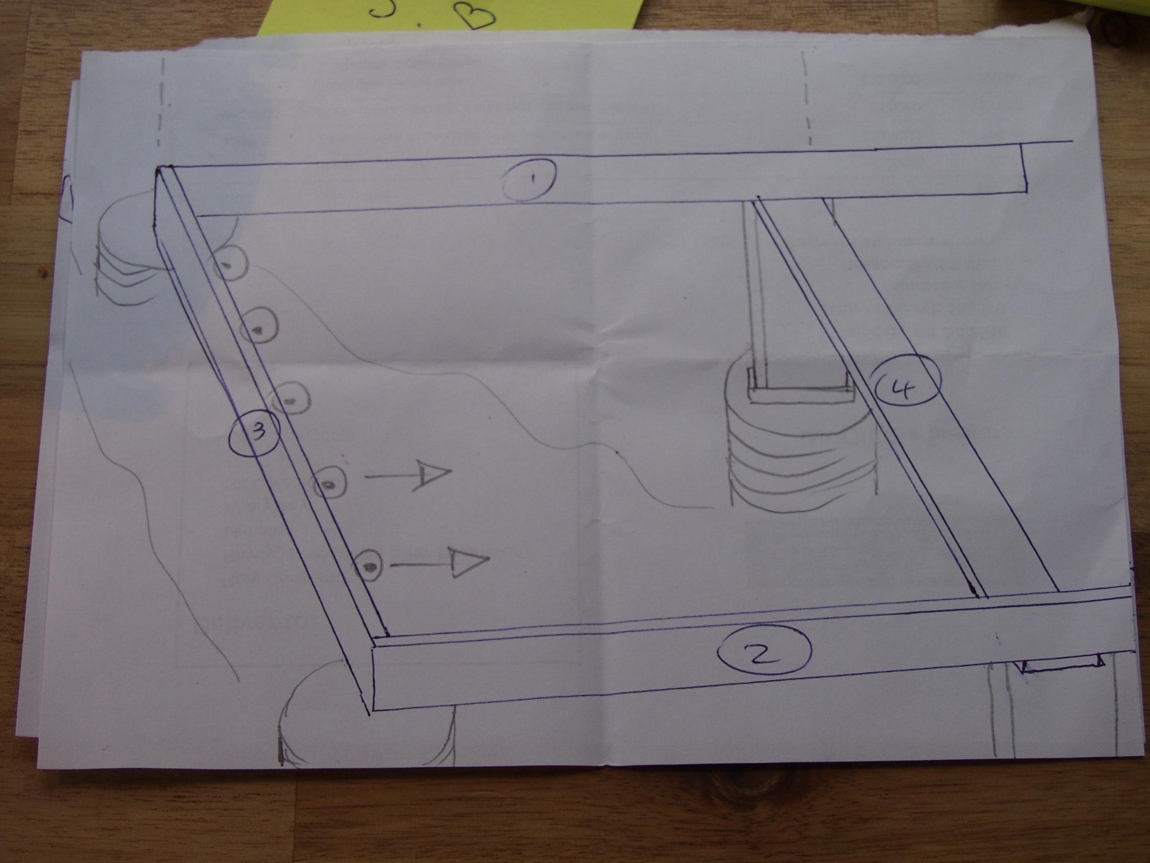

  9. Hi chaps- took wknd away/ just seen replies. Sorry for confusion. I add my sketch again. Beam numbers 1,2,3,4. The idea has been the cantilevered +20% or so walky area to be added RHS @ lower two pillars' side. This was/ & always will be the RHS -side- of cabin, next to & parallel to stream below. But the front of cabin, door etc(facing down gdn to house) then has no terrace/ balcony. As I'll obviously need a front terrace area (I cant just step out of door ~4ft splat) should the added walky cantilevered section instead go on the FRONT I'm wondering now? (IE extending beams 3 & 4 forwards, instead of extending beams 1 & 2 twds rhs as per the orig sketch below). Beam 2 is always the cabin FRONT. Beam 4 is always the cabin RHS. In the orig sketch below I have a drop outside my door (where my '2' is scribbled) onto the 45* slope.
  10. @Onoff ok understand the splash up.. but you see I'm high as it is (cabin front will be way off ground) so need this packing as minimal as possible: even if I wrapped the cnr beam join are with dpm or something. No the stream side you see is definitely the cabin's RHS side: over stream here is n'bors (only yds away) & dark with no view. Front as originally intended will 1) be facing down long thin gdn to main house/ symmetry etc, 2) view, & 3) most importantly: its facing south.
  11. HiFerdinand- but the idea of going OTT heavy duty on the footings, is to prevent any movement so as not ever to need jacking up. Id not factored this in. What this does give me as in idea thogh, is to use 2 of those black placcy cabin base 'shoe' things to just lift these two beams off my plinths upper-side. But I need to fix the beam > to shoe > then shoe to the concrete. I must have a very strong join here too: the cabin is a typical design with a front overhang/ extended roof -exactly- where you'd not want to regarding weather/ wind hitting it front-on, & horizontally too.
  12. Hi Onoff- how supercool is that!! man it even goes upside down. Major thanks for that. I get the idea- I'll go with the nothched 6x6's, & doubling up 6x2's (for all four cabin perimeter walls though?), & understand the brick: I'd prefer to get this to something 2cm H though: water would never be standing on the plinthfs @ only 2ft dia & no lip.. it just can't pool here, it'll pour off before 0.5cm surely even in monsoon. The cantilevered area: my pro chap says 20% safe rule of thumb (his work/ he knows etc). In which case 60cm. But the side roof eaves would be diggin in your ears/ face.. so I'd need 1m min on the cabin side/ next to stream side. Mmm. So now I'm thinking its surely more sensible to put this overhang -forward- at the door end instead, as I'll have to have a decky-area here (& steps of somesort up too). Its then either a Q of going with the cantilevered idea for this front-deck area, stretching it to 1.5m & supporting the front 2 corner points with 4" pillars (just a guess).. or.. construct a front-deck afterwards as a stand-alone thing. One odd result of either going with or without the orig side walky-bit.. is the front of cabin will be quite a height off slope in front, which needs to be all or mostly 'hidden', obviously by a series of steps up to front &/ or front-decky thing.

  17. @Onoff very cool indeed! I will be telling people its computer designed. Am I allowed to go your 2nd plan, but a different upper side: no BLUE sleeper under here, the outer beams lying on the plinths instead? If I go 8x2's then adding a "GREY cap" on this top end, would be one of my 4 cabin wall-loads-onto it. If so, the whole shebang drops down 5". As PeterW mentions water sitting on plinths & in contact with beams in this idea tho.. is there anything I could put between? If I go as per your 2nd plan, with big 8x2's I'm a full 7" higher than I'd anticipated: already it'll be fairly high off the ground (floor approx 60cm off the ground in front of the door). I think another 7" height & it'll look weird & perched up, & be tricky to hide its underneath area. Ideally I should have put the upper plinths set down 5".. but I was nervous to with the back plinth, in case steep earth bank above it misbehaved. Thanks- zoot

  22. Ok my plan wasn't to put horizontal sleepers. In my sketch (my pro chap's rough idea) the perimeter beams rest on/ attatch to the upper plinths. I'm not saying this is correct & you're not, but just want your thoughts on it. You see if I put a sleeper in between, the whole structure is an extra 5" high for one thing (Im already high as it is) & is it needed I wonder?
  23. @Onoff ok many thanks. I was just wondering if you could rotate the sketch round that's all. Then you see I can ID which beam 1,2,3,4 from my sketch. Its a p'easy project for you- but its far from simple for me having never fixed a joist or a sleeper you see. I need to go back a step: is my sleeper the right one for the job? the brown 10x5 type I put a photo of, softwood afaict.
  24. @Onoff its tricky to visualise as your orientation is opposite to my sketch which is in my head & I can only go by or my head explodes trying to work this out. Your high plinths are on the RHS (mine on the LHS). If we swizzle your sketch round, the joists are as I originally had too.. its suggested by Declan & PeterW to put the joists perpendicular running (front to back as we look at the image, not across left to right). Your thoughts on this appreciated.
  25. @Onoff I like the sketch- thanks. Actually for the top two plinths I don't need upright pillars. The frame will sit on the plinths instead here. This means less wood to use (+ I'm saving going so high too: already the cabin will be perched 'up' a good 1ft). My sketch pg before shows this basic idea, but its suggested just changing the joists 90*/ not doing the 'cantilever' then RHS (bc chaps here said it'll save wood/ preferable, & I can sure up the walky sticky outy bit).
