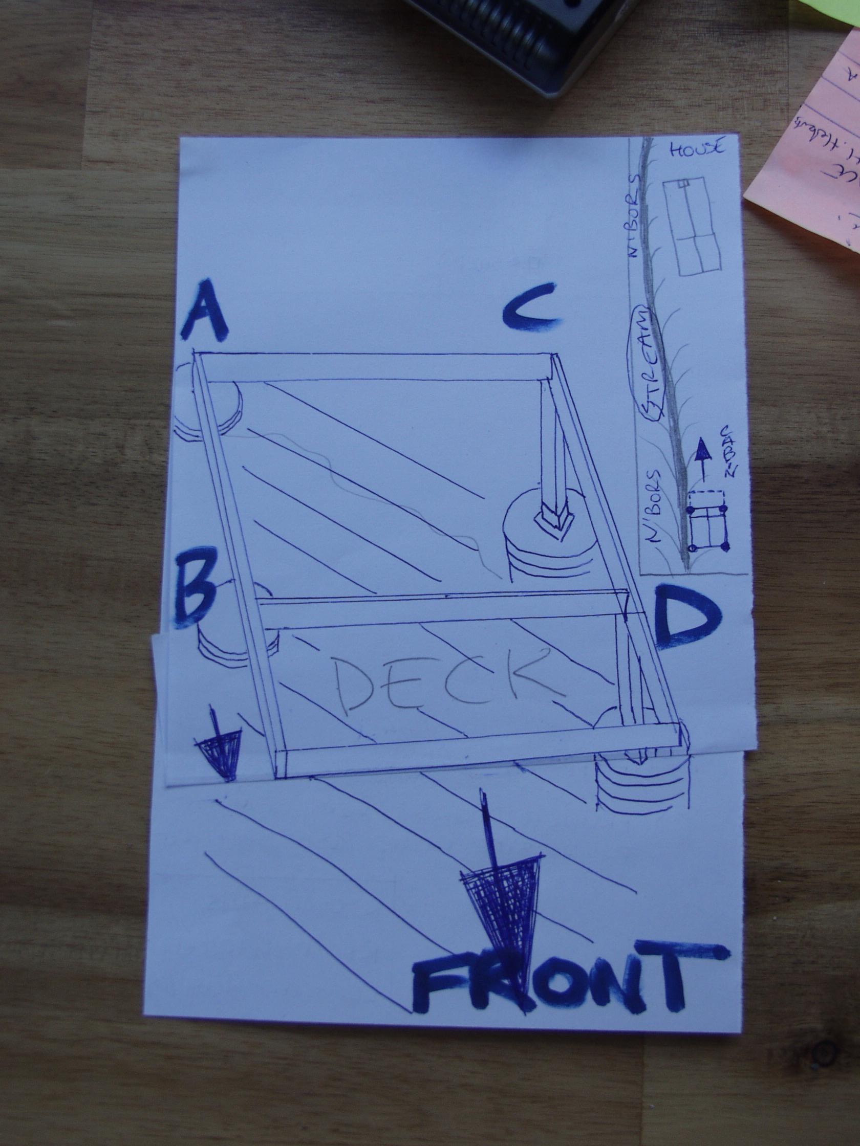

  3. I have been planning it meticulously from the start. I couldn't have done any more extensive planning.. Anyway. This is my plan as of now. A revised plan. Until yesterday (coinciding with your confusion where front of cabin was).. the cantilevered addition was over the stream, RHS, on the -side- of the cabin (always was & can only ever be the side of the cabin/ it cannot be the front of the cabin as Id look into a sheer dark bank 4m away). A & B the high side. C & D the low stream side. Lines \\\\\ indicate steep slope to stream. The front of the cabin = BIG arrow. This hasn't changed. The cantilevered section now is on this end (alot of thought how it could've stayed on the cabin RH side, as was my original plan, & to build a separate front "deck" > & link the two: but its too complicated for me). Please let me know if all is clear now? Thanks all- zoot.
  4. @Declan52 all understood thanks. My old cam takes a charge-day to take a snap, & me drawing/ ages.. or I'd add a sketch as I go like Onoff. Is the idea of -two- cantilevered sections viable then? or is that asking for trouble.
  5. @Onoff I think I've got to scrap the side walky addition + making a later structure in front/ I just haven't a clue how to design the two to join. Ok so instead: if I swizzle the 2x cantilevered beams FORWARD towards the house, to form the front deck area (so NOT protruding over twds the stream / cabin RH side, as was my orig idea). So one loooong beam will be sat upon two high-slope plinths (no pillars). And the other loooong beam will be sat on two stream-side plinths with pillars. Is there any confusion to understand what I'm suggesting?

  23. I did see this Declan, but I can't see what the orange lines does RHS.. Did you mean extend the beam no.3 forwards (& therefore presumably no.4 forwards too) so having -two- cantilevered additions?
  24. One with the purple lines?
  25. This is exactly what I pictured from the off Dave. But if I did choose the overhang RHS.. then I couldn't have another overhang coming out forwards as well could I? I mean that's asking too much of my base surely. In which case I could only think of making a separate, later addition job, of a front deck area.. & somehow stretching it out twds the overhang RHS, & the two to meet. Somehow. But then my brain melts down.
