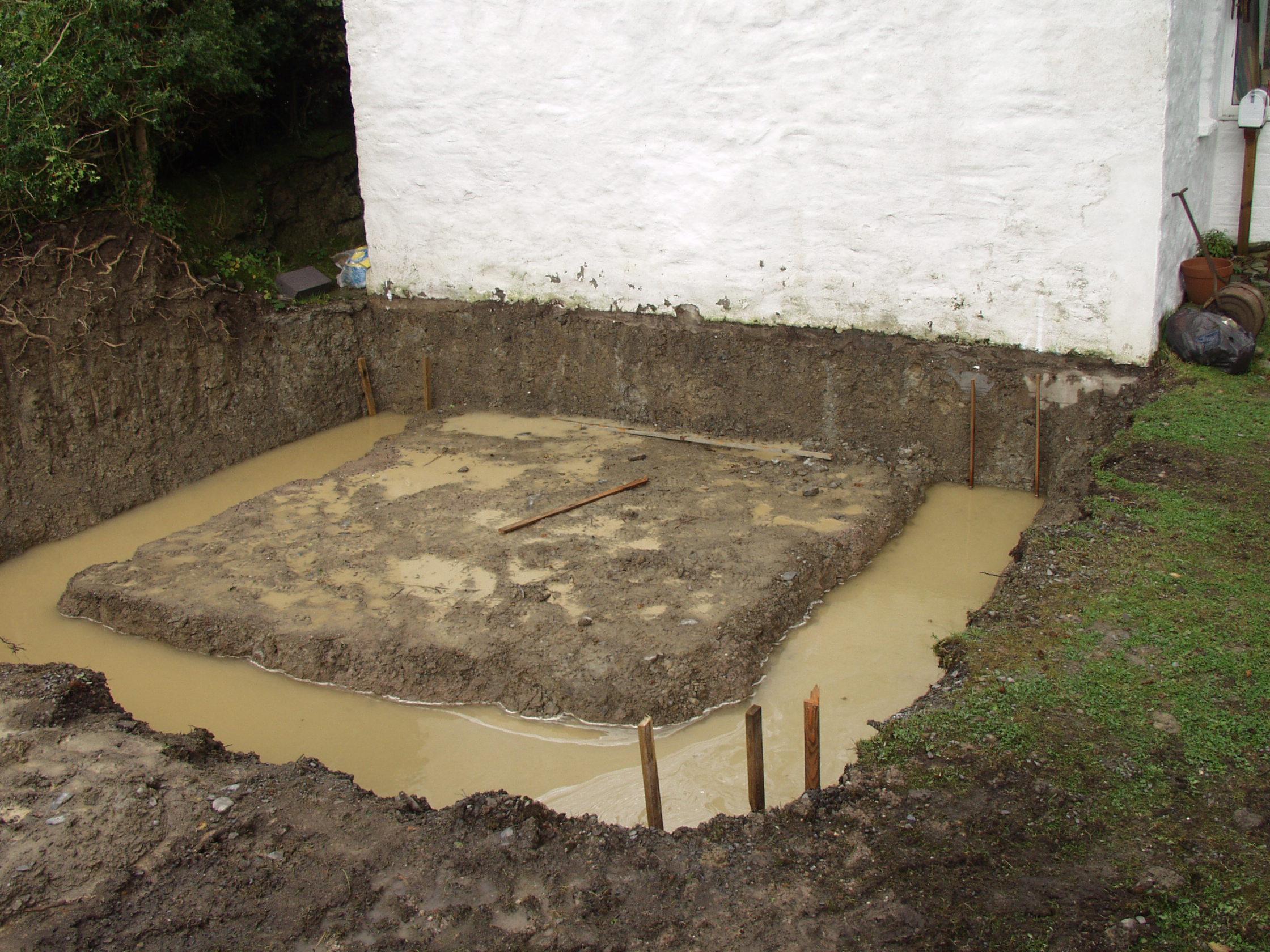

I'd imagine it would if you don't trust your builder. The only thing I need to discuss with him with regard to any additional costs, is this drainage situation, which I hadn't put on the plan (not asked to) or known of needing. Apparantly its a case of adding two 100mm ribbed black pipes: 1st from the top of the concrete pour > out to 4m away to my stream apparantly to drain off the 1"-2" water sitting on the concrete in a moat: why it can't be pumped out I don't know, but, if it has to be done (& the idea was the BCO's I think) then I'd hope either no cost , or only cost of pipe, or reasonable if not. The 2nd drainage pipe apparantly needs to go around the whole 3 sides of extention.. so I'd imagine although not a 1 hr job, not a big job so I'd hope again nothing £unreasonable to be added. Apart from these, as the build is very streamlined for simplicity/ I am doing all internal work/ & all stages itemised albeit in estimate form.. I do not envisage any nastiy surprises, none at all. I know this builder, he's done work for me before & bill was exactly as per estimate to the penny (in fact he let me off £700 for a new back door & frame he/ they did, as it got jammed so often [howden's poor door + huge moisture in air here = swell] I kicked up a bit, & I forced Howden's to refund him £300 he was rather impressed with! .. now that's a good builder).

@Onoff but what do you think of the 3/4m of exposed clay -below- the footings? if a week of heavy rain directly on it, as is exactly the likely case, is there any concern of erosion? & what happens to this exposed area of clay which will be, in my new room, from floor to knee level now.. just get rendered?
Whodafk is Mark Harmon, & why is he on my concrete thread? Another thing of concern, especially digging a ft lower than specified.. is the exposed foundation area below existing wall. I'm alarmed at the shallow D of the original footings, & now its all exposed/ nothing pushing against it, & open to the elements (it gets hammered being west facing & also facing down our wee valley/ village). Its going to be a week before the ground block 18" is done, & weather forcast poor.

Ok this gives me a bit of stress relief. But loo, you see the two batons sticking up, in the 1st pic, twds the top RHS of photo in the trench. The left baton's top has a grey stone & wee white dot above it. Ok.. the white spot is exactly 350mm from internal existing floor (sitroom adjacent). This is where the new floor should be. Its not a dot/ mark I put on for him, its just coincidentally/ usefully there. But I'm told its 2x blocks, to be built on the concrete = scree/ floor height. So I measured it: I can see where the water's clearing on the concrete the top (2" of water about right). From here + 18" up, so Im told, is the scree/ floor level. It is not 9" below of the white dot.. its in fact 11.5" below.

Finished but I had to go off- so stressed. The ammount of rain was huge/ relentless, & now.. total calm/ light skies. I mean WhyTF couldn't it have been shifted!! its absurd & left me feeling very anxious not only today but for the whole job, & onward. There seems to have been only 12" poured, with 2" of water alrerady in the trench.. & what looks like 3" or more maybe now just sitting ontop. I am very upset with this. I can't understand: Why so little? why not piped in (in the digger 2' bucket swung round > emptied??) why is the floor gonna be 9" too low? how on earth can this what only looks like a moat full of brown water be right?
The fill (about 1/3rd now) looks like weak rainy soup.. this is really worrying. The trench is being filled approx 2" of rain every hour. Seriously the worst rainy morning in 3 years Ive been here.

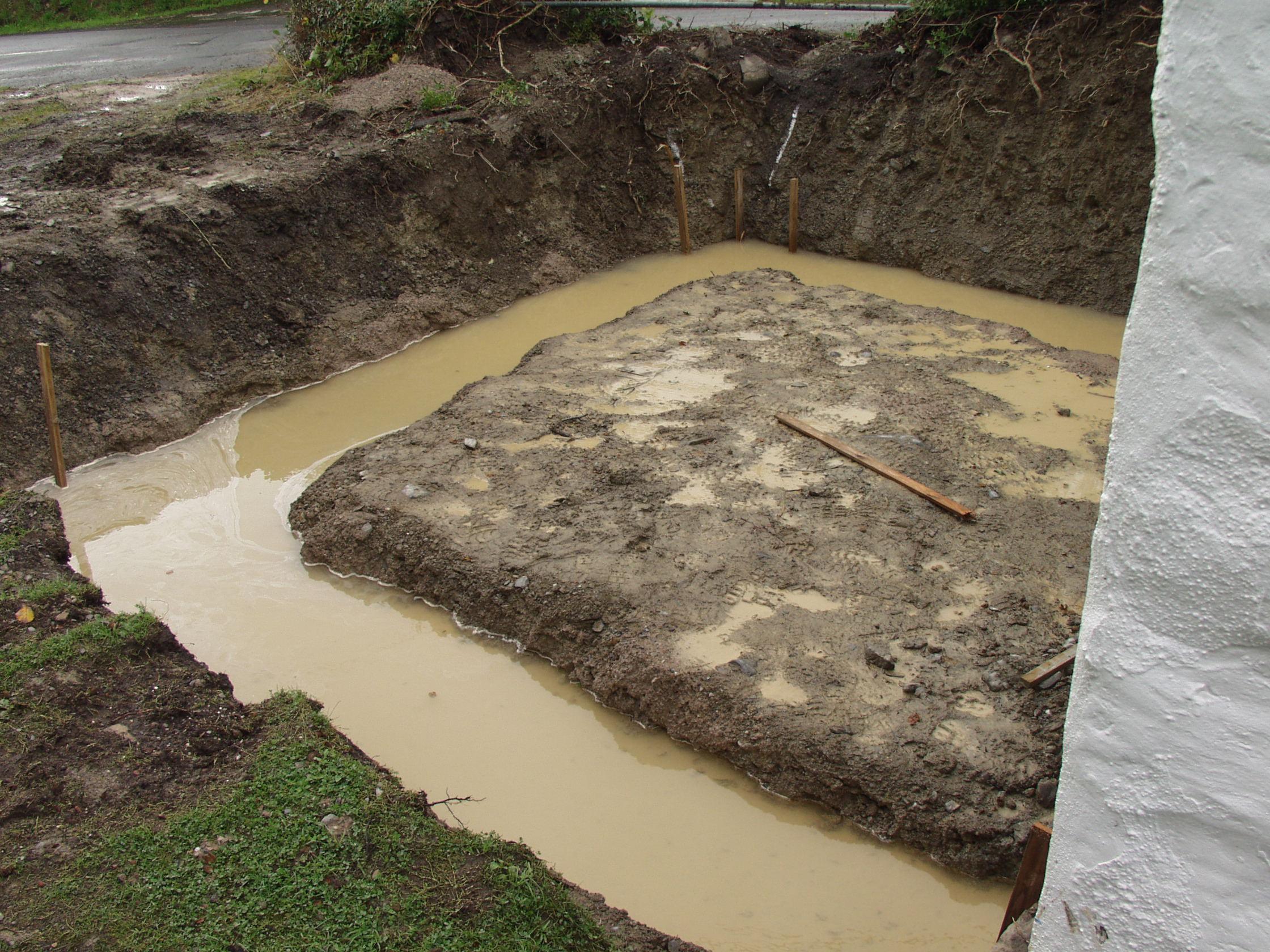

Yes relentless. The fill is about 1/10th (slowly digger bucket by bucket, swung round from the bigFO cement wagon- why not a big PIPE out from it, I don't know). Ive got one eye on the radar forcast 15m by 15m updates, & one on the job
I know I should Peter. But after concrete they're putting in a 'drainage pipe' (100mm black) planA was dig up front garden/ all way along to the stream.. awful ruining my front lawn.. but now only 1/2 as bad going direct 4m to hedge I mentioned to them (Highways drainage channel).. so I have to hang on & oversee planA isn't reverted back to. Also Ive got my floor level idea now.. which is 9" below what I asked for. In one way good as it gives me more height (hopefully in both rooms), but a huge pain as it now involves steps down/ levelling off land around, &/ or retaining wall or xyz, BCO problems to solve basically: I spent literally 6 months getting this height precisley correct too as its critical, every height of ab&c follows it.
Terrible conditions here now.. this is extremely concerning. There seem to be 2 schools of thought here on whether the rain is a problem or not. I can't say it makes me half as concerned tho.
Now its hammering it down & for another hour min lookslike too, & concrete wagon's just arrived- dammit. Stressful. Trenches are 2" full of water too (was pumped out 8AM but now refilled it seems).
