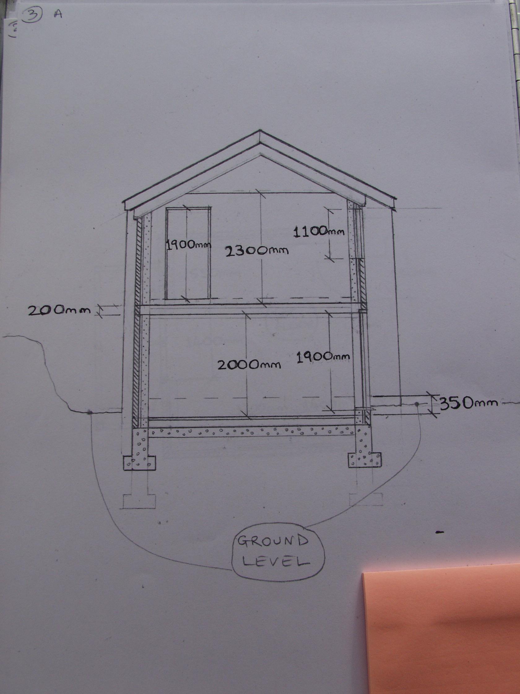

Can someone tell me: in my last photo with the black membrane (& damn ditches).. I have here 100mm from shiny/ wet concrete > to the lip of outside block (the 2nd 9" block top). Is 100mm on top of the wet concrete, my final floor height? or is there another brick to go on the perimeter?
@Declan52 sorry to answer your Q's. 350mm 100mm (whether 50mm-100mm it doesnt alter the final floor/ scree H, as this has to be @ top of the 2x 9" blocks surely?) 25mm? (again whatever is planned, to meet the top of the 2x9" blocks' level.. I don't know how it could be any extra) No services, just minimal electrics.
Hi Declan. I've just put up my plan again ^ for convenience: you can see the 350mm fig. I explained to main builder1 (I went through the 3 simple pages with him carefully, made sure happy with my drawings- very happy "good, neat") the 350mm figure, & it being from the finished floor level in the house. I said the broken lines are "original floor levels". Understood. "Am I right broken lines are usual as used for such adjacent/ finished floor levels".. "yes". So I did my best, my very best. Yes I forgot the wording.. 'orig floor level' but he didn't show ANY concern, as I could see he understood perfectly simply. Thing is he didn't do the groundwork as I assumed he would, his chap2 suddenly appears & wants to start wed 3pm. No warning. "Erm.. ok.. you have plan & happy? (Yes- all clear). I'll just put a mark where existing floor is.. & critical thing is 350mm down from it". So I crossed every t & dotted every i. As best I could. And I get a slew/ deluge of opinion on here that my plan's not this or that, or its all my fault. No, that's just not right at all. More haste less speed is the fault, this & only this.

That side Peter is no issue. The problem I have now, just speaking to no2 again, is because this is ALL 1ft lower.. this path area @ 600mm is being talked of I had never accounted for. This eats into the very small parking area I had meticulously accounterd, for in terms of where my corner point was decided at, with, only going 1 step down (IE the surrounding ground could go up to the extention). Now no2 is firm firm on this path area around PLUS some sort of retaining wall: albeit 1x BIG FO block high at best (maybe 1.5 height needed I think). So now I'm not happy. I wanted the adjacent ground -always- to go up to/ marry in with the extention, not some big step down into a path all around it. But I hjave no choice with this now. Not happy. But I can't visualise end result, the extra cost involved, whether I can -maybe- somehow backfill this damn path area I don't want.
@Carrerahill @PeterW too.. thanks for thought. All points taken & understood. I know I need to step up & say xyz firmly. But this 2nd chap is not approachable in this way. I mentioned 'maybe' the floor's lower than expected? Today he got his rule out & agreed, & a bit sheepishly that "I have gone a bit deeper" by 80mm he says (actually I think 180mm, min). And then he says of course "so you need a path round, block up a retaining wall" (to keep adjacent now higher ground at bay). So this extra step down, as I thought, will cause hassle & expense to rejig things to suit it. I shouldn't be taking on the cost of this, but if argue in terms of a 'mistake' made by 2nd-in-C, I just know not only him.. but builder no.1 will shut up shop & walk off the job. I cannot have this, or deal with the stress of it. I have to compromise somehow. Ive already said "at least you're not too shallow.. so maybe done me a favour" to appease him & we're good with each other. But any compromise from him? (IE quickly whip up the block retaining wall).. I think fkn no way/ forget it. But this idea is only solution. I'm not happy about this compromise by me, but if I gain extra H in the lower room.. I'll be ok swallowing a little extra cost & I keep these 2 happy. But not alot extra.

I think its sensible to wait until the floor is built/ the slab done. Then I can ask the Q's. I'm not so concerned about the extra D, if, the dividing floor can be adjusted. Absolutely fine. In fact I gain some inches as said.. but what I -don't want is all the excess added to lower room: bc then I have a balcony & fr doors opening out @ approx only head-height from surrounding ground. That will look weird, reduce the view (& Im looking straight into a giveway sign) & just be generally 'wrong'. Anyway I think a more pressing concern, is the area of exposed ground below the original wall. This of couse is where the extra depth is most pertinent as it were. I don't like seeing it & I think I can see some bits crumbling away.. now THIS is stressful. Anyone know what's likely to be done here?

Hi Russell. This is the plan: its -not- a "Full Plans" type: to reiterrate, the build is commencing via a 'Build Notice' involving my builder asking me for only critical dims on a simplified plan showing door positions/ window/ etc/ etc. It doesn't require u-values, or similar intricate details. This plan probably shows more than he asked me to do, but, he was very happy with it. My 2nd-in-command has a copy, which I see he's got in his digger (sitting idle at the mo), & he was happy with it. If neither happy, or anything whatoever unclear.. they'd have Q'd me. We discussed the interior adjacent room original floor levels (the broken lines), I explained the important 350mm step down from this point. He understood. I think (bc he gave me a full plans example, to get the gist & glean the basics he needs from it) the broken line is standard 'plans' designated symbol, for an existing floor level I'm not sure.. but, I walked him through this simple plan focussing on this point/ my broken line, the ground level line near it, & the 350mm new floor mark: he understood perfectly. Thanks all.
