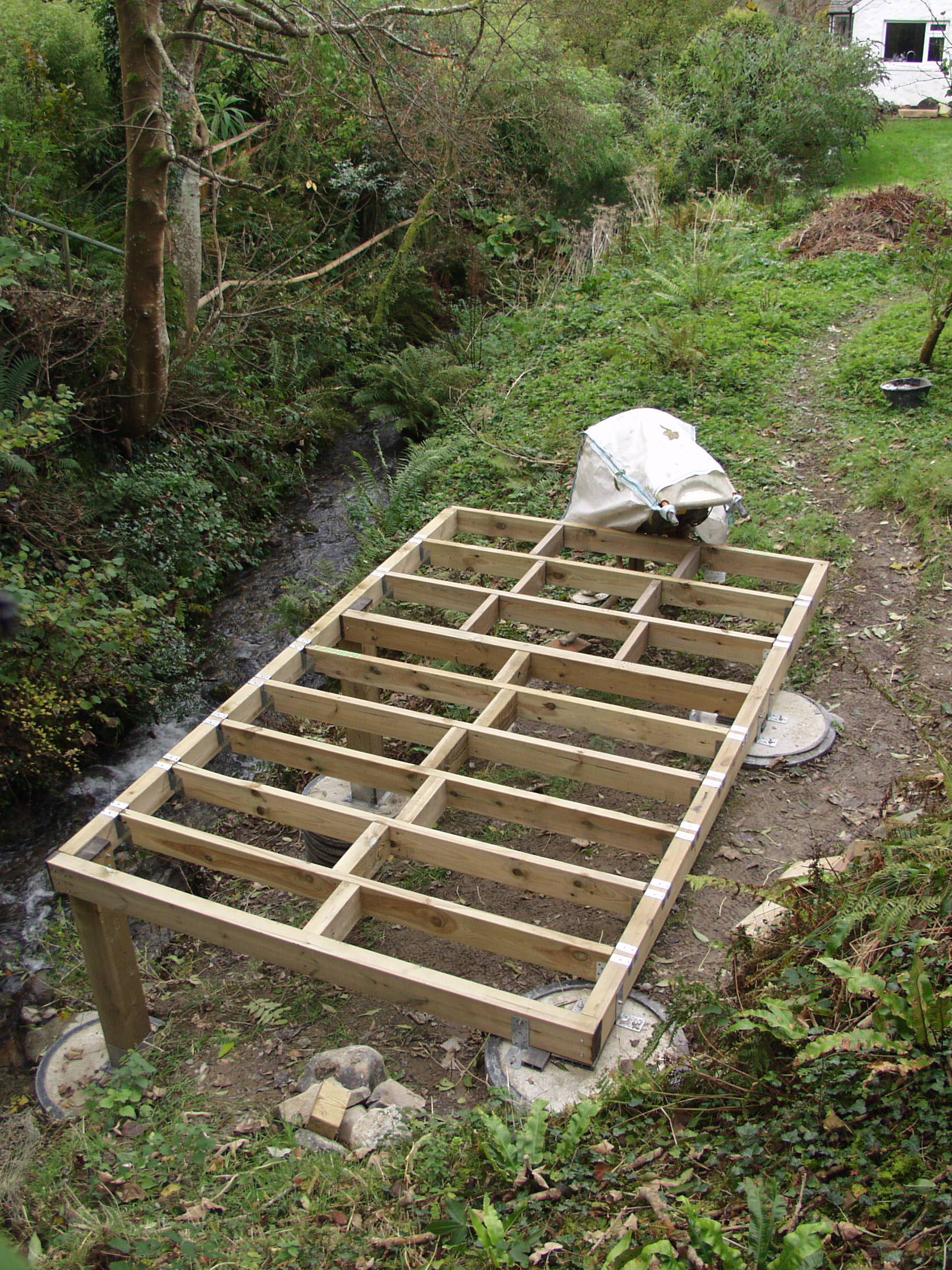

  3. Here's the sod in Q I'm (hopefully) taking apart tmrw/ deliver ~end of week probably. Seems to be sitting on s'thing or other.. will find out tmrw I guess.

  9. Hi Declan, shed won't sit directly on the OSB, no I understand the perimeter 3x2 is for shed to sit on directly.. but the 3x2 ontop of the OSB, is effectively the shed's load on perimeter of the OSB.. surely OSB is not designed for a load to go on it: is my point. Osb day 1 then shed day 2. Yup that makes good sense/ understood. Insulation and final floor day 346. Not understood: ahem.. page 346 thanking you.
  10. Understood. The front deck bit (where the cabin will not be).. here the 2 joists Ive put in are at 450mm centres, so if I put scaffold bords on this area with wee gaps etc.. would 1 centre noggins be ok (looks a bit big gaps) or should I double up & put 2 in? And do these noggins' ends need to be cuprinol'd.. or will the fact that they're nailed & flush to the joists mean painting their cut ends not needed?
  11. Yes going with Peter's idea, just trying to get my head fully around it. You mean my overall 4m height?
  12. Ok understood. So the shed will sit on the OSB.. but I'd have thought over time this would be the fallible 'layer' you see.. especially here as its rainforest wet.. so is it defo ok to put the cabin walls (the cabin load) onto the perimeter of the OSB? Are you suggesting the way a typical log cabin is built, is the floor is put in last/ so I can build it standing on the OSB.. then once roof on, fit insulation > floor inside? What if there is a time delay between the OSB layer & cabin onto it? IE rain on the OSB?
  13. Good idea- I know where to get some too. I don't much like that decking stuff/ too 'london boho'. Joe if you have ideas on PeterW's idea on a 3x2 outer frame (on its side) for insulation, ontop of my base as it is now this is.. ..or anyone else? I can't get my head around it, or know what I'm doing to get a layer of insulation between my base/ joists & below my cabin. Thanks all- zoot
  14. Peter- can I pick up on your idea of laying another frame of 3x2 (on its side).. & filling the centre with 50mm celotex. I get the idea, but not the OSB sheet onto which -I think- the c'tex will need to sit. Afaict this OSB looks moisture-prone on its edges (I think its chipboard?). So unless its shielded/ goes inside of the new outer 3x2 frame, its edges will be exposed to weather. But, if its put inside the c'tex will protrude up 12mm or 15mm above the new frame. I was going to put joists in today, but not sure exactly at what height to fix them.. IE.. in order to negate this 12 or 15mm protrusion, maybe your idea was to set the joists -down- by this ammount, so the c'tex top will be flush with the 3x2 frame-?

  24. Another Q soory. I 'm having trouble working out my 5x joist spacing. I just can't work it out to mean the 5 are equally spaced in my 2170mm gap. If I divide 2170 by 5.. this doesn't work. Or by 6.. doesn't work. What on earth am i doing wrong?
