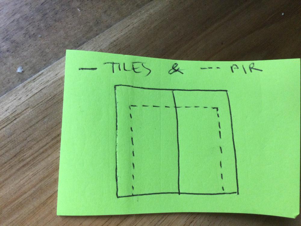

  7. Hi Peter, understand.. but how much PIR would you say minimum though doing this? It's a smallish cottage you see, every inch of room counts type thing.

  10. Hi TT, ok so the redoing the pB, was one thing that occured to me too as a "possible" action to take. So you've confirmed this idea had validity. Ok that's helpful. As to me choosing between this (A) & the adding-insulation-to-existing-ceiling idea (B), I have no way of knowing. As I have no experience. I can only then guess, that (B) is potentially easier, & (A) is possibly trickier but would be the better option. But Im just guessing, as I have no experience.

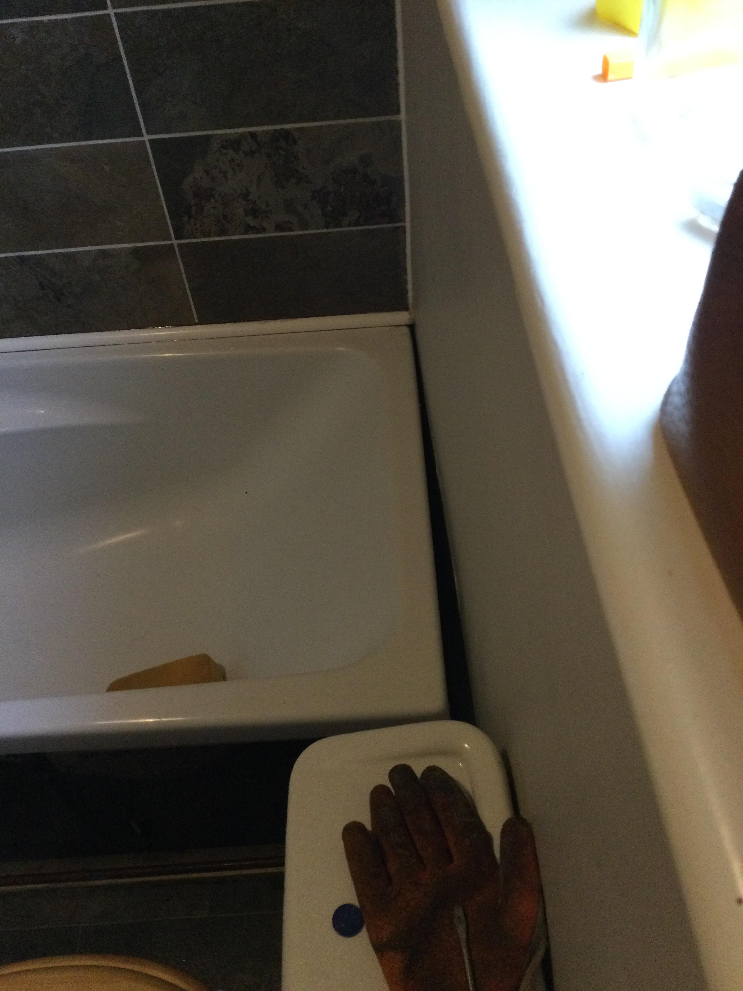

  13. Chaps, this new cautious approach ( builder do excavating/ quote needed/ job on hold).. means I'm back considering all aspects of where the cold might be entering the room. And whether I can do anything about it, prior to considering this massive (for me) step of excavation which would be a huge upheaval, let alone cost, duration etc. Did some detective work, & one area I'd not previously thought of, has come to mind with regard to a (possible) huge area of cold ingress to this mainroom. I can feel cold pouring down the stairwell. No doubt at all. Ok this could be from a,b,c,d places collectively together, or, one hugely dominating. If I close my upstairs bedroom doors.. I recently realised.. a bit less cold pours down. A bit. Suggesting the majority is -still- entering down stairwell from 1st floor though. So I look suspiciously at my sloped ceiling area of my stairwell area, high up. I go in loft, to see what insulation is stuffed down this slope. I can't see behind a big 9" joist. This blocks sight, & seems to block any access between the plasterboard sloping down behind it.. &.. the roof only 8" or so away. SO. It seems to me, like the stairwell plasterboard sloped ceiling, has no insulation behind it. And the roof only a little above it here. = a freezing cold ceiling area. This sloped side section, being about 2/3rds area of the stairwell ceiling. SURELY this cold source is the main culprit of the -stairwell- cold. But access to it.. to stuff even orange fluff down... is n/a. I'll add photos. Zoot
  14. @Onoff cheers for the fag sketch.. gets me into gear 1 to be honest. I still think I should get my builder in to excavate: he might well do the cautious approach & start inward of the edge & 45* sloping down into an excavated area. It's too much of a risk for me alone, & as insurance will be involved should he take the job on: & I can make 100% sure beforehand to check all this insurance aspect, before agreeing. This means I can't afford to crack on with the job now then, alas: I need to get a quote & consider the whole hightened cost. It might mean it's out of my budget. We'll see what his quote is. Thanks, zoot

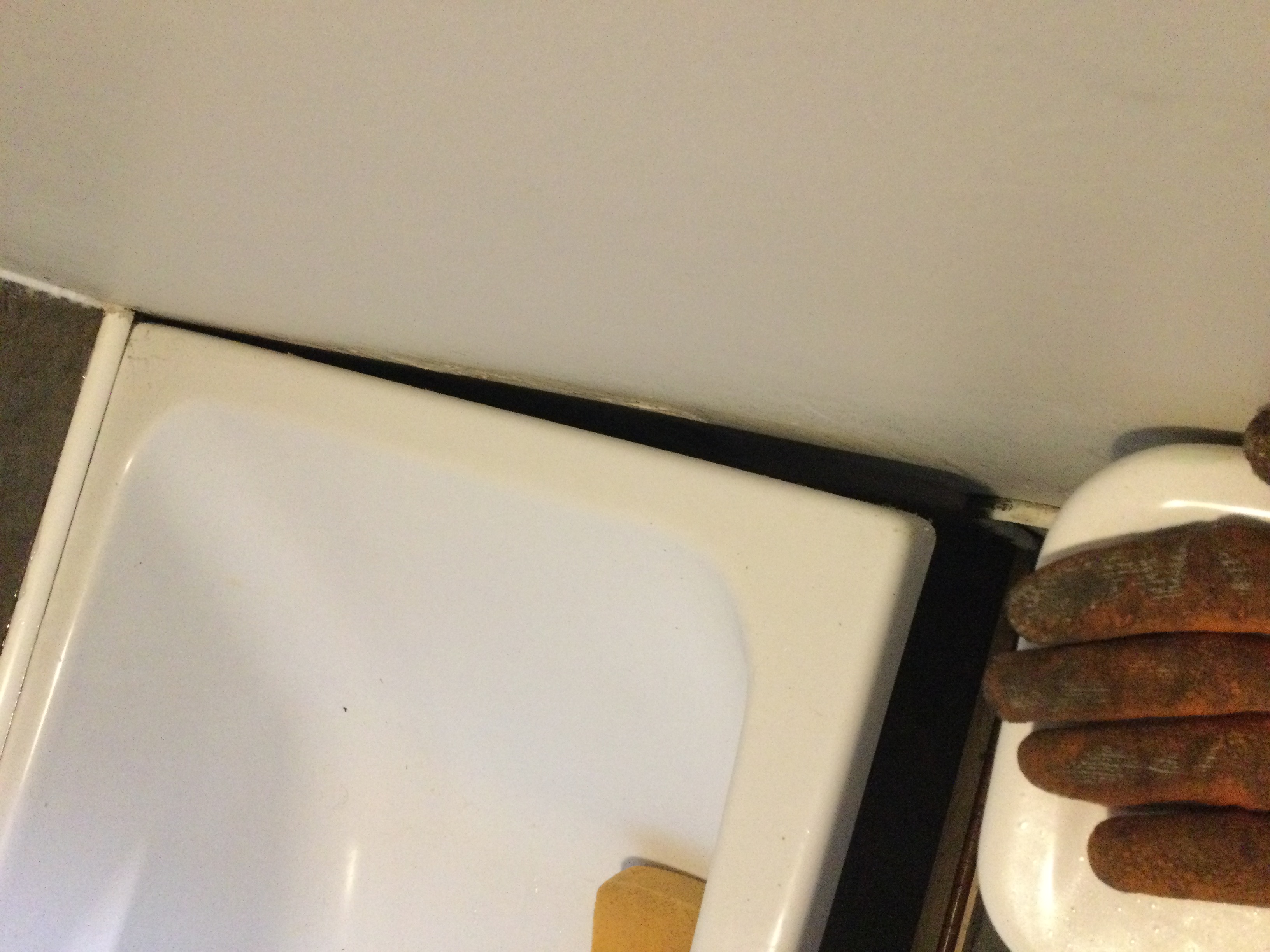

  16. Crikey, no wonder you had a few extra pages then! Forgive me, but I'm not quite on board with the suggested idea. The grey foam stuff I can visualise, & presume chosen cos it'll squish one end & fill out almost all the way along. The BT1 stuff understood, as likely the best quality stuff. But I imagined it might be just be a case of some sort of plastic beading, to bridge the gap, glued to bath & wall, the lower section cut along say 20mm one end, 40mm this end. Im not quite understanding the grey foam. Or is this the first stage, then some sort of white placcy trim then goes -over- it? Thanks, Zoot

  18. Chaps- I've had this annoying gap at end of bath to wall, now a good time to address it, before I put the side back on. Gap is 7mm.... 35mm this end: the extention walls aren't square, no idea why (I think cottage 'shell' wasn't originally, that this 70's extention was built onto). Could you advise- I do slosh a bit of bathwater down here. Thanks Zoot
