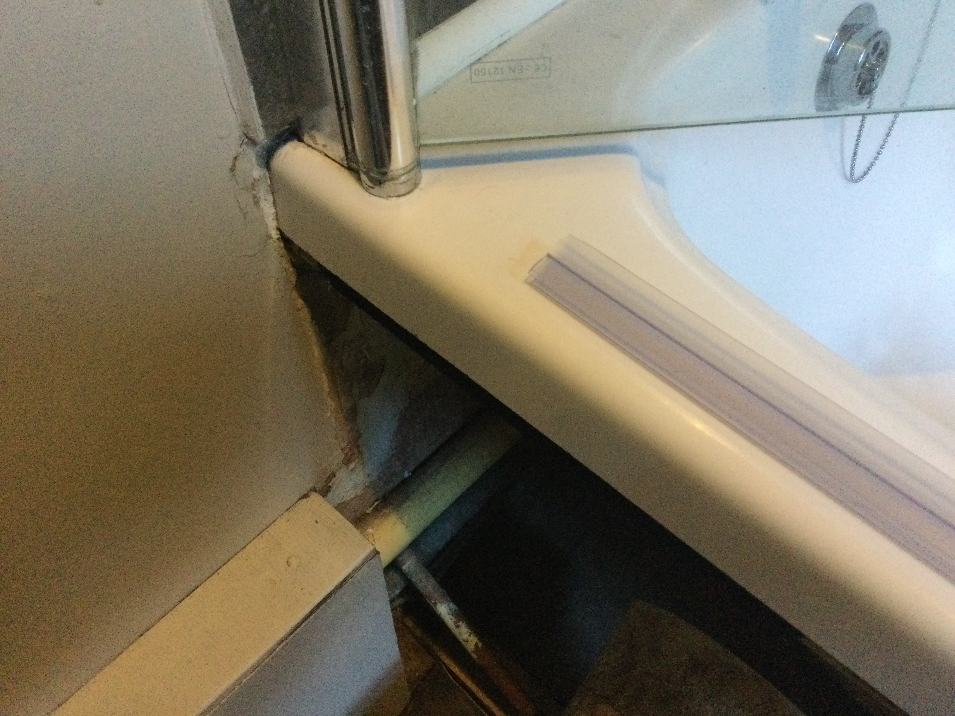

Hi chaps, I have a small persistent problem, causing bigger longterm woes & damage. The shower screen seal area, particularly the hinge corner. I've got a new clear 16mm seal strip, with two fins one long one/ other shorter. Firstly- which way round? Long fin bath side, or short fin bath side? (Www info suggests both ways correct!). Secondly- I get an incredibly annoying leak at this area. It's help to ruin the lino, the bottom edge of the bath side section, & creates water ingress to the hardboard underneath the lino. It happens 50% of time I have a shower (leaving me perplexed), & about a good litre+ of water on my lino floor after a shower when it happens. Trouble is I just cannot establish -precisely- where the problem lies. So I can never resolve it. I lay down 2 big sponges on the inside of bath at this corner when I use the shower.. but the leak still happens even so. Driven me absolutely mad for 5 years this. Thanks, Zoot.
Hi chaps, hope y'all had a good Christmas break. @Onoff thanks for these photos added 22/12. I've yet to do this gap, because floor kinda ruined by the bathwater flood.. so needing weeks to dry out (hardboard mainly, which was put down under the lino/ a lino job done by pro 2 yrs ago). Lino was coming up in areas you see, due to the water ingress underneath. So I've lifted / rolled back, & aim to restick it back down onto hardboard once this is dry. Lino underside in a state needs prepping too. Urgh. Will jump back on & do the tub gap once lino down. Thanks, Zoot.

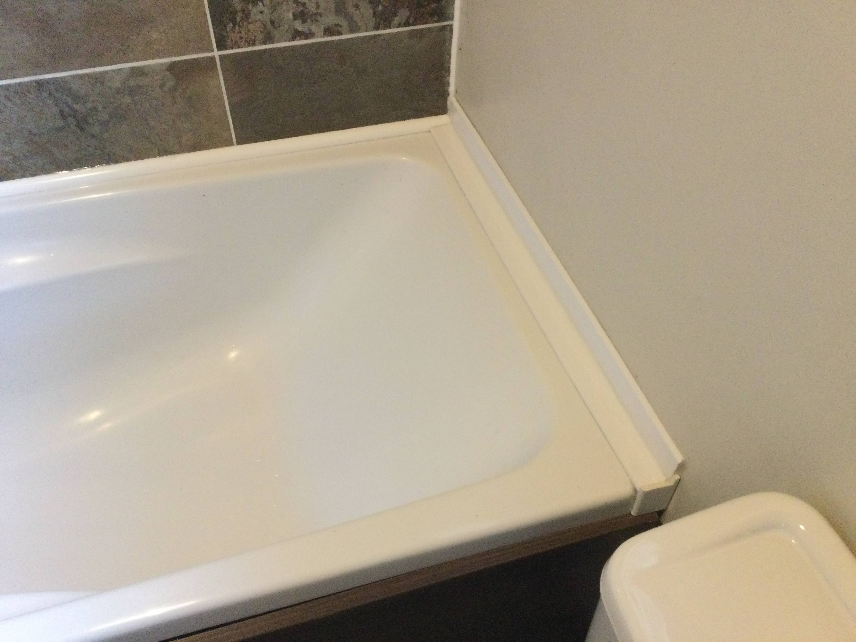

Chaps- I've had this annoying gap at end of bath to wall, now a good time to address it, before I put the side back on. Gap is 7mm.... 35mm this end: the extention walls aren't square, no idea why (I think cottage 'shell' wasn't originally, that this 70's extention was built onto). Could you advise- I do slosh a bit of bathwater down here. Thanks Zoot
The screwfix chap was undoing this ( said he was a plumber & could he show me.. yes sure) & possibly reversed the washer. Anyway, as usual I go with instinct: do what Onoff says & go from there. Spot on. Actually I need tidy up a few more minor things in here whilst bath side is off.. need to keep thread open. Grateful chaps, Zoot
Hi ProDave. Yup best idea was try attack it in situ.. so I heated the thing, then let it go cold/ doesn't take long in there, & this helped to shift the cap off. Dug out black washer, seemed too big so trimmed edges/ reversed it: then cap went back on easier & further inward too: seems as Onoff suggested the washer was the issue. Leak stopped. Fab, thanks job done.
Yup, but thing is Ive silicone'd immediately under the bath fiberglass hole to the rubber washer, as advised. I could leave this rubber washer on tho.. & hope to get a mm perfect alignment next time, when I remove & fix/ or replace the trap. I think my only feasable idea. Tricky tho. Thanks, Zoot
Hi Onoff. Understood thanks. I am 100% sure, before posting this new problem exactly where, & where not, the leak is coming from. Its simply dry at the black/ white junction above. And I can see it coming out the low thing screw cap. And it's dry onward at the junction to main 2m bath sloping pipe (dry on the underside of the sloping pipe too, just as confirmation).
