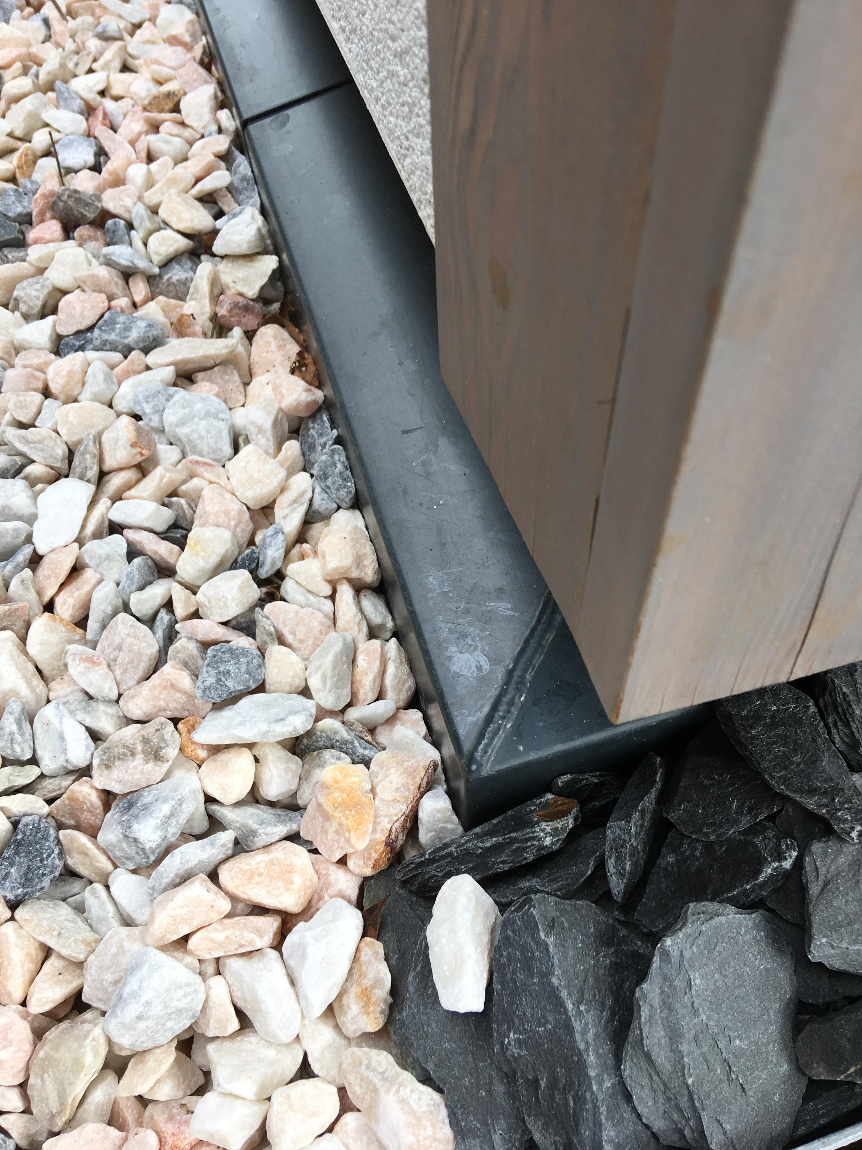

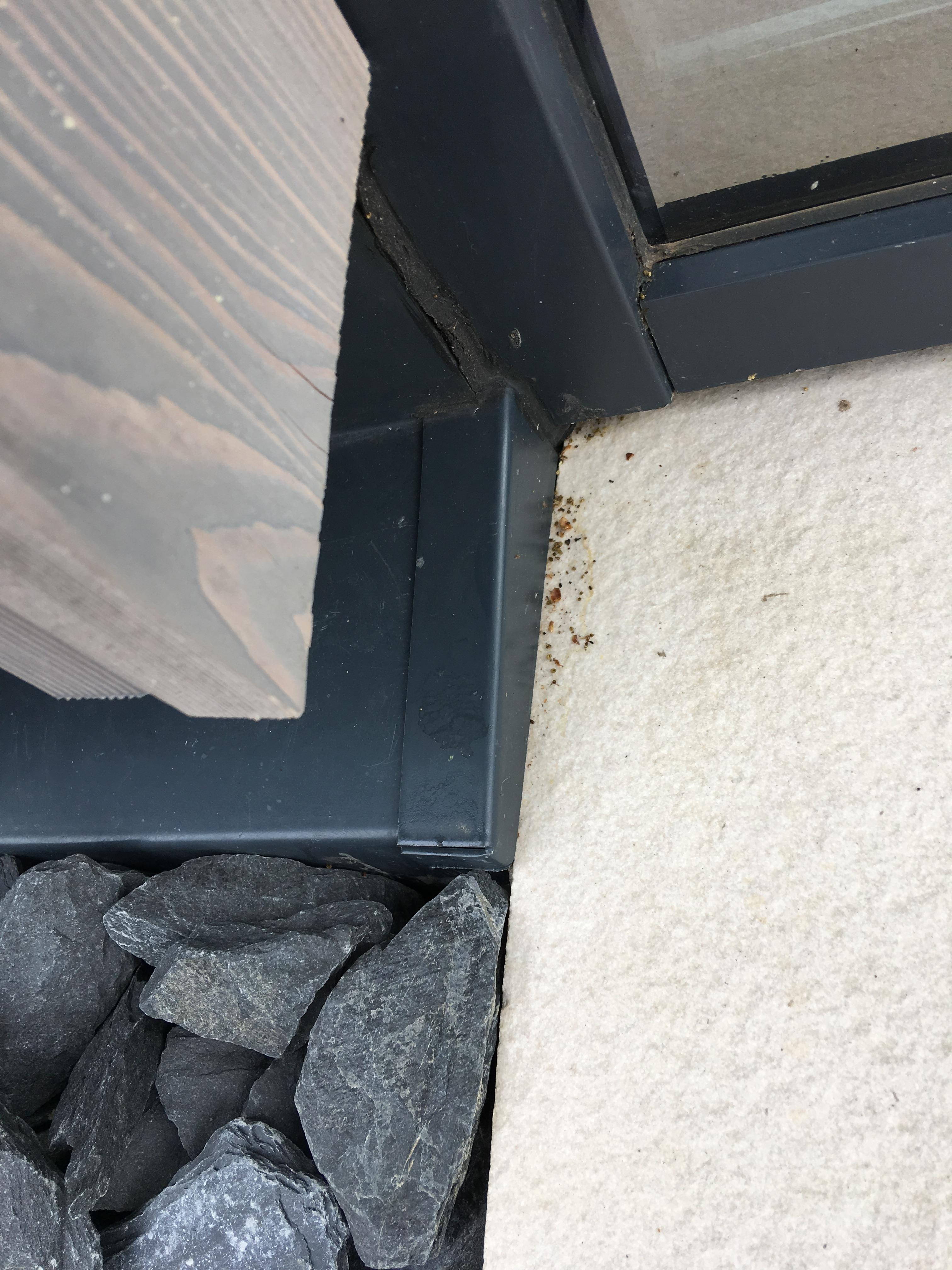

  21. My corners were fabricated to fit, we also had end pieces made to finish off ends of runs.
