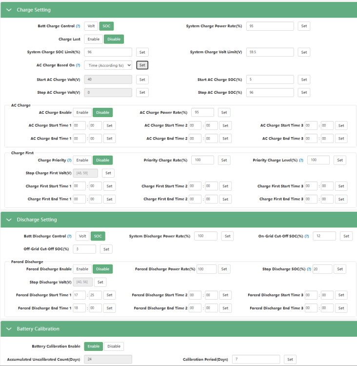

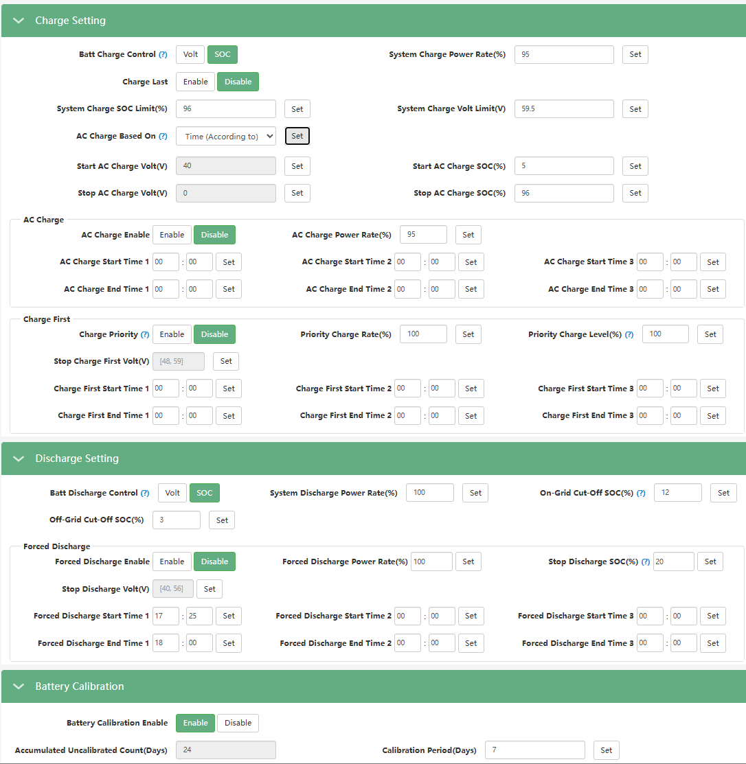

  1. Just to add, in case anyone else has this issue - the system was apparently trying to charge at 00:00 due to battery callibration, where it tries to charge to 100% but couldn't as the limit is set to 96% so it kept trying. I never changed any settings but it looks like if you click on the "enable" to calibrate then you need to change the SOC charge limit to 100% until it's gone through one cycle.

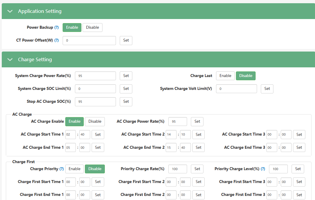

  2. Hi, I have a Luxpower Hybrid Inverter 6K [LXP-6K Hybrid] and it's been working properly for a couple of years but recently it's not been working as it should. I'm going through the support email address and they are getting back with the odd thing, but once they updated the firmware it's got even worse. They've not got back for a couple of days so I'm just seeing if I can find a way to get the damn thing to work. The webpage interface has changed recently so I guess the issues may be related to this but it's been hopeless. The recent issues are: - using time slots and SOC to charge no longer works. Apparently this is a design issue but it used to work. Now you have to set the charge at night for period, or else set the system to charge when the battery SOC reduces to a certain level. So, for example, you can't now charge the battery to 30% at 4am-5am. It's a bit crap but hopefully it will change. - the forced discharge stopped working, but now it is. - the battery isn't used at 00:00 no matter what the battery SOC is. I've gone through every setting and can't for the life of me see any setting that should even lead to this happening (the battery isn't charging at 00:00, it's just not used). - Luxpower updated the firmware but now it's even worse! At 00:00 the battery gets changed at the max level. This is even when AC charge is disabled and all time slots are 00:00 (ie nothing is even set). - all I can do is set the overall battery max charge level to something small at night, and then change it back in the morning so the solar charges the battery. This stops the battery charging but the battery still isn't used at 00:00. If anyone can suggest something that I could try it would be appreciated! I've pasted the main settings, both the new and old look options.

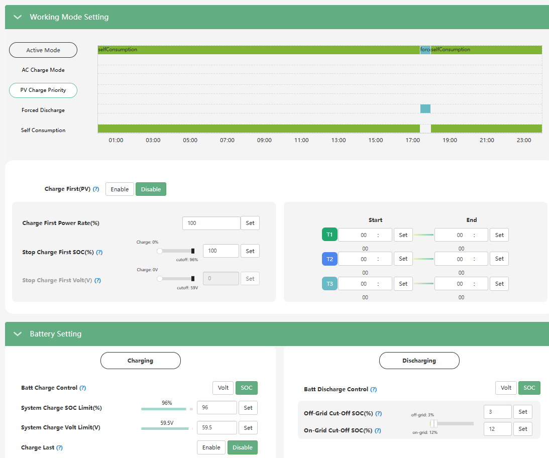

  3. Just to update this, in case by some miracle someone else comes across the thread with the same question, I couldn't update the setting as the inverter needed a firmware update. It's not something I can do myself but I got good responses from LuxPower and they updated over night.
  4. Thinking about it, it seems like it must refer to the max battery charge when not using AC (ie through solar I guess), but it gives me an error if I try to set it to 95%. Maybe it's effectively doing nothing now but in the summer it lets the battery fully charge.
  5. Thanks, that is interesting. There is another setting elsewhere where the battery is stopped from going below a certain point (6% or thereabouts) and this setting is only in the charge section. At the moment it shows a zero but this is out of range so I guess it's assuming the default, whatever that is.
  6. I really have tried to find out but there is nothing in the manual, or any similar manual online - though many have a similar page to the page below but without this parameter. I get what "System Charge Power Rate(%)" is, though is there any reason it's bad to put in 100%? Looking looking online most of the time it's 80% or something like that. I'm not sure if this overrides the "AC Charge Power Rate(%)" parameter but I'll just set them as being the same. I get what "Stop AC Charge SOC(%)" means, even I can understand that! But what is "System Charge SOC Limit(%)"? If the page isn't loaded up then it wants a [10,101] range but it doesn't like anything if I put a figure in and press "set". I think I changed this recently, thinking it was the previous field by mistake, so I don't know what it was previously set as and I can't seem to set everything to default either. My inverter is called LXP Hybrid Inverter 6K [LXP-6K Hybrid]. Any clues would be appreciated!
