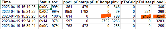

  11. Thanks, that seems like a lot. I think I just assumed 4kW as when I looked at the data there were a few discharge figures around there but it may be concidence.

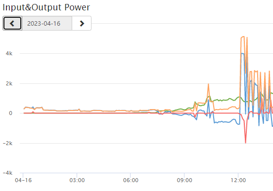

  15. You've got me questioning everything I thought I knew! I can see what you are saying but it does seem like consumption really is consumption (though how accurate it is is another matter). If I look at the history data it shows the following: it looks like the immersion flicked on and it took a while for the battery to discharge. As far as I can see, the battery can discharge at 4kW at least as I've seen this "pDisCharge" value on other days (I'm fairly sure that this is the limit). The chart uses 5 min incremements so I think some spikes can look bigger than they are.

  17. If it was consumption of 6kw I think the orange line would be at 6kw, with the solar/battery/grid making this up. That spike looks like those random (to me!) spikes that I see sometimes. What you say about the induction hob seems right in that this does cause some spikes, but I seem to get them anyway. I think the import as per the app slightly overstates the actual draw though, when I look at the actual meter readings. All I did that day was heat up my take away in the microwave!

  19. I can't see the spike on the chart but I do have an induction hob! I thought it was only 1kw though. It's something I never ever use in the winter but it may be worth using now, so long as the import spike is only small.
