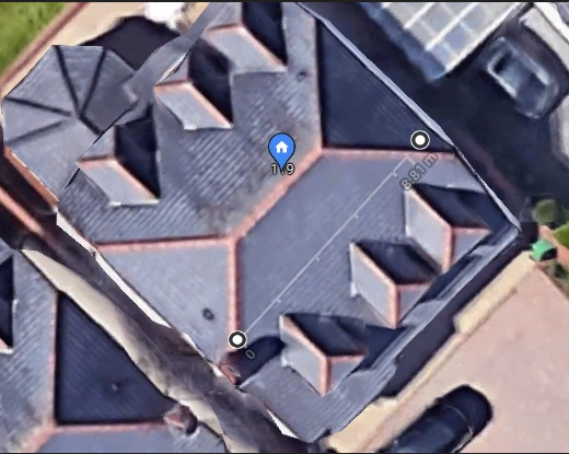

Thanks - love the diagram. Did they say how much space you need between panels? Can you tell me how big your roof is and what overall (theoretical) power the panels would amount to? You have 12 panels there which is what I was coming up with, but I'm just assuming that the gap doesn't have to be huge and I was looking at 169cm x 105cm panels. In theory, 12 of those panels is 4.5kw/h (though less for the angles etc).
Just measured and, allowing for 30cm from the roof edges (not the wall edges as the roof extends a bit), I've got 6 meters by 5 meters. It seems like I could have 4 long rows of 3 panels potentially, which would be a decent size. No doubt there are a million reason why it won't happen though ... SIGH.
I hope you are right about the ridgeline point. I fired off an email to the council planning permission email yesterday but I'm not sure I'll get a reply. Not sure why you need 30cm from the edge. There must be a reason though. I guess it's not that much but it would be a miracle if you could use all the space with limited panel size options as you say. Is the east/west thing as they want to fit rows along the long edge to minimise the gaps? In my case I'd want to line the panels along the longer edge so hopefully that helps, but I'm not finding it easy to even get quotes at the moment.

Oh feck. An installer just called and looked up the roof on their system and reckoned that, as you can't go anywhere near the edges, it probably wouldn't be worth installing panels on the front and side roof due to the dormas. Dammit 😞 -

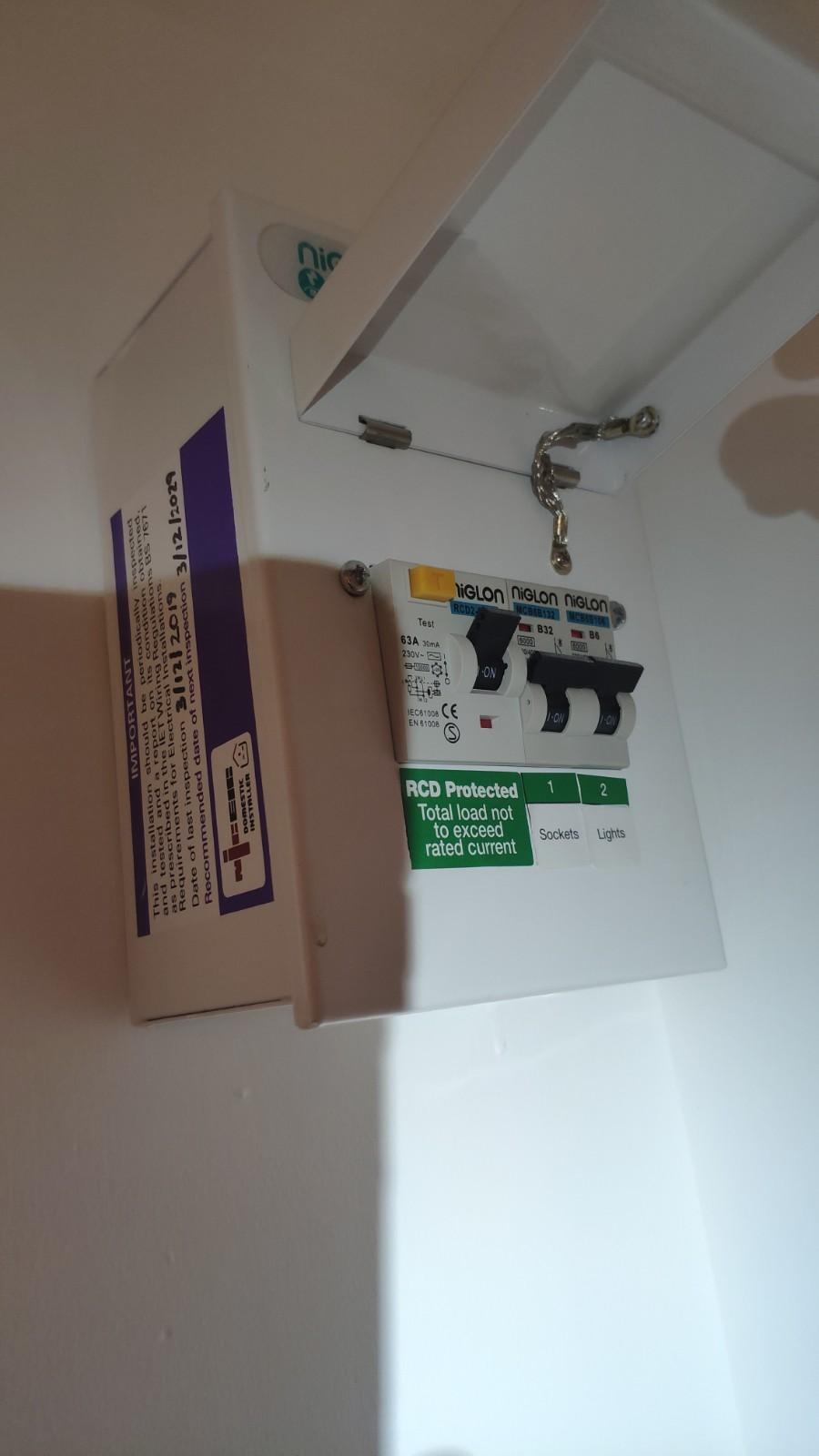

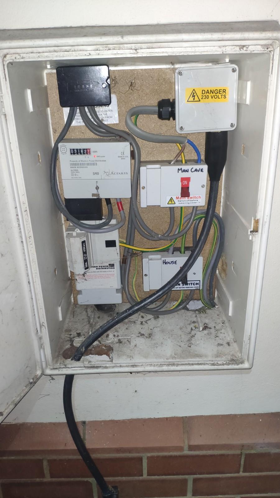

Thanks. You may be right about the SEG stuff as I work from home so would probably use just about everything in the day, and could plan to use excess. One thing that has just occured to me is that I don't have a smart meter. My old distributor (sadly no longer around), Pure Planet, were going to install one but couldn't for some reason. They probably told me to contact the supplier but I never did as I wasn't all that bothered. Whether that's bad for getting solar or not I don't know. Anyway, it's dark but I took a few pictures!
Thanks. That outside box has the electricity metre in and I guess is just where the grid is connected. It's just a white electric box to me! I guess I'm lucky in that the panels would go lenthways so the gaps wouldn't restrict quite as much as the other way around. I was thinking that you could fit three rows maybe. I did look at a chart that showed the optimal angle and direction and it looked like there wasn't all that much difference between something like 10 degrees and 30 degrees in terms of effectiveness. That may not be correct though, hopeful thinking maybe. I'm in Wales and as far as I can see the only restriction that could potentially apply is that I couldn't go within 1 metre of an external boundary. If it's viable than I'll need to look into SEG and maybe other tarrifs if any vary with peak/off peak times. This is something I'm putting off until I know whether it's a go'er 😉 I guess there is also the option of some on the roof and some on the room.

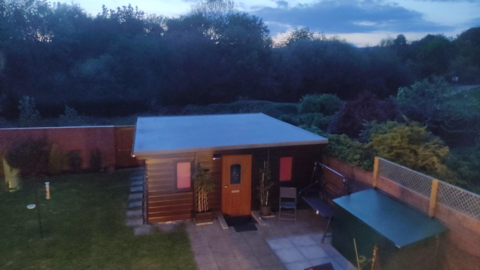

This is my second post - the first was very useful, larely in terms of how to think about a battery. My conclusion is that it's not worth it for me, at least not for now. I've been considering whether it's worth forgetting the main roof, possibly just for now, and having panels installed on an outbuilding. This is something like 20 feet by 15, fibreglass roof, sloped slightly (for drainage) towards south-west. It was built a couple of years ago to building regs standard I believe but it was not covered by builing regs as it's a permitted developement. They dug down a bit, so the heighest point of the roof from the outside is just over 2 metres so I don't think there are issues with it suddenly being too high and needing planning permission if panels are added (assuming the panels aren't too sloped, which I don't want as it would look silly). There is an electric feed there from the outside box where the electric comes into the house and it has it's own fuse switch inside this box. In the room itself there is a small customer unit. It seems like a way easier install than having to get on the roof and I'm thinking that if I then wanted some on the roof at some point then it would always be something close to a seperate install anyway given they'd need scaffolding etc. Am I correct in thinking that there would be forms etc needed, but the installer would / should sort that, and essentially the panels would to feed to a small-ish inverter (which I guess would have to be in the outside room) and then from there into the house vis this outside box? I assume that the supplier would need to be told (current Shelll as I got switched from a green supplier and I've not yet looked into switching)? It worries me a bit that this outside box (I don't know the technical name!) is kind of crammed inside as is due to the extra fuse for the outside room. Anyway, any comments would be great!

Hi all, appologies if this kind of post isn't allowed but I've been pondering whether it's worth (*) getting solar panels installed and possibly a battery. The house was built in 2003 so the roof is in good condition. (*) I know it's probably going to amount to a net cost over a reasonable number of years, but I'm OK with this for the greater good if it's not too dramatic a cost. If I'm managed to do it correctly an image of my roof is attached. This is from Google Maps, with north upwards (so the front roof faces south east and the side roof faces south west). It would all be a decent size perhaps but for the dorma things taking some space (and I guess you can't have a panel on each facing south west?). I added a measurement line in white. In addition, I have a recent garden build that's about 20 feet by 15 feet (it's a games room). This is a flat roof, sloped slightly (for drainage) south west, with a fibreglass top. The wooden beams were solid and it was a proper build, even though it was a permitted development (so building regs didn't apply). It's only about 2m high so the height restrictions shouldn't be an issue. It does have an electric feed and it's own fuse box, but I've no idea what it would mean to electricity from there to the house. Every time I try Googling I confuse the hell out of myself! The other issue is where to store a batter as I don't have a shed. If it wasn't huge then maybe it could go in the games room I guess, but I think the attic would be too hot even with fans etc? Anyway, and comments about the potential would be appreciated!
