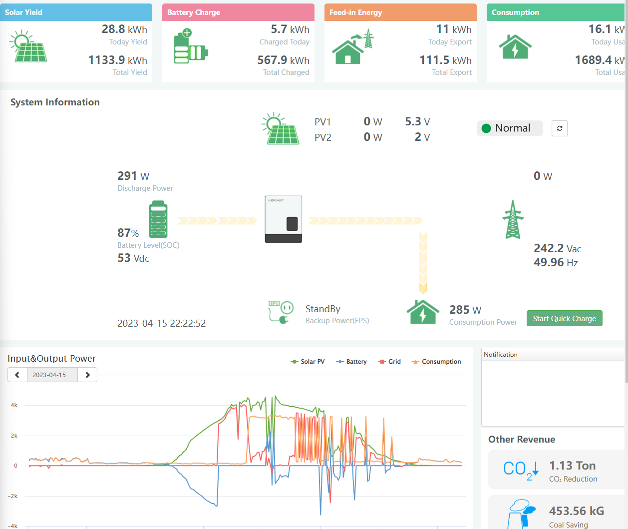

  4. All, thanks for the responses. My conclusion is that, without doing anything fundamental, I can't do much except for setting the thermometer to the max for the immersion (not gas). It was turned almost all the way before, but now it certainly is hotter (it would be too hot without a mixer) and when I turned the immersion on today it stayed on for longer than it ever has before so that's am improvement. It still seems slightly odd that, after a shower at 2pm, the immersion only flicked on briefly many times. I guess the thermoneter is in a place where the water is still hot, and it certainly is! I probably got over 11Kwh into the water today. Also, 28.8 Kwh today - woot!

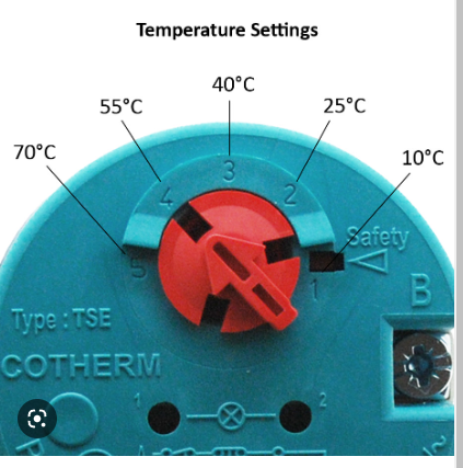

  7. I've not touched anything and it does seem low. I'll turn it to 55 but I only ever put the gas water heating on for 30 mins max, and not even every day, so it may not make much difference. I'll turn the other know the final bit more to the right!

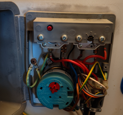

  10. Thanks. The boiler is amazing really, esp when combined with the heat retention of the tank. I doubt we've averaged more than 2.2 hours a week of gas for heating the water, and that's a family of four. But when I'm getting 24Khw from the panels and using 10Kwh I really want to heat up what I can via that method! I undid the box thing and see this. It feels like there are two dials - the red one on the blue bit and the small black one at the top right - and one may be setting the temperature before the immersion cuts out?
  11. Thanks, this does make sense. What I stuggled with is why the immersion stops after about 90 mins max (so 4.5kwh maybe) - unless it just does that even if the temp isn't at the set level (as I'm assuming that the middle being hot would mean that most is).
  12. That box is about 40% up from the floor and has one screw holding it in place. I'm thinking of going for it and unscrewing to see what is behind it - I couldn't kill myself could I? Maybe I can change the temp!

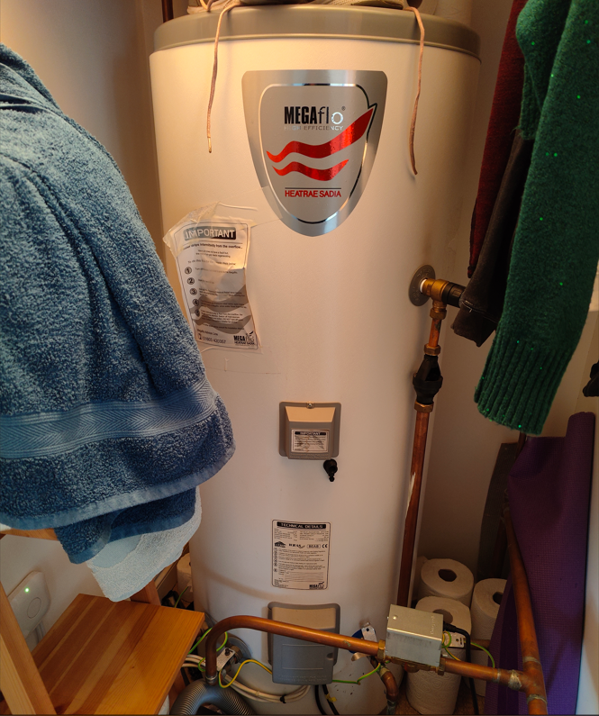

  16. My cylinder is called Megaflo cl210. Overall I've been very impressed with how it keeps water hot, but maybe I can improve this aspect somehow with a longer rod. Assuming I ever hear from the effing installers again I'll ask about this when the diverter is fitted.
  17. Yes this is a good point. I can't see this easily and assume I have to unscrew something, but I'll discuss this when the installers finally finish the damn job and fit the diverter. The water does get hot enough, but going from 55 degrees (say) to 60 would help make the hot water last longer.

  19. I have one waiting to be fitted, but when I switch the immersion on by hand it draws the 3kw for about 60/90 mins but then flicks on and off very briefly for the rest of the day, but the quantity of water heated isn't as much as if gas is used no matter how long it's on for. I guess it just heats the top bit.
  20. Many thanks - re the latter point, this makes sense but I can't control the kids always washing their hair at night etc. It just hacks me right off to give about 10Kwh to the grid in the day but then run out of water water at night! I'll see if I can make sense of the cylinder. I'm still waiting for the diverter to be installed (I'm using the switch manually now) so it may be something I can discuss with the installer as an extra job, esp as immersion heating rods don't cost all that much. I'm generally keen to do what I can myself but this would be way beyond me.
