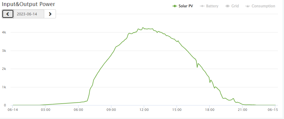

Damn, I do hope that my inverter app isn't dodgy! Cardiff isn't much like south Spain to be fair. These are 10 degree sloped with the brackets + 2 for the roof, and no shading at this time of year. I usually get a peak of just over 4kW for a bit, but decent values for a lot of the day due to the relative flatness. This is what I got yesterday. EDIT - mystery over, I have 12 panels and not 8! -

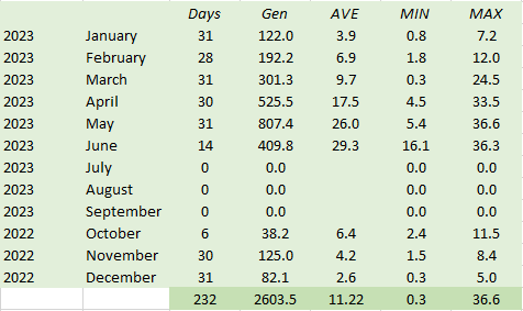

I have JA 410W panels also I like pointlessly showing charts, so here is what I have so far (install on 25 Oct 2022) for my 8 panels on a flat roof. May/June 2023 look a bit freaky and way more than most years but I'm hoping that splitting into two series will help a little bit in the winter months, even though now the sun is high enough that there is virtually no shading. -

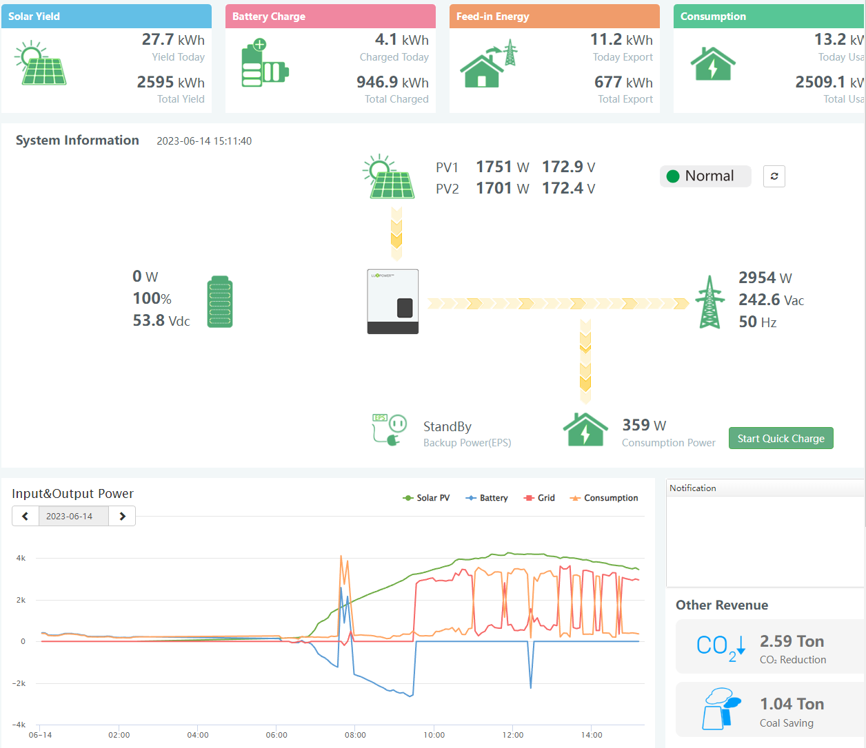

Thanks very much! Re re the CT clamp test, I may need to put loads of things on as the battery would be used before the grid (though I guess there would be a tiny draw first)? To be honest, it's pretty clear from the manual and labels that it was the wrong way around. Even I can tell where the meter is and there is an arrow pointing towards that. It seems to be working as it should as far perhaps as the excess in concerned, but I'm still not sure about the over ride. This chart shows me flipping the clamp at around 11am. -

Edit - I'm almost certain that the CT clamp was the wrong way around, so I've switched that and the inverter app now shows high consumption. The diverter still says "water hot", and the "solar heating" has gone from 0 to 2.5kWh - none of which really make sense but at least it's progress I guess. -
Seems like an odd question but I'm trying to understand what is going on. I had a diverter fitted yesterday (NU Vision) and can't work out if it's doing anything! It says "Water hot" so I think it's incorrectly thinking that the immersion trigger (70 degrees) has been reached. Thought it does seem to think that something has been "saved" today, thought the "heating by solar" is zero. This part is probably just not working. But, yesterday I pressed set the override for 90 mins. The consumption in the app looked OK, with a spike of ~3kW, but then dropped back and flicked up and down a bit. This is what happends if the water really is at the required temperature but it had been a day since it was heated so this didn't seem right. But, we had four showers last night and the water was piping hot. In addition, the diverter reckoned on 4.5kWh being used (which would be 1.5 hours x 3kW) thought this could just be a mechanical calc I guess on what "should" be used rather than anything else so I'm a bit dubious about it. I was assuming that the CT clamp trigger was irrelevant in that when it's on it's like any other form of consumption when it's actually heating water, but now I'm wondering whether these things can mess up the data in the app? I assume that solar generation is always going to be accurate but I wonder about the other stuff.
