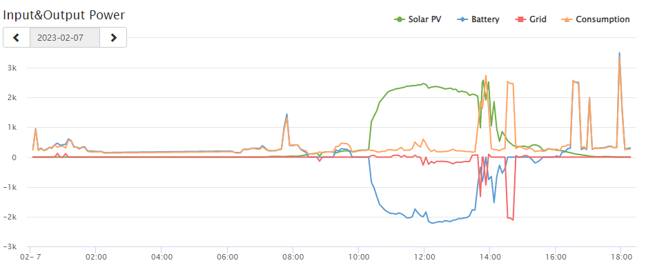

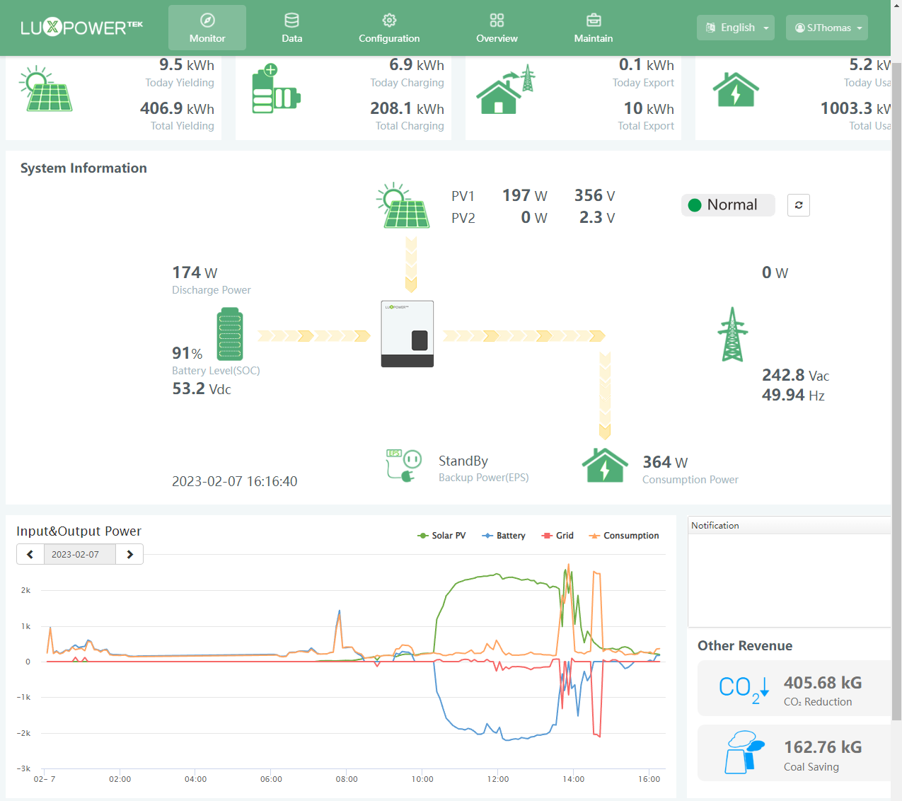

  11. It seems like I can't look for a firware update myself? I've Googled it and they talk about contacting the installer, but if I can't get a reply from them now even with some cash outstanding I'm not sure what response I will get in a year or two! I've just used the hob again, and a few other things in the kitchen, and the meter says 0.1k1 import so far today and the inverter says 0.2kw import so I guess that's a good thing. Maybe it was a quirk but I'll keep checking the meter.

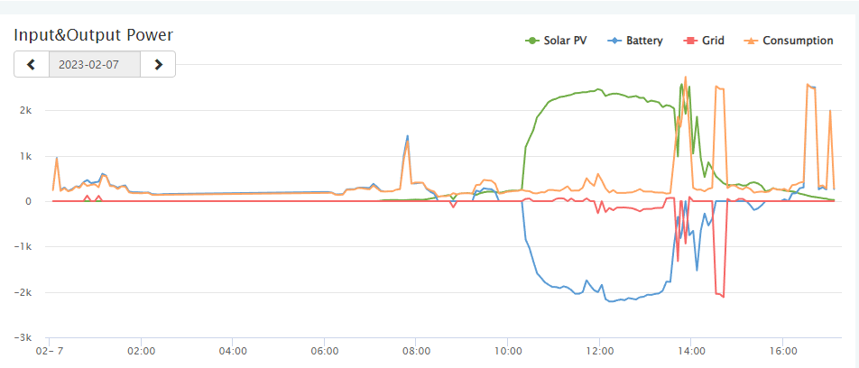

  14. Funnily enough, the spike at 2pm was when I was cooking and part of that was using an electric hob that we just never use. We use the gas hobsusually but I thought I'd use an electric hob as I knew I'd have excess today. It's probably over a year since it's even been switched on. I think it's an induction hob in that it gets hot very quickly and seems to click off if there is nothing on it. I just did a test now and put it on for 5 mins, and the spike seems to be covered by the battery. Could the type of appliance make any difference?

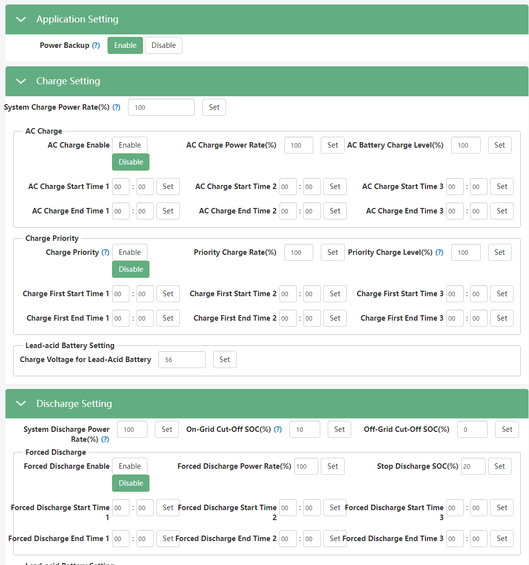

  17. This is the battery (actually it's three x 3.2 kwh). It can go to zero and I assume that nothing bad will happen if it does get set to zero? On the grounds that they haven't said otherwise!

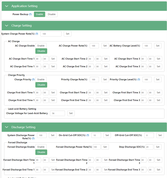

  18. Thanks, I never noticed that button before. Now it looks like this. Maybe the "On-Grid Cut-Off SOC(%)" needs to be set to 0 (from 10)?
  19. PS I just used the pizza oven and microwave at the same time and this all seemed to come from the battery!

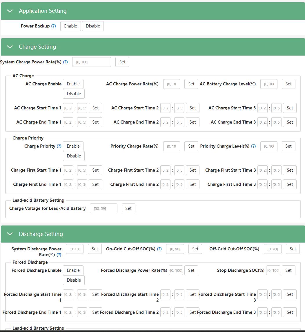

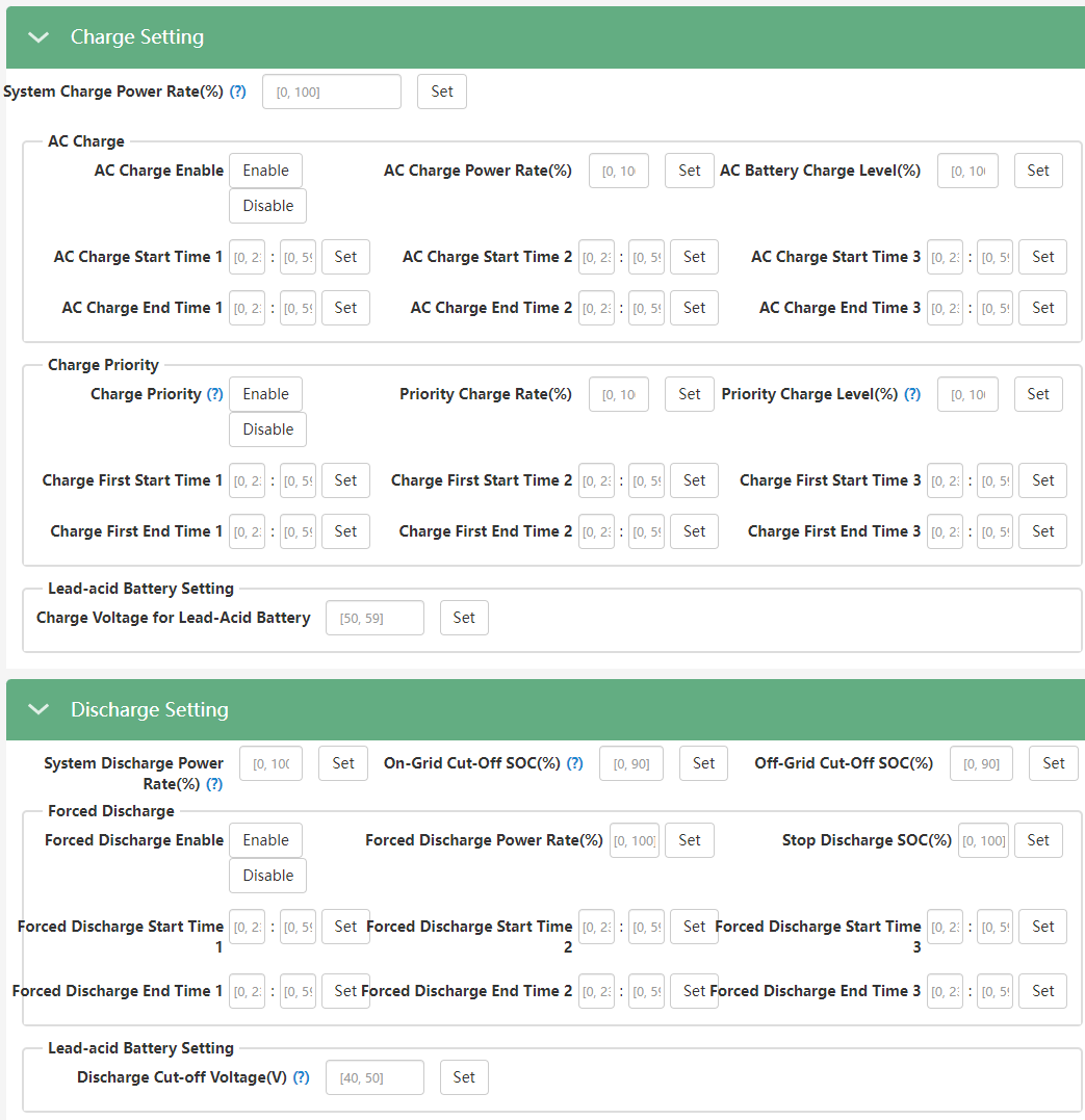

  20. Thanks, the only settings I can see are below. I think that there are all default. I really want to change the battery to run down 100% also as it can, but I can't work out how to do this. It looks like the "On-Grid Cut-Off SOC(%)" field maybe, as it says [0,90] but I can't change it to [0,100] as it doesn't accept it. I've asked but it's just so hard to get anything back from the installer.

  23. Thanks, I wondered about that but the draw didn't seem all that much and wasn't for that long. A later snip is below and the later draw seems OK as the battery is used then. Next time I'm going to cook in the day I'll take a photo of the meter before and after to be sure. Re the max battery draw, if it's 4kwh max output and solar is generating 2kwh then can you in theory use 6kwh without needing the grid?
  24. Hi all - I've had my system since 25 October, and with all the sun this week I've been looking at the figures. I get that you always get small imports from the grid, even if it in theory doesn't need to happen (as the battery + solar have enough power), but today the figures look odd. The data as per the snip suggest that I've imported 1kw today, but there has been lots of solar and the battery is almost full. This looks like it was mostly between 2pm and 3pm when I was cooking, but shouldn't the battery have been used then? Can I also check my understanding of the figures that the inverter produces: I'm assuming that the generation will be correct (as everything flows through the inverter), the battery figures are probably accurate, but all others are only estimates? It beats me how the inverter knows if I'm using a hair dryer in a bedroom as it's in a garden room, but it seems to have some idea. The inverter figures don't quite add up in that they say: solar 407, import 669 and consumption 1003. Even allowing for efficiency this makes the import look too high for that consumption but the actual import (as per the meter) is about 579, so way lower than what the inverter says. Saying that, I think that there was a draw today but maybe I just need to keep checking the meter as it's the only way I can know what it being drawn (it's not a smart meter). Overall it looks good in that I'm averaging 5.6Kwh import from the grid from 25 Oct to now which seems like about half (if that) of what it was for the same period last year, but I want to make sure I'm not missing a trick for the summer. Another aspect is that I think the battery is set up to only discharge down to 10%, though it can go to zero. The installer said that it was just set up this way to make sure it works and then it will be changed, though I suspect that this was just the default setting and they didn't change it. I've asked but it takes weeks to get a reply so if anyone has any clue how to change this then that would be great (see the second snip)! I've tried changing the 0,90 inputs but it doesn't seem to like it. Thanks in advance!
