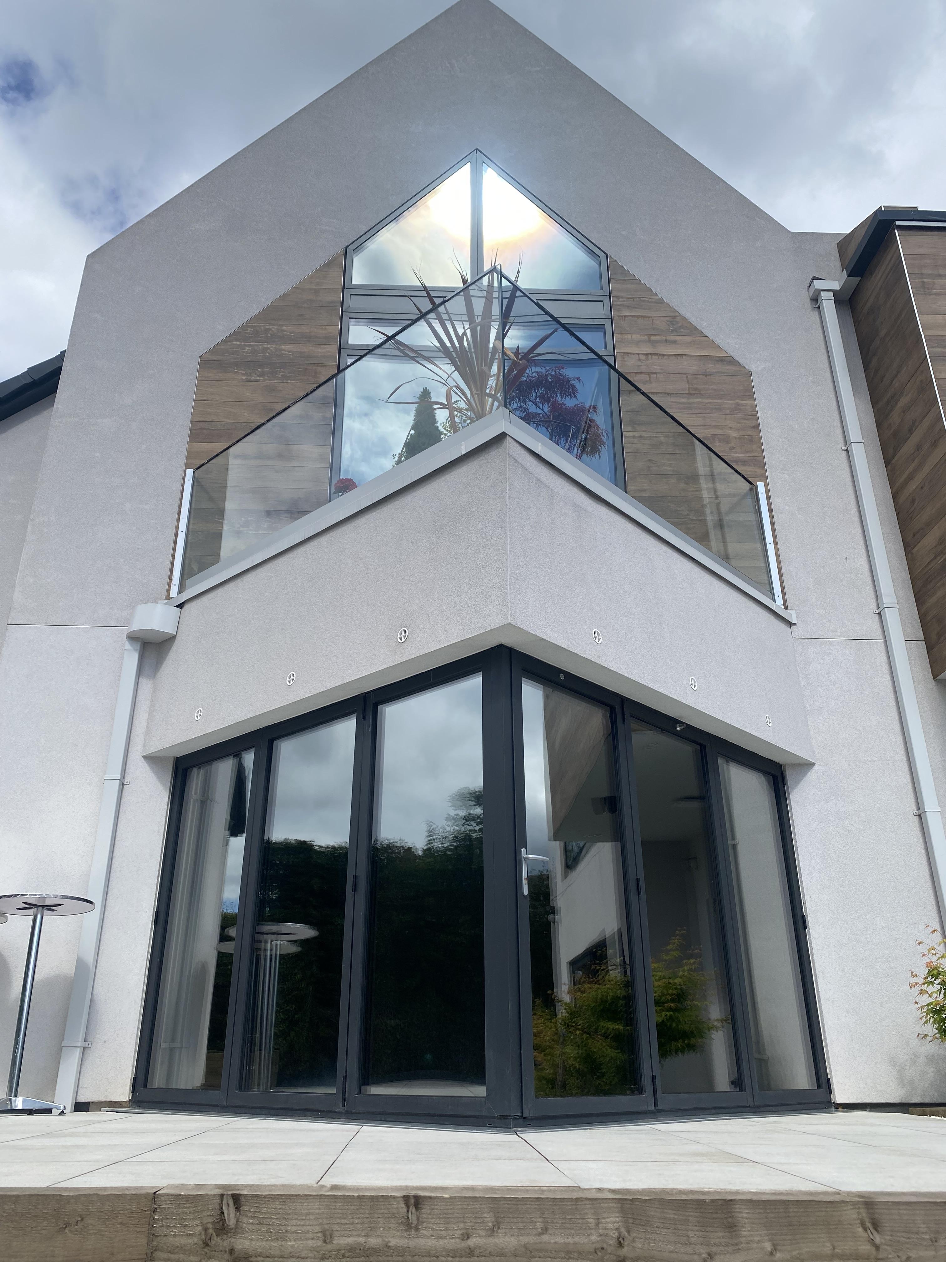

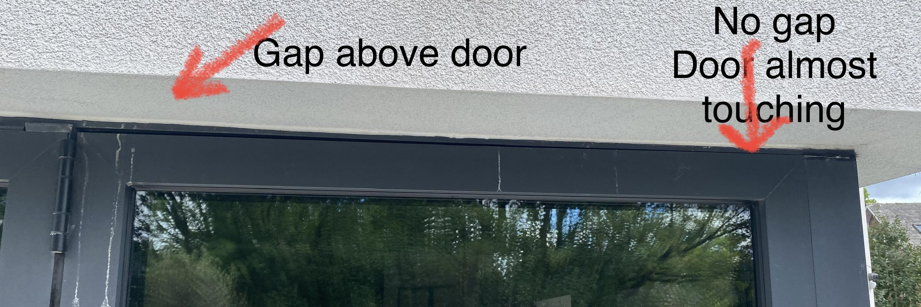

Hi Simon, Can I ask where it says about MBC guaranteeing a 2mm deflection on the openings and how long this is guaranteed for? MBC did ours. 2019. (Very happy overall). But we're struggling to open the corner bi-folds and the contractor who came out has found the corner has dropped 10mm. Thanks Lauren -
