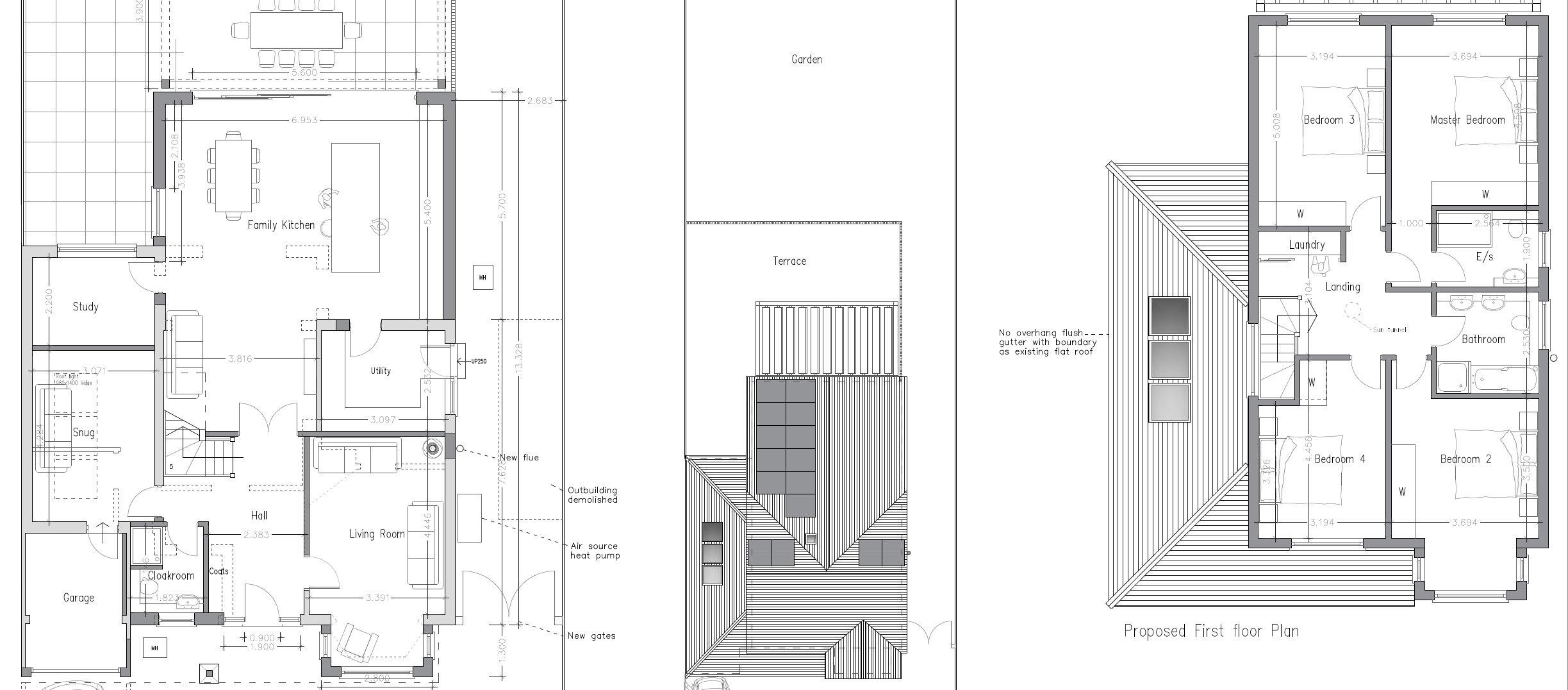

  9. Hi, Yes, we're aware of the Bedroom 4 "wardrobe" - likely to be the spare and become the laundry cupboard. On the back - don't really disagree it's more for the volume. If we do do the stepped back 1st floor, is that likely to be much more ££ - I guess it needed another steel in and support?

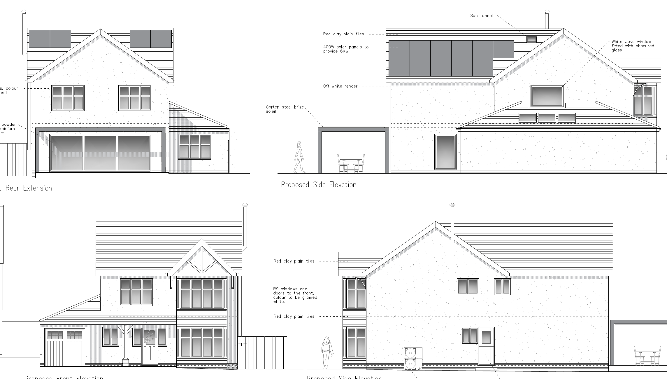

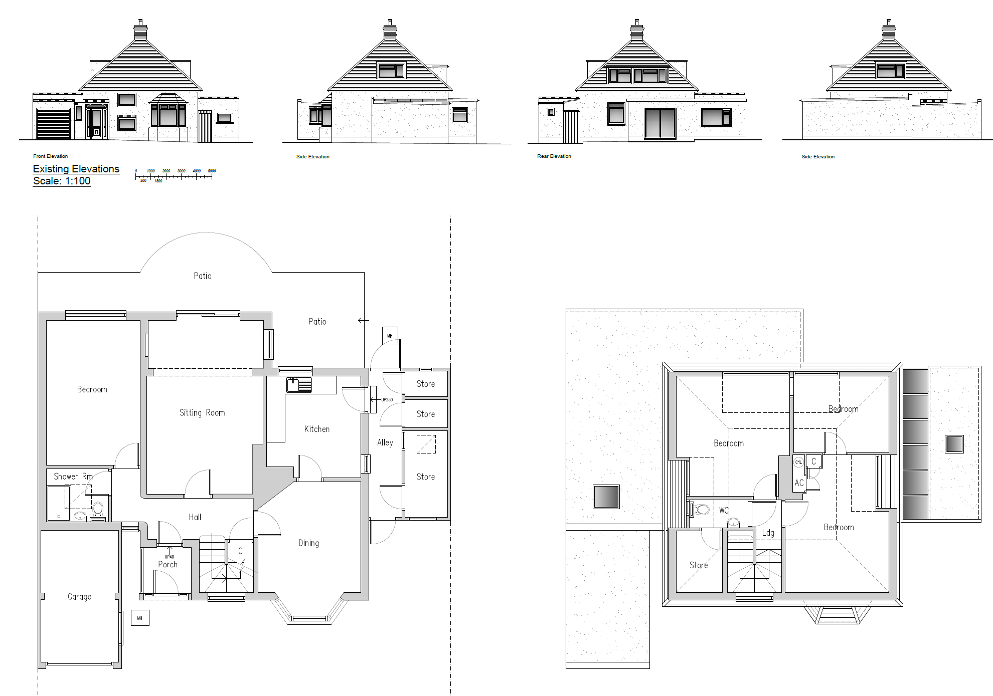

  11. Hi, We've put in planning, it's taking a 1.5 storey house, putting a second floor and roof and 2 storey extension out the back with a gable end. Width wise it keeps the same as the current house, just extends back Current house Planning We are asking to extend 4m (2 storey) from the current back of the house (6m from original) We've reduced the garage to line up with the bay and put a porch across between them We've added a pitch roof on the side to replace a flat roof Overall, it will be more volume with the 2 storeys, but actually not that much extra footprint The PO has come back via email with about 6 points, some I don't care enough about, but the on the volume they've asked: The proposed two storey rear extension is very large and considered somewhat disproportionate. In addition, there is concern about over dominance to neighbours. Could this be reduced in depth by at least 1m please? With 3m to each boundary, and only 4m deeper than current ground floor (and nowhere close to failing a 45' or 25' rule) - is this the sort of thing you can say "no" to? upstairs we could rejig to lose a little depth, but having the downstairs smaller compromises the space we want and having a step would be more expensive. If they put things in those terms, are they usually something you can discuss/haggle over? In addition, the proposed gable seems overly wide and we would ask that this is reduced in width to a maximum of 6m. This is odd to me, as it's literally the same width as the house. We would consider a hipped roof at the back (which would also take off volume from the roofline), but fundamentally it's just the same width as the current house? Also hipped would compromise PV due to angles, is this something you can argue on sustainability grounds? To be fair, they have signed off with a "I know there are a lot of points above but please note that with revisions, we feel that we can support this proposal providing further issues don’t arise." Ultimately, are POs all a law unto themselves, or is there some coding in how they say things (like there is on Ofsted school reports) where "if they say it that way you should argue this way". For this, I'm keen to ask for a site visit (none yet) and talk things through with them. Any experiences I can draw on?
