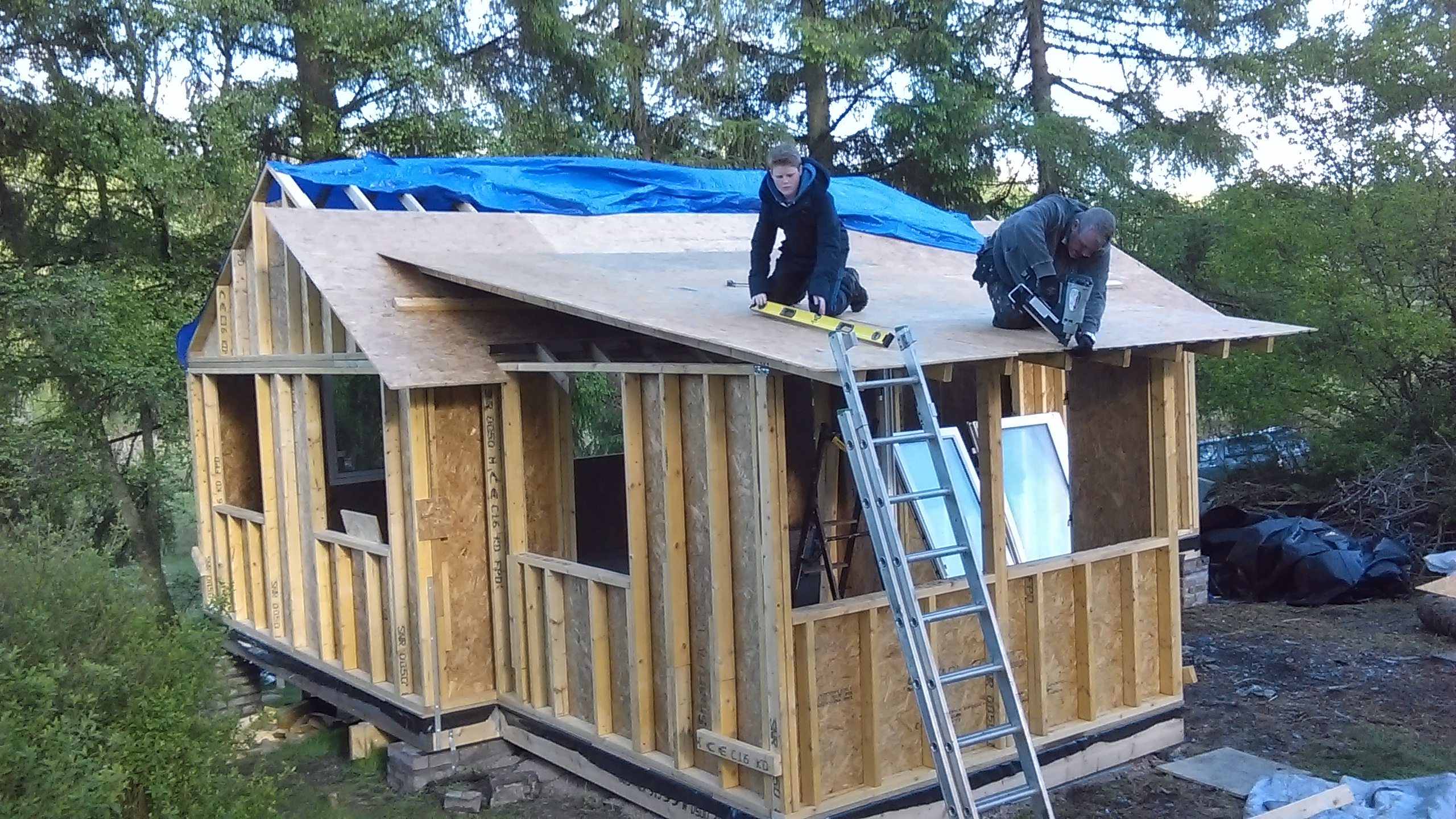

Lots of wet days and rain dripping of noses but a nail gun is a great stress buster for us Social Work types and the wall panels and trusses were complete...time for a big hut raising weekend!
The June weather was kind and we got a lot of work done but the tarps had to go back on as the floor was still getting soaked...
Magic, frame complete
Roof is almost there and again we had 8 volunteers over the weekend...including schoolboy nephews who kept wandering off with tools!
Then end of June saw the EPDM roof being stuck on with the stickiest of glues but close to water proof at last.

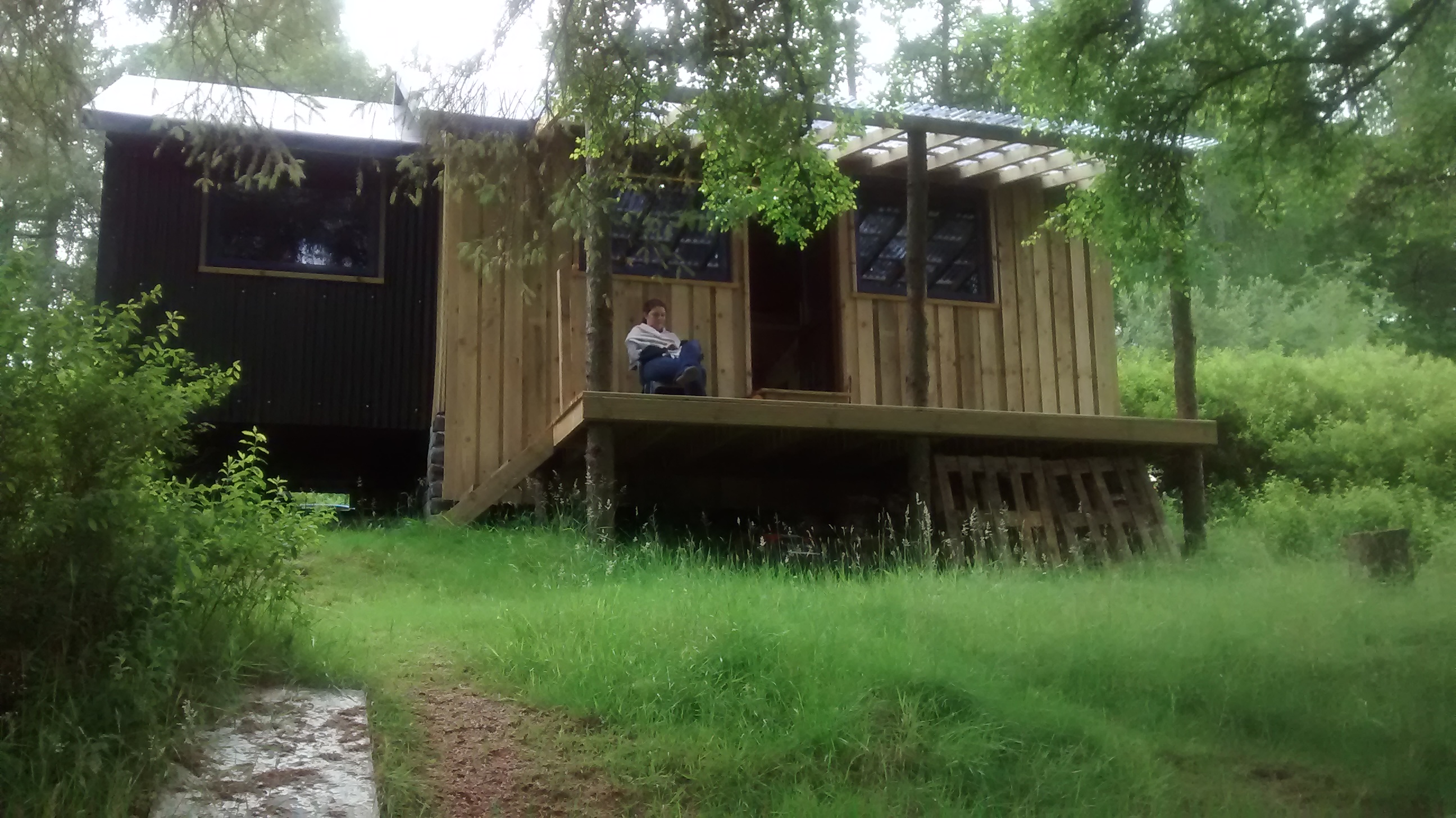

Decided simple was best and to crack on with the decking out front.
Rescued some fallen trees from nearby and rested them against a quickly assembled frame of 6*2 treated joists.
This gave us a nice deck to work on the roof from...
Always keep a tidy site Ebuilders...you don't want a wayward screw sticking into the foot of one of you volunteer helpers who come to play with trainers on!
Bit of good luck, we had one 4.8 length of decking left over so fashioned up three nice steps to the front door. Lucky for us 800mm wide was just right.

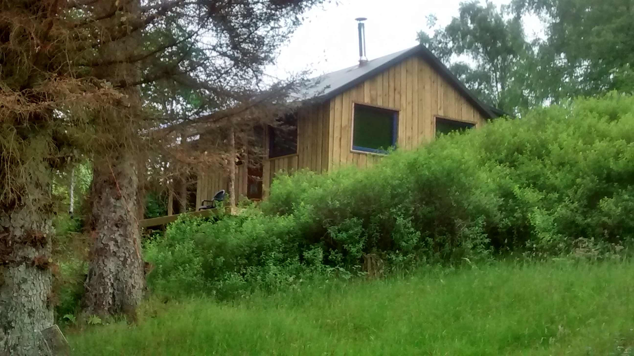

Exterior views
