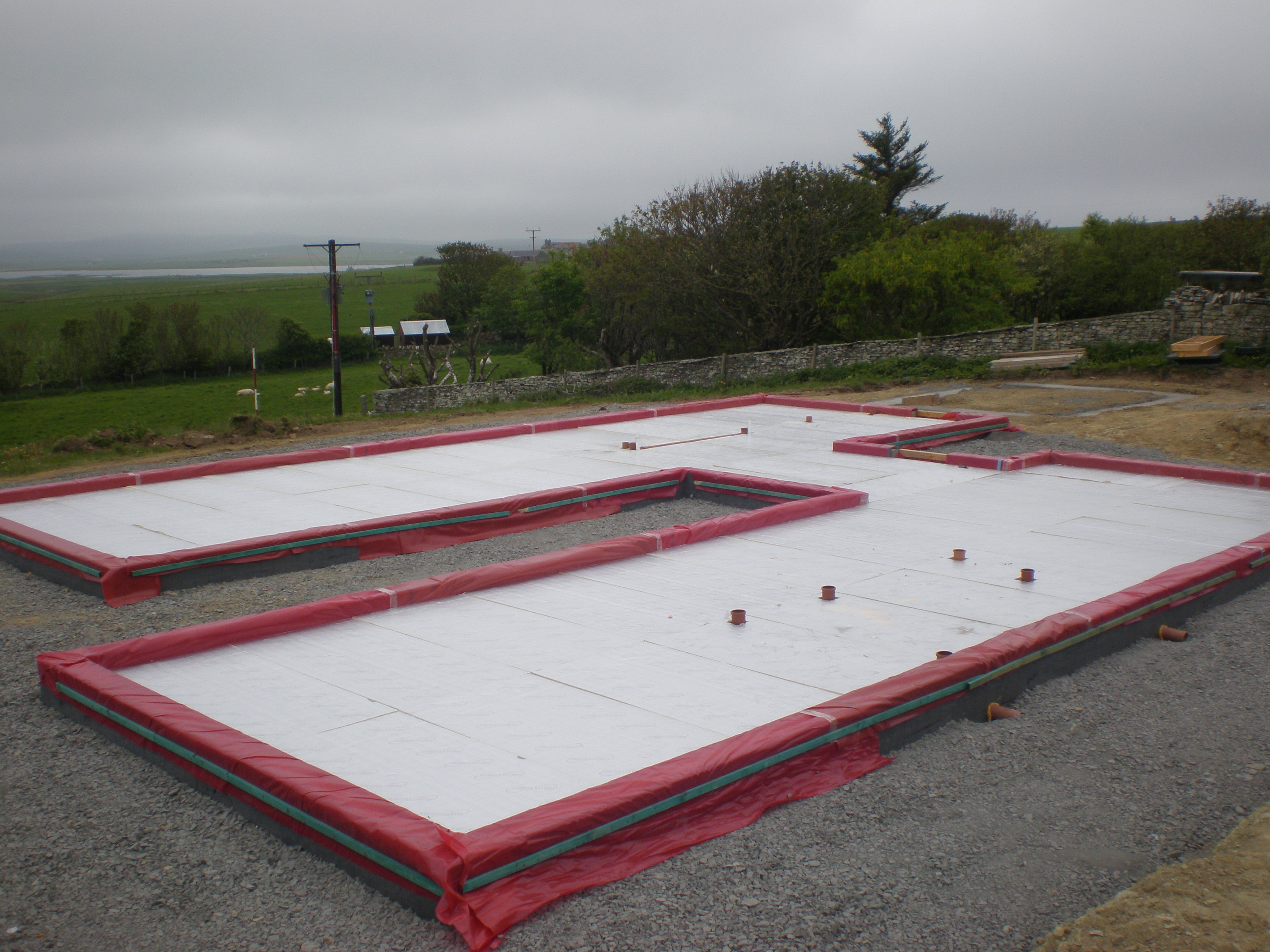

Another week of hard work by the builders and the foundations are complete.

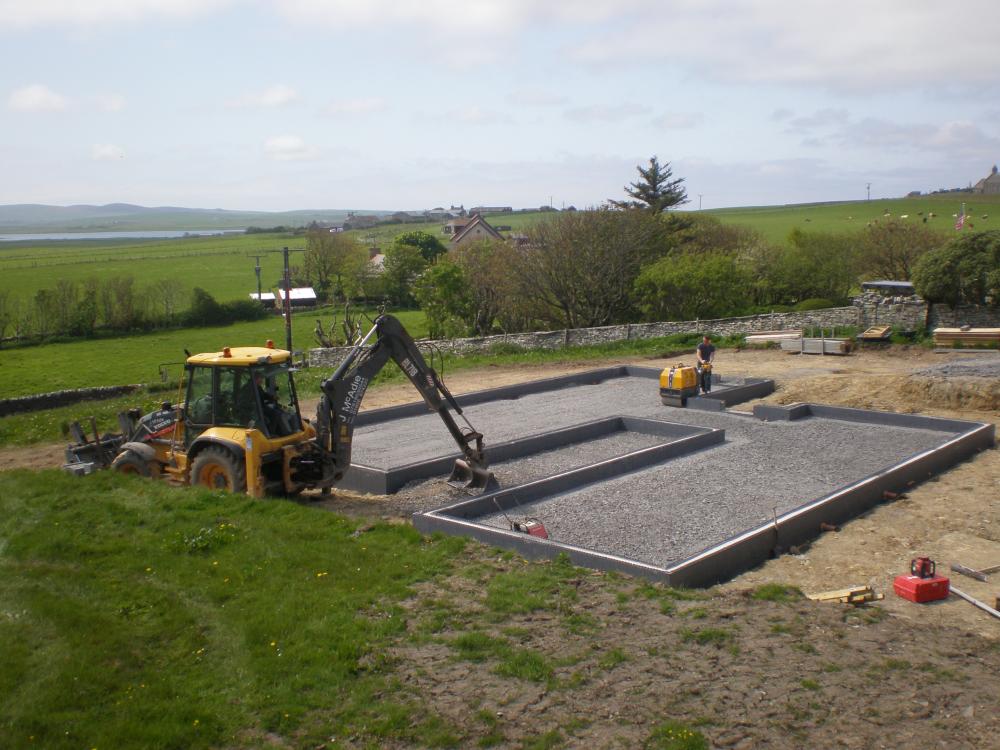

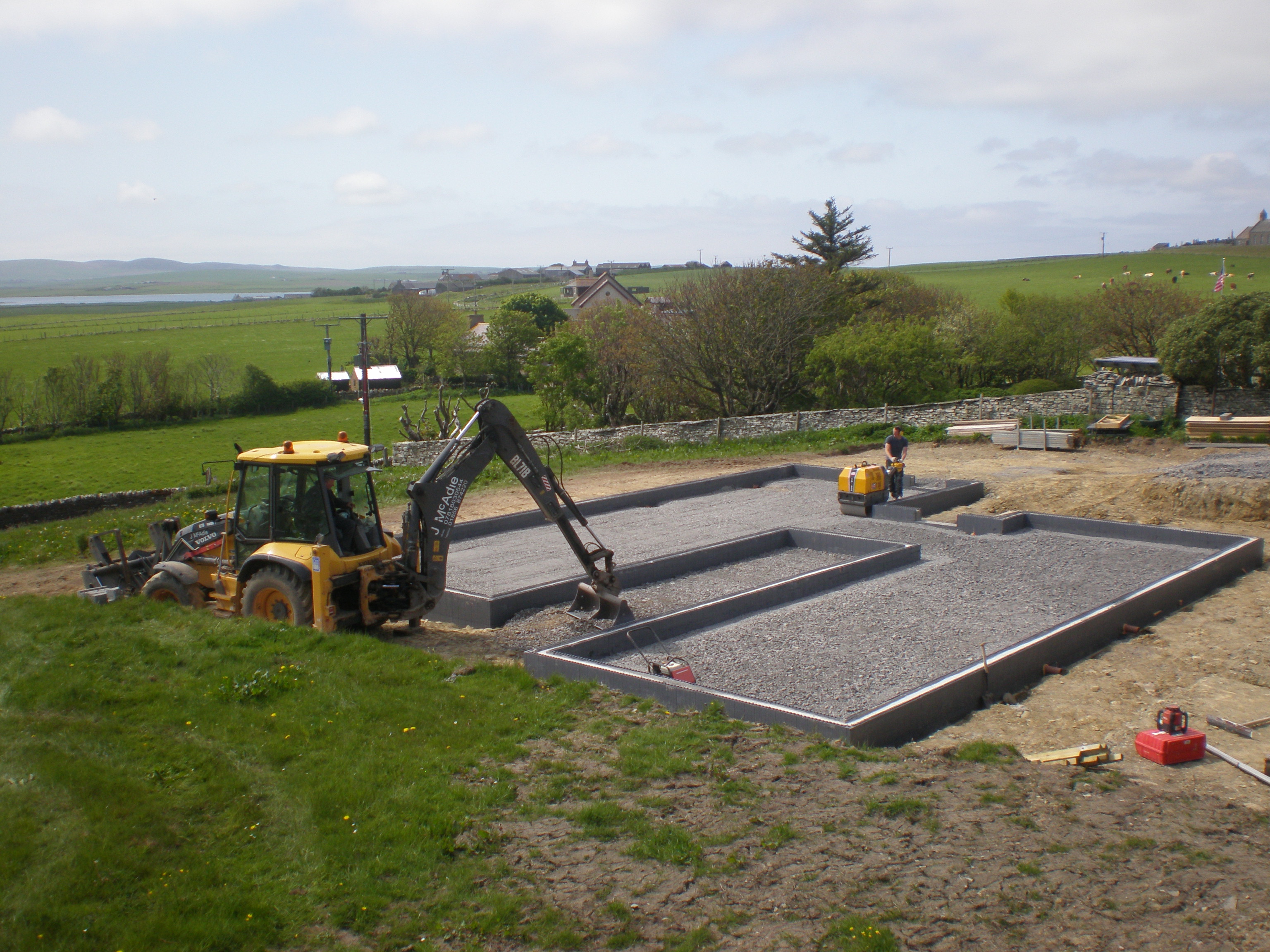

Type 1 up-fill (only 100mm or so required) was spread then compacted down with a vibrating roller.  A final layer of quarry dust was added to finish the blinding.  In keeping with previous comments about a clean and tidy site, you can also see the digger spreading type 1 around the foundations.

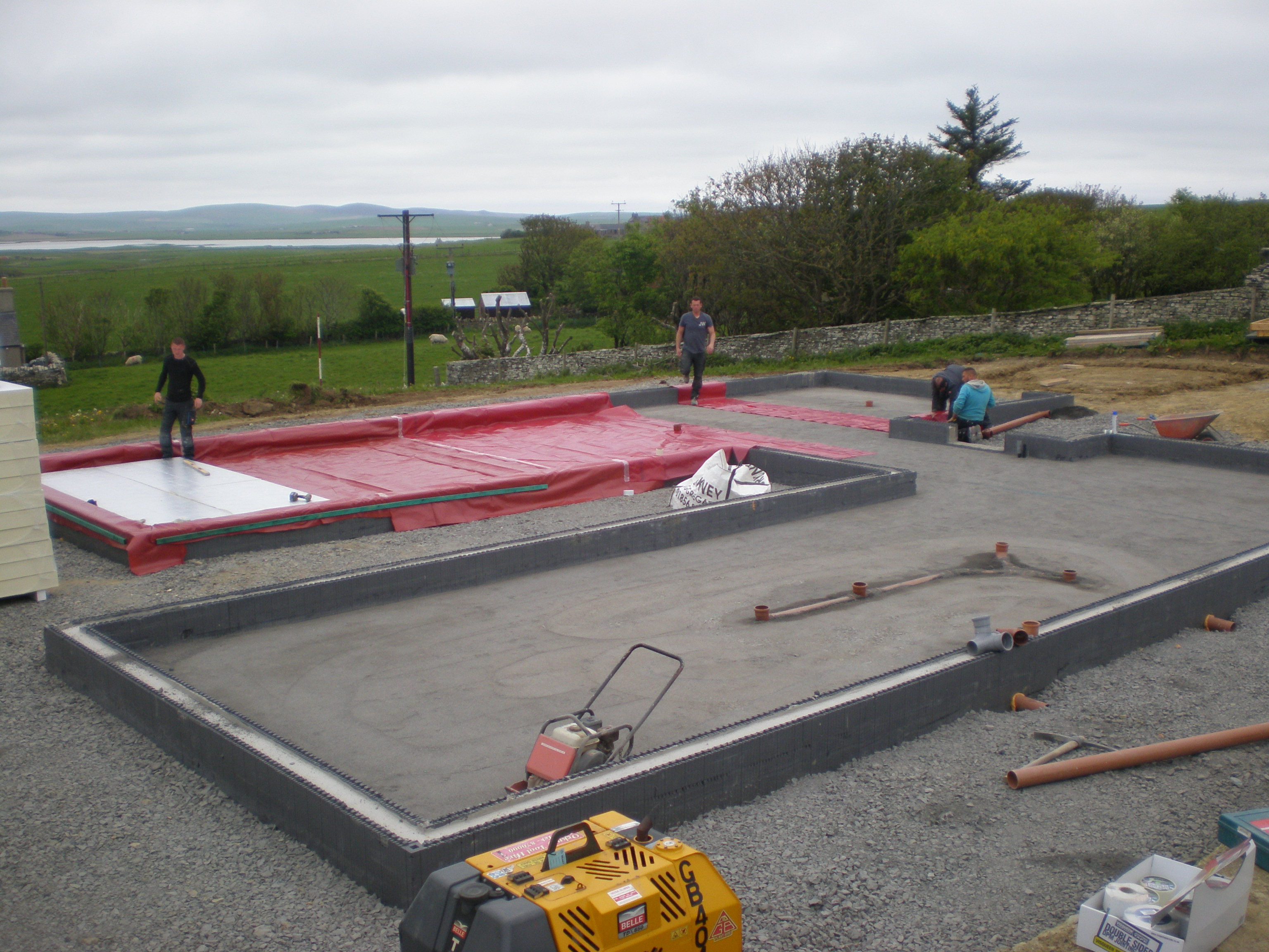

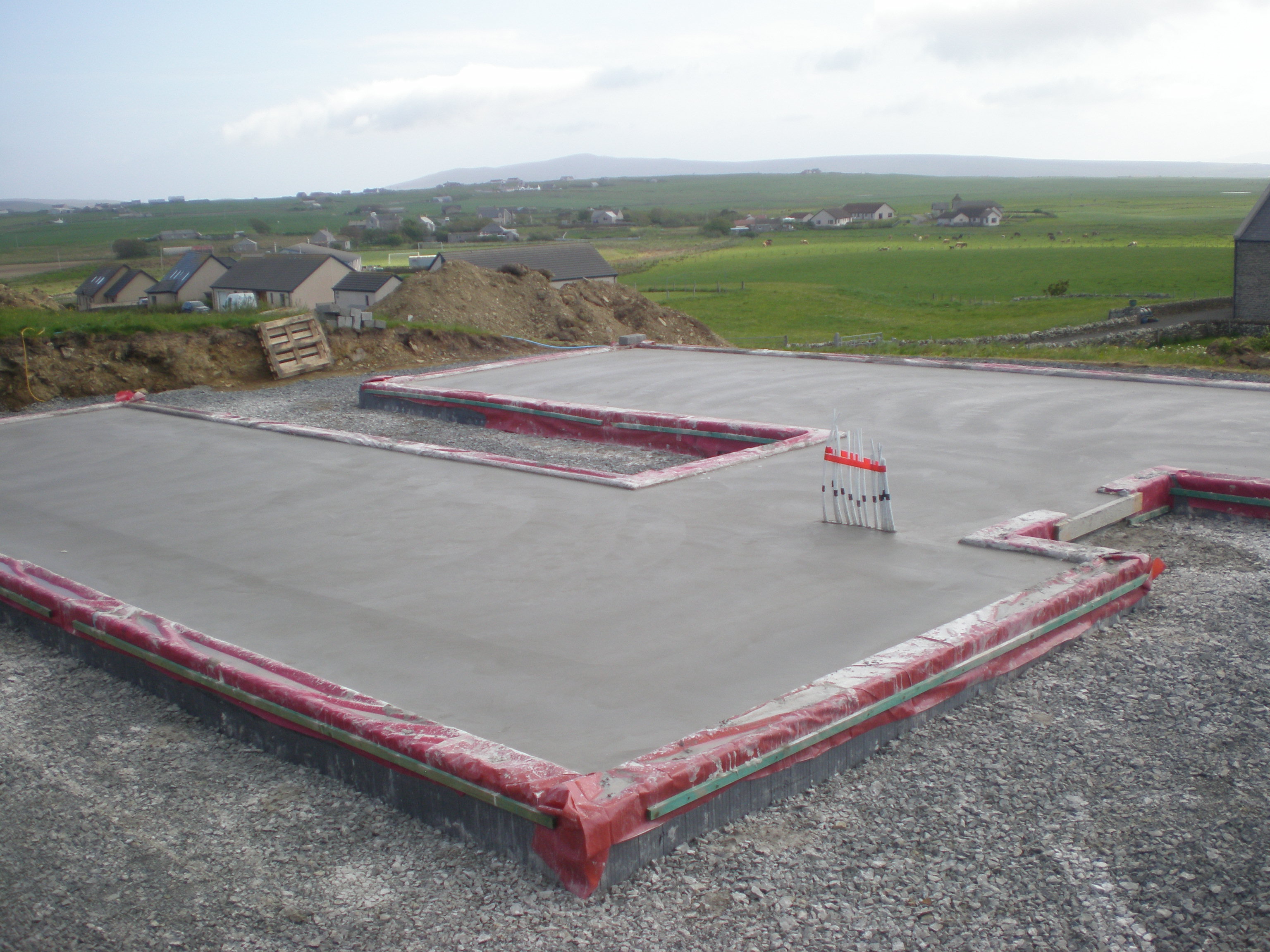

Internal drains and ducts are added, DPC / Radon barrier laid and 150mm PU insulation fitted.

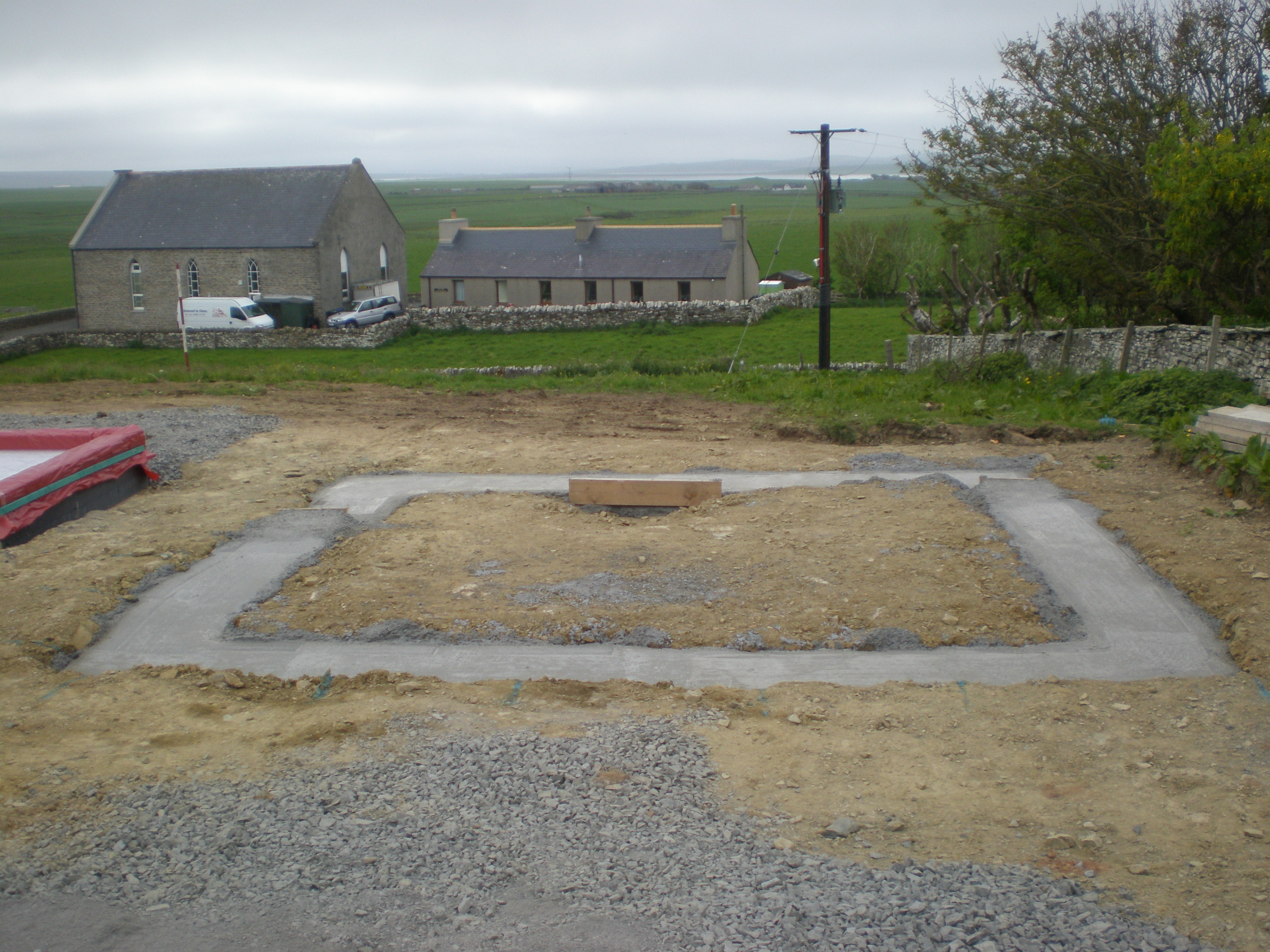

Whilst doing all this, the concrete wagon stopped by and the strip founds for our garage were put in.

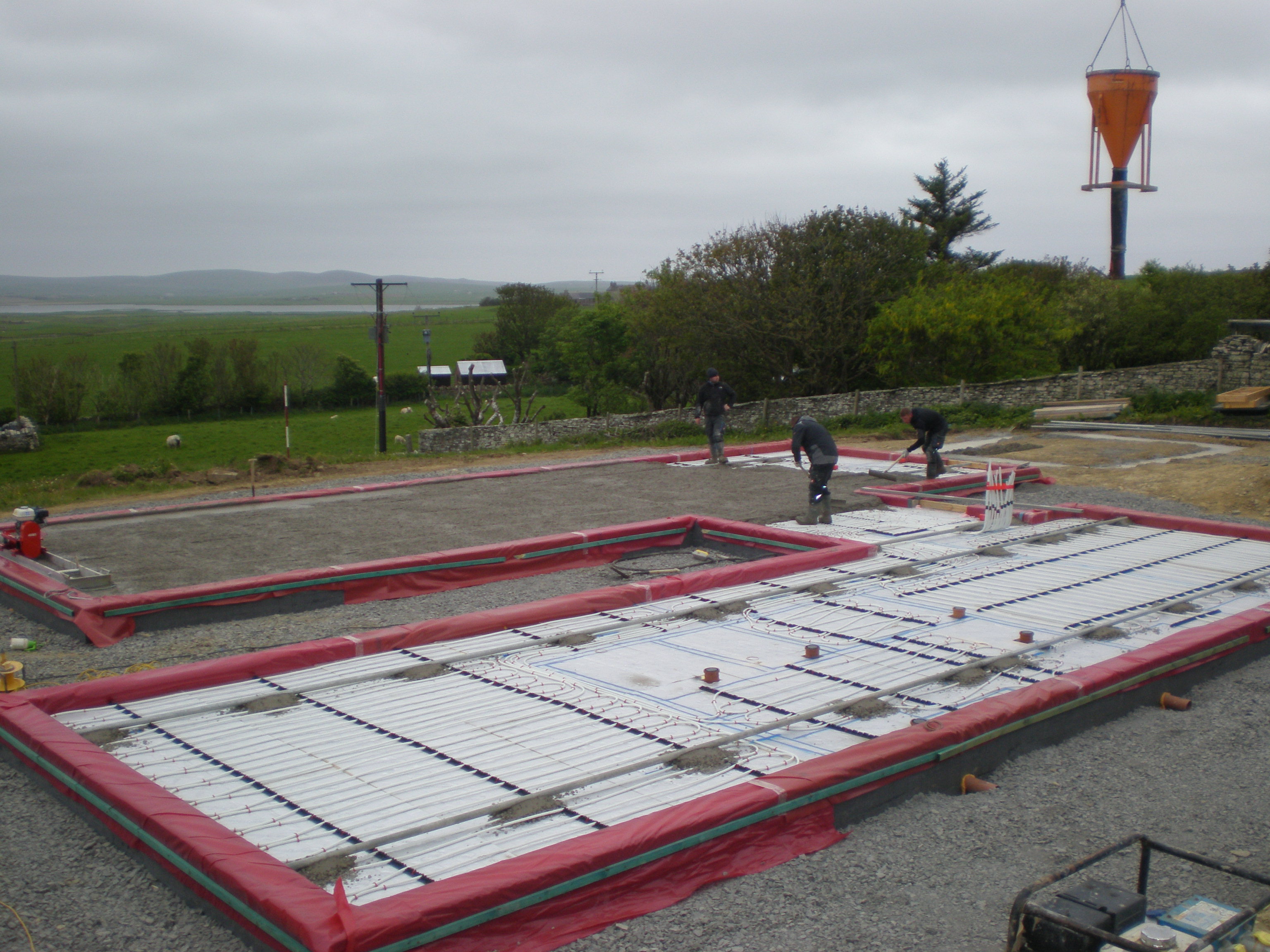

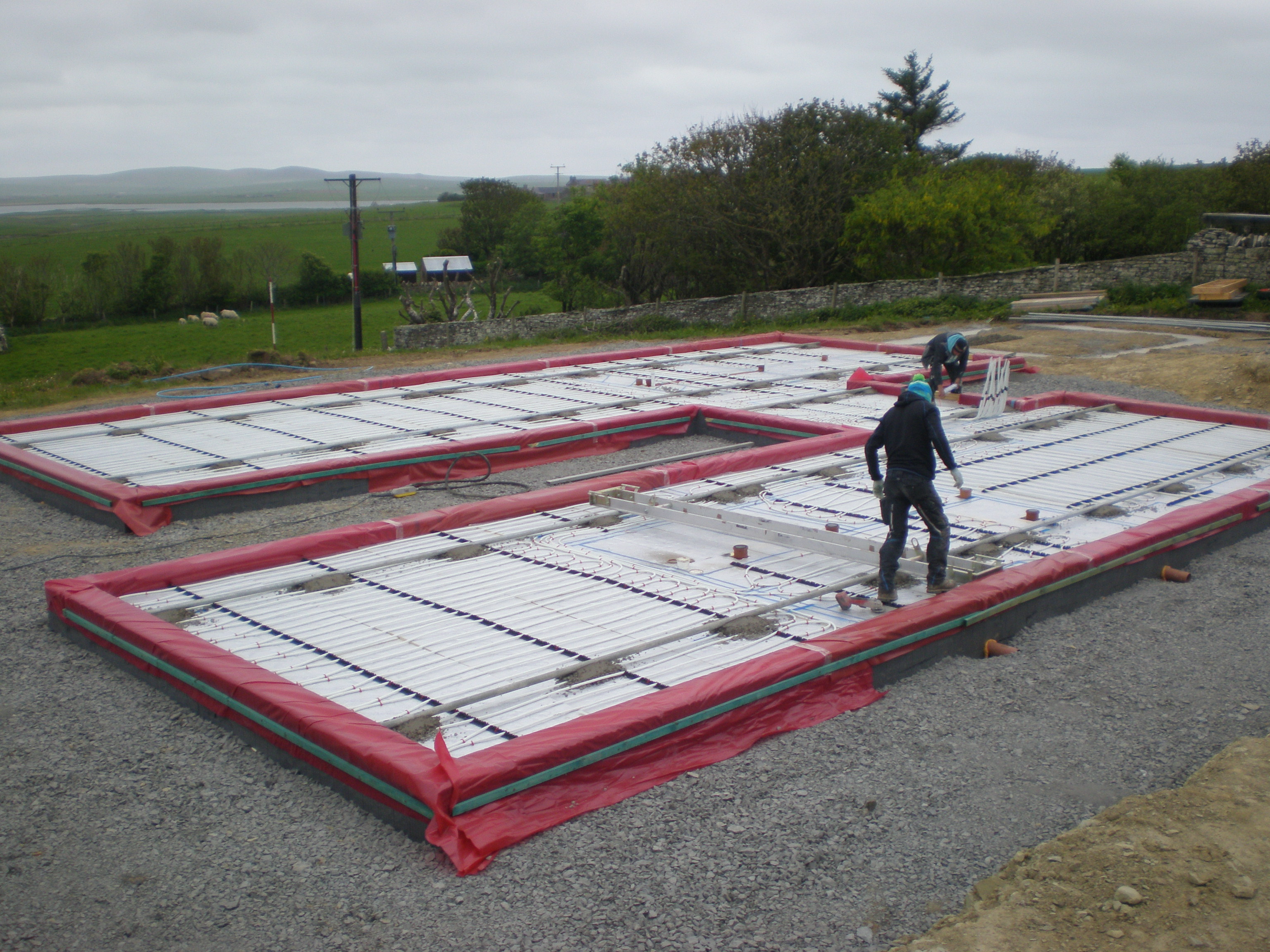

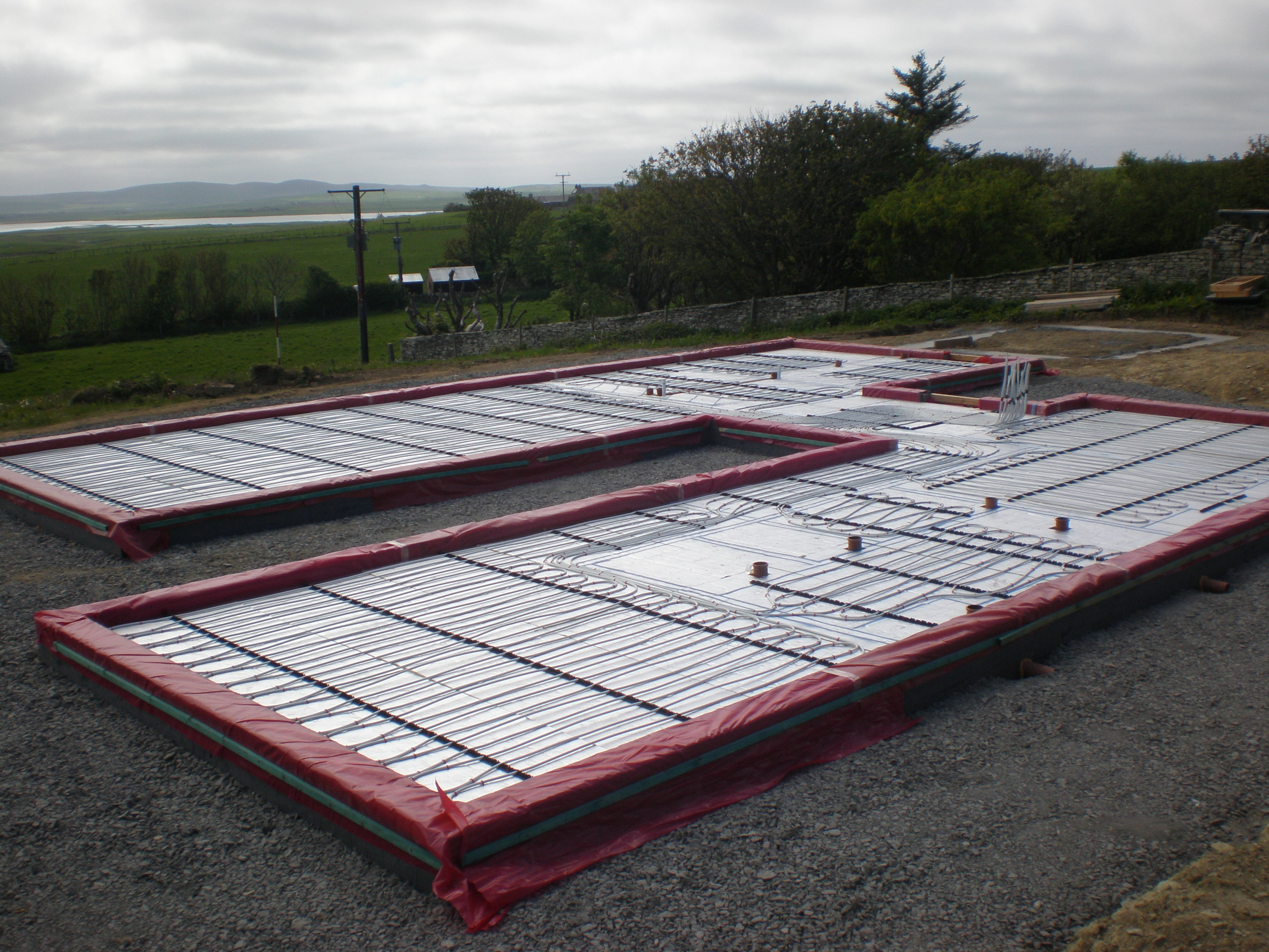

The plumber subsequently put in the UFH pipework, over 1 KM of it!  A track system was stuck down (black lines you can see) onto the face of the insulation and pipework clipped in. Individual clips direct into the insulation were used where required.

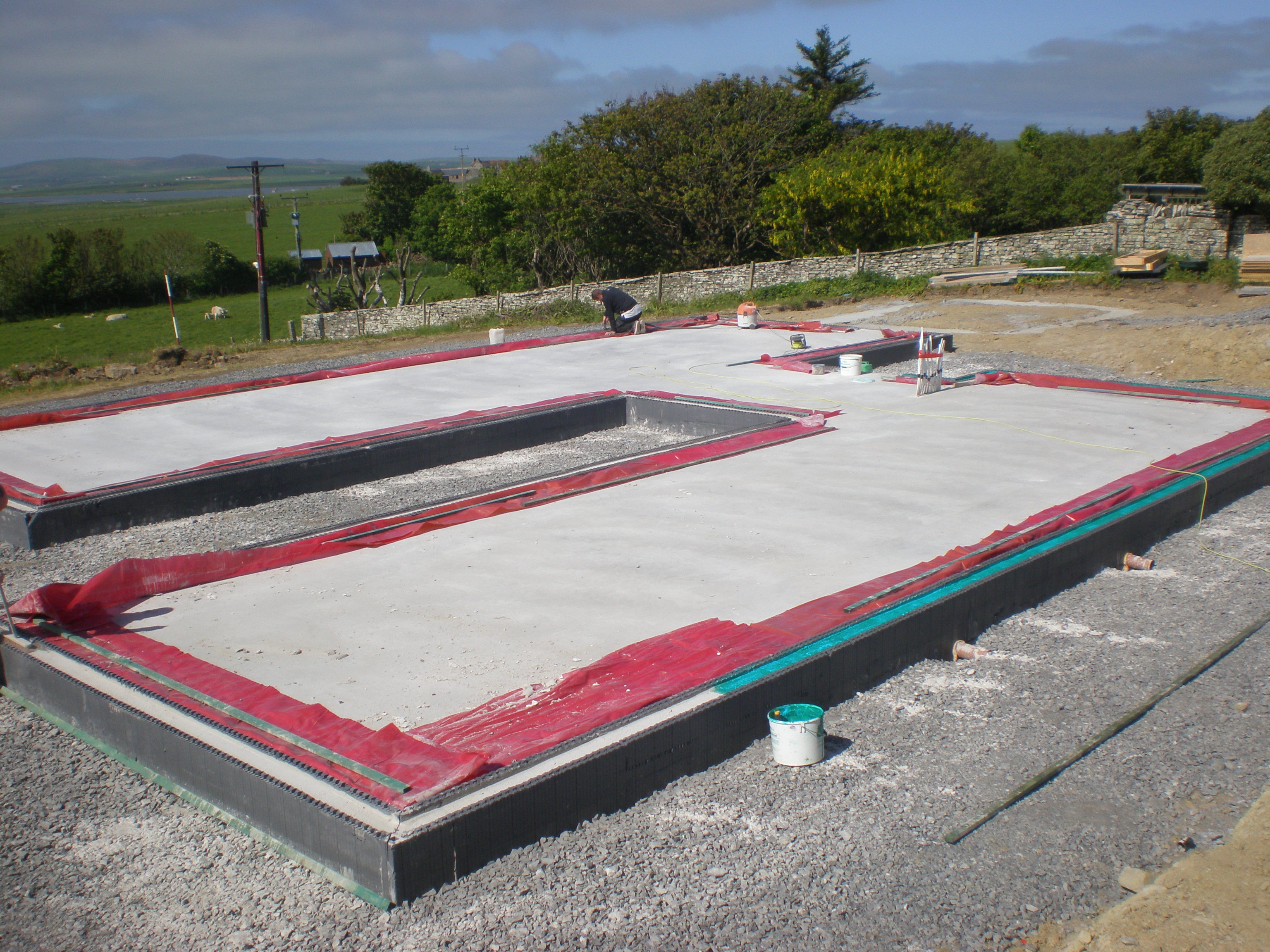

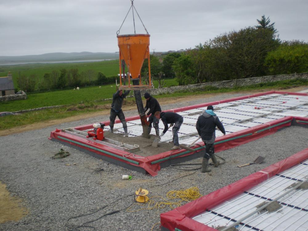

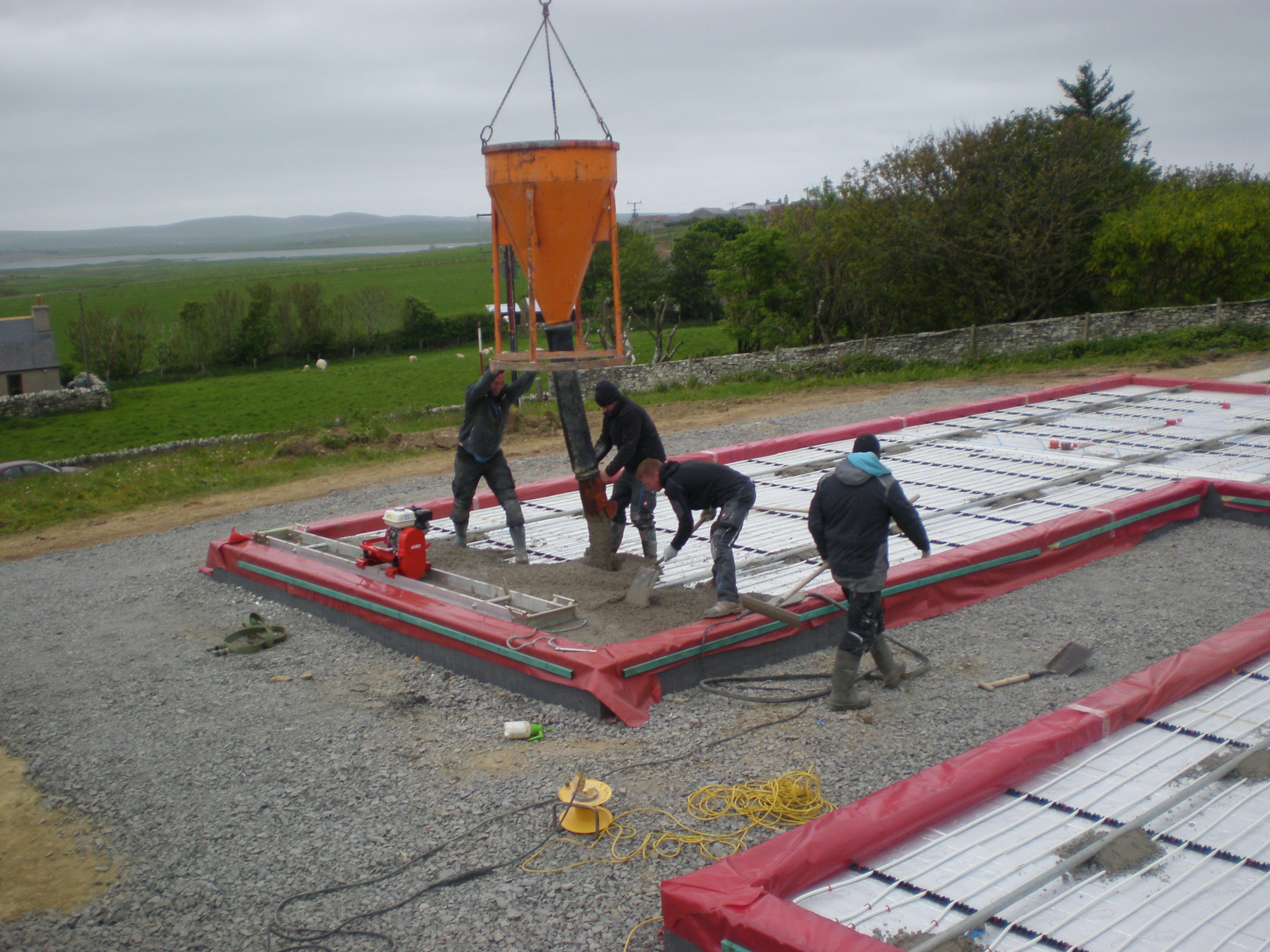

The following day, an hour of light drizzle forecast, the main concrete slab was poured.  Two wagons and just under 14 m3 of concrete with glass fibre mixed through.  Again, a concrete skip and crane were used to move the concrete from wagon to foundation.

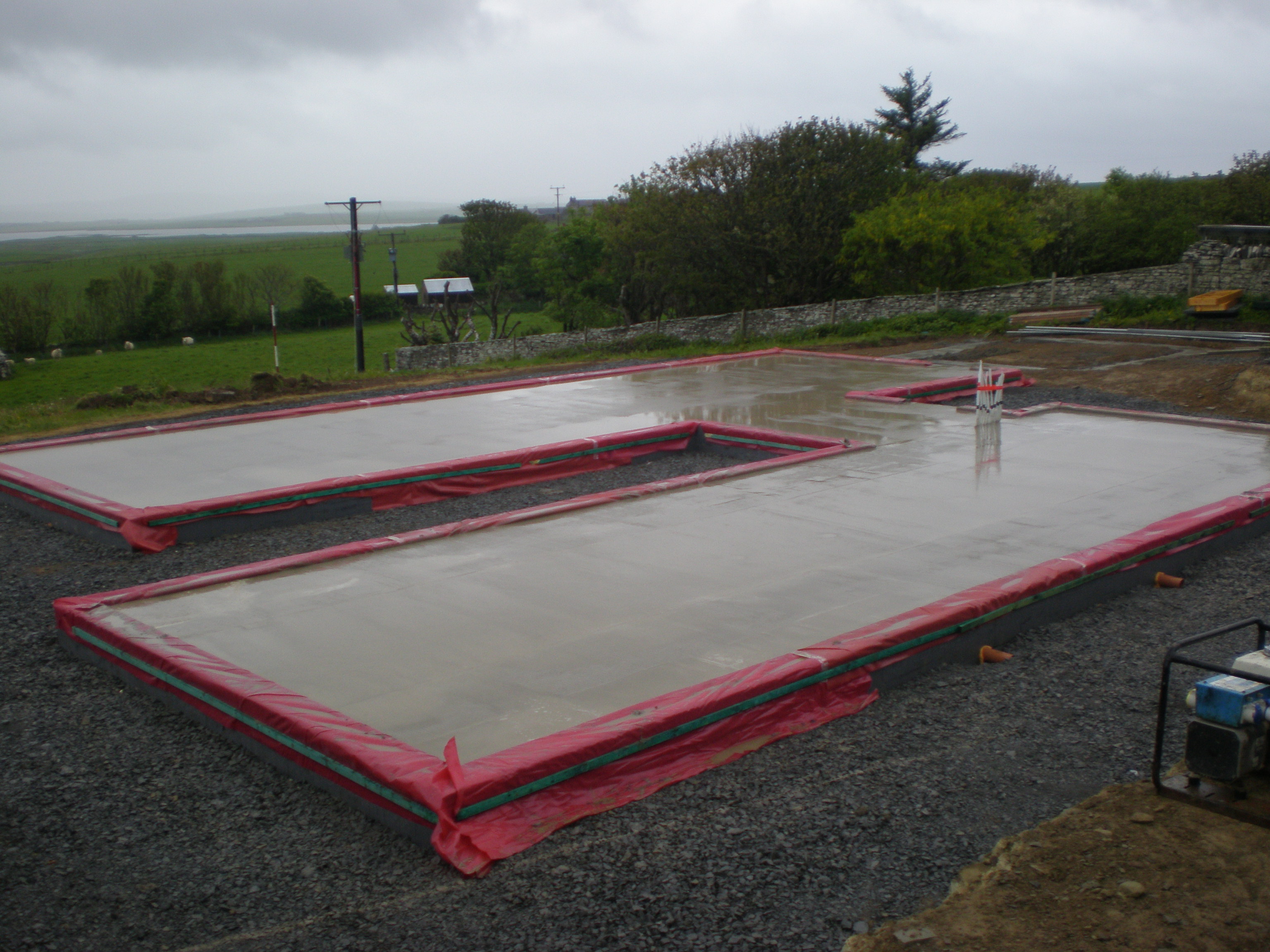

You'll notice the twin (scaffolding pole) rails running the length of the foundation.  They had simply been set as guide rails for the vibrating leveler to run on and were removed once the main vibration runs had been completed.  The next shot shows the slab ready for power floating later in the day.
Unfortunately, it kept on raining which meant a 0430 start the following day for my builder.  He did a cracking job power floating the slab, which is now beautifully smooth and level.
The final stage before building the walls can start, is painting a radon barrier ( the green paint you can see ) on the concrete core of the ICF block.

A very tidy bit of work on the foundation, but where did the drainage and ducting go?

The second picture you can see the drains just visible through the surface of the quarry dust blinding. At the moment they just go through the ICF wall and no more.  All the drain runs will go in once the scaffolding comes down.  In the third picture you can see what looks like a drain in the insulation, this and the white pipe beside are actually ducting for water and electric cables for the kitchen island. Ducts for BT and main electric come up next to the UFH pipes  at the main entrance.
It does indeed look like everything has disappeared under the floated concrete slab. Everything was capped and is just below the slab surface, 1 or 2 mm ( when you are on the slab you can see where they all are) and easy enough to uncover again. Just seems to be the way the builder and plumber do it, I think primarily to ensure the floor can be properly and easily power floated.

I think he means in the 2nd, 3rd and 4th pictures there are drain runs under the slab. but now the slab is poured, they don't come through the surface of the slab.  Is that a "whoops" or are the positions accurately known so you can break through to them later (with the risk of damaging the pipe?)

As per my last comment, covering the drains was intentional on the part of the builders.  All were cut such that they were just below the level of the rail system used for the vibrating leveller.  Standing on the slab you can just see the circular outline of the various drains as they are literally a few millimetres below the surface, so I don't envisage the builders having problems locating or breaking through to them.

Prior to the concrete pour, the guys ran the vibrating leveller down the rails to make sure the drainage pipes were just below the surface.  In the picture below, you can just see the grinder used and a small offcut of pipe where one of the drains was trimmed down.  All of the drainage pipes were finished with a coupling and plugged with rubber type bungs.  The ducts were plugged with a duct tape covering.
