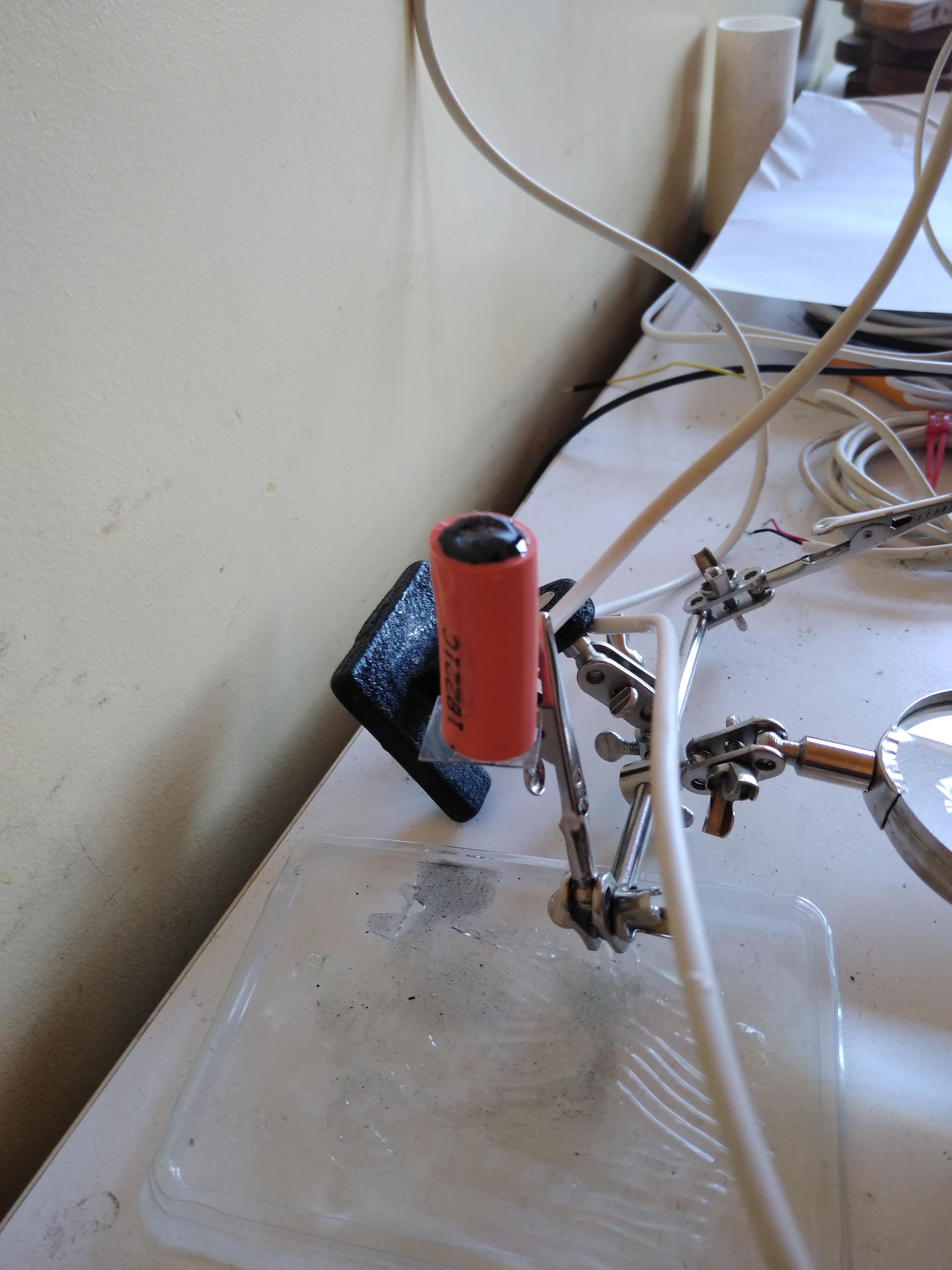

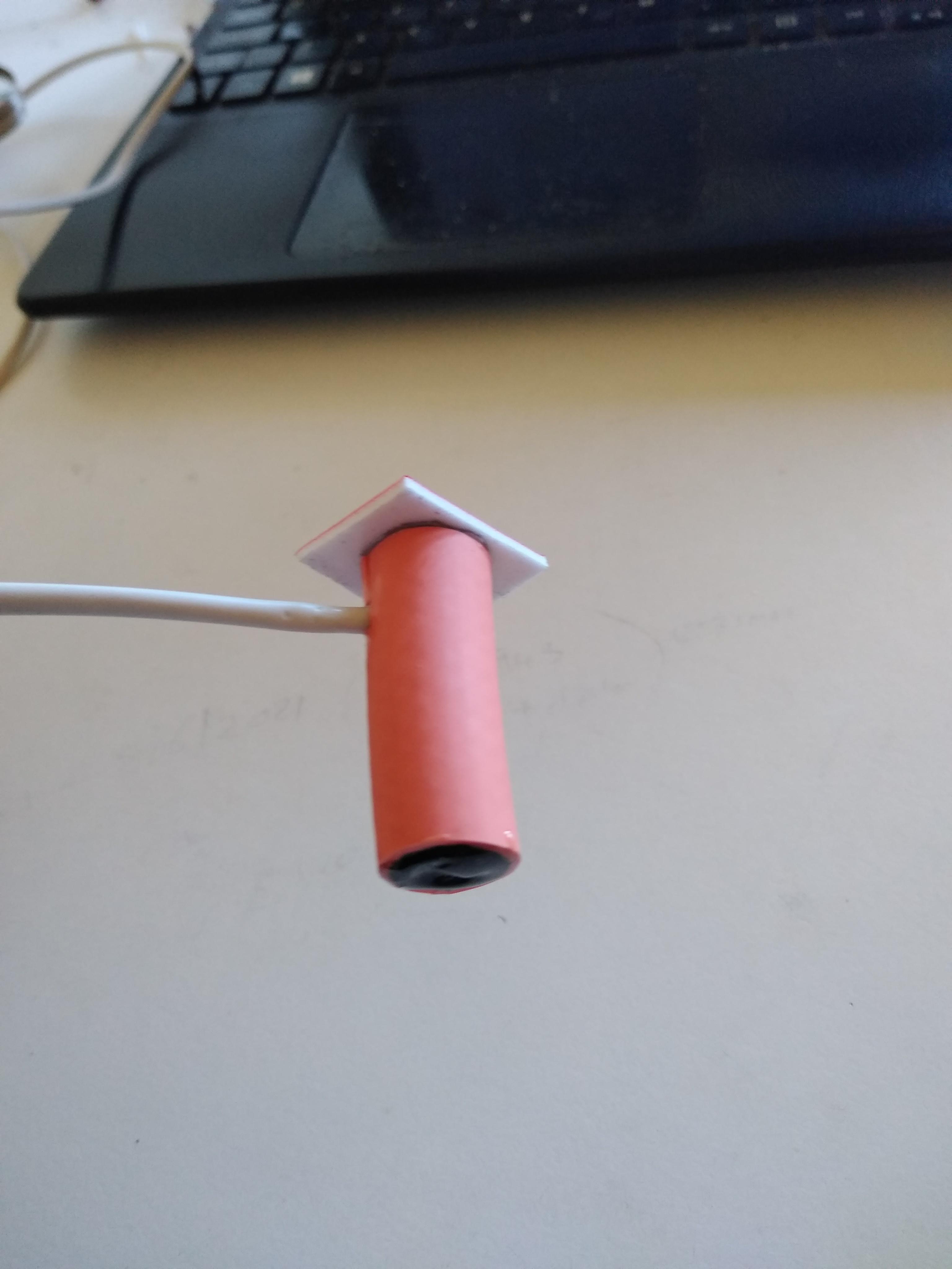

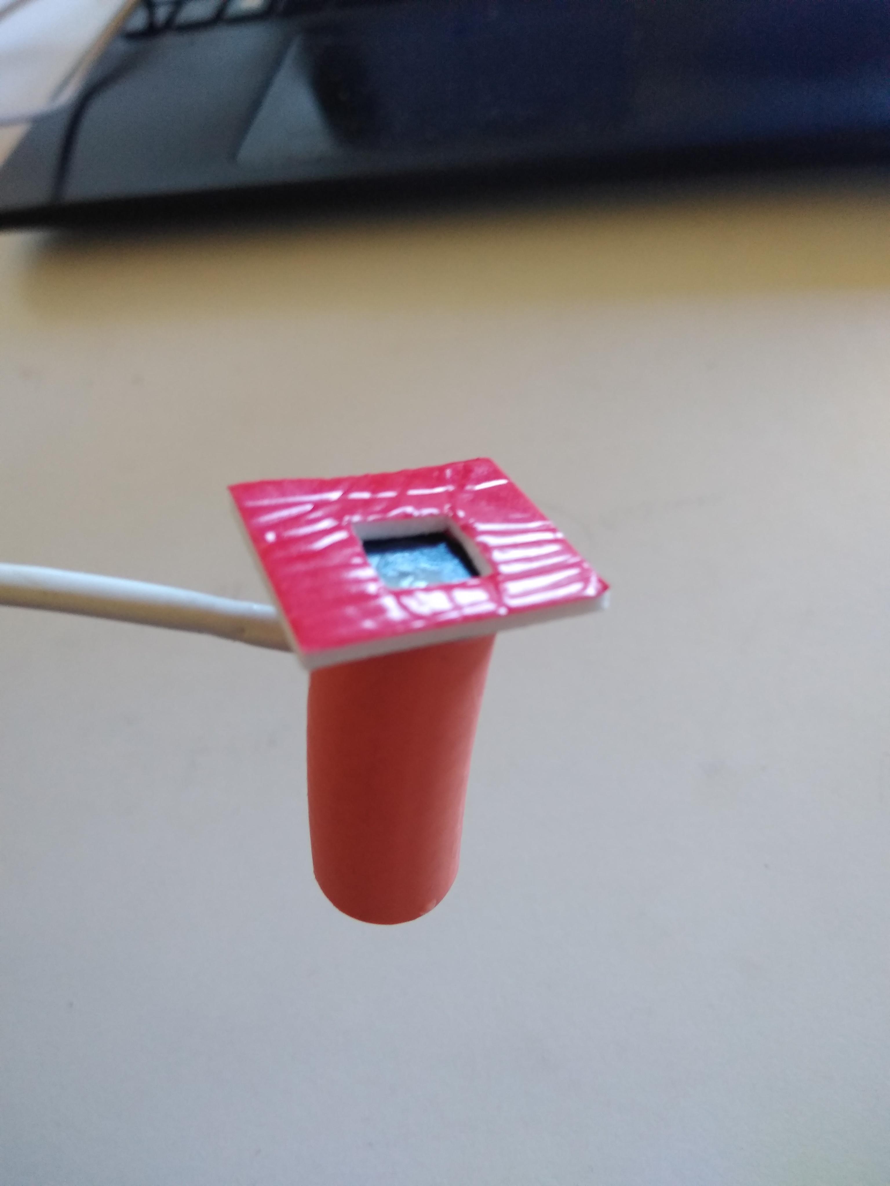

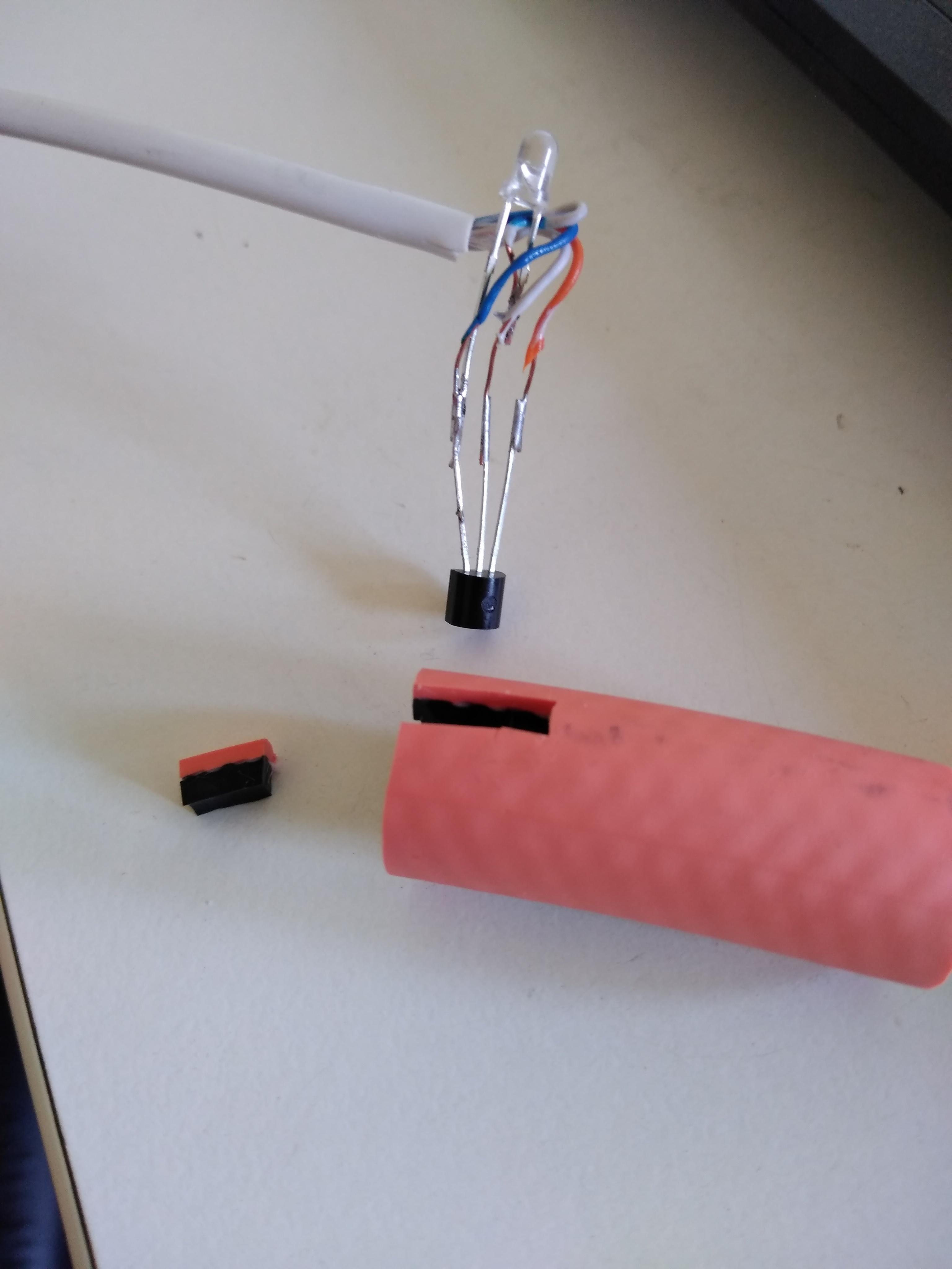

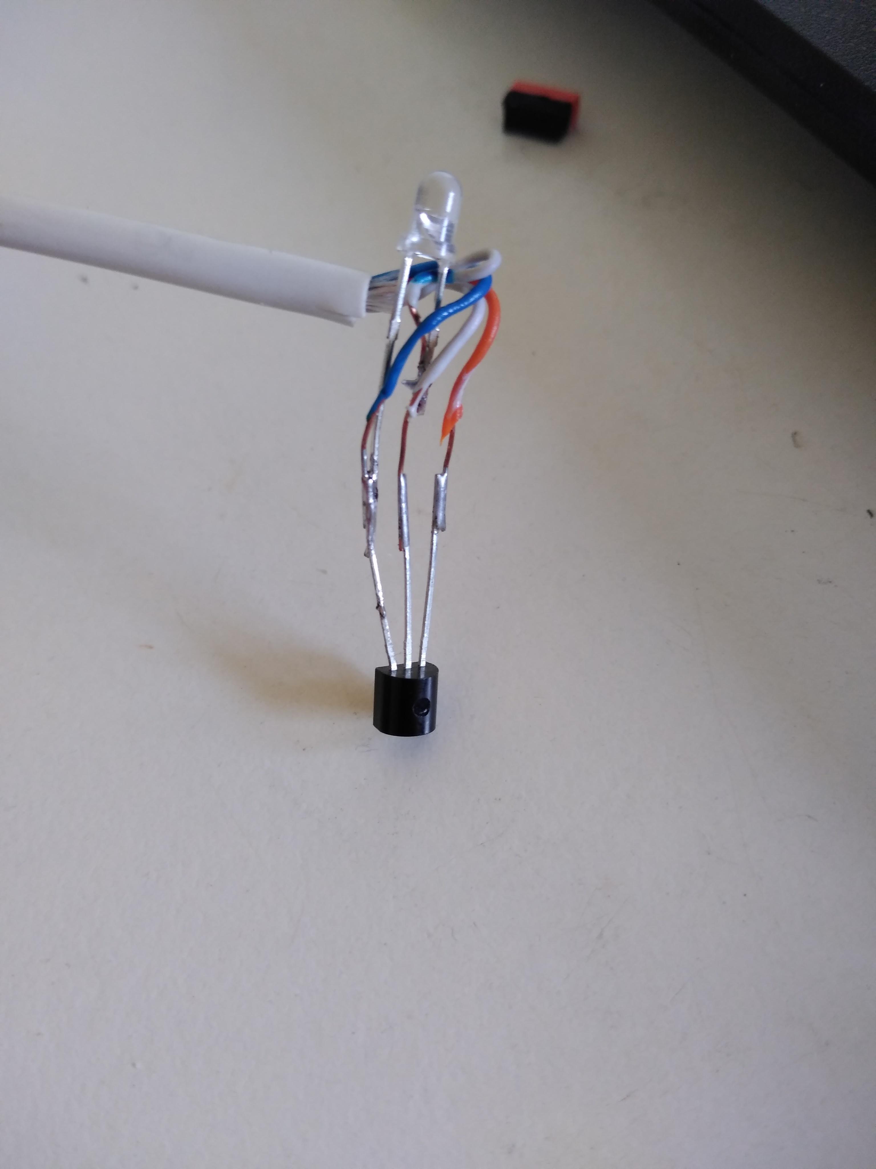

Some pictures of my 1wire therm and LED.

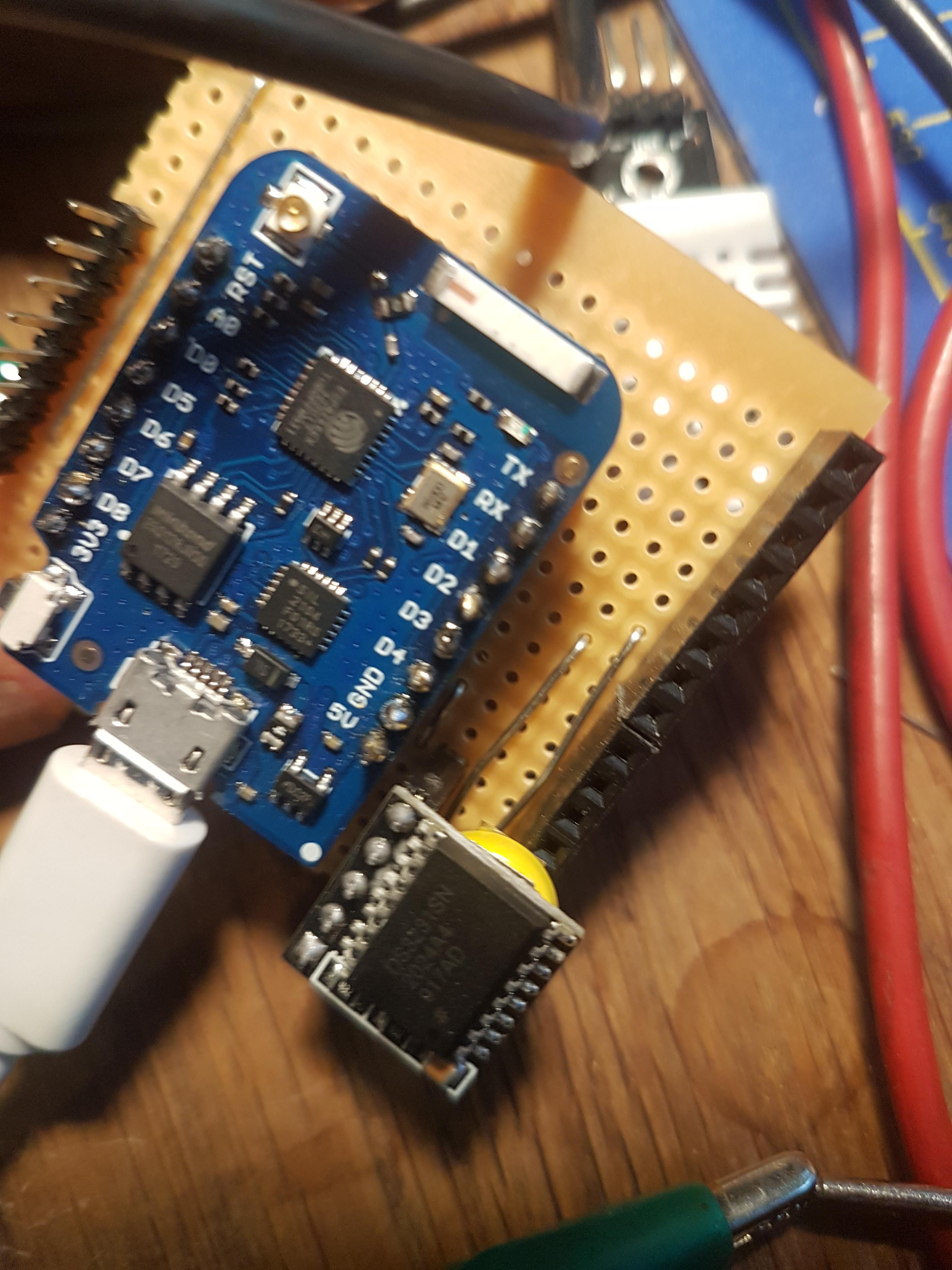

I have moved on and found an interesting bug. If I run the RTC on a nano it works fine, then I transfer it to the WEMOS, first run is fine but next upload it breaks and I get error 4. So for now I will put the RTC on the back burner and work on getting counts back to the server. See if can remember enough Node Red to get that going with MQTT from the device. Might be fun but no more time today. Chores🤨

Sounds like you have something pulling the GPIO0, GPIO2 and/or GPIO15 pins to the wrong levels at boot time. These are the boot control bits.
summary here
MikeSharp01
Posted
Yes, thanks for the heads up on the boot pins - had the GPIO15 with a pullup for the pulses. That has cured the boot from reset switch but the rtc is still error 4 - bus arbitration fault. (Nothing else on the SDA / SCL pins I can see.)
MikeSharp01
Posted
Bugger me, just looked at the tracks above the board taking SDA and SCL from the RTC to the WEMOS lovely and parallel - so thought nice capacitor there, so bent them apart - see pic, works like a dream - dry joint or interference?
