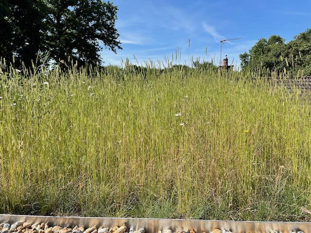

First roof which will have a wildflower green roof being overlooked by our bedroom balcony

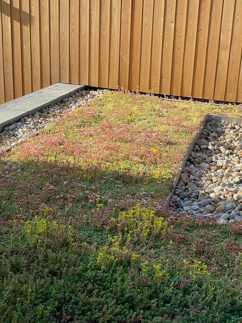

Second roof above our utility room which links the house to the garage which will have a sedum roof
They will return a little later on in the blog to install the green roofs.

But while he was doing that the flat roofers came back and installed our green roofs.
The wildflower material

How are you going to mow that roof?
On 06/04/2022 at 14:07, pocster said:
Robot mower for certain !
On 06/04/2022 at 14:15, Thorfun said:
the wildflowers have started to bloom
the roof is full on now! bees are buzzing around and it gives great privacy in our bedroom from the neighbours house to the south as well.

Do you really like that look out of your bedroom window?  To me it looks like you need to run the lawnmower over it?
Thorfun
yes we really do! it's like overlooking a wildflower meadow. I've been informed that over the years as more flowers take hold the number of grasses should reduce so it won't look so grass-heavy.
Thorfun
the sedum roof is looking particularly lovely at the moment with the different colours
