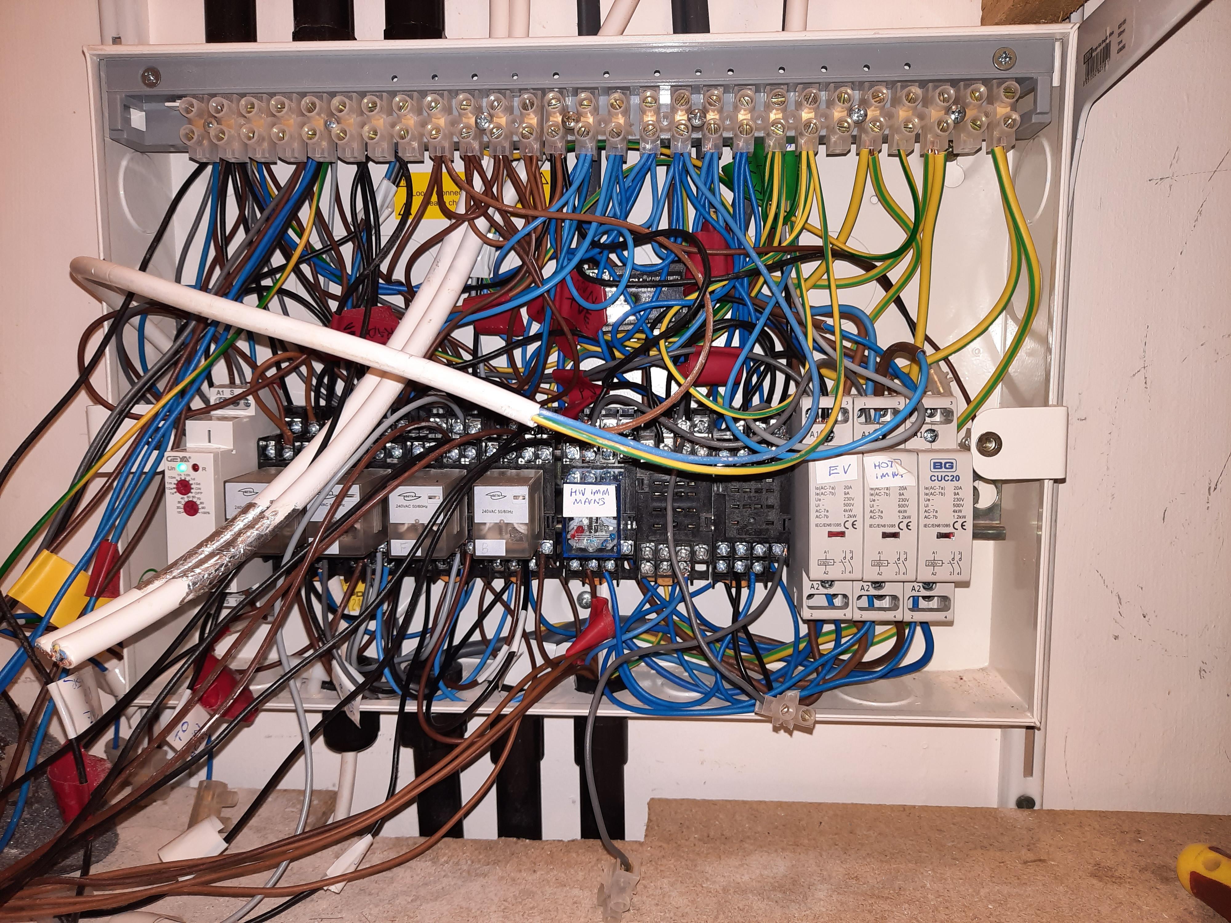

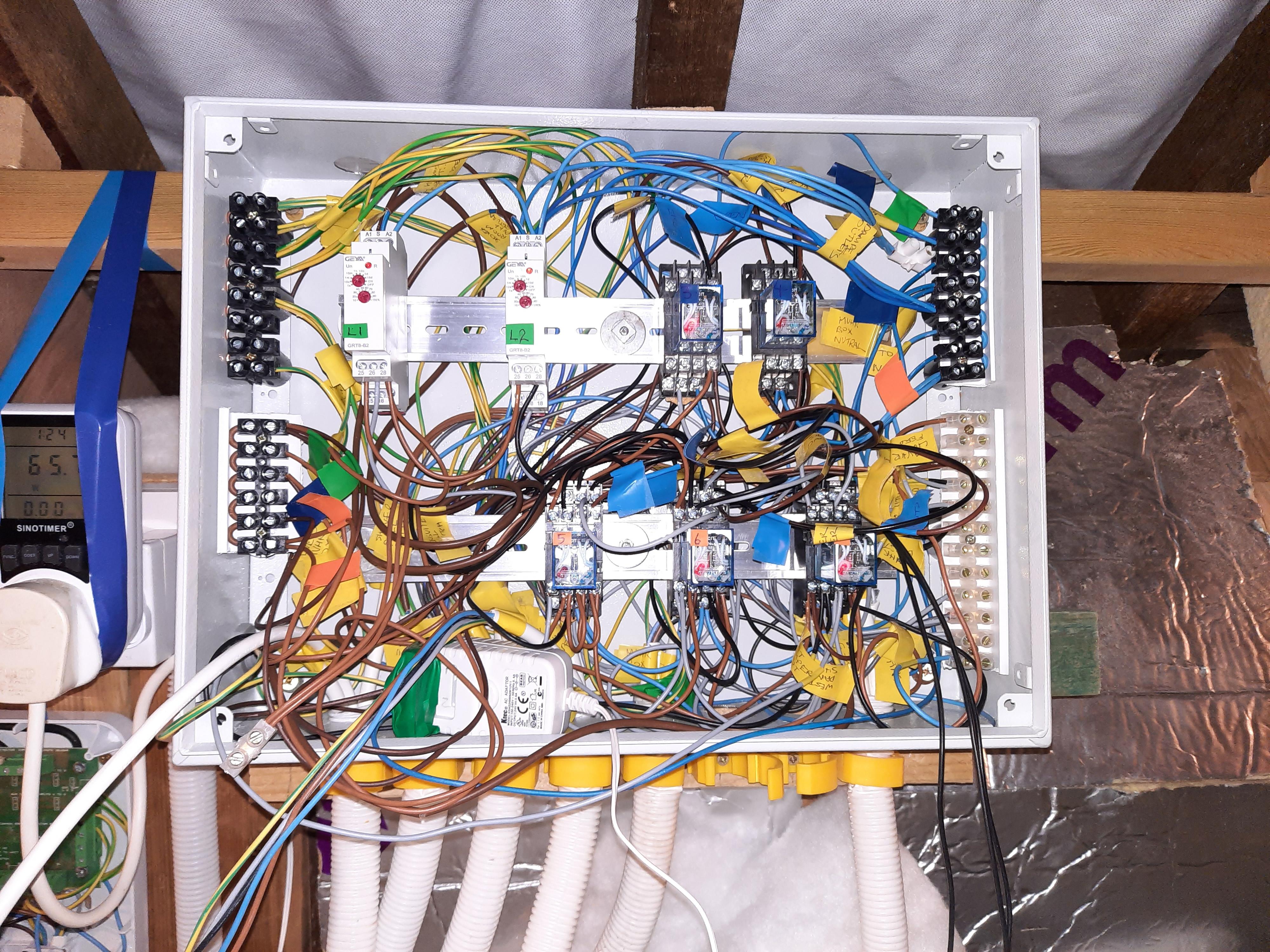

MVHR controls mvhr old school automation Entry posted by Marvin January 31, 2022 3561 views Share More sharing options... Followers 4 This is what my system controls would look like if I didn't have a computerised home automation system: Wait a minute, I haven't got a computerised home automation system! 2

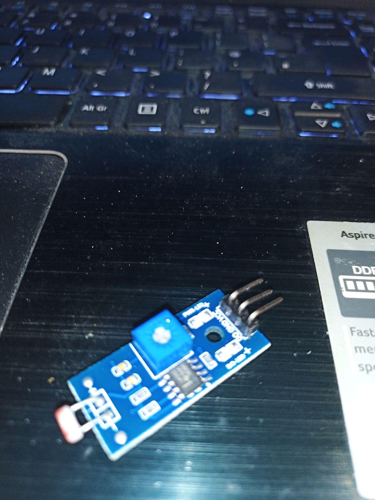

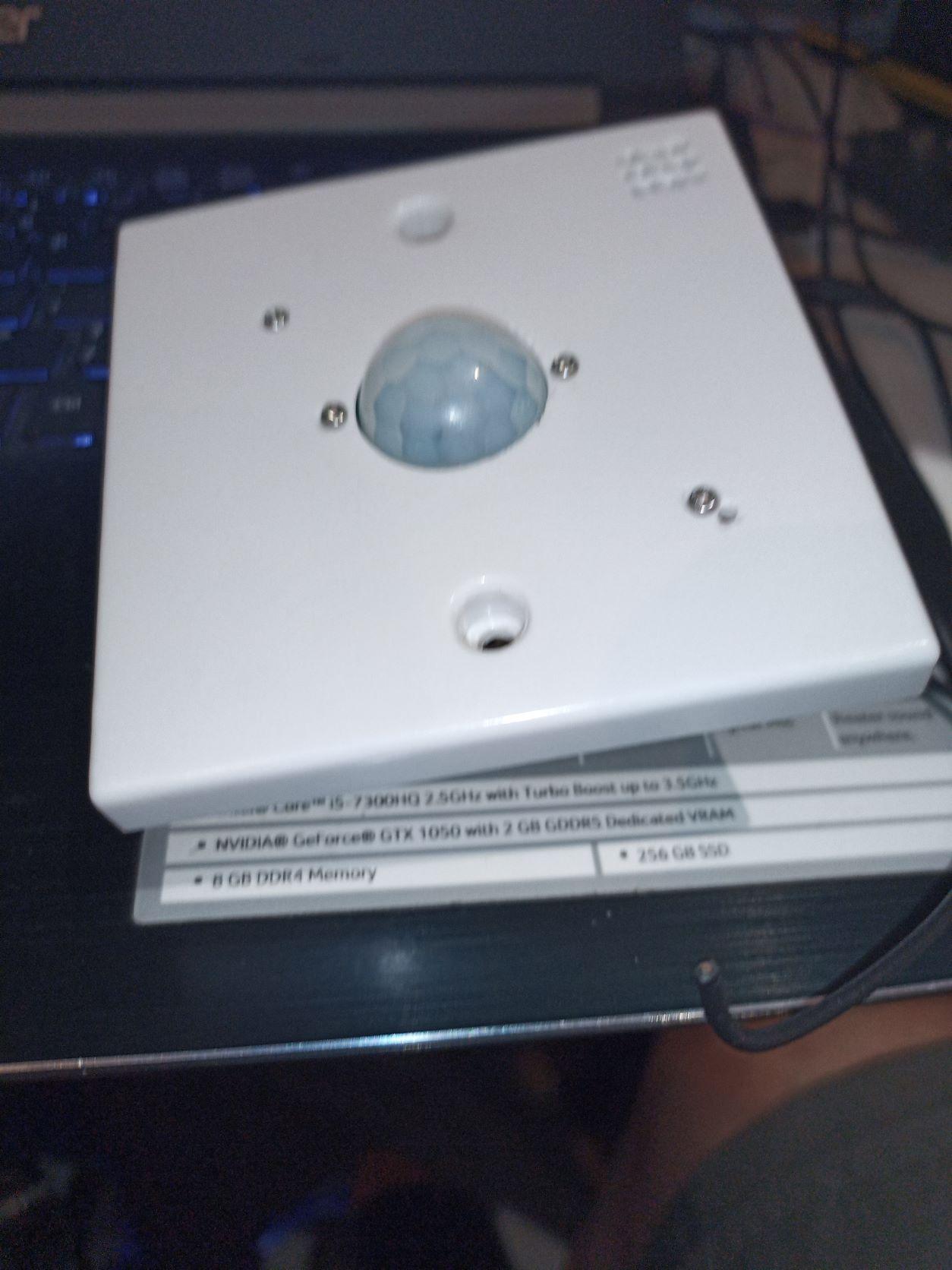

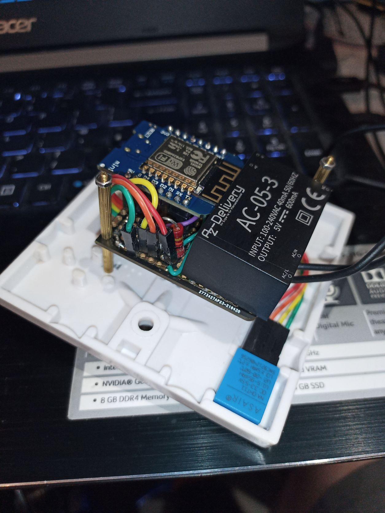

Ajn 47 Posted February 12, 2022 Didn't think its a sound idea? Well this is my starter for ten to go in our downstairs loo...(we are only single storey but..what else to call it?). There is a shower in this room so it was going to have a RH sensor. I have added a PIR to the RH sensor. I have also included a light sensor, more to determine who has left the light on.... (I know who it is... but need to catch them) The sensors connect to a D1mini wifi micro controller running esp-easy. The output via wifi goes to a MQTT server running on a respberry pi. This also runs Node red as the control software and Web user interface. Node red controls all my heat recovery and heating activity including recording data to an SQL server. So to trigger "additional ventilation". I have ordered a mic and ADC (anolog to digital converter) recorder that will create a sound file to be stored in segments as triggered by the PIR. Software on the pi will look at the sound files to learn when the ventilation needs to be activated above the background level and for how long. Pictures are the PIR, RH and light sensors built on the back of a single blank face plate. This goes in the ceiling not far from the extract vent and one of the lights. 1 Link to comment
