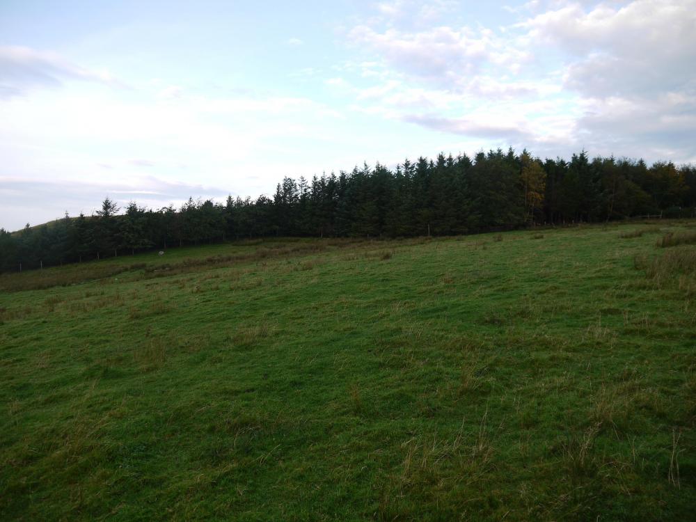

1. Obtain outline planning, purchase of site – this allowed us to know that a build was possible.

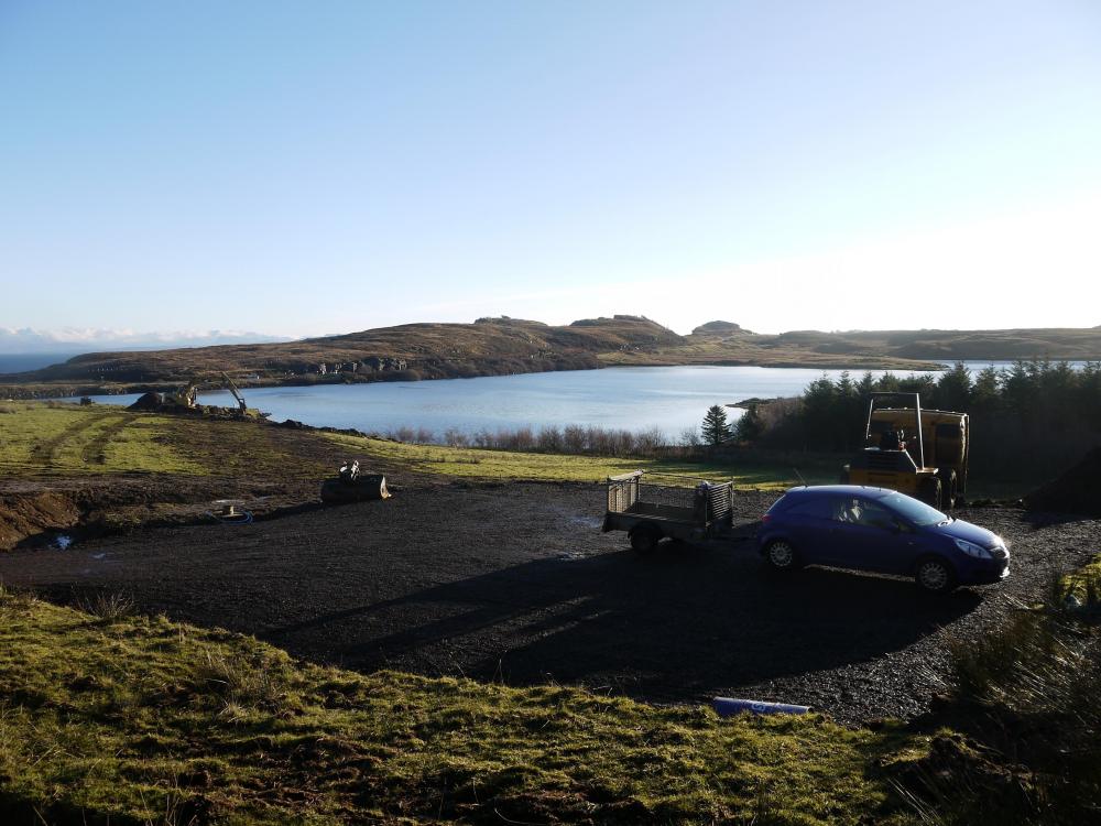

2. Put in services, access, design – this was the first actual work and made an area of croft ground into a valuable plot for lending purposes.

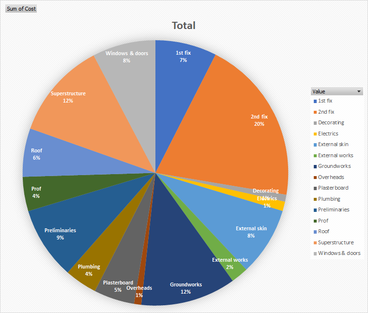

What did it cost?
The total cost for the project was just over £196,000 (net of VAT). This includes the land, services, professional fees, overheads and the actual build costs.
I’ve summarised all of my costs into a pie chart below.

First of all, congratulations on living the dream. Thank you for sharing the details.
One number that surprises me is the percentage spent on the superstructure. 18% including the roof looks very low and as there is no separate section for the insulation I gather it's also included. This is quite a result.

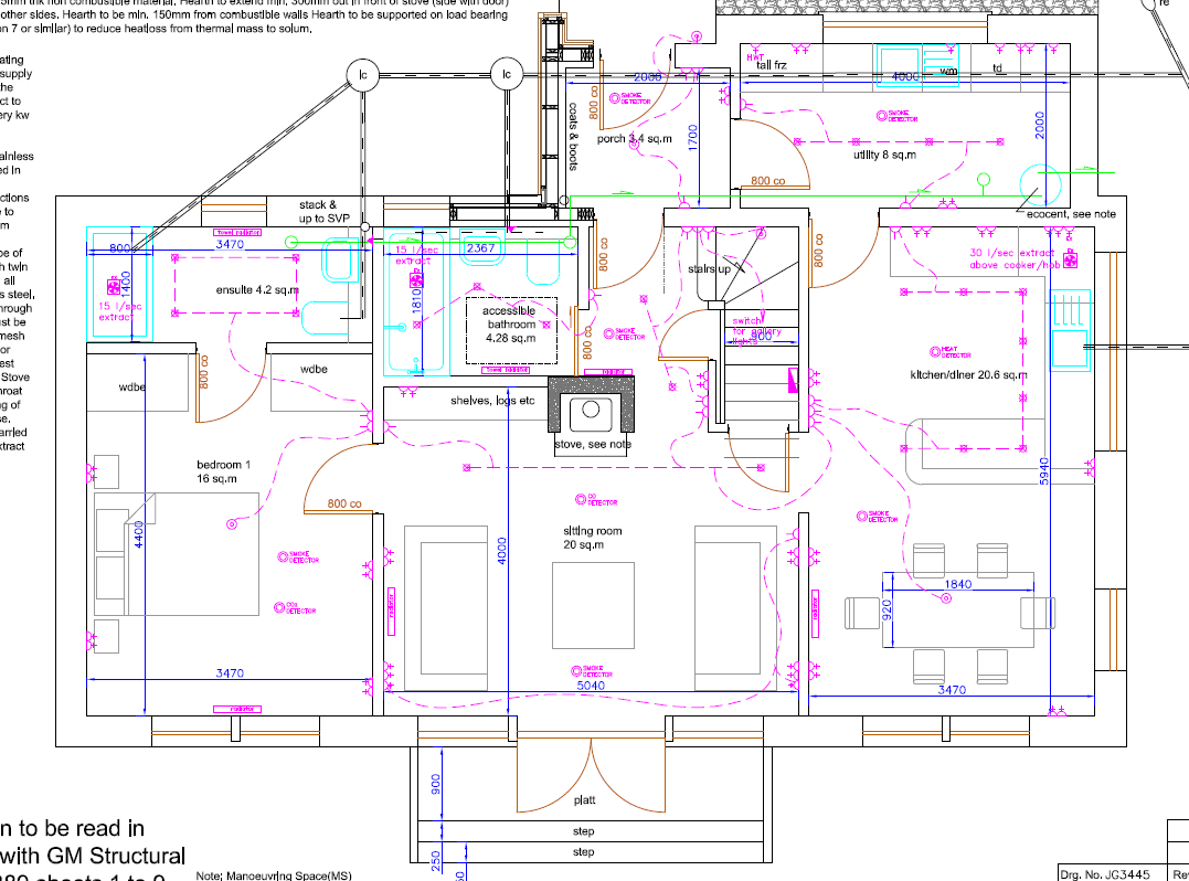

congratulations on building yourself a lovely house.
any chance you can show us a layout.

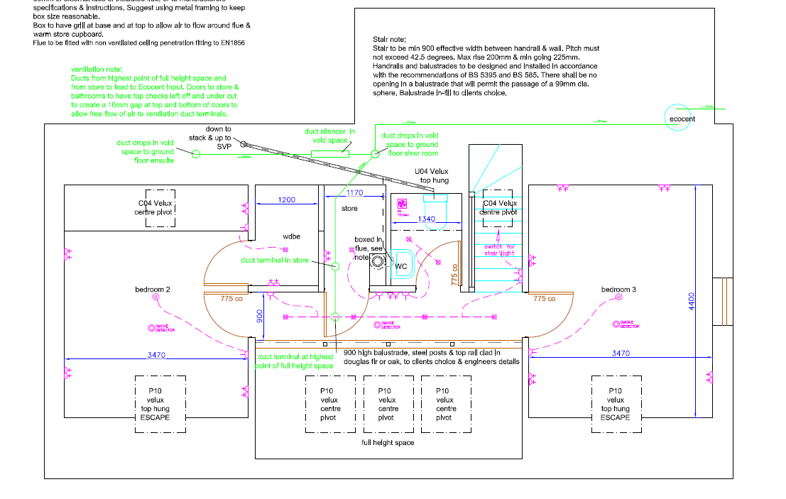

Hope that comes through ok! We did away with the wardrobe, WC and store upstairs. Now have an open plan living area for our children.

thanks, great to see someone's plans that have made it to completion and interesting to see how you did away with some things during the build.

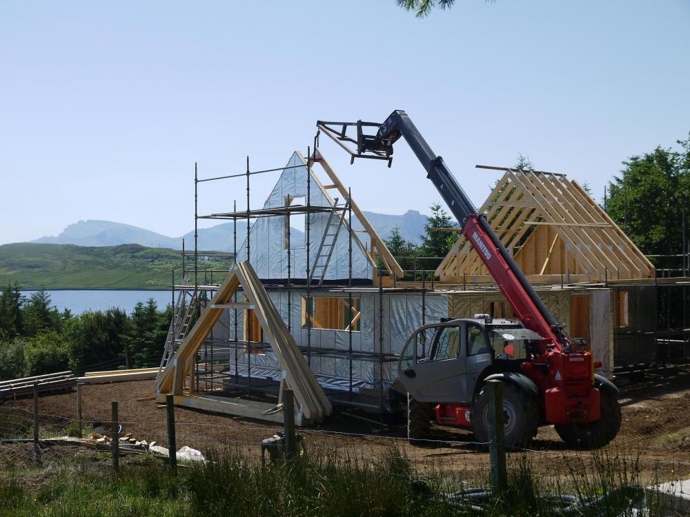

It cost £13k for the materials to build the kit. Included within that is £5k for engineered attic trusses from Pasquill.
Labour was £9k, included within that was the time making the kit, erecting it and also the suspended ground floor.
Other expensive items were a steel beam for the vaulted ceiling and three Kerto beams for the middle ridge part.
I also had to hire a telehandler with a truss jib for two weeks that cost around £750.
By the end of that we looked like this.
Roof for the main part.
Was £5k for the Cupa heavies slates and £4.5k for the roofer.
The wee metal lean to roof was cost about £1.2k for materials and labour.
Included within the roof is also some cast iron affect guttering, which was around £500 and £250 for labour in fitting.
Yes I have included insulation, within 1st fix.
We spent around £5k on insulation.  Could add another £1.5k for labour as joiners did the rafters and service void insulation. We fitted the glasswool and the groundfloor insulation ourselves.
