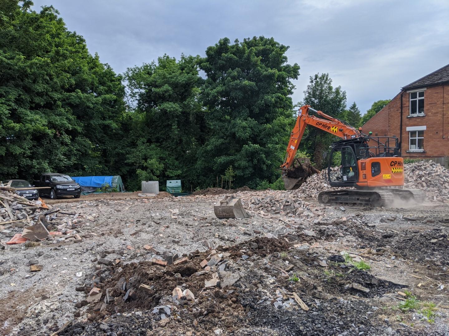

As we're building a basement, we knew excavation would be extensive. Once we'd leveled the site, dug out the founds, the drainage and main basement excavation works could start. As you can see, we've ended up with a rather large pile of bricks...

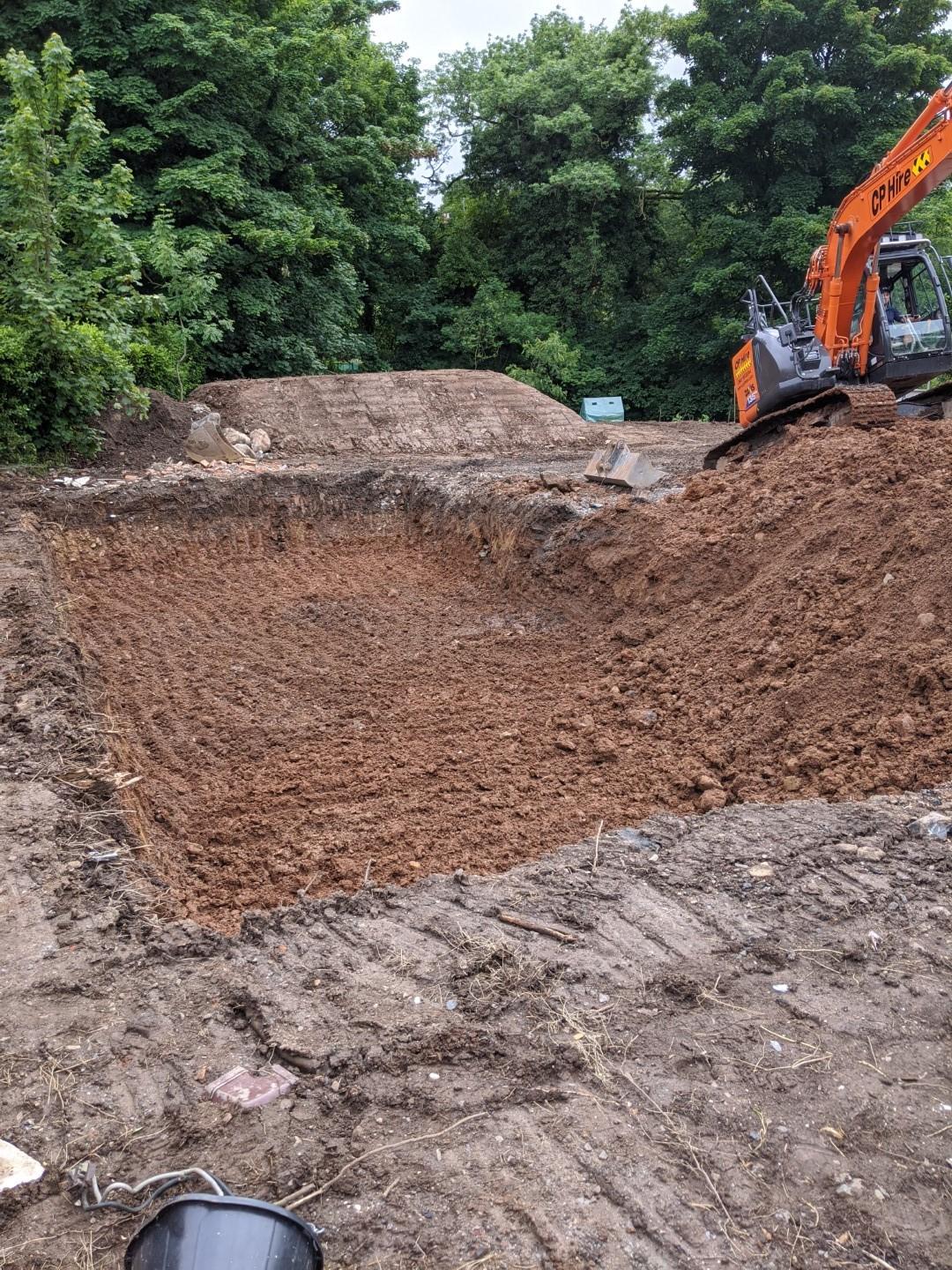

A sense of scale, this is 1/2 depth of 1/2 of the main building footprint... the clay was already building up at this point! We knew then we'd have to shift a few loads away as there wouldn't be room on site.

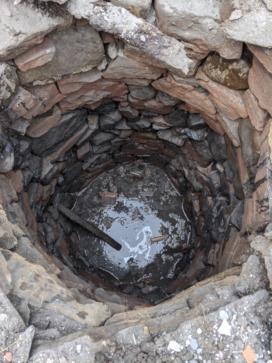

All started well... until, well, I got a knock on the office door and was greeted to Noel looking in with a strange, perplexed, half smile reminiscent of a child that's done something wrong and is straining to hide their obvious pride in their achievement.
"Conor, I've found a well"
"What do you mean, a well?"
"A well".
A few moments of silence passed. Then he showed me this:
Somebody, back in 1920 or so, in their unfathomable wisdom, decided to build their house directly over a 5m deep, sandstone walled well. DONT PANIC!!! A few phone calls and a bit of head scratching later, we found a solution. 5m3 of lean mix concrete was quickly ordered! The well was pretty much at the back inner corner of the house so had to be dealt with. Luckily, the well was dry (apart from a little sludge at the bottom) and not apparently hydraulically linked to anything of importance... so engineer said fill it up! A shame, but a relatively cheap outcome for what could have been a disaster.

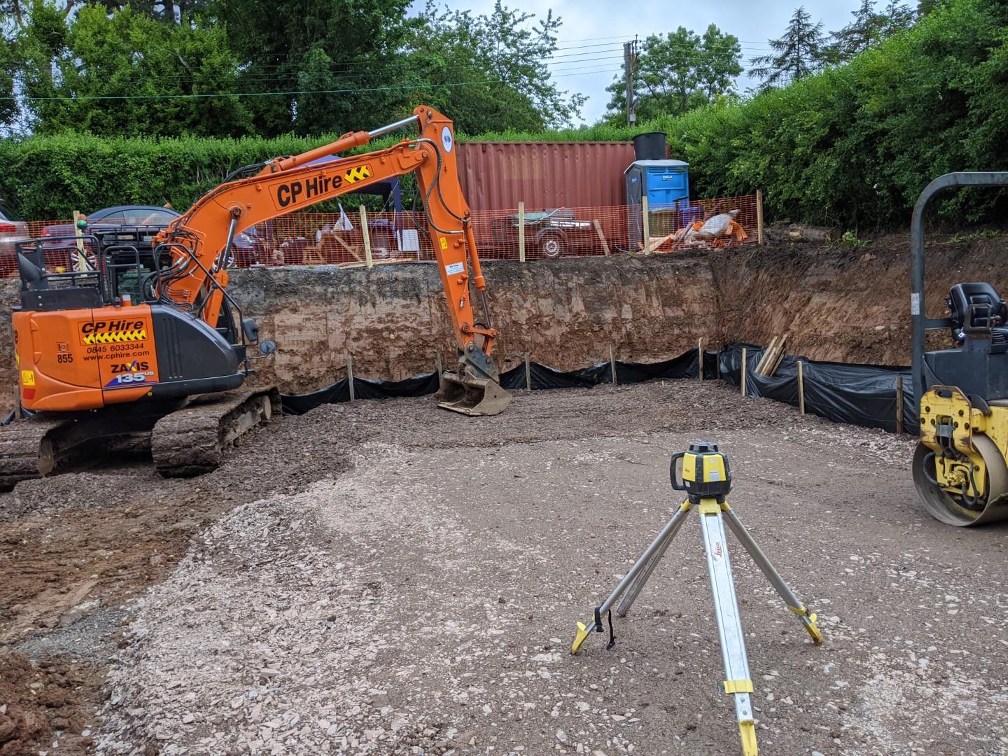

In the end, we finished after almost three weeks (up from the one week estimate) and trucked out 51 loads of soil (816 tonnes) and imported 225 tonnes of stone.

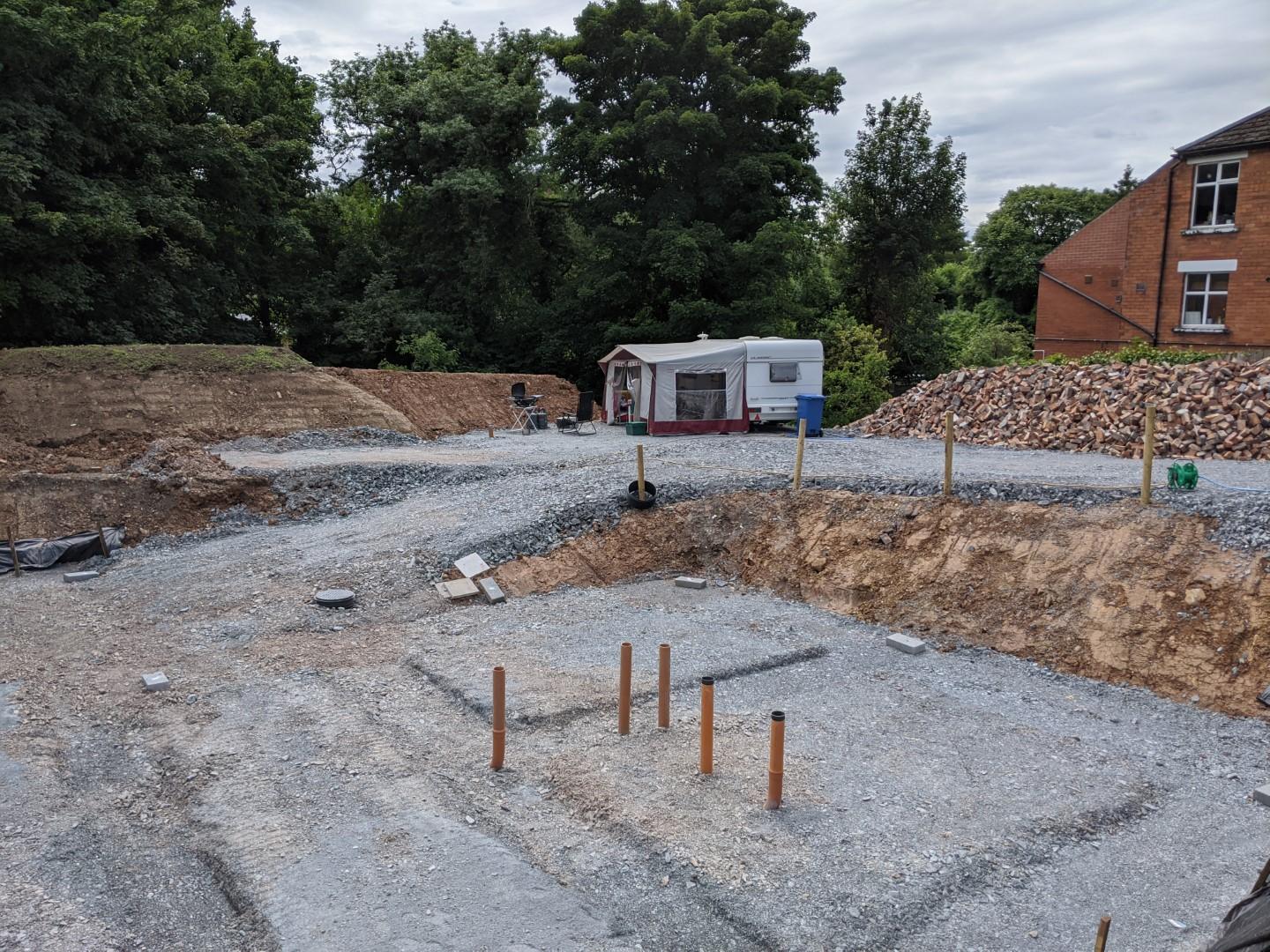

Bonus tho, we now had somewhere to put our "day" caravan and awning and finally have a spot to have a BBQ and beer after work.... and quality time with family.MVIMG_20200712_135536.thumb.jpg.38d04b777c07c077aa45da7b188290b3.jpg

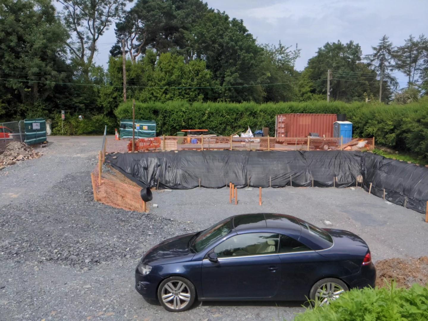

Ended up 50% over budget.... well, at least we're out of the ground now....
IMG_20200810_143205_exported_733_1597066754541.thumb.jpg.dc80044a0e14a38896a2ba6268657d7e.jpg

Well getting out of the ground is always fraught with danger, shame to cover the well (should have bought some walk on glazing from @pocster ??. Well done, looks good, a huge tick in the box.
