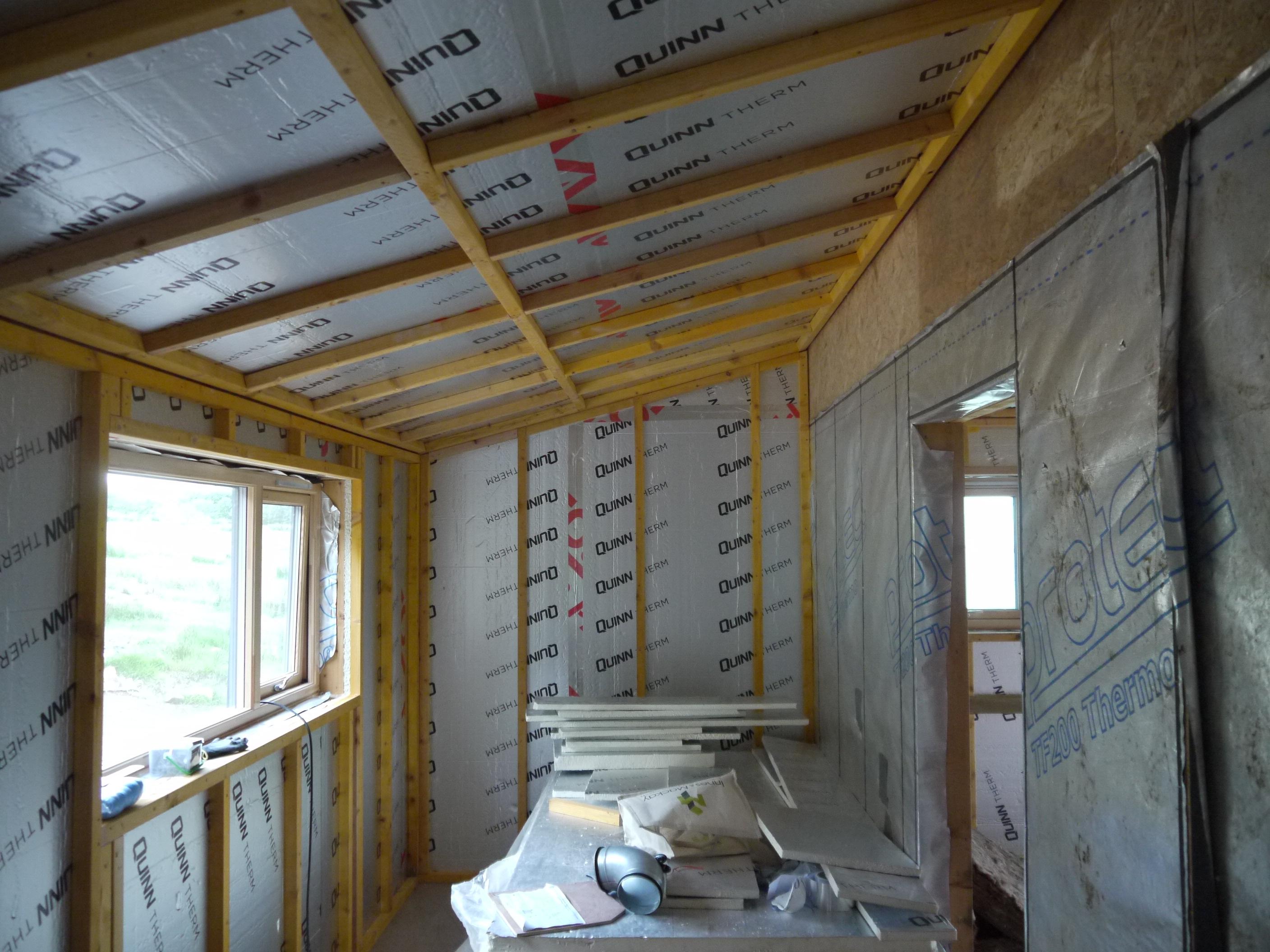

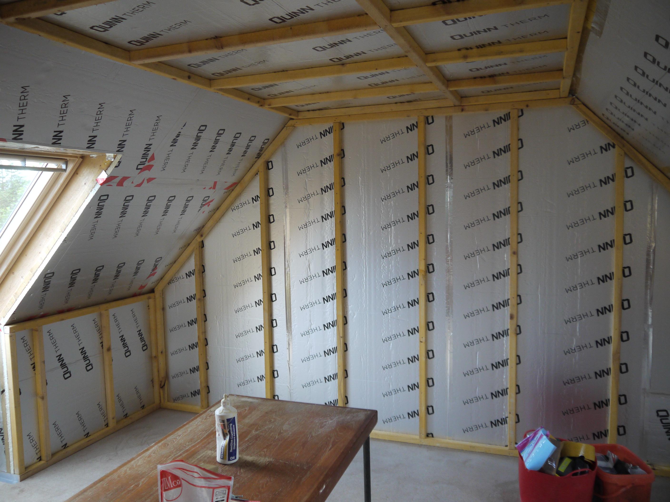

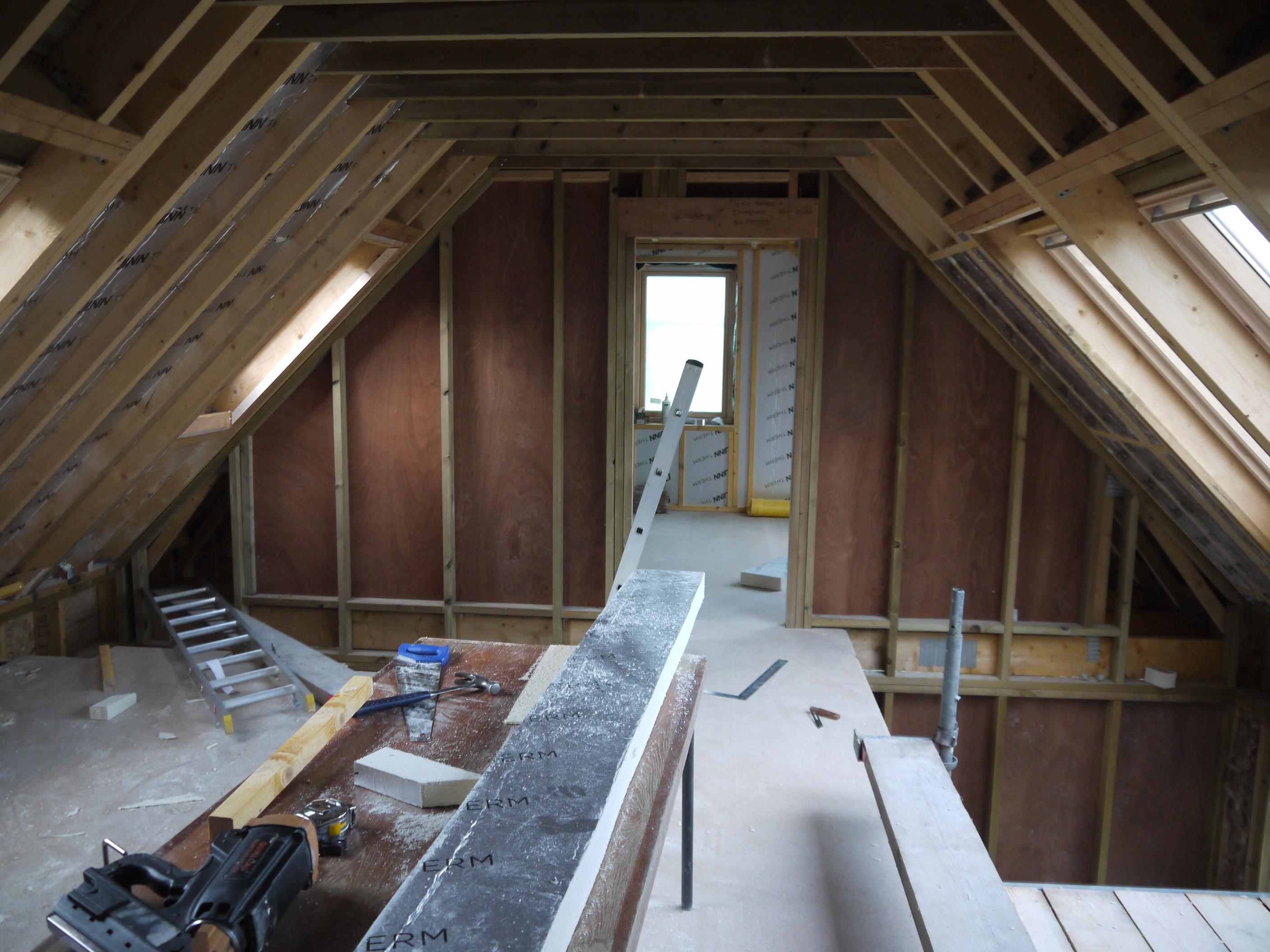

The first job was insulating the first floor.
Two layers of 80mm quinn therm was then fitted between the rafters leaving a ventilation gap to the sarking/breathe membrane.
A final layer of 25mm quinn therm layer on top with a service void.
For the flat ceiling we used a couple of layers of frametherm 35 with an airtightness membrane and Quinn therm 25mm layer.
We still have some work to do around the windows.

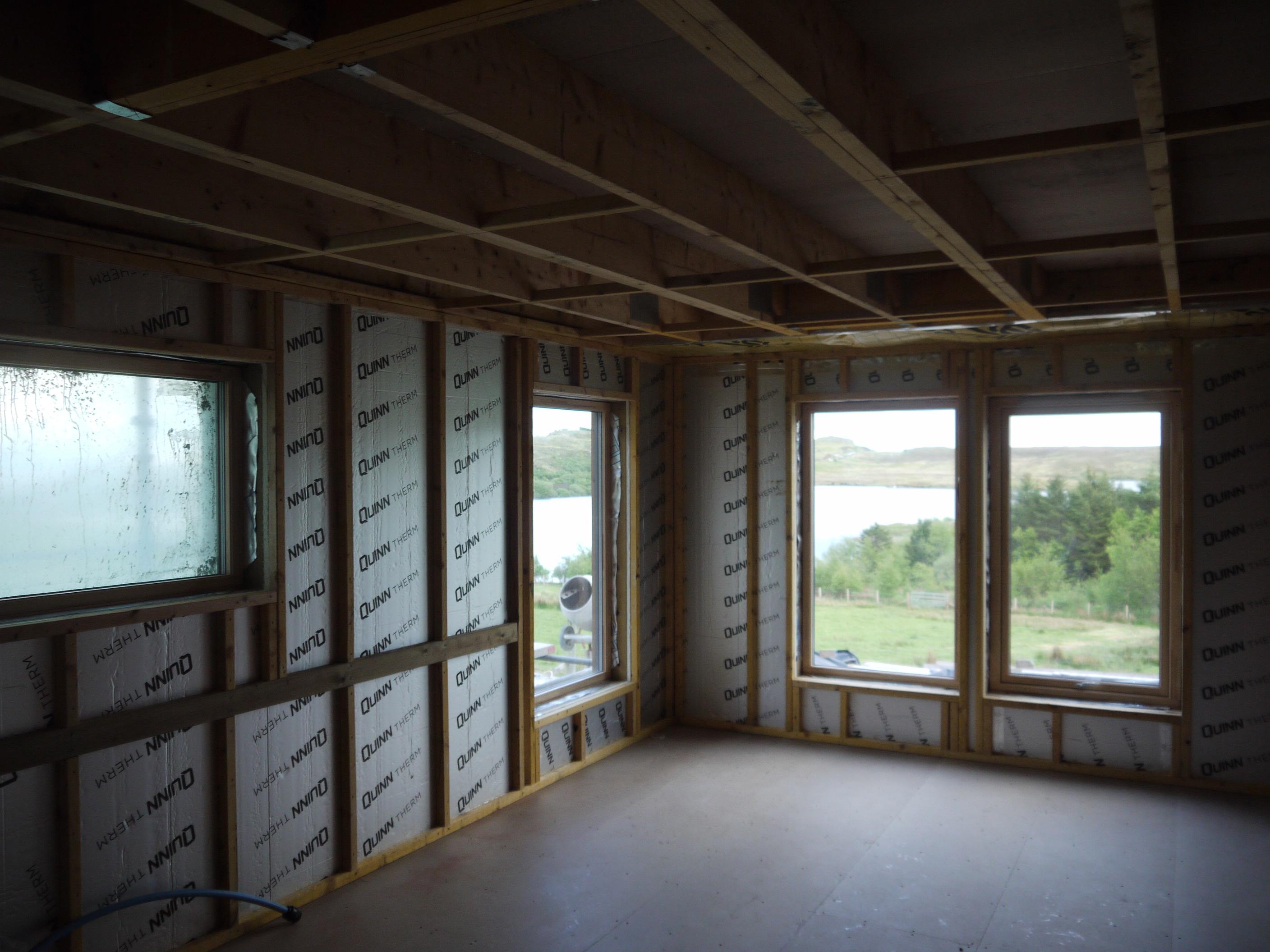

Downstairs was a lot quicker. This already had frametherm fitted between the studs so the Quinn therm 25mm went on top.

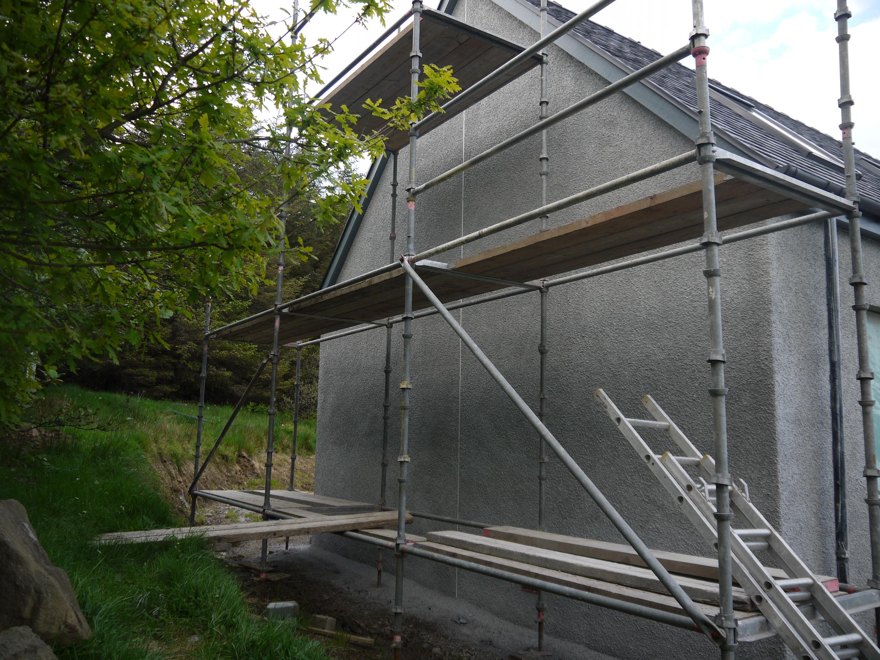

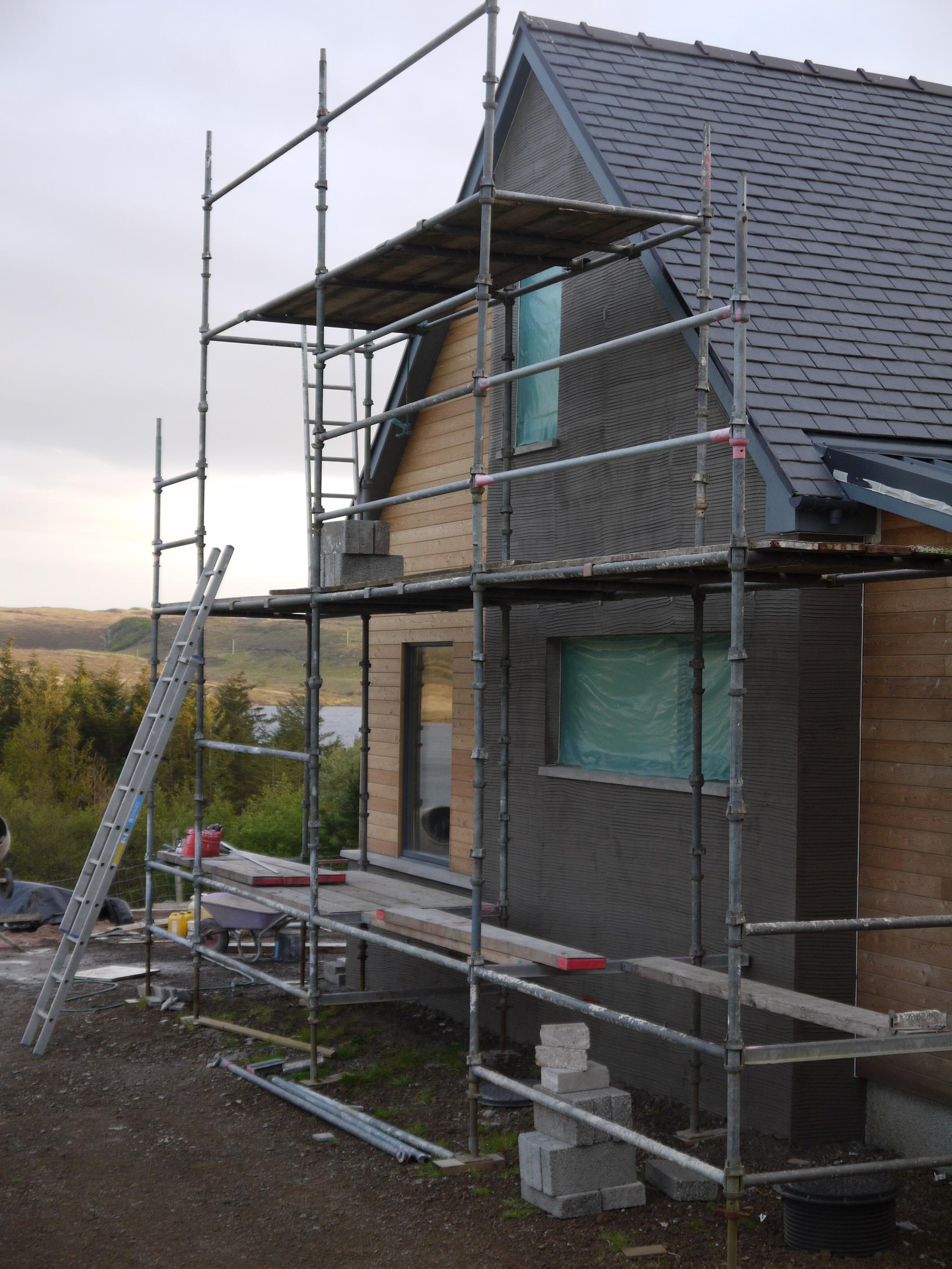

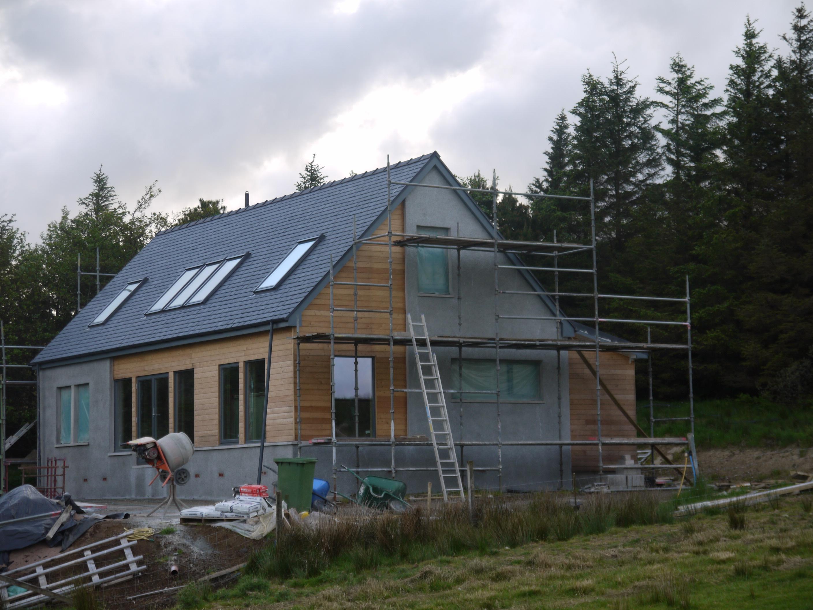

Now for the outside. We had been waiting for good weather for rendering the blockwork.

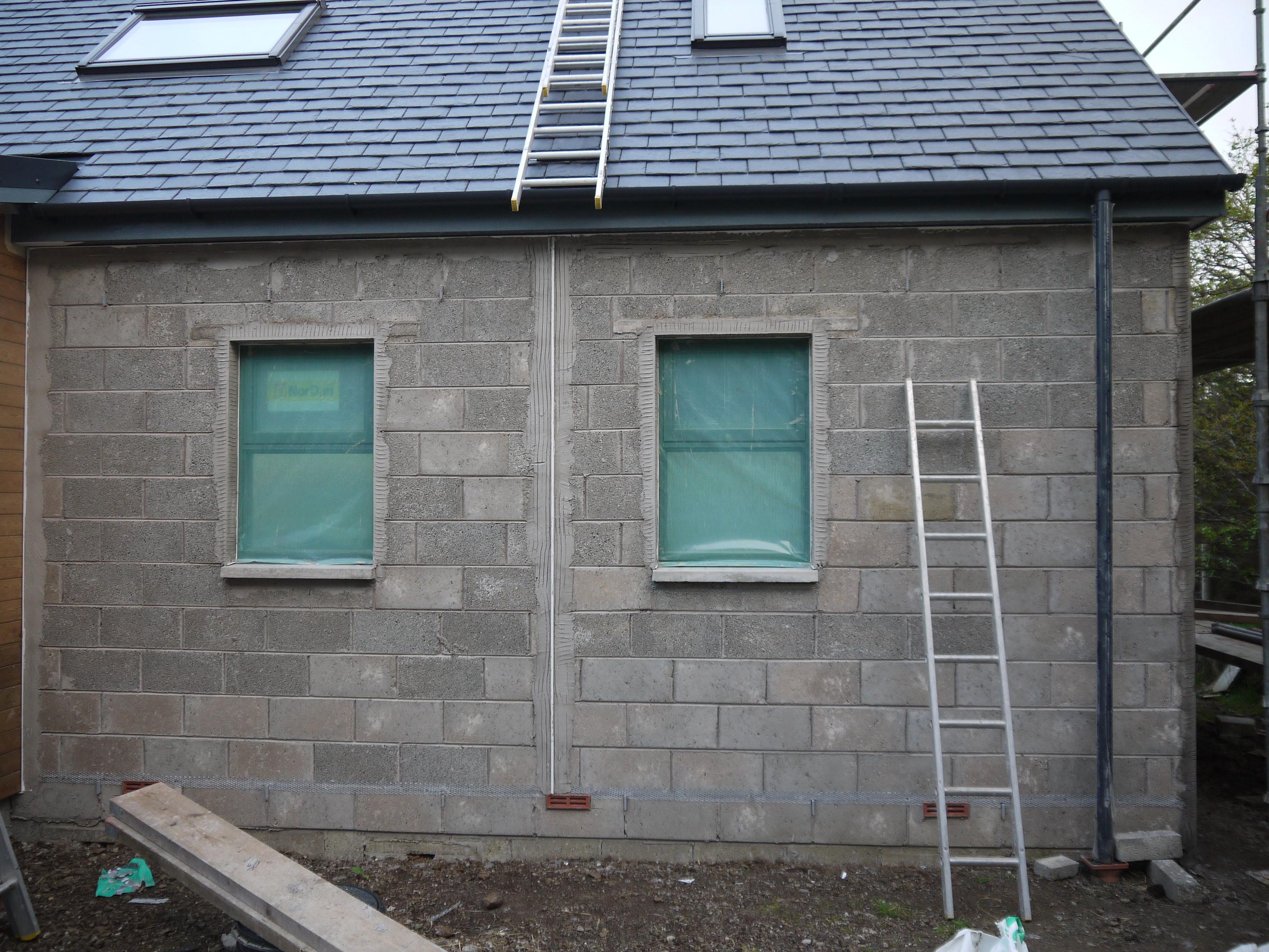

The first step was rendering beads and mesh.
Then a scratch coat coat was added.
Then finally the rough casting.

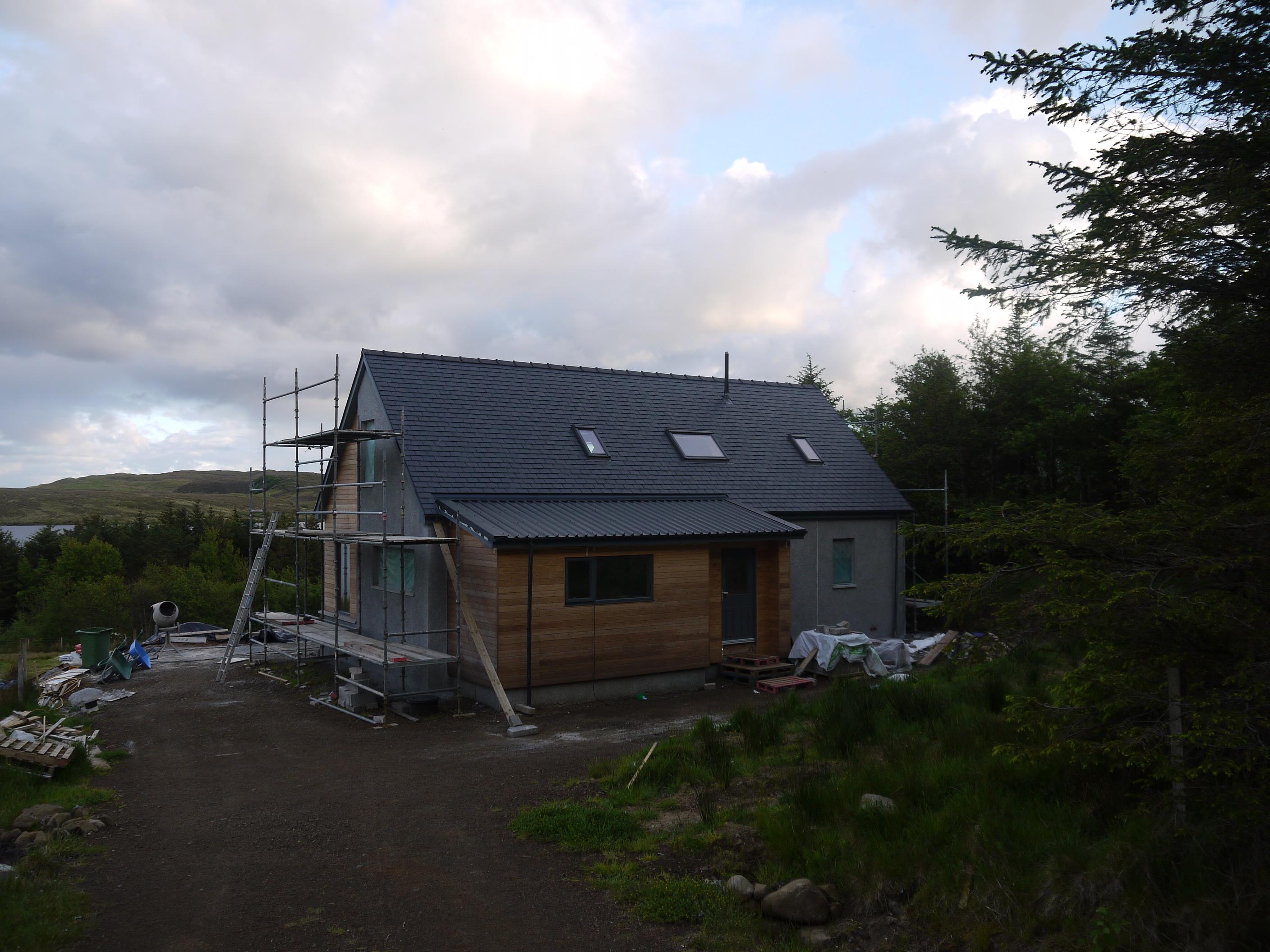

The rough casting will now be left and painted in July.
The next step is getting the electrician and plumber to do first fix.

@Thedreamer Looks great, very tidy.  Do you have any of the detailing for the junction between the render and the cladding?  Are the cladding parts not done with block at all?
Thanks
Link to comment
Thanks
Thanks
A stop bead was fitted to keep a gap between the render and the cladding.
The cladding was fitted on battens to keep a cavity for ventilation, so block-work just starts under the cills.
Link to comment
16 minutes ago, BMcN said:
Thanks, so where you have cladding you have no blockwork behind it?
Yes the house is a timberframe. Double block is very unusual in the Highlands and Islands these days, prehaps because of the weather conditions. Traditional here to built a timber frame and then build a single skin block wall essentially around the house with rough casting added on top. Reason being that it's best at keeping the wind and rain out. The gable end which faces the trees get hits with prevailing south west wind and rains off the mountains.
So the battens are attached to the kit. No blocks behind it.
Don't know if there are different ways of doing this, but if you were to fit a block here you would need to have a gap between the kit and blockwork, with a further gap between blockwork and cladding.
I think you would struggle to have it all fitting on the original foundation block which was laid on the flat, does that make sense?
Below the cills we have single layer of block, then down to the original foundation block work. We also have some weep vents which will provide some ventilation below the cills.

Is the wet dash down to the ground on the gable Or is it just the picture
Link to comment
I'm not sure it's pretty close to the ground, their then seems to be a bit of wet dash left at the bottom presumably that fell to the ground when it was being applied.
Is the reason for asking damp concerns?
Yes really should be 150 above ground finished levels with a bell cast bead sat on the doc
If it is touching the ground it will act Locke a sponge
Link to comment
Thanks @nod
Is the idea that dampness soaks into the cement render then by passes the DPC and travels across the cavity (if left untidy or filled with insulation)?
Would this be a problem in a timber frame property with a clear cavity? As the blockwork and render is essentially just a wall around the house.
We also have a suspended timber floor so it's a bit higher than your typically slab.
Link to comment
You should be ok with a cavity
The problem will be when it frosts It will get behind the W D and bring it off
Bad practice
normally we would bellcast on top of the dpc
Link to comment

1 hour ago, Thedreamer said:
@nod
What is a WD?
I've been looking at photos of rendering done around here for older properties and new builds which are probably timber frame. Some incorporate a bellcast bead but they are also rendered underneath but not with a smooth finish so is this render not prone to damp, frost/cracking as well?
Anyone who renders down to the floor is either inexperienced Or first care
Sometimes I’m asked to render a thin coat under a bead Not ideal But not a big job to replace a 200 mil strip should it drop off in a couple of years
