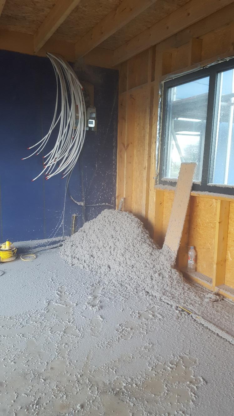

Allow me to explain.  It seems that much of the artificial snow that you see on film sets is, in fact, made from blown cellulose, particularly to cover outdoor areas without damaging flora and fauna.  I now know this after having some cellulose insulation inadvertently blown into the garage on Friday when the insulation found a gap in a board and made its way through.  No big deal, it was spotted early on and most was re-used, but it struck me that, apart from the colour, it looked a lot like freshly fallen snow.

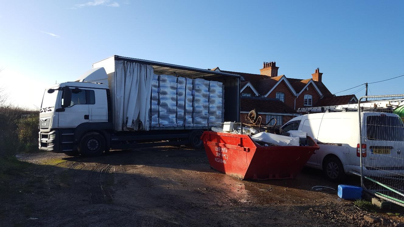

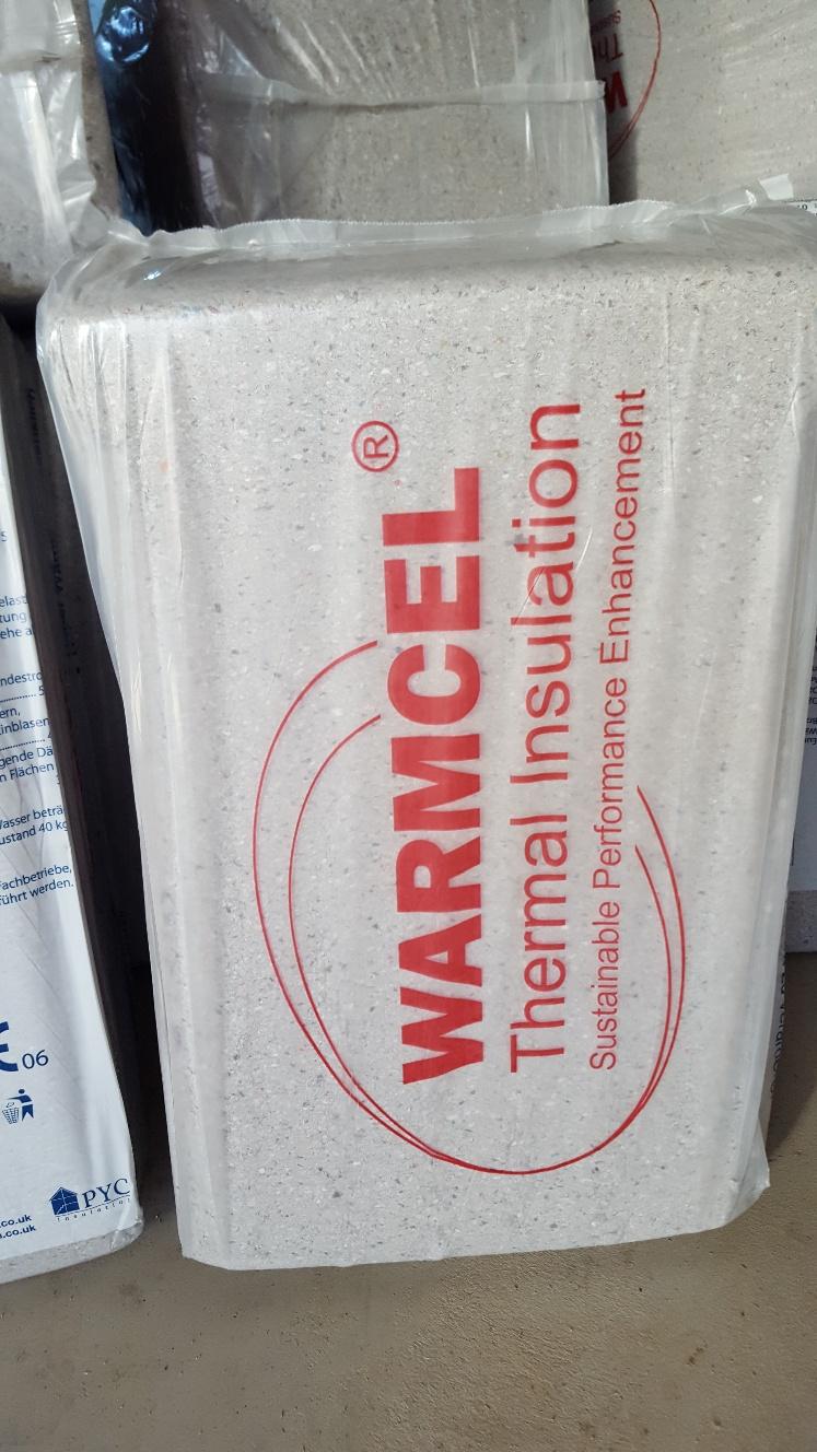

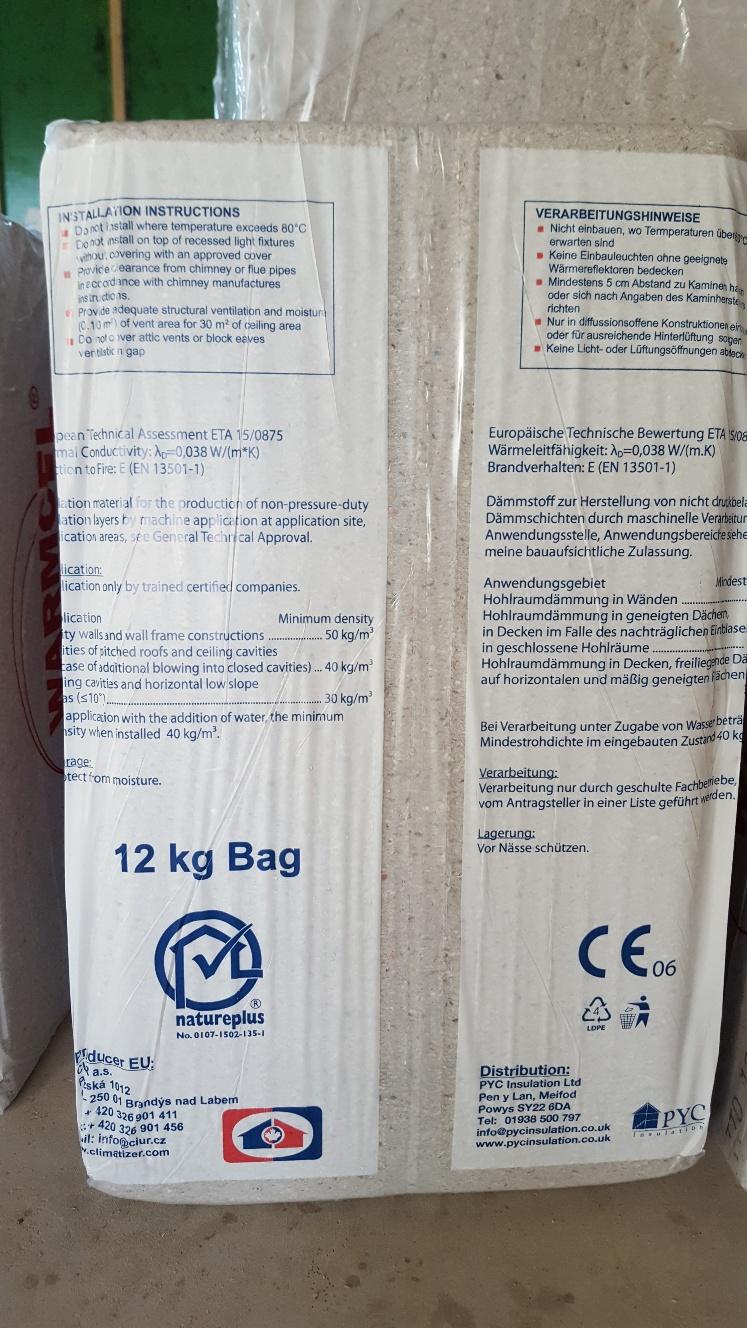

The cellulose delivery arrived ahead of Gordon and Keith as a palletised delivery.  Not surprising, given that there were 570 12kg bags.  That's a lot of cellulose.  At this stage, Gordon can't say whether it will be too little, too much, or Goldilocks cellulose and just right, as it's ordered in by MBC on his behalf.  Here's the delivery with the curtain sides just being opened on the lorry:
One of the pallets toppled off the forklift so the driver and I hauled the bags into the house and stacked them inside and I got a couple of photos of the packaging detail for anyone who's interested.

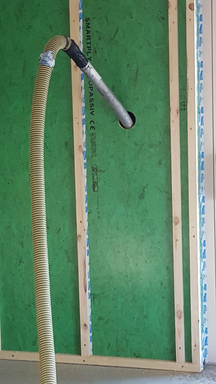

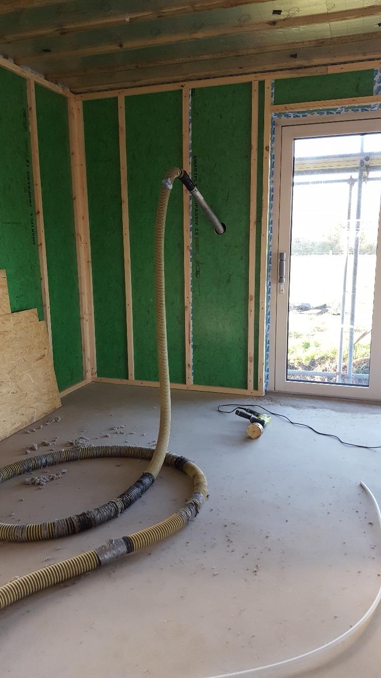

The process of putting the cellulose in is pretty straightforward.  The bales of compacted cellulose are fed into a machine housed in Gordon's van that fluffs the stuff up.  This then blows it along a tube terminating in the metal tube that goes into a hole that's been cut in the airtight board.

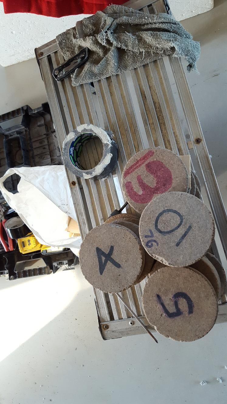

As he goes along and the sections are filled, numbered cork bungs are put into the holes.
The holes are only temporarily sealed with the bungs in case the cellulose settles or takes a little while to work into all the nooks and crannies, but once Gordon's happy that this has been done, the cut out disc of airtight board is put back in place and taped up with airtight tape.

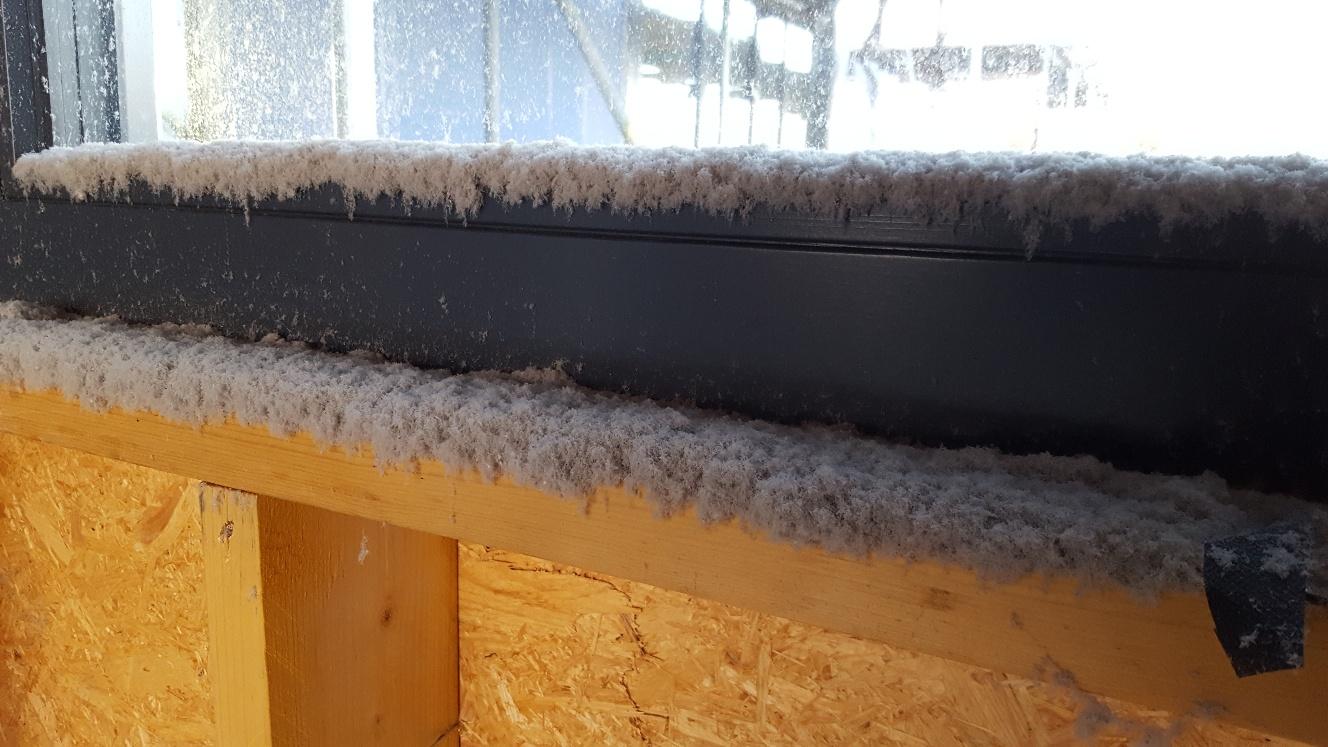

Because the cellulose is blown in under pressure, it will find any gaps or holes and do a good impression of fake snow.  The leakage in the photo above came into the garage via a loose board right at the top, above the cassette of the twin wall, after it forced the gap open.  It looked like loads - the entire floor was covered, there was a fair bit on the walls and a nice pile below the leaky board.  it looks like more, but this is barely about 1 bagful.

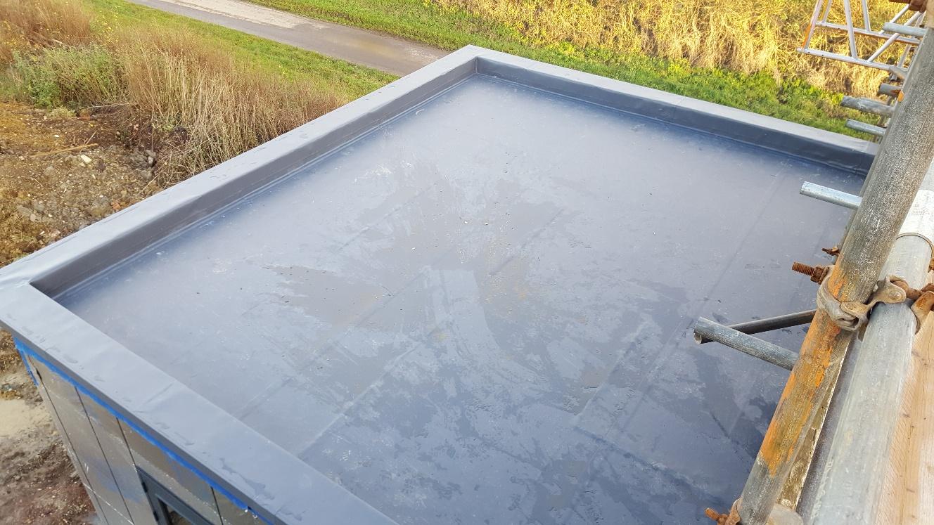

Also in on Friday were the flat roof guys, finishing the final part of the garage roof.  This is the last part of the flat roof work and I'm glad that it's all finished.  I have to admit that I completely underestimated the amount of work involved on the flat roof side of things, not least the parapets that were fiddly.  As a result, I've spent a lot more on getting this done than I had estimated before my quote came in and it also edged up with the amount of carpentry work that had to be put in ready to receive the membrane.  However, I haven't busted my contingency on it and costs are still comfortable.
Here's a photo of the finished garage roof.

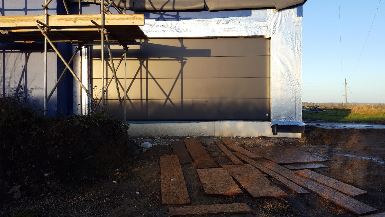

Skipping back to the beginning of the week, I had my garage door installed on Monday and I'm very pleased with it.  I find it hard to get excited by a garage door, but in so far as it functions well and looks quite nice, I'm pleased.  The door is made by Ryterna and I dealt with Joe at Dorset Garage Doors Ltd, just up the road from the house in the next village.  He is a really nice guy to deal with and his team were very nice, too, so I'd be happy to recommend them.  They also offer Hormann doors, but the Ryterna came in at about £1k cheaper, so that was the one for me!  Joe reckons the major difference is that the mechanism on the Hormann door is slightly smoother.  Personally, I'm not at all fussed if the mechanism on my door makes a little more noise for the sake of £1k.  The door itself is a sectional one and the exterior is powder coated in the ubiquitous RAL 7016 to match the windows.
