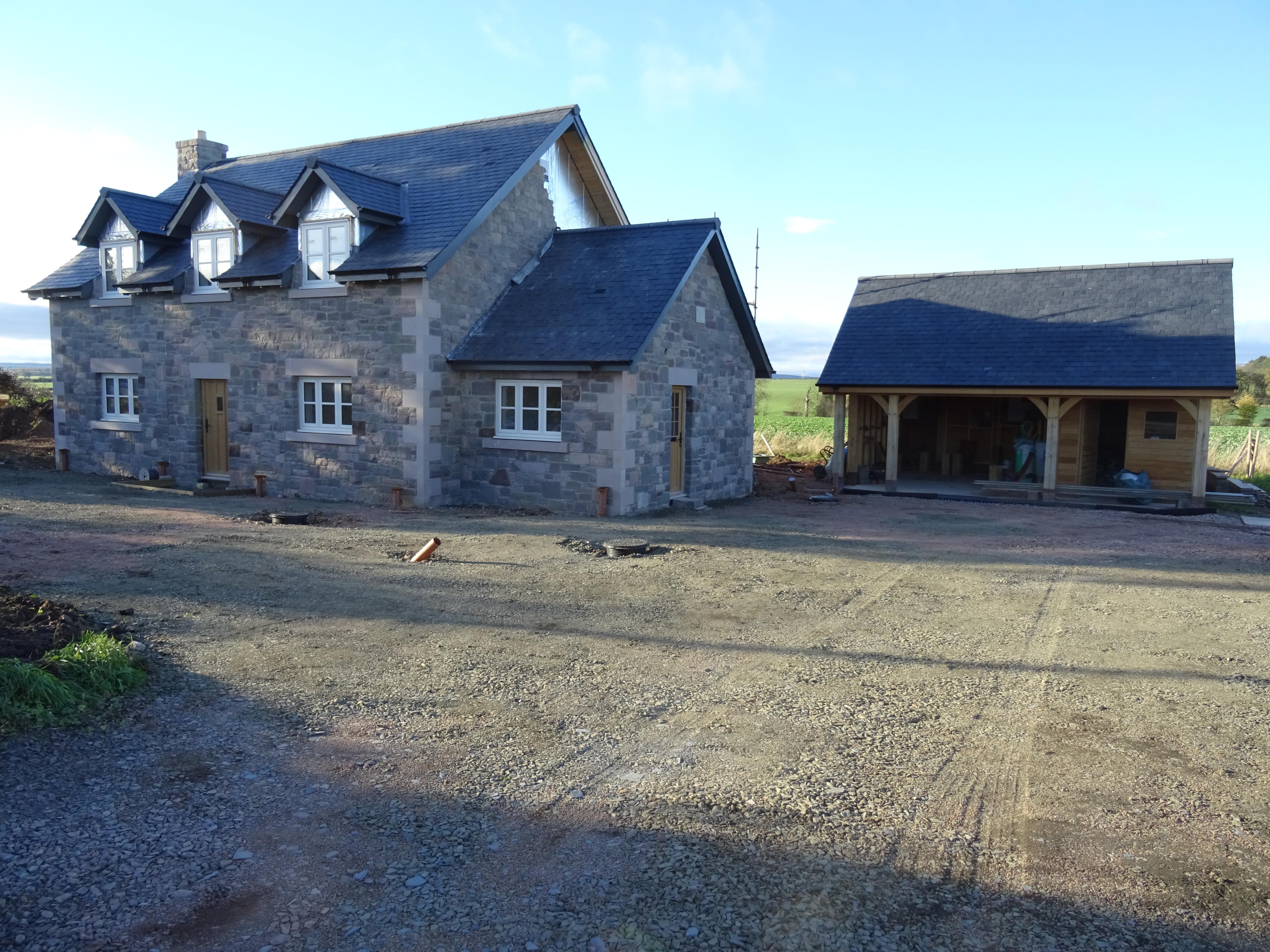

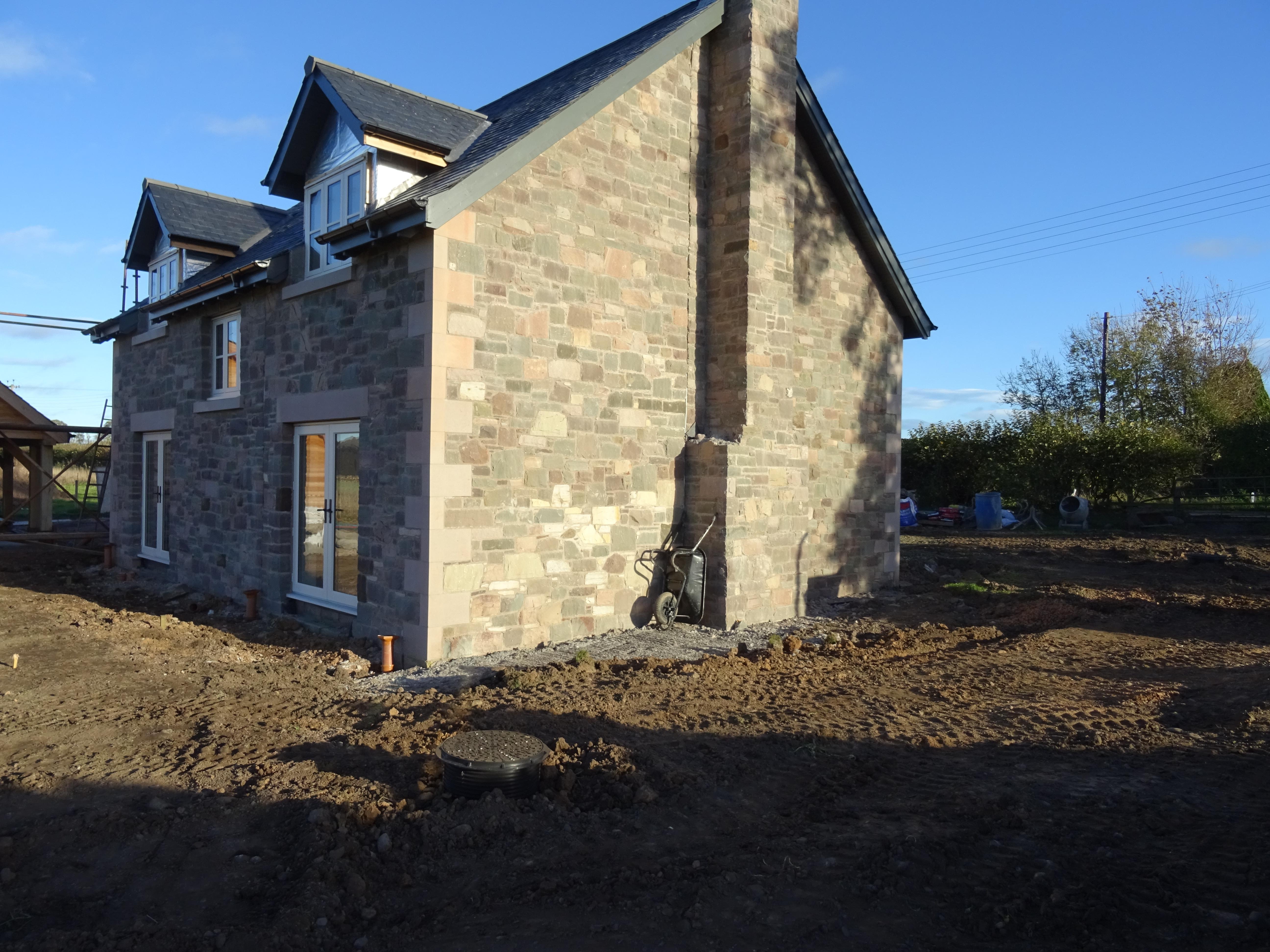

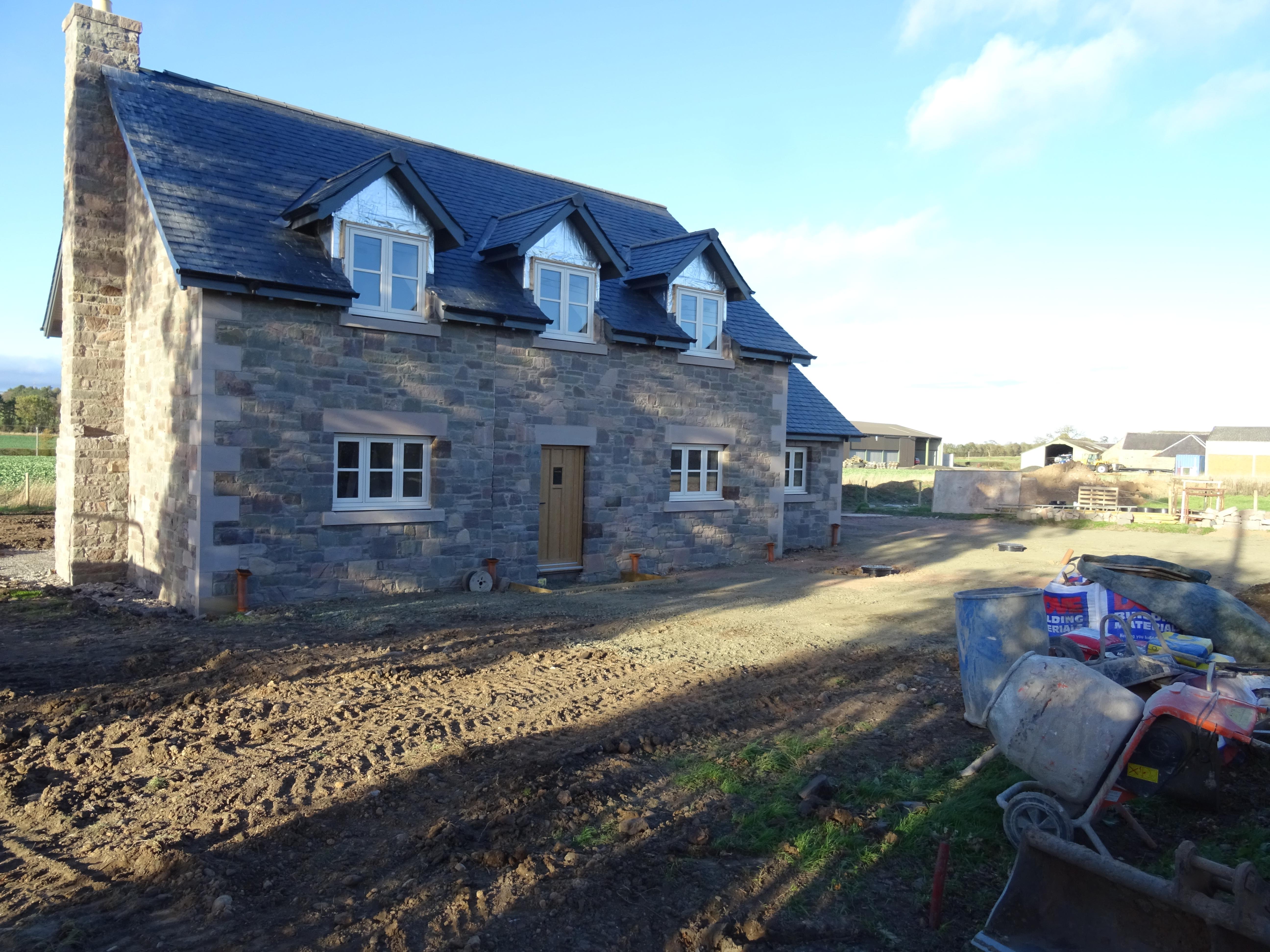

Blimey another month on there is a real sense we are getting there. So much so, we have given notice on our rental. We move in on Friday 30th November regardless!

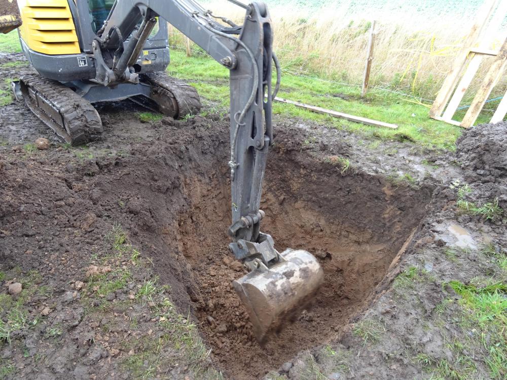

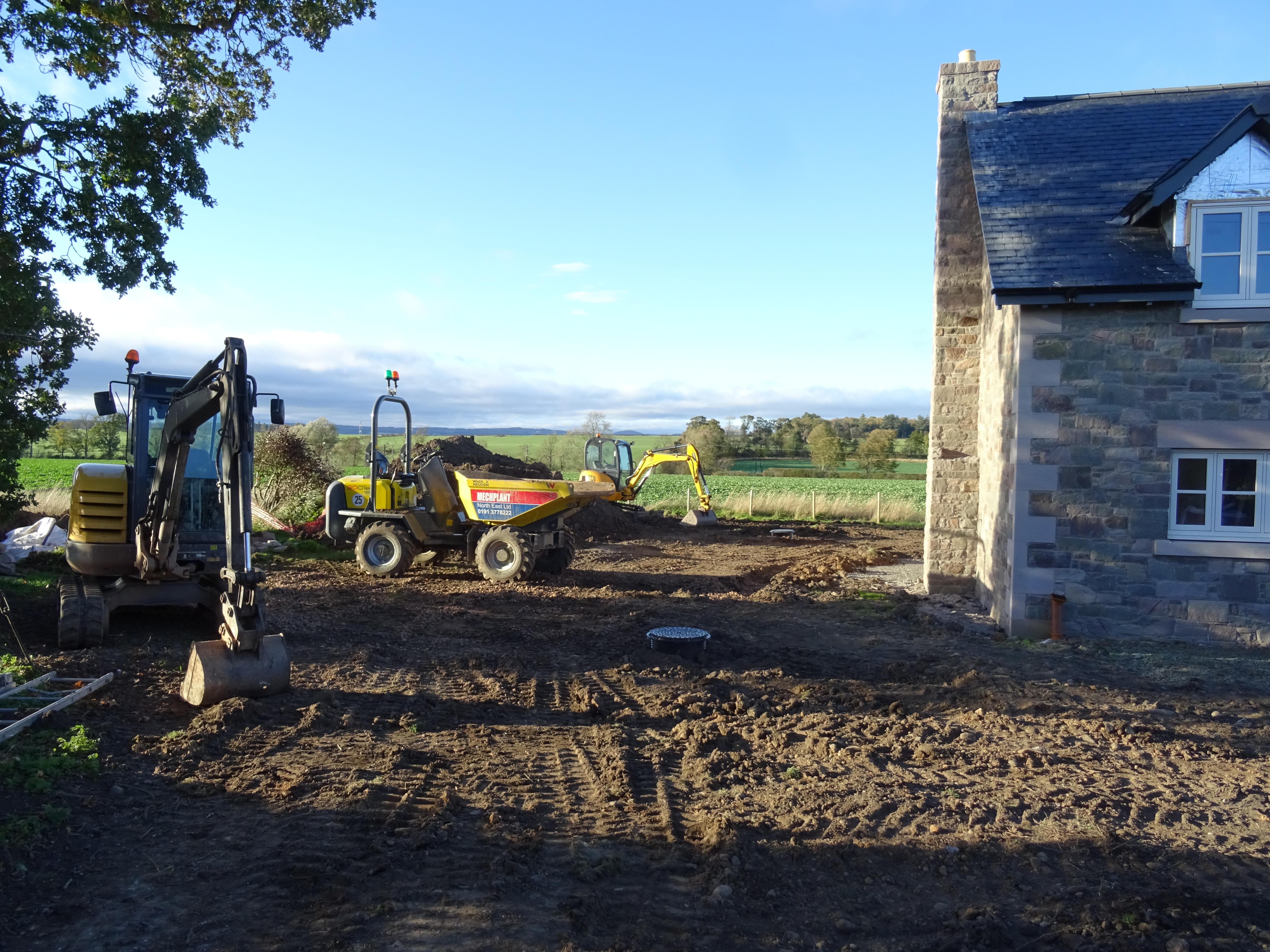

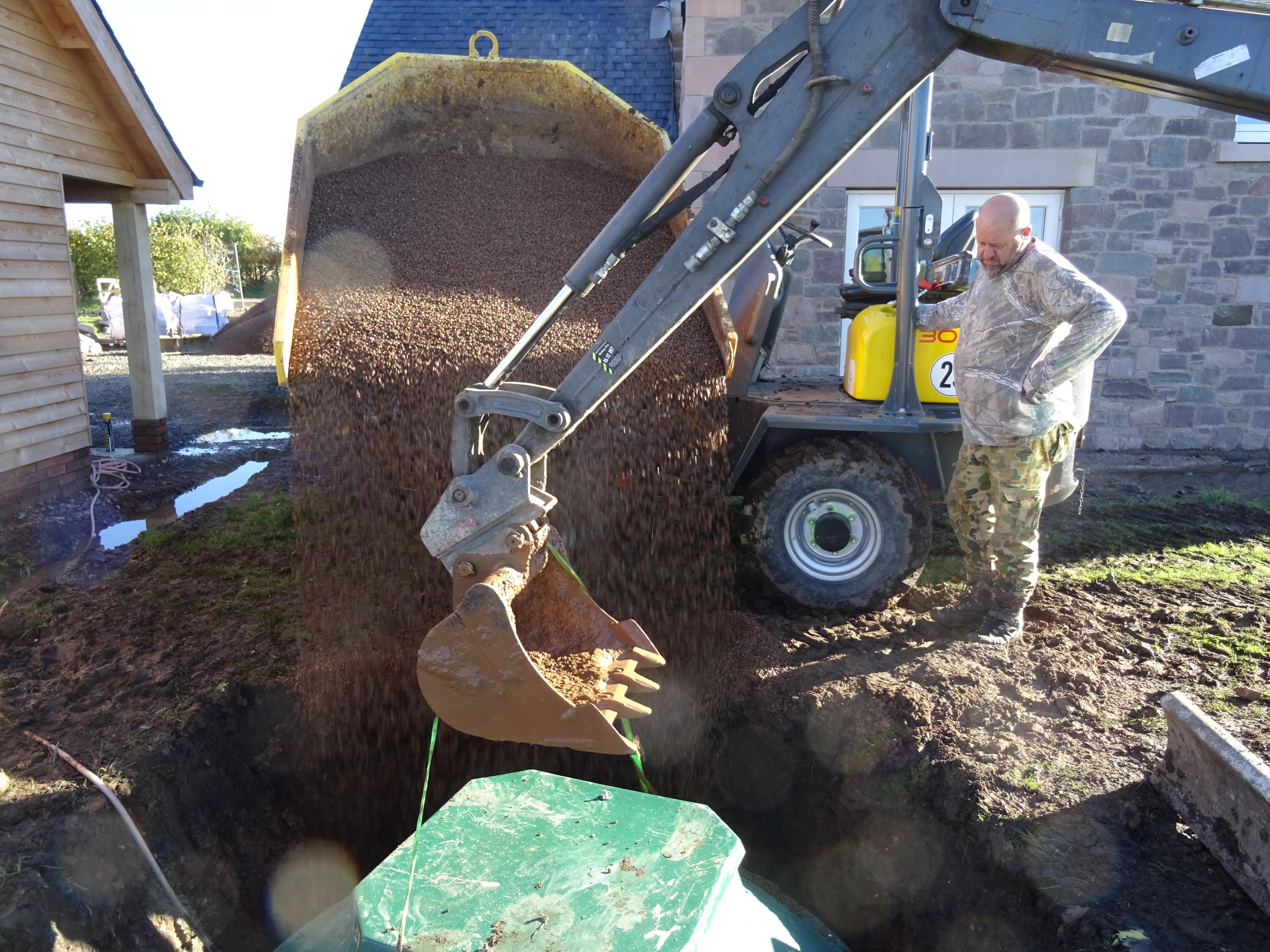

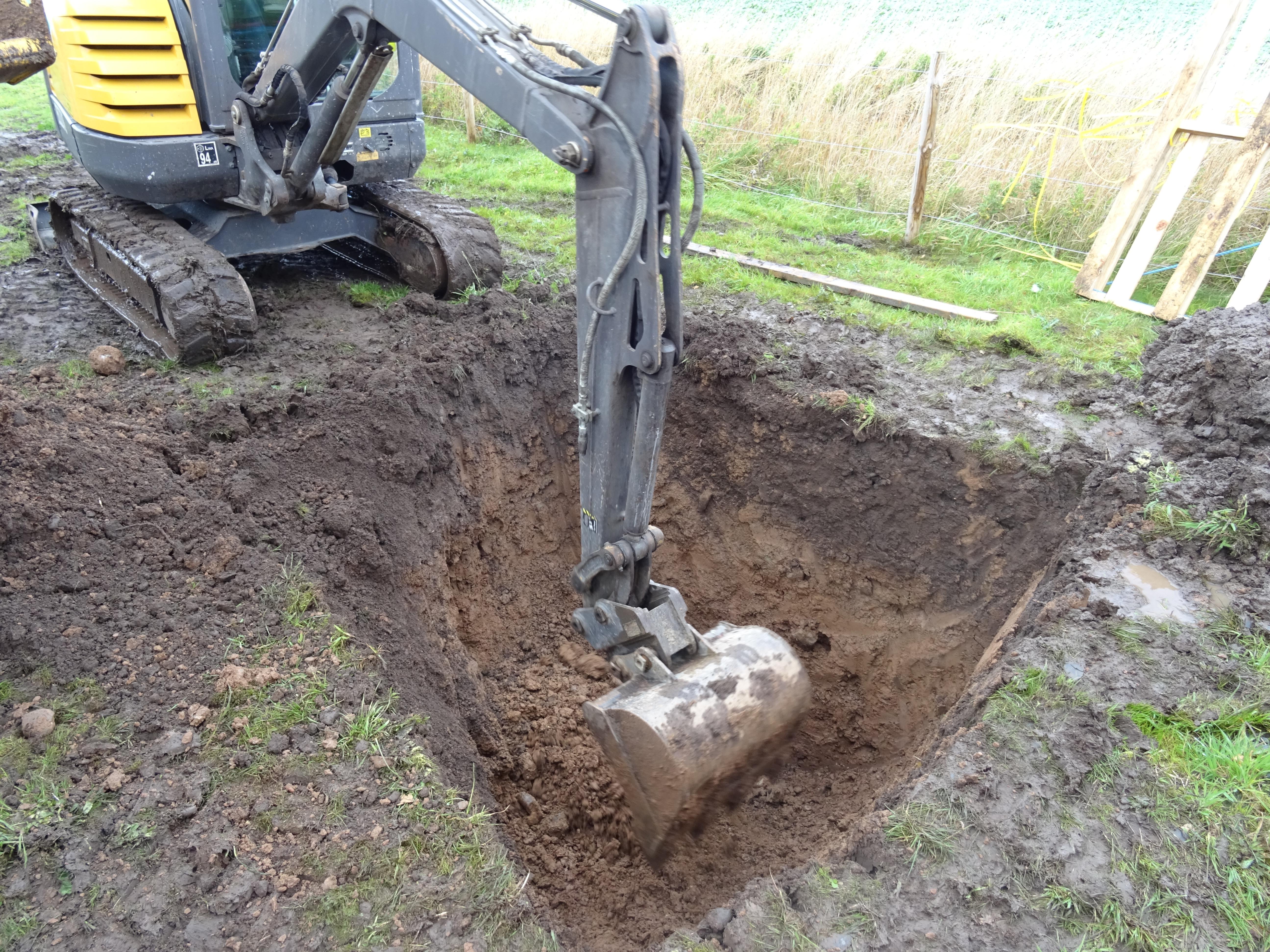

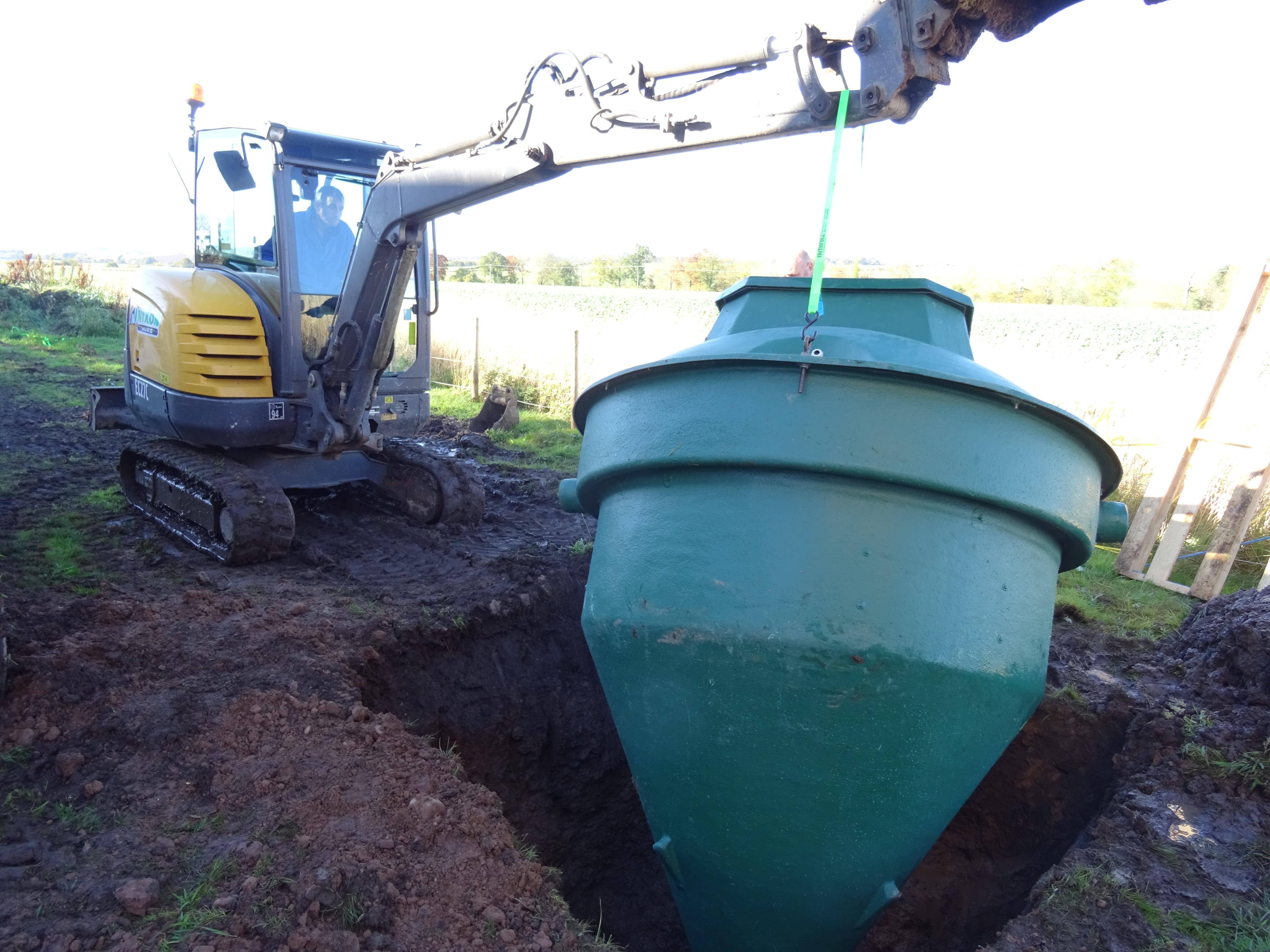

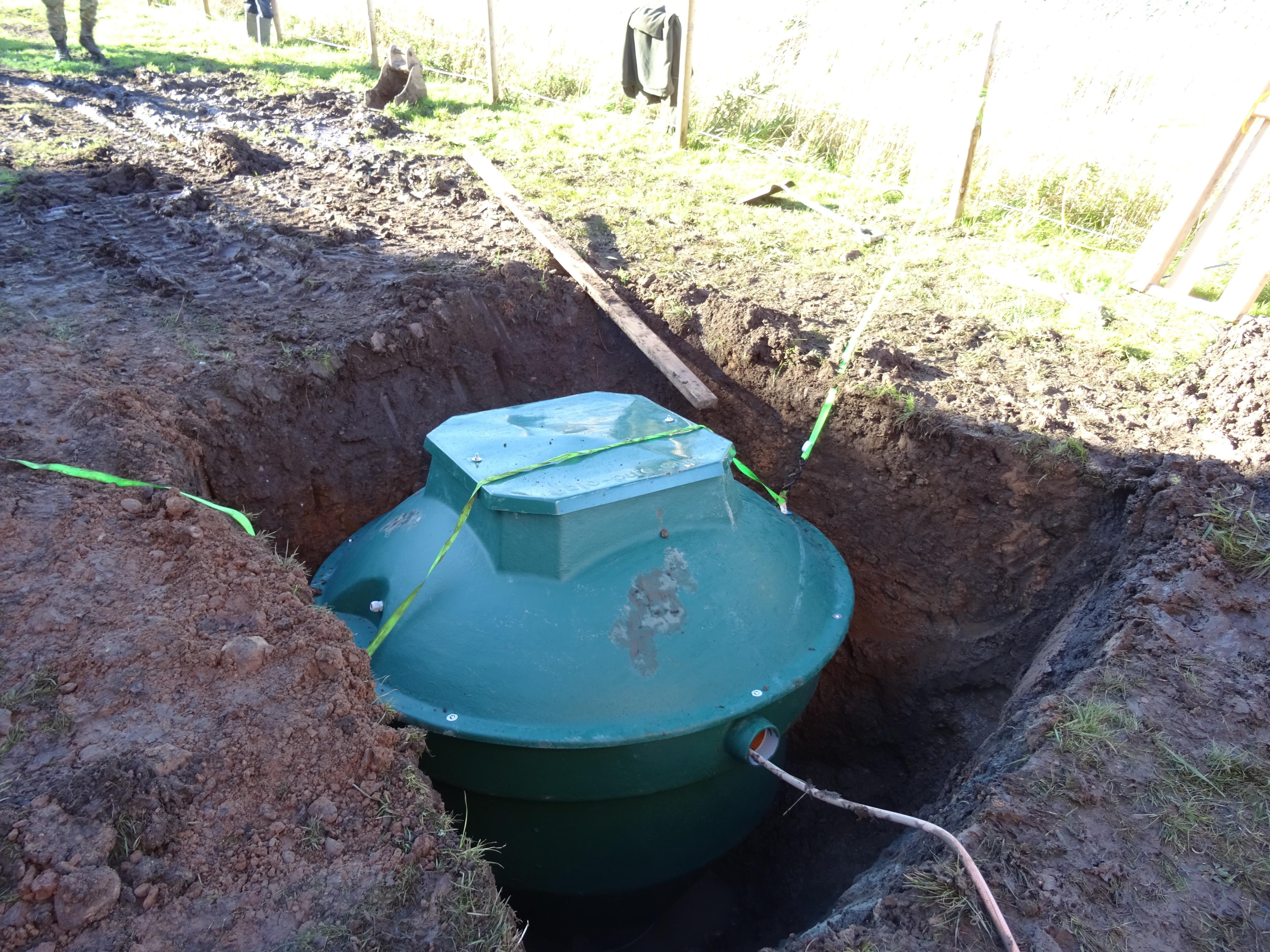

The main emphasis this month has been installing the treatment plant and drainage system. The treatment plant was initially installed, somewhat optimistically, without any anchors only for it to pop back out of the ground within 24hrs, despite being filled with water and the pit filled with pea shingle. Needless to say the second time round, it was anchored down and the pit filled with a lot more concrete than the first time.

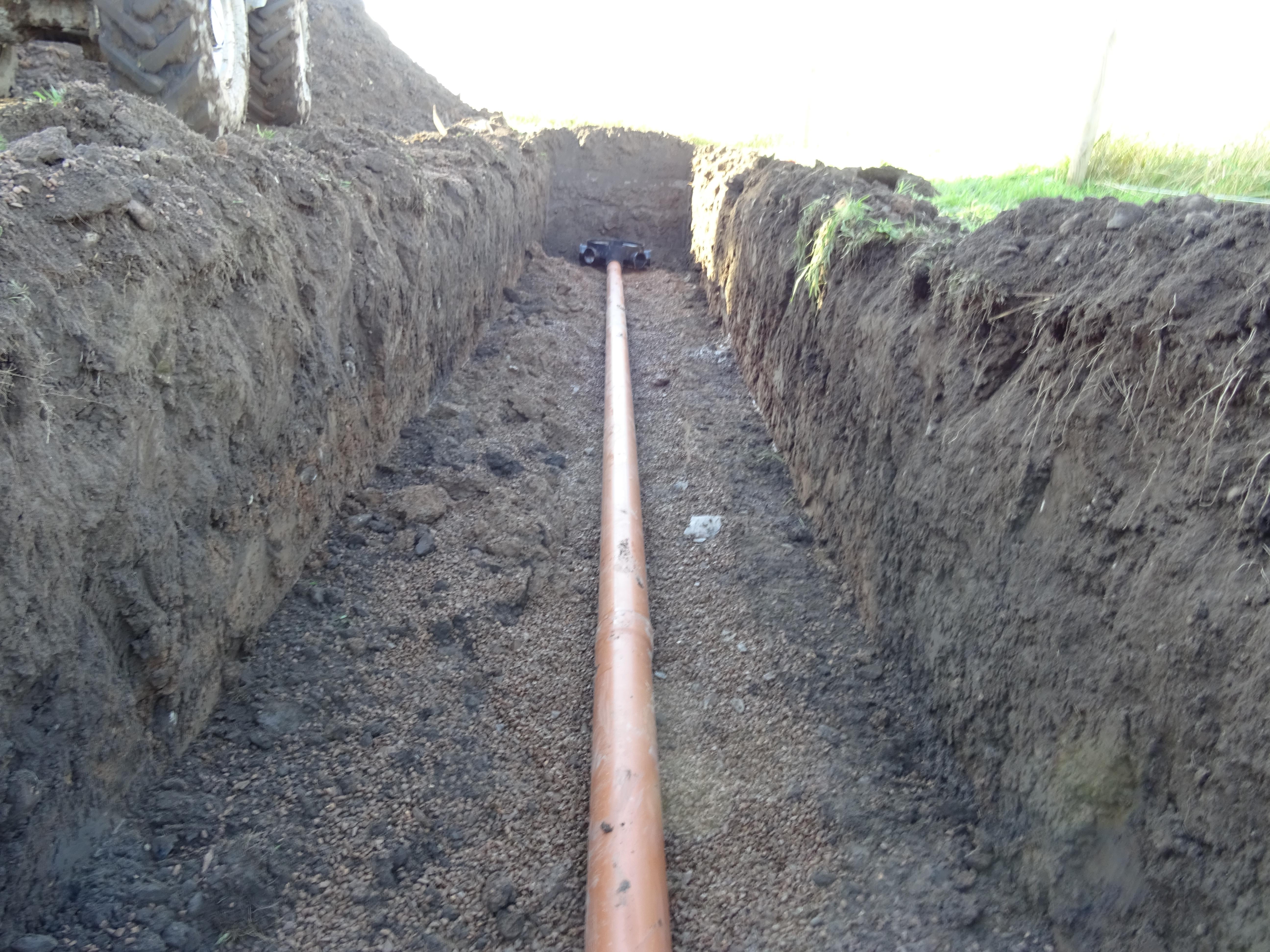

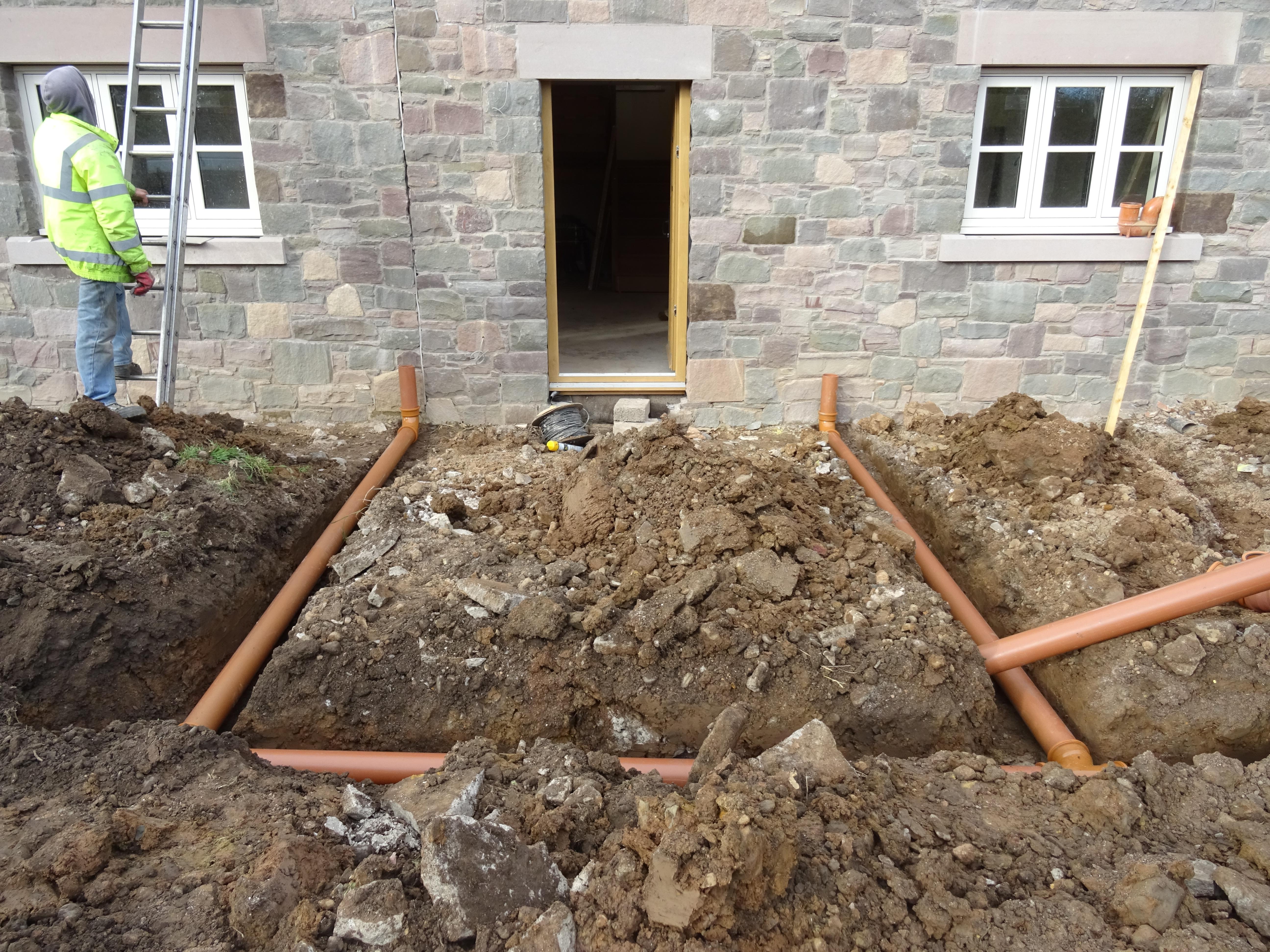

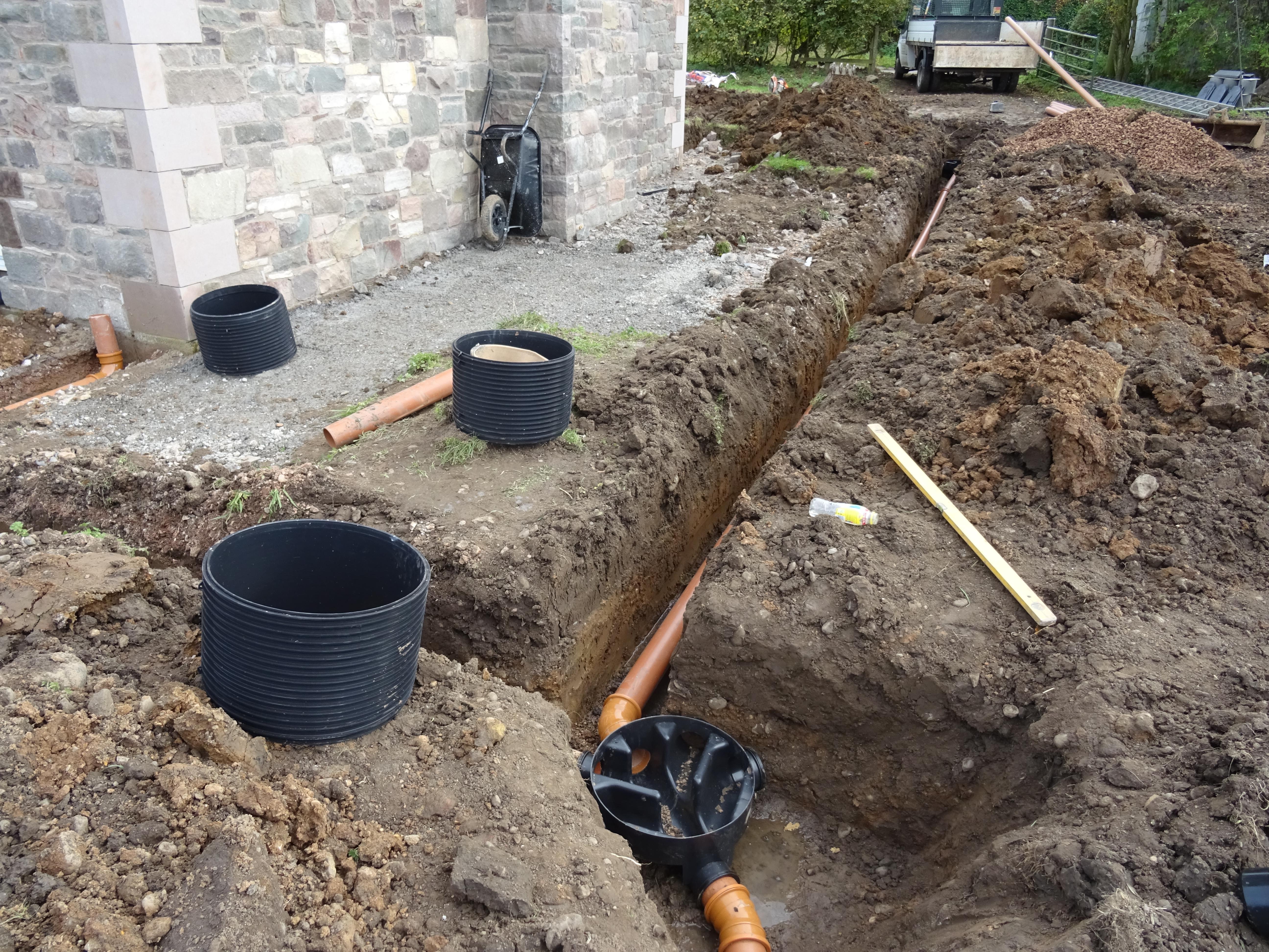

SEPA – [Scotland] had requested a soak away to be installed along with a 20 metre drainage channel 1.2 metre wide, before connecting to a field drain that eventually discharges into a nearby water course. I then had to register my plant with SEPA at a cost of £137.
The local Building Controller arrived on site to test the drains and within 20 minutes or so, both the foul and rainwater systems were passed.

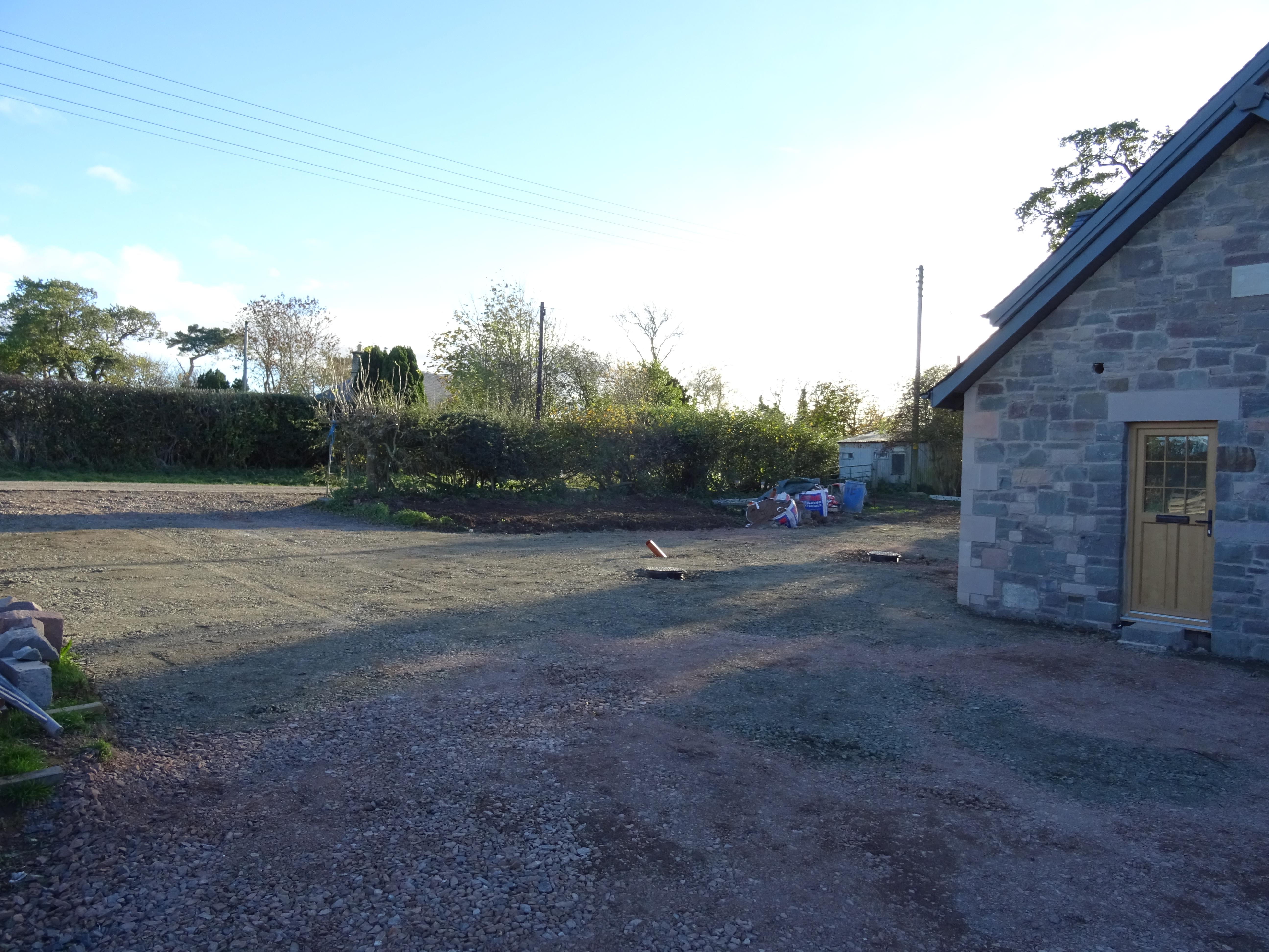

As soon as they had been given the all clear, the landscaper and his team set about back filling the trenches and levelling the site ready for a Hammer Head driveway, boundary hedging and turf across the remaining plot.
Landscaping can be one of those often forgotten costs and to assist others here are my quantities and material prices. I haven't included the cost of the turf as it is still uncertain as to whether or not it will be laid this year or next. That decision will be taken during the week.
Patio mix slabs & single slabs
2265
Setts
540
MOT 3 x 28 tonnes
448
Sand x 6 tonnes
195
Cement x 40 bags
150
Membrane - 60 metres
150
20mm whin stone x 26 tonnes
650
Internally, progress has been frustratingly slow. I had a check of my records and found that the joiner / tiler had only been on site for 11 of the possible past 30 work days!!
That said, we now seem to have a momentum building and the floor tiles have started to be laid. This in turn will allow the kitchen units to be fitted this coming week.
The electrician will have completed the second fix installation by the end of this coming week and the plumber is booked in for the following week to complete his second fix installations.
Once the tiles are down, the joiner will turn his attention to cladding the dormers.
So, over the next 4 weeks the following needs to happen –
Internally – Floor tile to be laid, grouted and sealed. Kitchen, utility room cabinets to be installed. Fitted furniture in the master bedroom to be fitted. Electrician to complete his second fix and to wire up the pump for the treatment plant. All sanitary ware to be installed. Final bits of internal joinery to be completed.
Externally – The gable end stone work to be completed. The dormers to be clad. The porch to be erected. The chimney to be finished off. The landscaping to be completed. Open Reach to connect us to the BT pole outside the plot.
What can possibly go wrong ??

You are not the first that I have know have a treatment plan float out of the ground. At least it was only water in it!!!!!
Ours is concreted in, but even so I would never push our luck and will only get it emptied in the summer after a dry spell when I can be certain the water table is low.
  • Thanks 1
Top tip @ProDave  - I will certainly bear that in mind because we were certainly caught out by the water table. We found it hard to believe that the water table would "force" the tank out like it did.

Great progress.
Interestingly our inspection chambers, drainage surface and soil pipes were put in at foundation stage. I was quite surprised at the cost of the materials!
Where is your surface water going to?
  • Thanks 1
Link to comment
42 minutes ago, vivienz said:
You can make great mulled wine in a slow cooker, too!
Oh! Might have to give that a whirl!
Link to comment
Ours too, in fact apart from the pressure test building control signed off the drains etc before the frame arrived.
Link to comment
17 hours ago, Thedreamer said:
Great progress.
Yes, I too was surprised the drainage system didn't go in at the foundation stage but was guided by our builder. Not sure there is a right or wrong way but I was concerned that the weather would not hold up by the time they were put in. Guess he was lucky and got away with it!
The surface water runs off to the existing field drain discharging eventually into a nearby water course.
