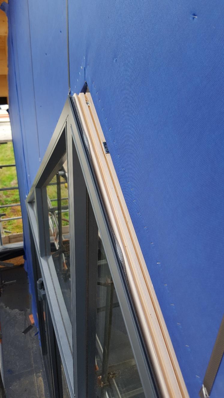

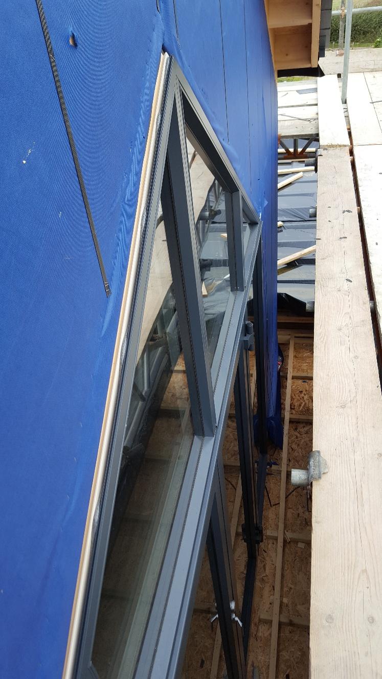

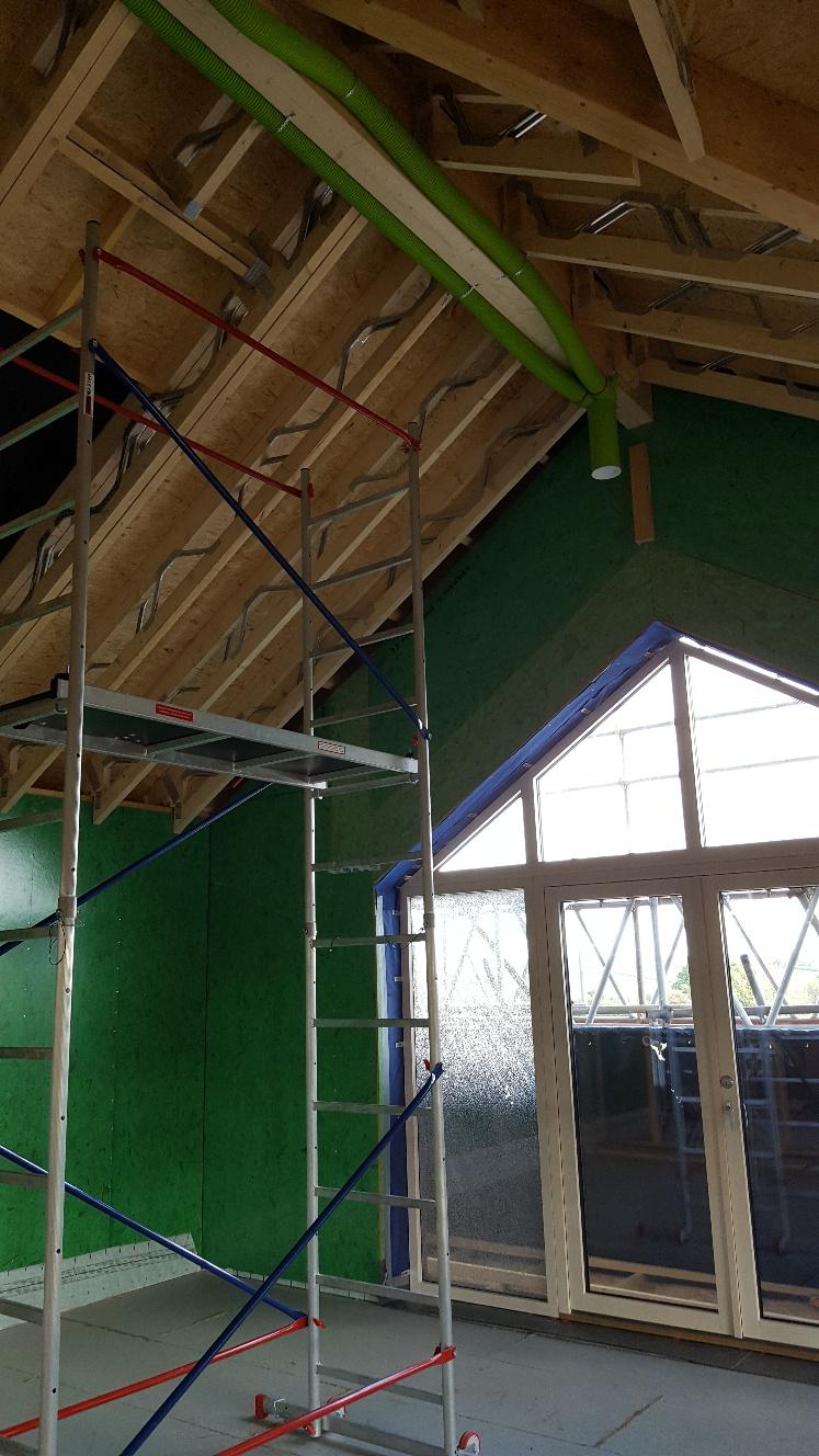

When I first saw it, I thought 'oh bugger, another window problem' and promptly got on the phone to the guys at Norrsken to ask what they thought of the photo I'd just sent them with a clear image of the problem.  This is what I sent:
And this is what it's meant to look like:
Can you spot the difference?  You're buildhubbers, so of course you can.  In the first photo, the apex of the triangular window sitting on the French doors and side panels clearly protrudes by some distance.  It's about 3cm.
At this point, and as before, what I most need to know is a) is it a problem? and b) how do we fix it, if it is.  And at this point, as before, Norrsken were hot to trot and the installations manager, Mark, along with his very bright and shiny new spirit level, did a swift dash up to north Dorset to come and see for himself exactly what the problem is.  I should explain that this window consists of 3 elements.  There are the central French doors, a glazed panel each side of the doors and then the triangular window that sits on top of all this.  When fitting, the installation team set everything up with a laser to make sure it's all dead on, and they took great care to make sure everything was right.

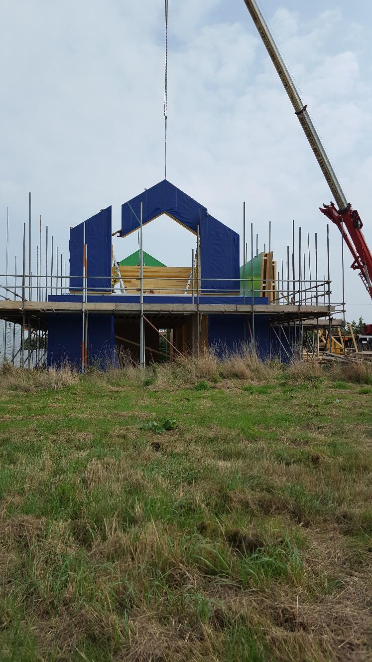

Because of this, I wasn't entirely surprised when Mark from Norrsken established quite clearly that the fault isn't with the windows, but with my MBC timber frame.  Directly above the triangular window, there is a steel with an apex in it, that is then boarded over.  You can see in this picture from a previous entry how these are put into place by MBC, and this is the section that has caused the problem on the west side:
So, first off, is this an issue?  This was my first question to Mark and, in particular, does the fact that the window frame is so proud of the wall compromise the thermal properties or insulating quality?  Thankfully, he assured me not, so I'm happy to accept this.
The next issue, is the physical problem of the top of the window protruding by about 3cm from the timber frame exterior wall.  It's fairly standard practice to have 25mm counter batten on the exterior, to which is attached whatever outer skin is covering the building.  Fortunately for me and MBC, I have planned all along to have 50mm battens on the outside so that a decent sized service cavity is created to run any exterior wires and cables through.  It's possible that I could have got away with 25mm but I preferred to spend a bit more on the larger battens and make life a bit easier when installing stuff on the outside.  This means that the slate cladding on the upper floor will be able to largely cover the error, but it will quite probably be tricky to get a decent finish between the window and the cladding as I had been planning to use powder coated aluminium to do this job and it won't be the easiest thing to fit with such a variation in the gap.  I'll tackle that when I get to it, but any suggestions are welcome.
Okay, so all in all, it's not a disaster but a pain.  I am, however, annoyed because MBC didn't know that I was planning 50mm battens and, aside from anything else, it's really disappointing that having done a good job on the vast majority of the build, this error slipped through.  There were enough spirit levels on site throughout the build that it shouldn't have been so difficult to run one up against this fairly fundamental section of the build, particularly as there was a whopper of a window going into this wall, to make sure that everything is true for the parts of the build that follow on after.

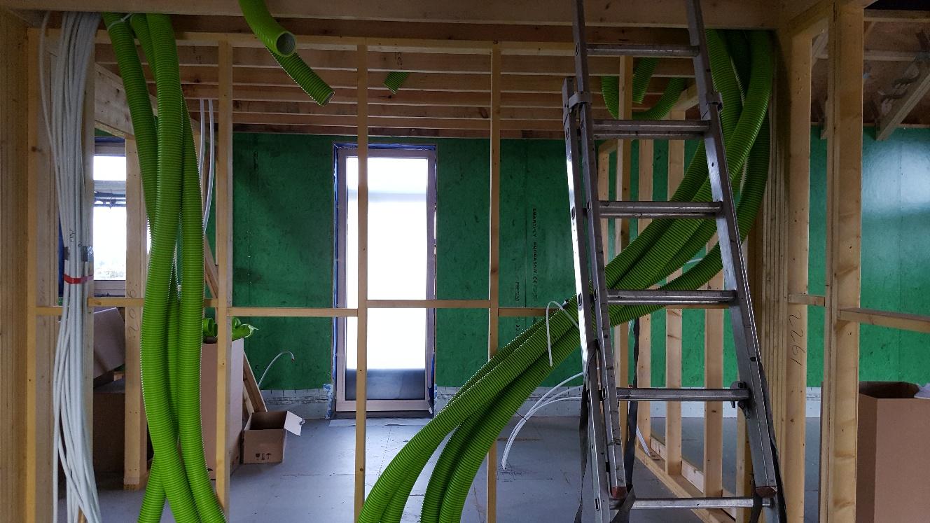

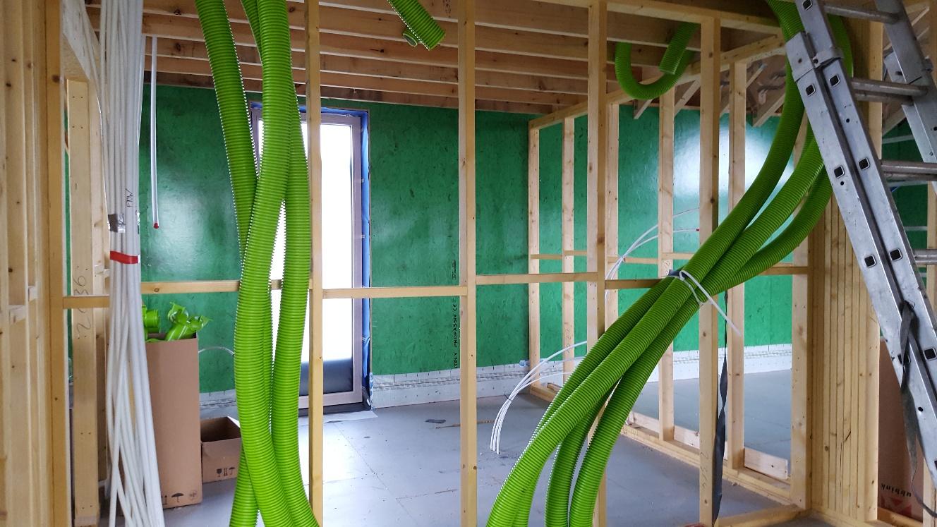

In the meantime, a few other things have gone on at the build.  A start has been made on putting in the ducting for the MVHR and shoving some of the UFH pipes and manifold towards where it will end up.  The UFH manifold for the upstairs is going up into the loft section.  In the original plans, the upstairs landing was vaulted, but the decision was taken early on to board this out and create a loft space that could then be used to stash away all the MVHR kit and other ancillary equipment, including the upstairs UFH manifold.  There is another bit of kit going in there that is a heat pump but used to cool rather than heat air going through the MVHR system and thus provide active cooling in the summer to complement my shading from the brise soleil and exterior roller blinds on the south facing windows.
Here's a photo of the MVHR ducting and UFH pipes coming up through a cut-out section in the floor and up into the loft space.  The stud wall that you can see divides the landing from the en-suite for the master bedroom; it is planned to be a twin stud wall and so, once done, all the pipework and ducting will be hidden in the cavity of the twin wall.
More of the same:
The plenums for the MVHR will sit at the far end of the bedrooms, i.e. near the windows.  The idea is that this will achieve a proper through put of fresh air through the entire room, rather than just circulating around the door and landing areas.  You will see that the plenums are quite a bit lower than the central glulam beam supporting the vault.  The plan here is to introduce a central flat section along the ridge, low enough to cover the ducting and the glulam and the plenum will then just pop out of the plasterboard.  Whilst this means extra cellulose being required for the increased volume of the roof section, it will make detailing it and covering it in far easier for MBC when the time comes to do that, so there's a decent quid pro quo there.
A major benefit of stuffing the MVHR ducting into the ceiling section that will be filled with cellulose is that the pipes up there don't need to be insulated, which would normally be the case.  The ones for the ground floor are currently getting their NASA-style coats and I'll show some photos of those in the next post.  This also means that it's given a reduction on the cost of all the MVHR kit as the insulation for the ducts isn't particularly cheap.

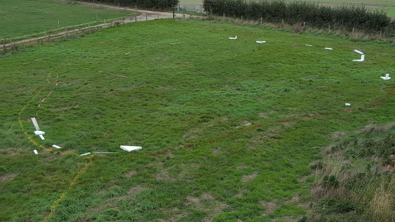

The other groundwork task is to start digging out the pond.  OH has decided on the shape and size and I used a couple of cans and left over EPS to mark out the perimeter this morning.  Before anyone asks, these are the answers: no swimming, no fish, no fishing, no duck shooting.  It's a wildlife pond and that's it.  But it is a bloody big pond and I'd like to get it dug before we get some serious weather in as we can then start to get a feel for just how well or not our clay soil will retain water and start to plant up the margins once we have a better idea of what we're dealing with.  It's hard to see the line marking, but this is the view from the top lift of the scaffold.

That would seem to be a bit of a shocker from MBC and difficult to understand how it could have happened. Is that section just not vertical and leaning into the house, or is it not as thick as it should be? Have you approached MBC about it? Is there anything they can do to make good the error?
Link to comment
As it stands, Russell, I haven't approached MBC because I dont think that they can do much, short of dismantling the roof. If performance isn't compromised and the building won't fall apart then there isn't a problem to solve, as such, other than the potential issue with cladding. I shall draw it to their attention, however, in case they there is any action they want to take.
Link to comment
Agree - can it be remedied ? Best to get it right (or better) at this stage rather than try and work around it. We had a few window openings that needed tweaking but nothing as far off vertical as that.
Also, curious about this - A major benefit of stuffing the MVHR ducting into the ceiling section that will be filled with cellulose is that the pipes up there don't need to be insulated, which would normally be the case.  The ones for the ground floor are currently getting their NASA-style coats and I'll show some photos of those in the next post.  This also means that it's given a reduction on the cost of all the MVHR kit as the insulation for the ducts isn't particularly cheap.
We only insulated the short runs of 180mm steel radial ducting (intake and exhaust) from the unit to outside vents - really only the intake needed insulating as it's the one that gets cold and would otherwise drip with condensation but we did both.
All internal ducting (from unit to manifold and from manifold to vents - i.e. your green pipe) sits inside the insulated envelope of the house so needs no insulation, unless I'm misunderstanding your install.
Link to comment
The exhaust should be nearly as cold.
Link to comment
Especially if, like us, you have an MVHR with a built in air-to-air heat pump.  I've seen ours blowing out exhaust air at below freezing on the few times I tried it out in heating mode.  I insulated both the external ducts, the fresh air in and the exhaust air out, but most of the internal ducts are running in areas surrounded by insulation, and even the short sections of duct that aren't don't have any condensation problems, even when the supply air side is handling cool air with the air-to-air heat pump running in cooling mode.  I'd be surprised if there was any problem with condensation, as that cooled air is pretty dry, having had a lot of the incoming vapour condensed out in the heat exchanger.
Link to comment
Vivien is having a duct-air cooling device for summer cooling. I imagine that is why her ductwork needs insulation.
Link to comment
Yes, you are correct - brain not fully in gear today!
Link to comment
Got it - given the distributed cool air is in the twin walled plastic pipe is the insulation to prevent this warming up or minimising condensing on the outside of the pipe? Quite curious as we obviously only considered the use of MVHR without any additional cooling but if we were to upgrade in the future, wondering if this would be an issue.
Link to comment
We have the same ducting and air cooling and there's no condensation at all on the internal fresh air feed ducts.  I did look for it the first few times we turned the cooling on, just in case there was a problem with condensation on the outside of the ducts, but in practice the outside surface doesn't seem to get cool, probably because the design of twin wall ducting inherently provides a degree of insulation.
In cooling mode our system usually runs with the fresh air feed air to the rooms at around 12 deg C, and the outside of the ducts, where they are exposed, don't seem to get more than a degree or two below room temperature, so well above dew point for a typical day when cooling would be needed.  Might be different if we lived in the tropics, but here it seems that we rarely, if ever, get the combination of high temperatures with high humidity that might pose an external condensation risk on that ducting.
  • Like 1
Link to comment
Good point. Perhaps insulation is not needed therefore, unless her cooling system achieves considerably greater levels of cooling.
Link to comment
The idea was to preserve the cold air as the ceilings are high and the runs, at least a few, are quite long.
The exhaust runs aren’t insulated. ?
