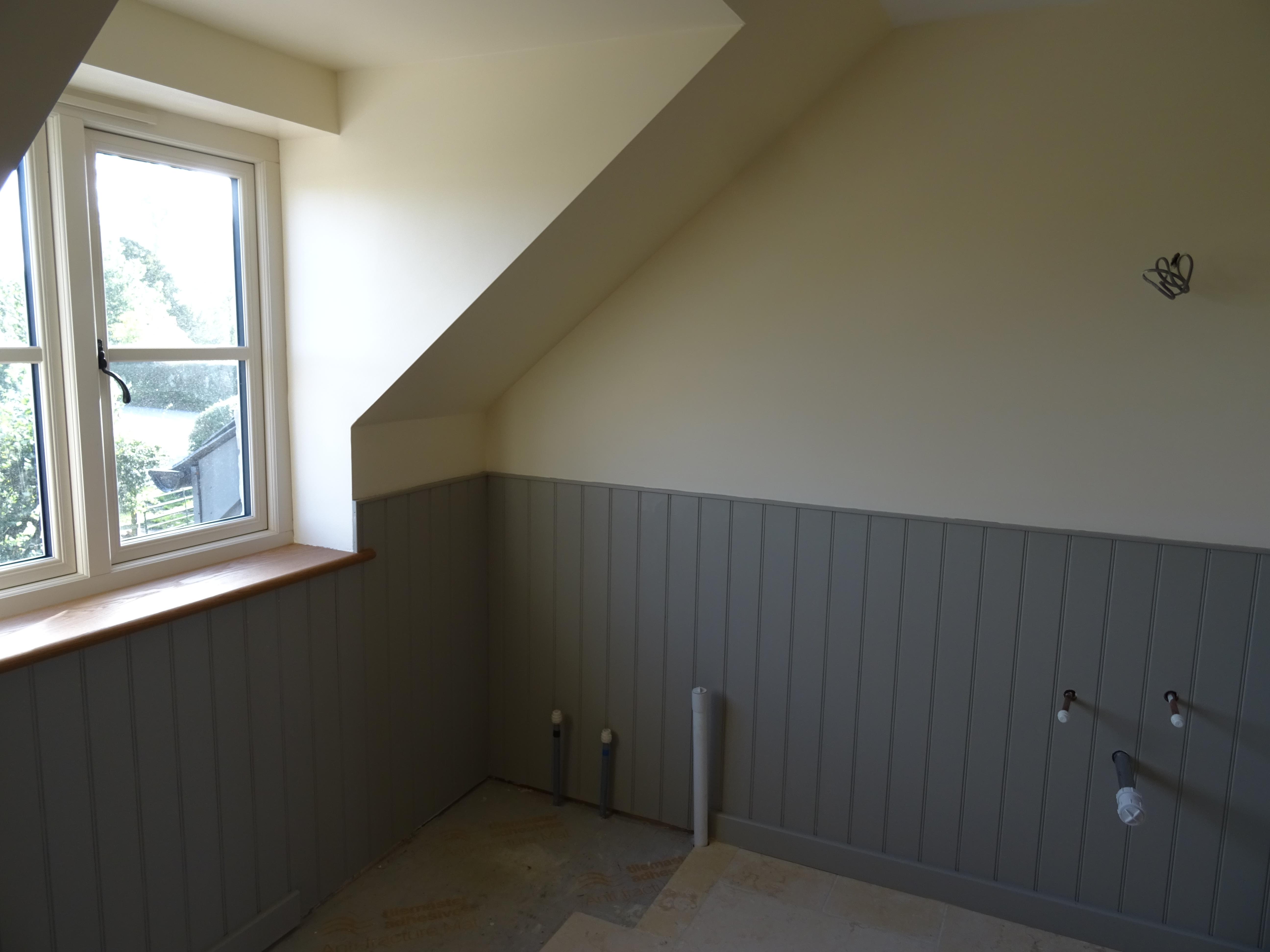

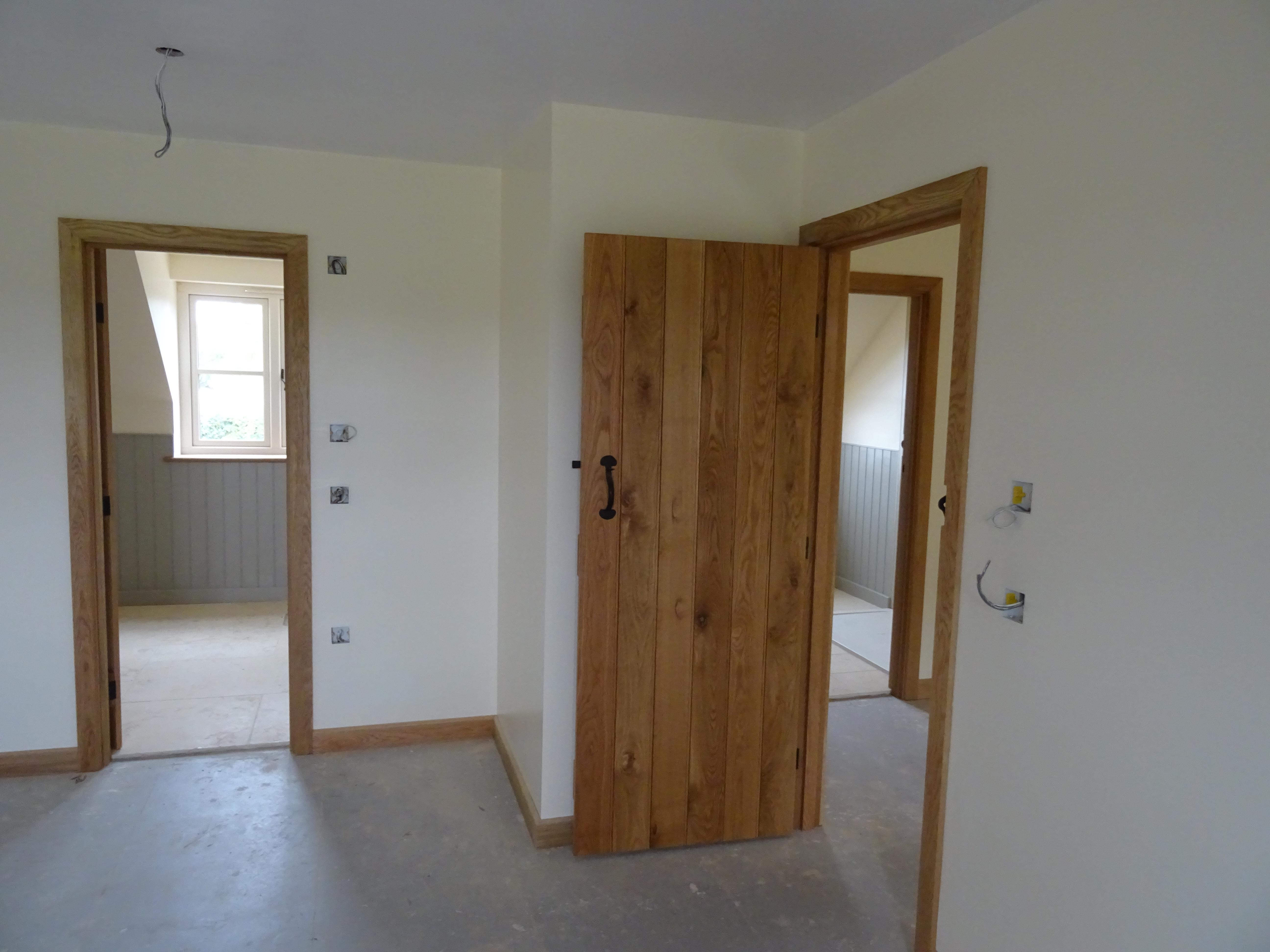

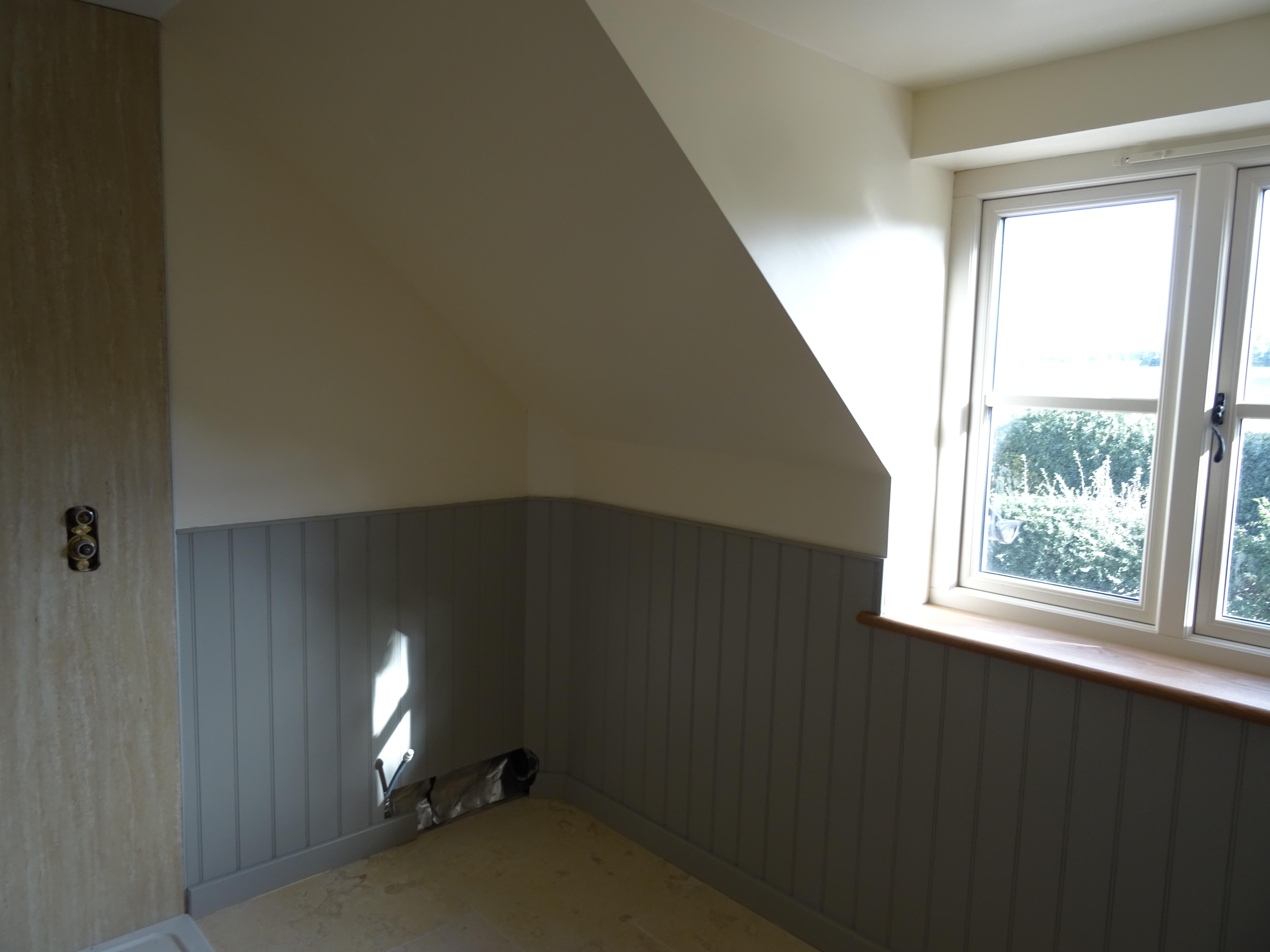

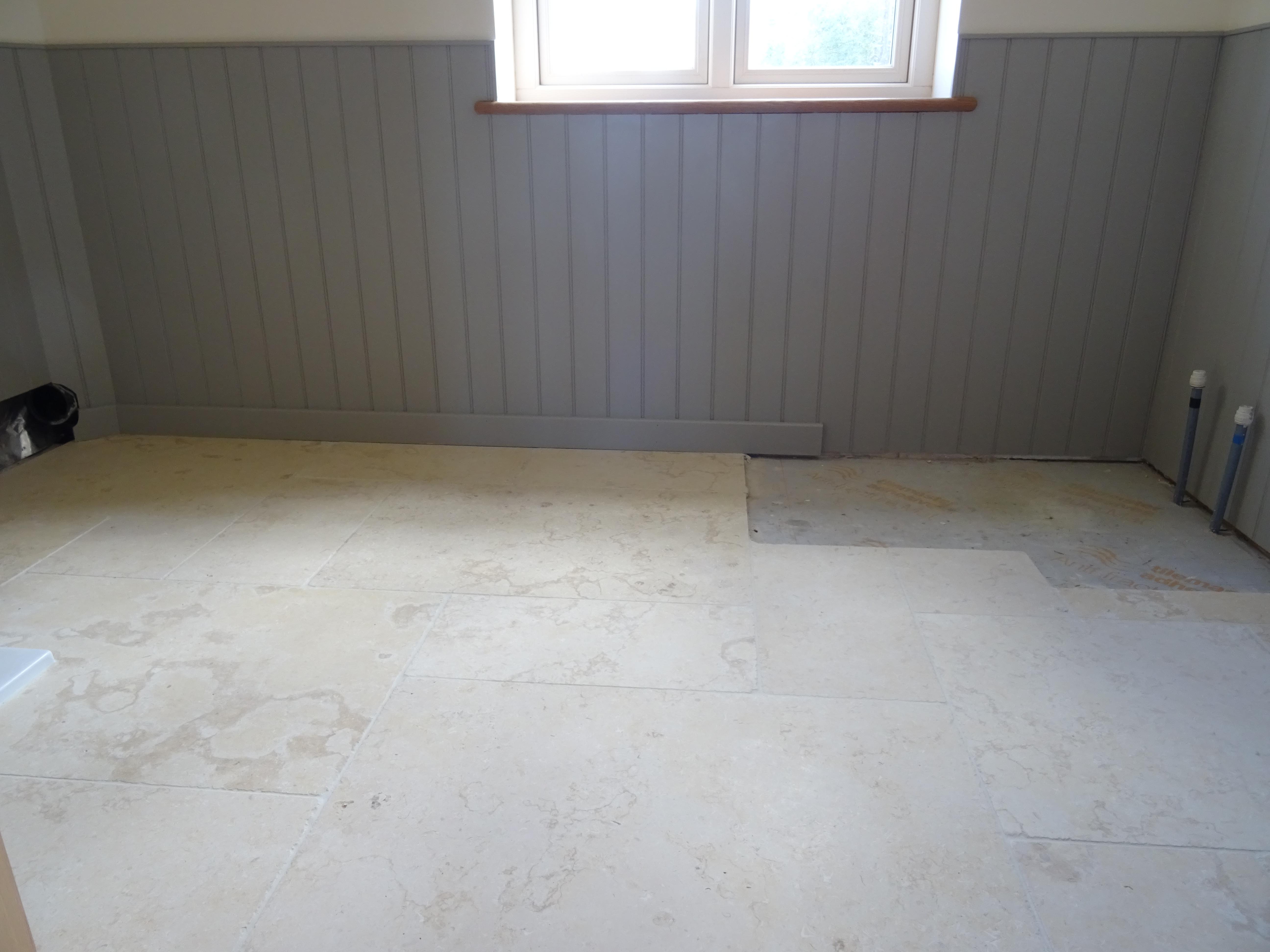

The upstairs is now complete – in as much as we are still awaiting the sanitary ware to be fitted – but the rooms have been decorated, the bathroom and en suite, paneled and tiled.
The paneling is moisture resistant MDF, which came in long panels, making it a lot easier to fit and also better than individual T&G panels. The floor tiles, laid in an OPUS design, went down on anti fracture matting.

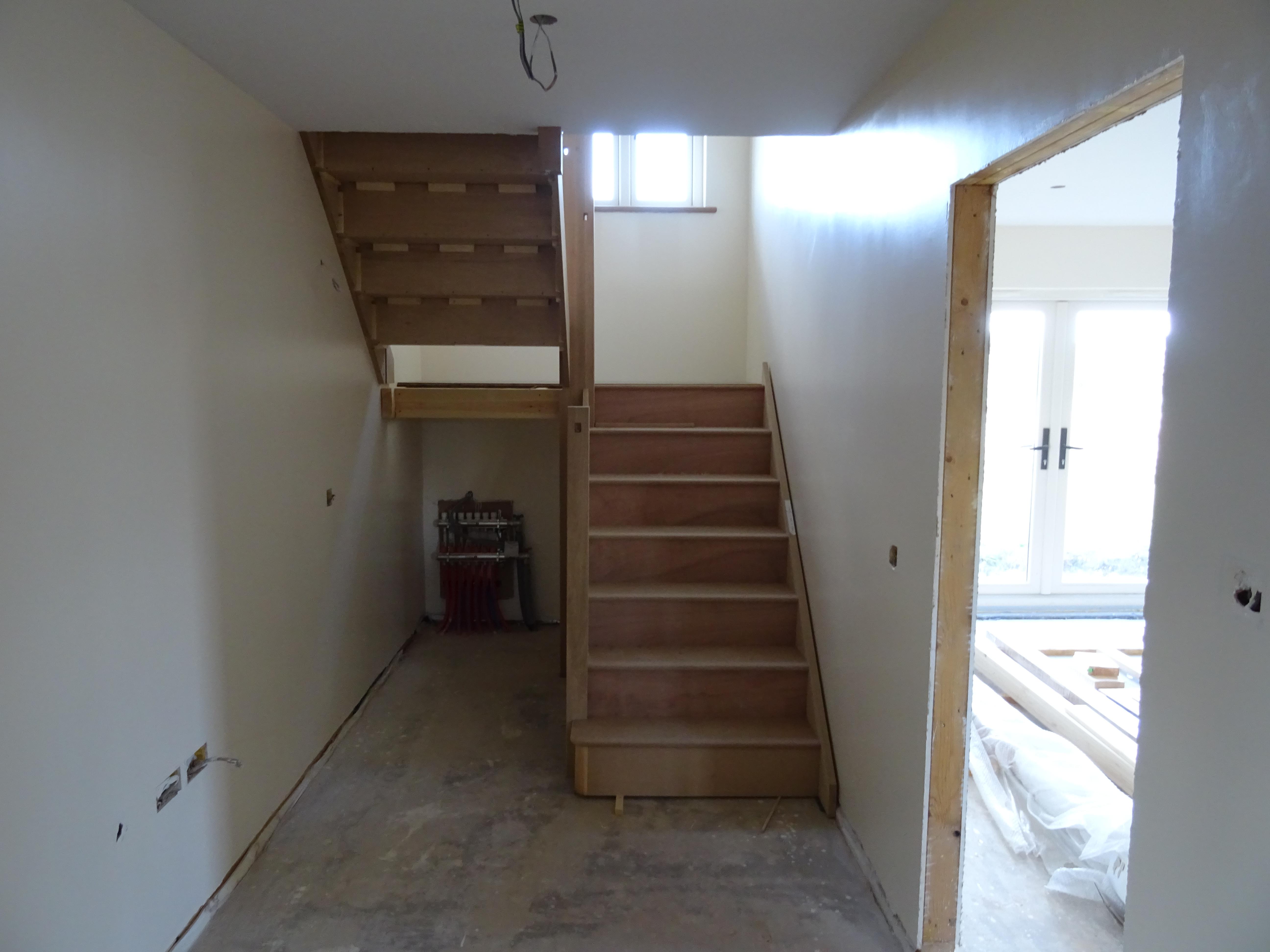

The oak staircase arrived and has also been installed. We have gone for a predominantly oak staircase. The main stair treads are redwood as they will be carpeted. We decided to go against a full oak staircase as we were concerned about the noise, safety element when coming down them and also due to the financial costs. The cupboard under the stairs is yet to be completed. Once done this will prove to be a very useful storage area.

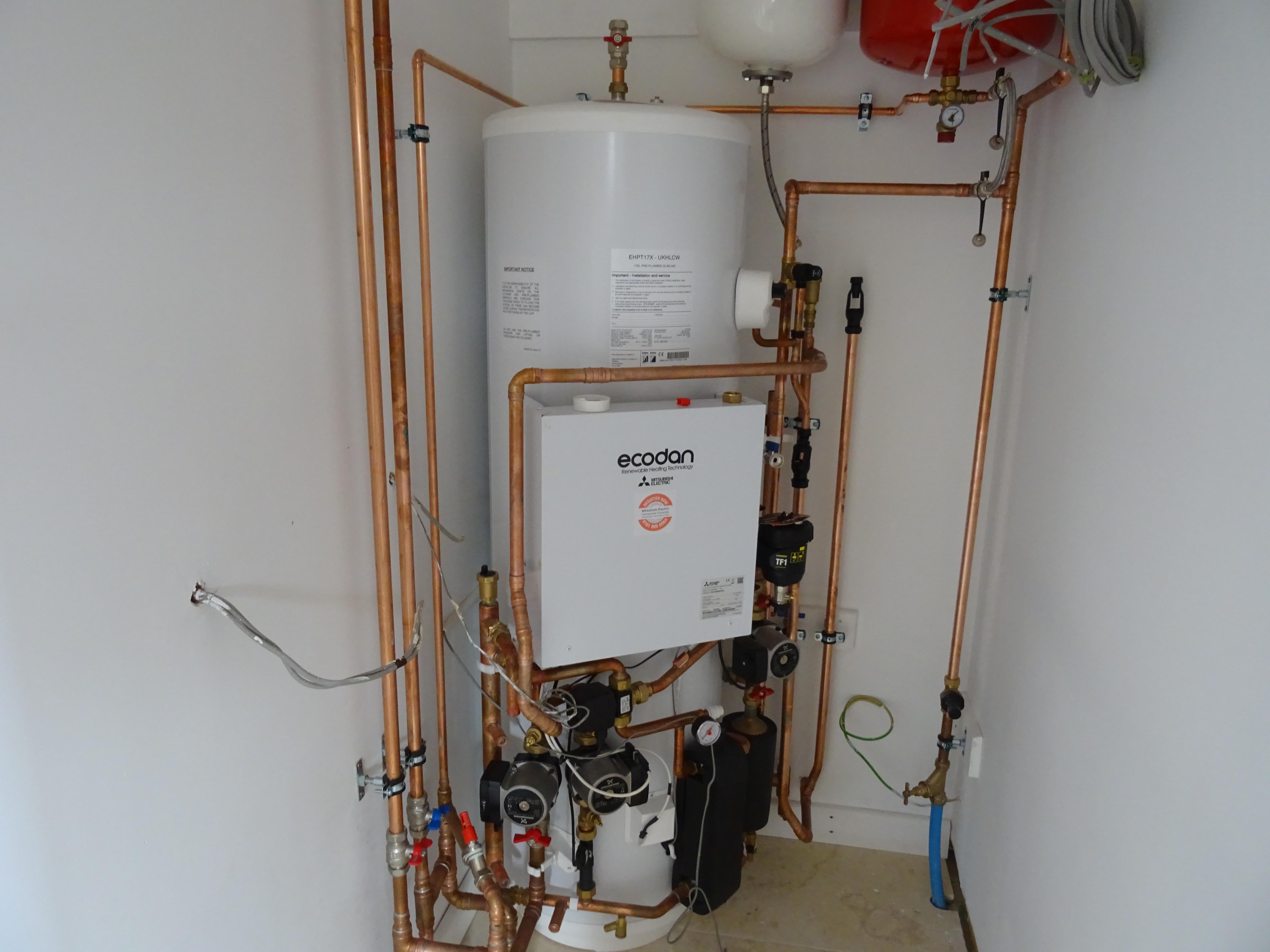

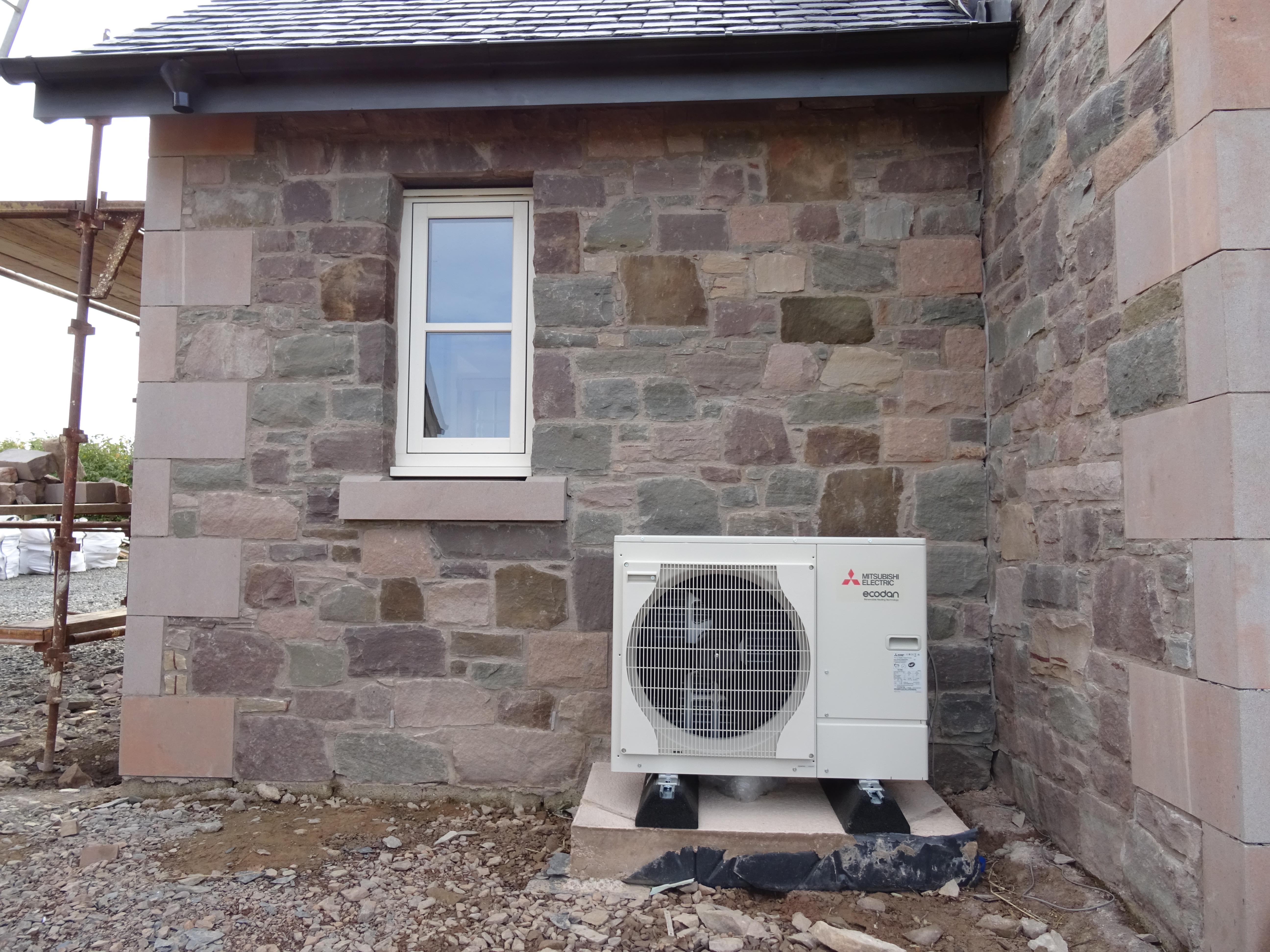

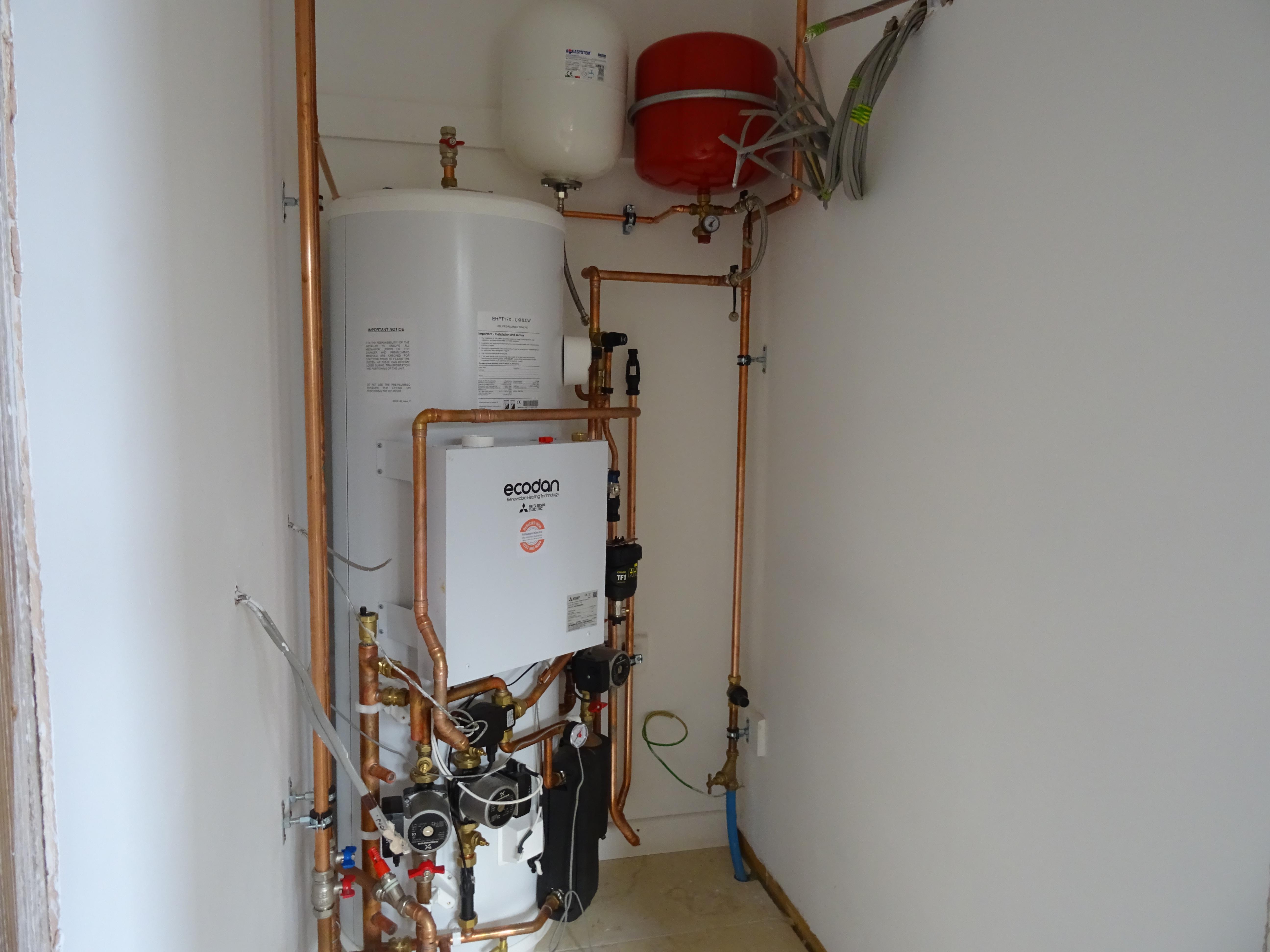

Downstairs, the cylinder and associated items are being installed together with the ASHP. The cylinder itself is a 170 litre tank which will have a recharge time of 37 minutes to 40 degrees.
This will allow the UFH to be fired up and thereby ensuring the screed floor would have dried out completely, prior to any tiles being laid downstairs.

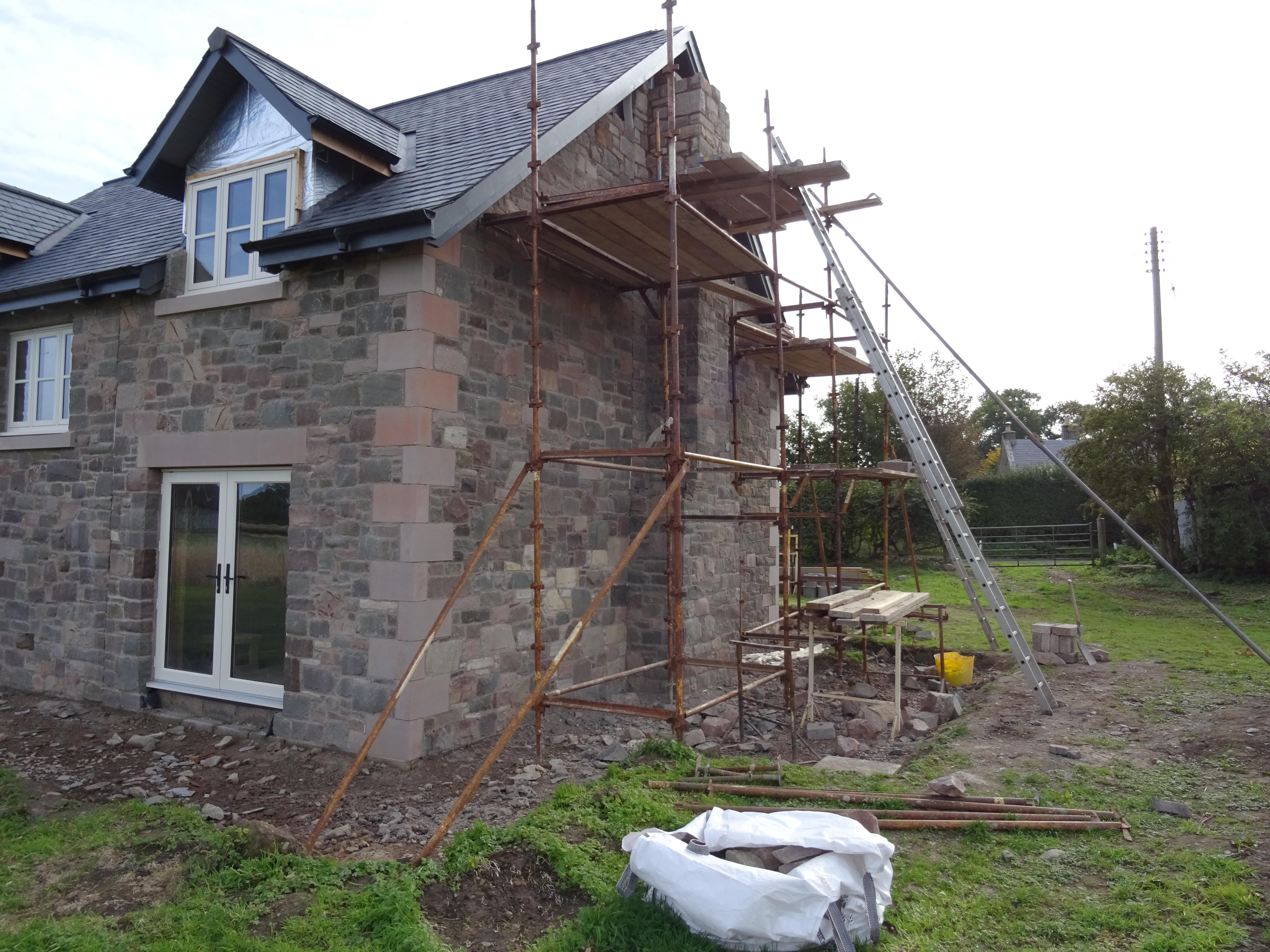

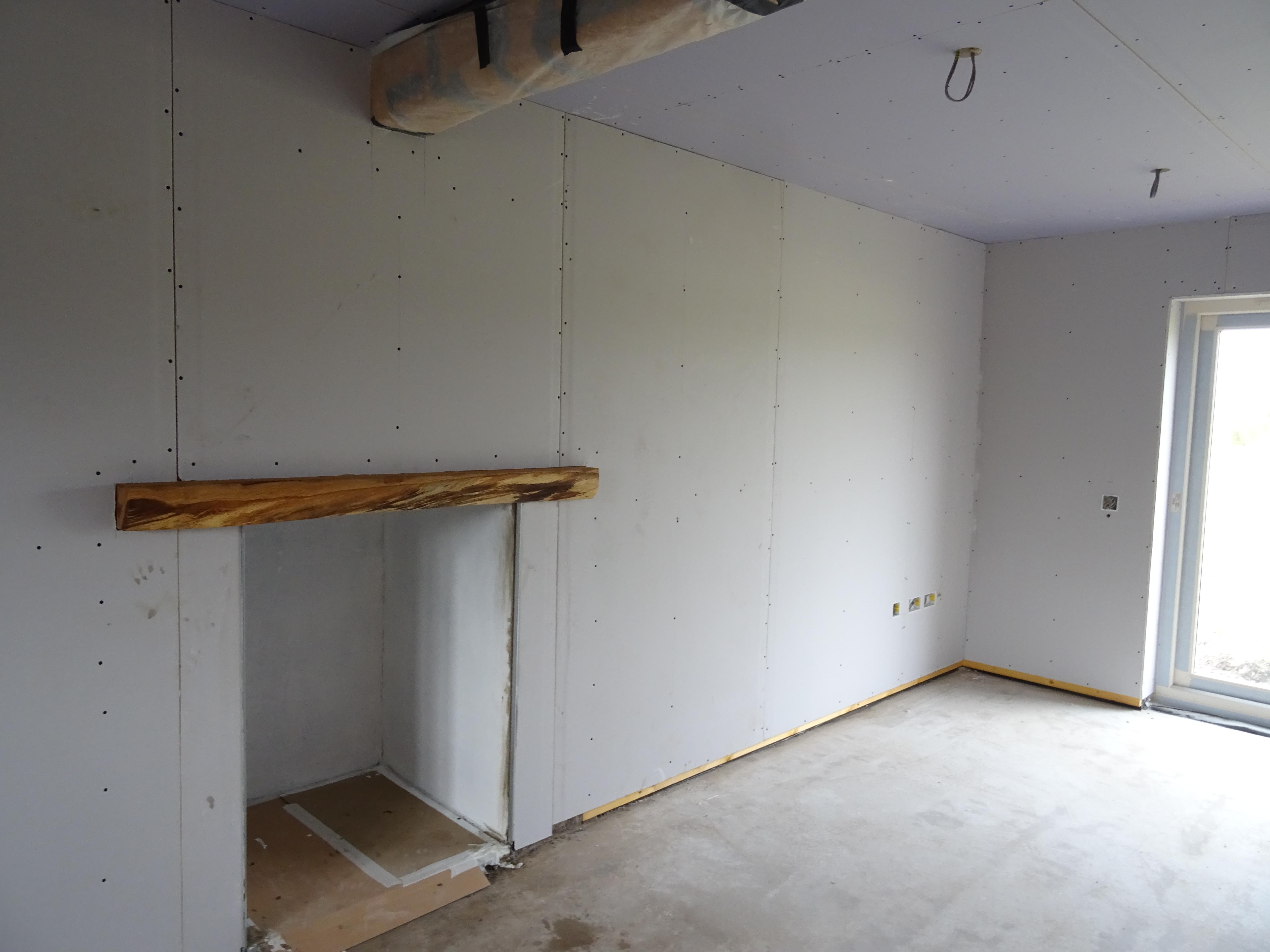

The sitting room is now being plastered and will be painted in due course. The delay in getting this room finished was due to the fact that the chimney hadn’t been completed. Thankfully, it has now been done, which in turn, has allowed the WBS fitters to come and install the oak beam and register plate. The WBS won’t be fired up and formally commissioned until early Dec, due to the delays cause by the chimney not being done in time.

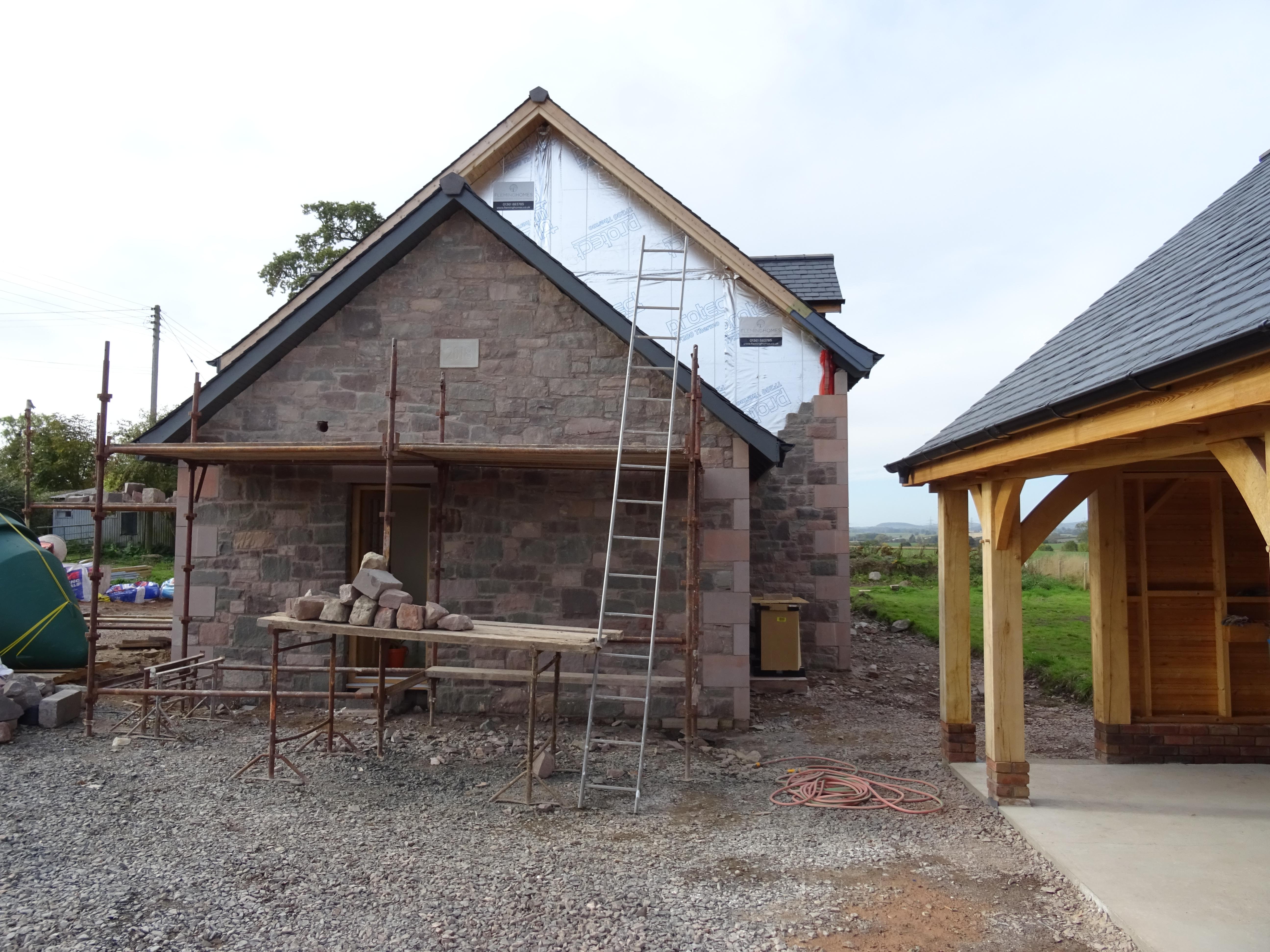

Outside, the stone work is almost complete. The chimney end will be finished this coming week and then work can turn to the awkward gable end above the single storey roof. We are now in discussions with a landscaper, so things must be heading in the right direction.

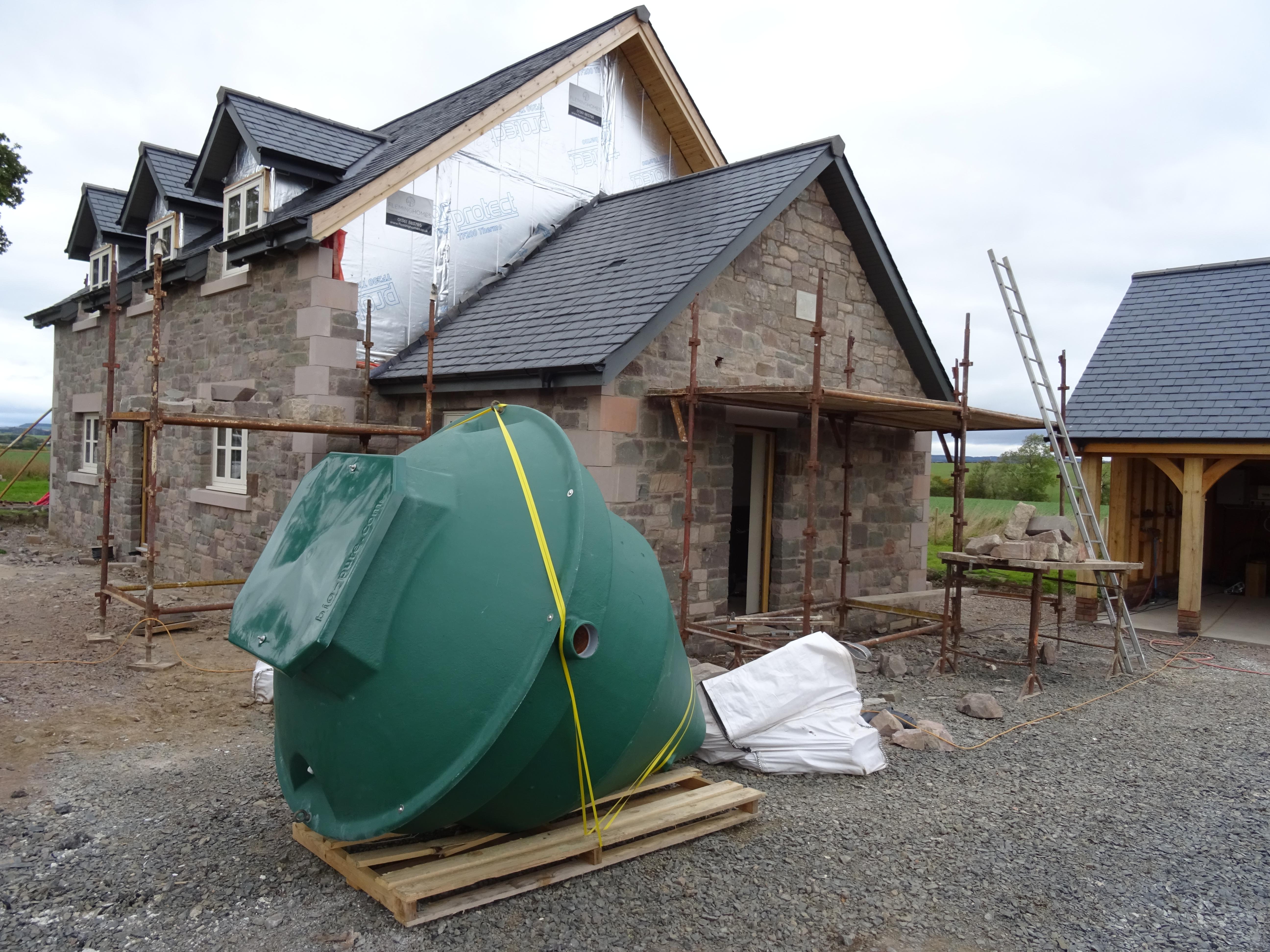

Over the coming weeks, the drainage system and treatment plant will be installed, allowing the roofer to return and fix the downpipes.

I have a fully oak staircase. I do find that it's not as safe coming down it as one with carpet TBH. The dog fell down it once too (shouldn't have been upstairs mind ;)).

@Redoctober  Looking good! I take it that's a 5kW ASHP you have? IIRC you should be able to access a floor drying out function for UFH on the controller.
  • Thanks 1
Link to comment
Yes @Stones is it and yes the Electrician is due Tuesday so we can fire it up and get the UFH working. Thanks.
Maybe apply some clear anti-slip tape to the nose of each tread.
