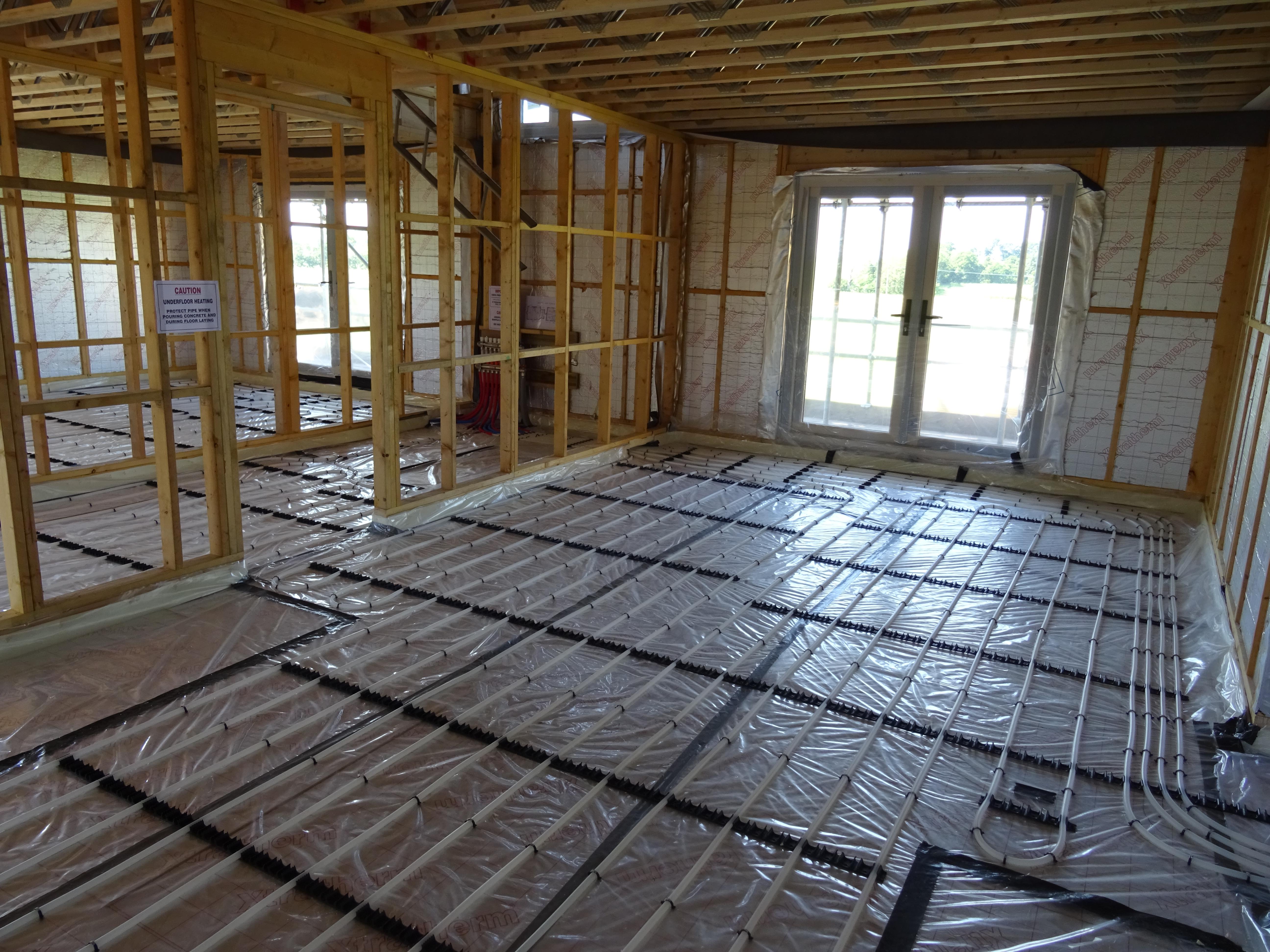

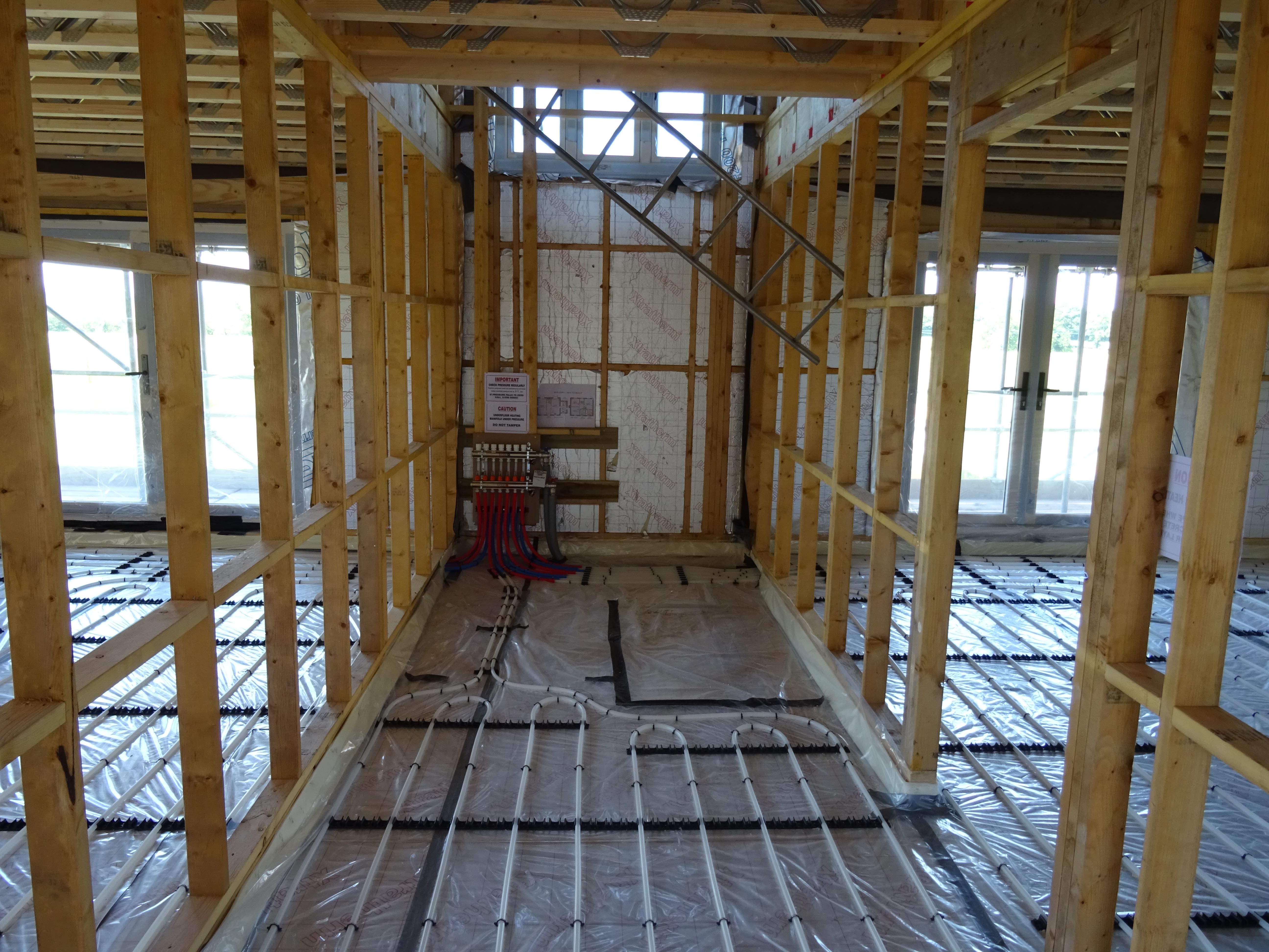

Let me explain - Since my last post, the plan was for the windows and doors to be fitted, followed by the ground floor UFH pipes and manifold to be installed, leaving a couple of days before the weekend break for the liquid screed to be poured. All of which would allow the internals to be started with earnest on Monday.

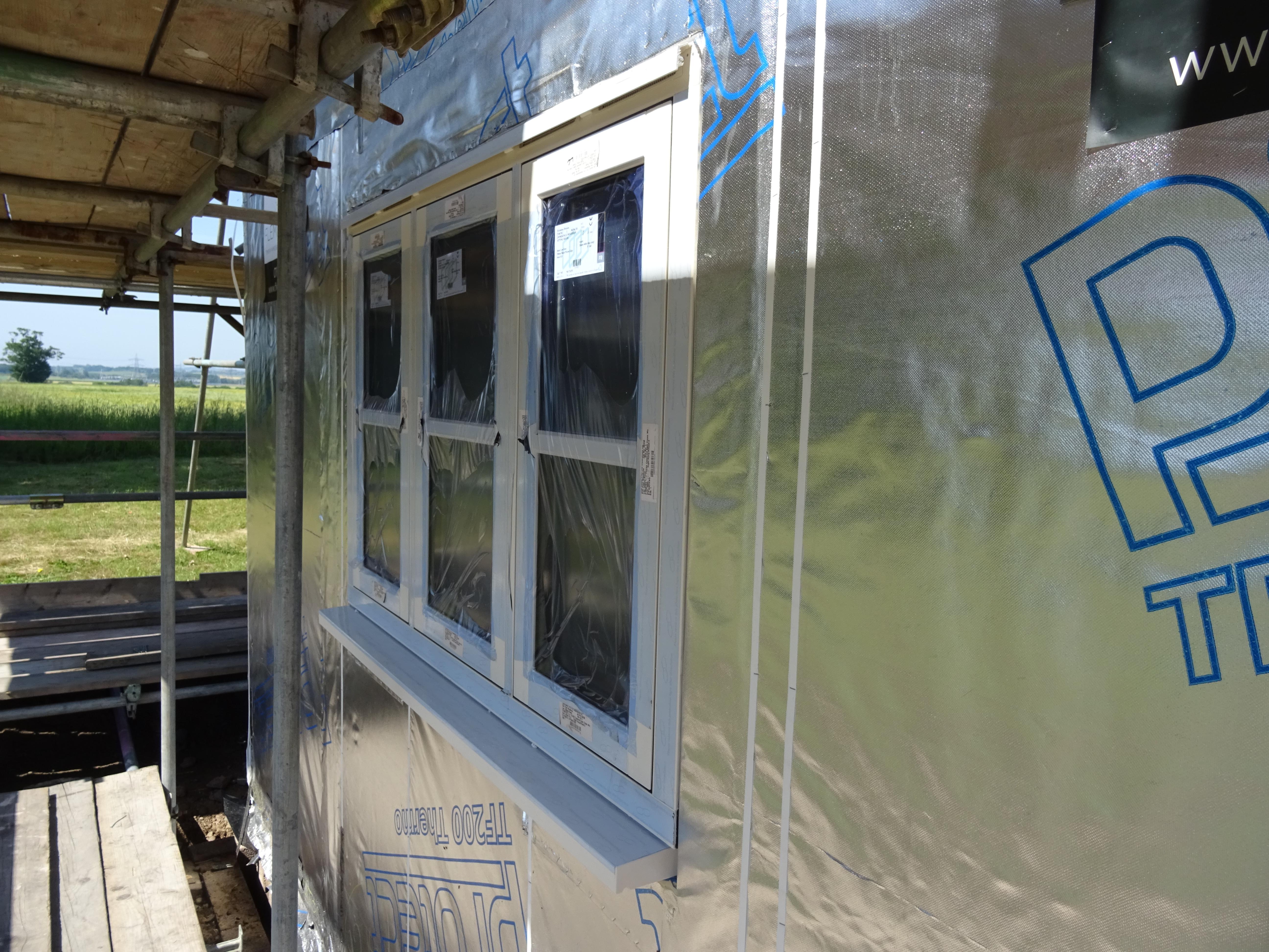

Yes the windows arrived but no front and back doors – they will take a couple more weeks. With no tradesman around I was asked by the fitters where I would like the windows placed in regards to the TF they are to sit on. This is where my lack of understanding came and bit my backside. I instructed them to fit them flush with the outside of the TF – See photograph below.
It was the following day when the builders returned to lay the insulation ahead of the UFH that I was told that the position of the windows was incorrect. They should have sat out from the TF to allow the fire batons to be fitted etc. My inexperience caused me to feel physically sick, fearing the worst and not being able to see that the problem was able to be fixed relatively easily.
It was my roofer how gave me a “virtual smack around the face” which caused me to see things differently. I contacted the fitters and explained to them that I had made an error. Could they come and correct it for me at my expense? Of course they could and will do so, albeit in a couple of week’s time.

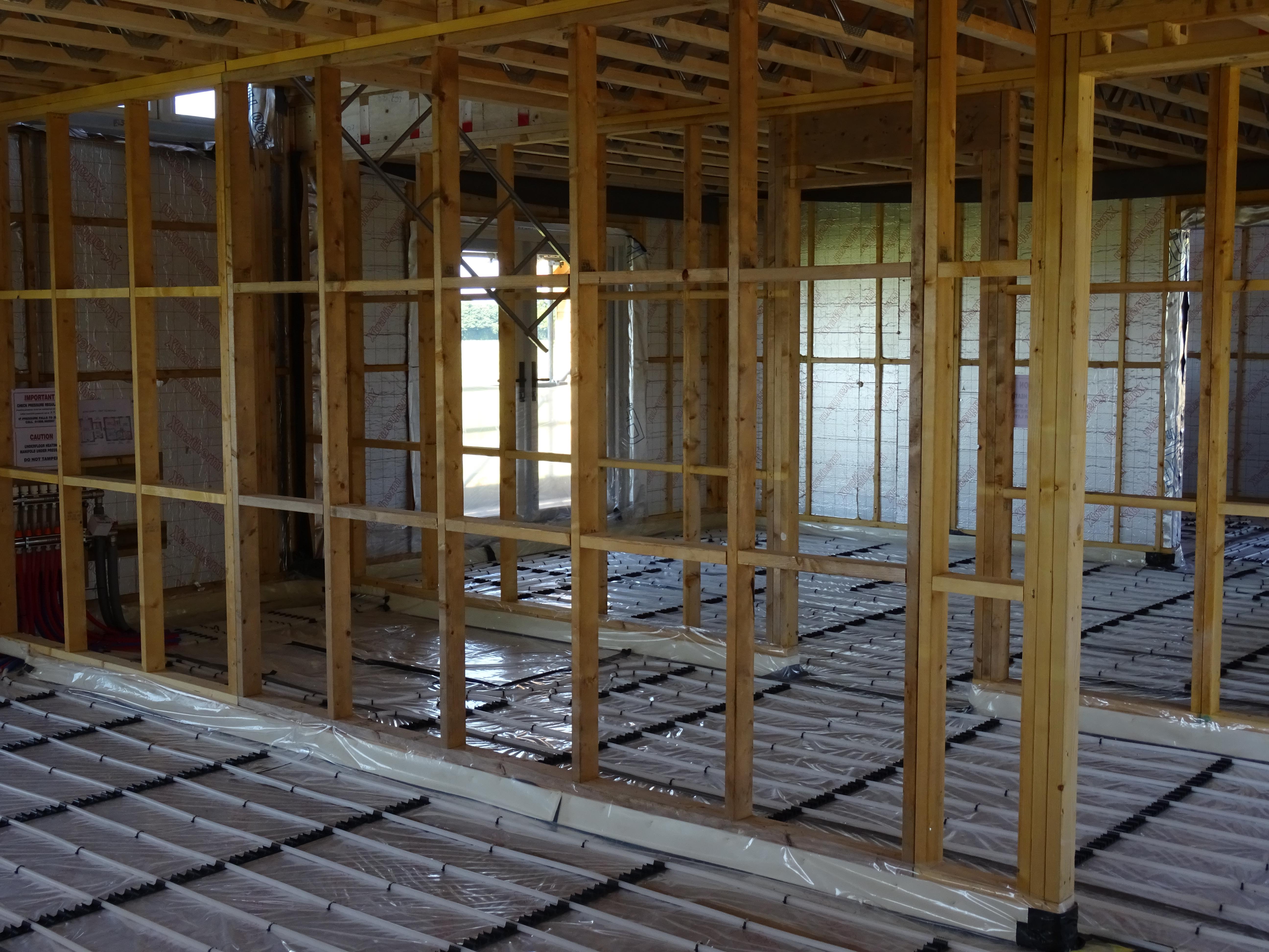

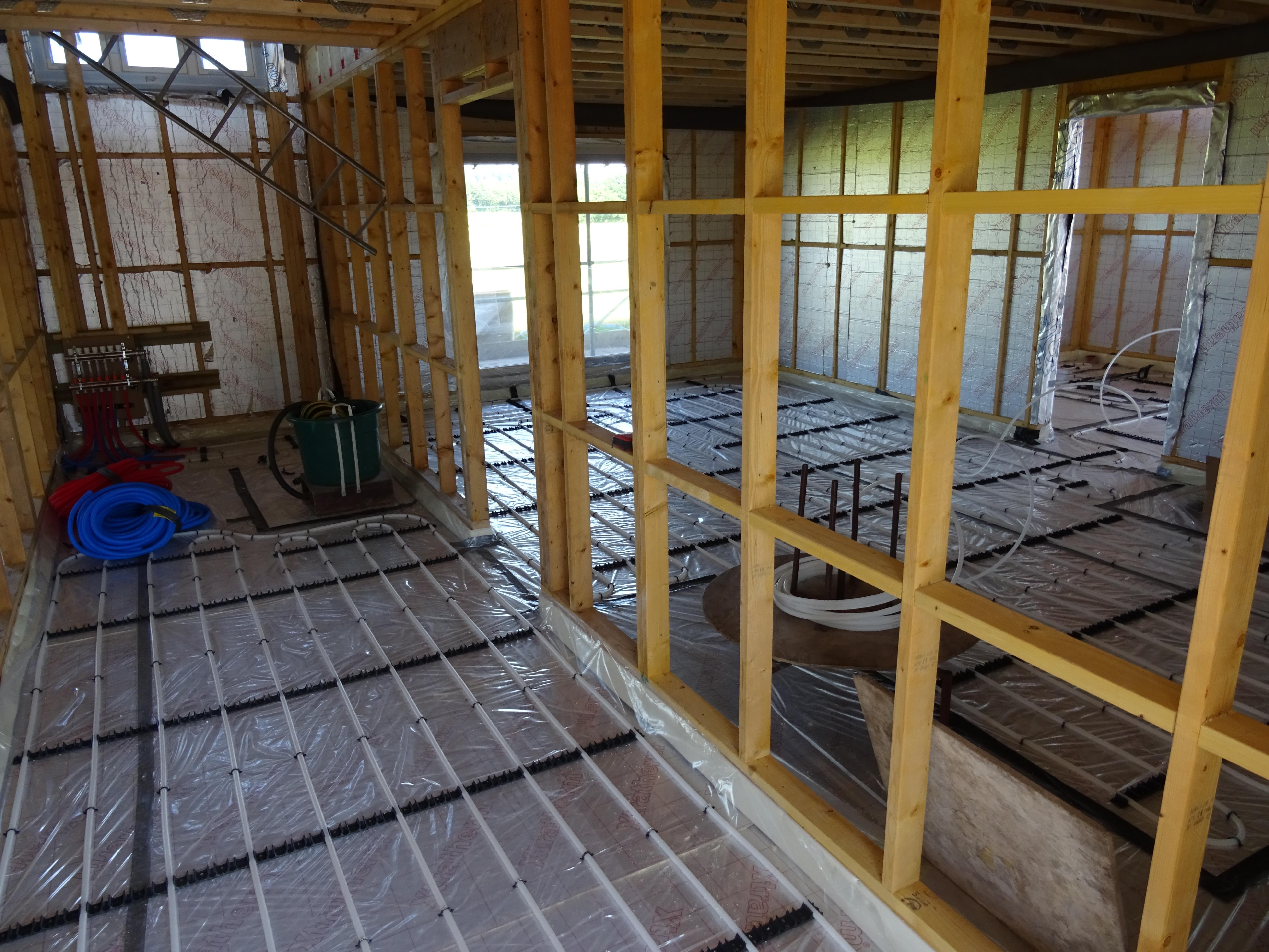

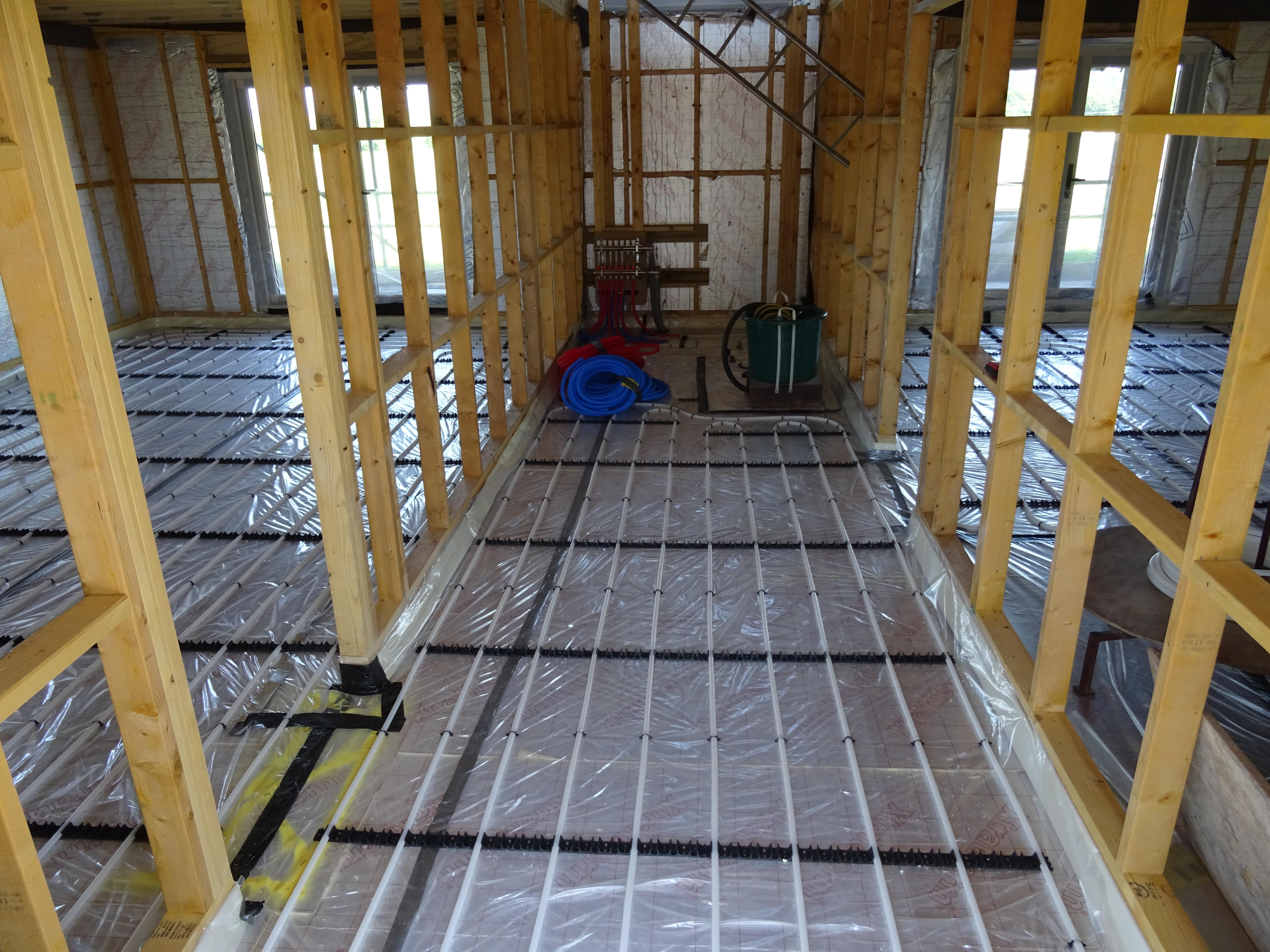

My builders then set about laying the insulation and sheeting across the ground floor only to present another “problem” to me – A block from an internal supporting wall was to be removed in order to allow the UFH flow and return pipes to run through from the cylinder to the manifold. They said that now the block had been removed, there was no defence in place for the liquid screed and if poured in its current state, it would just fill up the cavity between the two supporting walls. When I asked him what he would do to correct this he basically said that is someone else’s problem – the guy doing the UFH!!
Again, my lack of experience in these matters caused me more concerns and anxiety. [I doubt it but I can’t help thinking that the builders enjoy presenting problems to me knowing that I am not fully experienced to be able to either “shrug” them off or to have an immediate answer.]

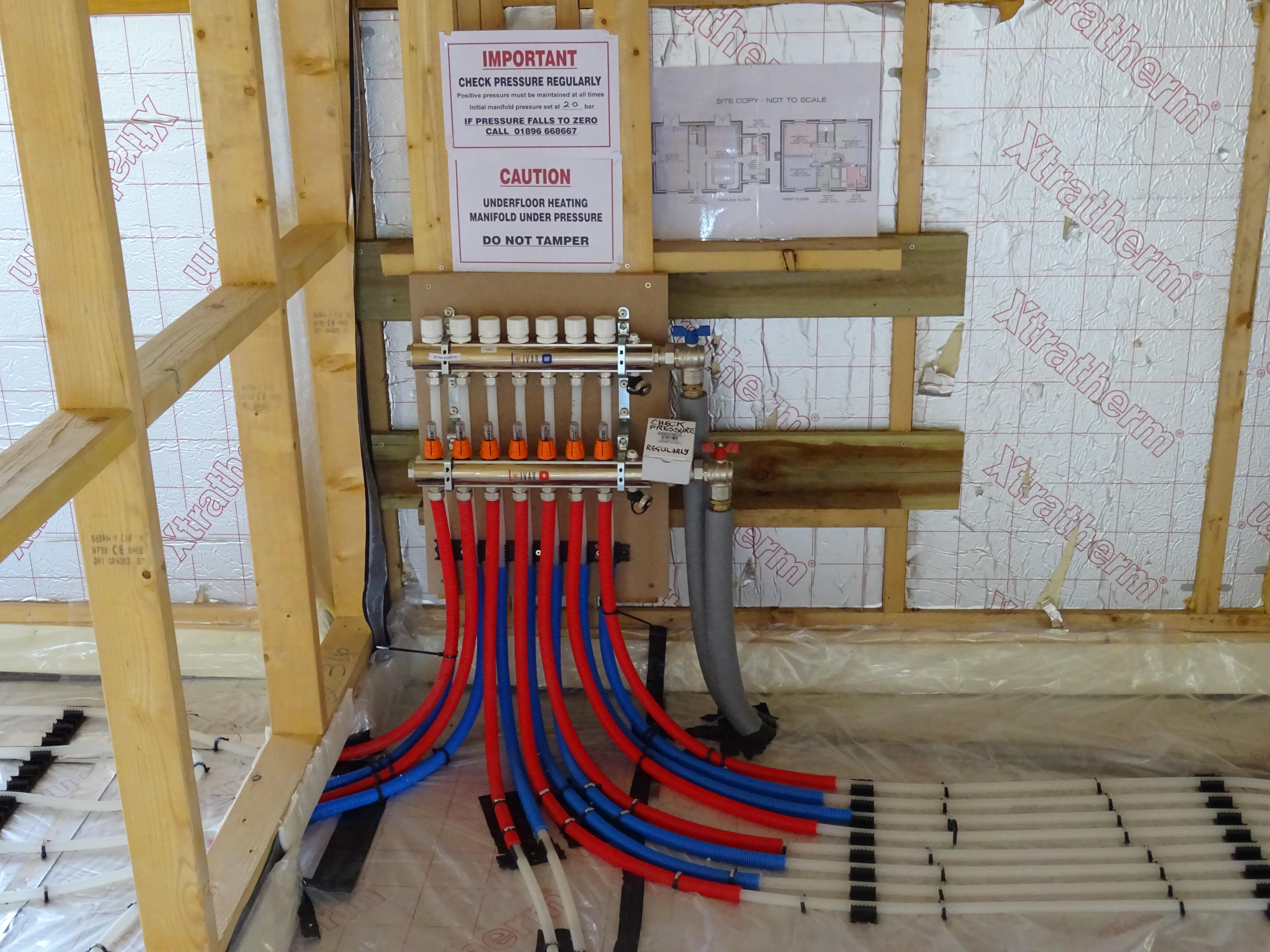

When the UFH fitter arrived on site, he did just that – shrugged it off as if it was a common issue which he has dealt with on many occasions. He spent 3 long days on site doing the ground floor UFH pipes etc. I’m really pleased with his work.
That then left Thursday and Friday free for the liquid screed. Here’s the rub. This plan of attack had been given to the builder some two weeks ago and has been mentioned a couple of times since. Thursday afternoon I get a call to say the screed will not be poured until a week Friday as the company doing it are busy!! This effectively puts back the internal work by a week as I’m not comfortable with tradesmen entering the house whilst the pipes are exposed so to speak.

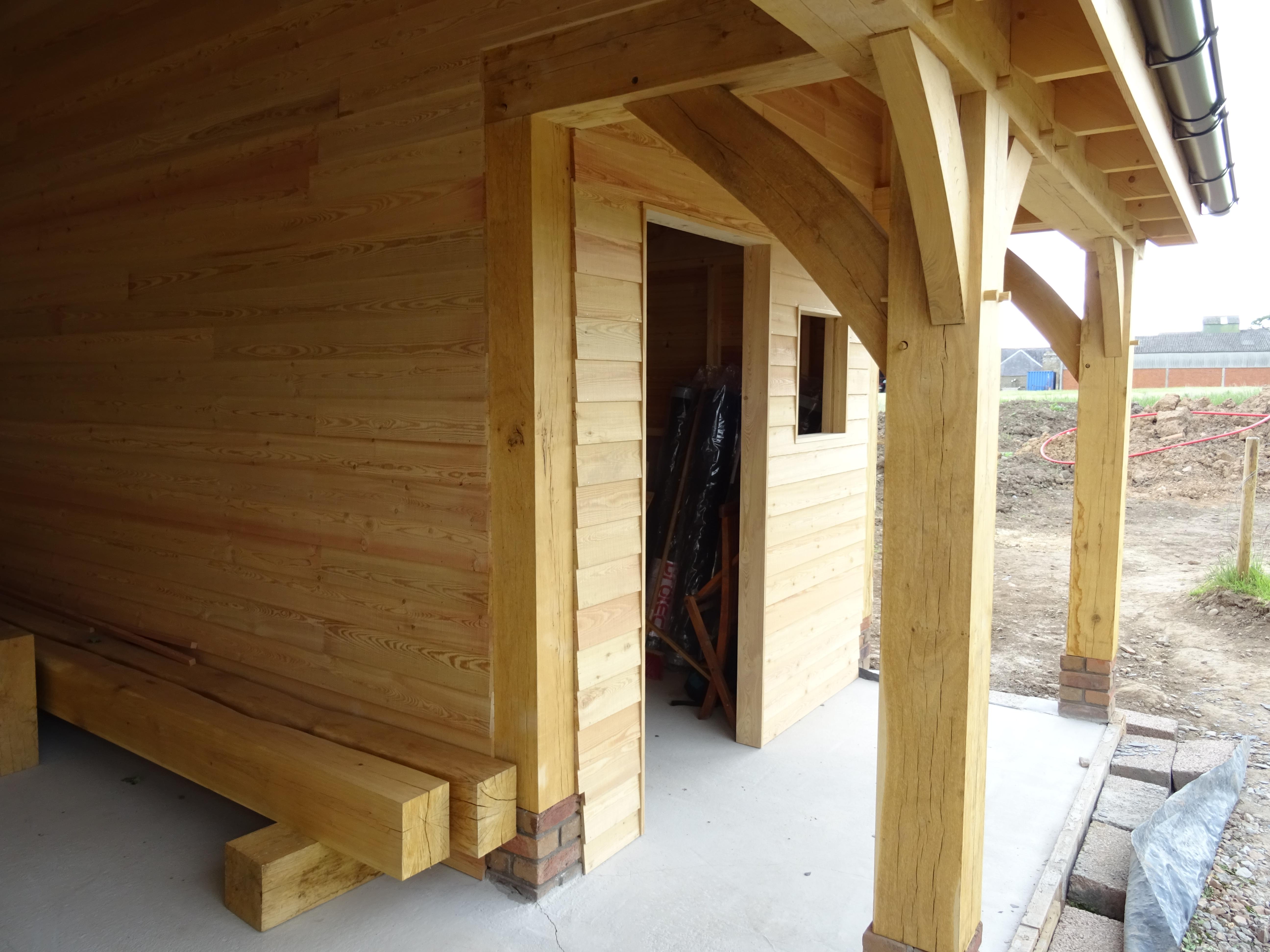

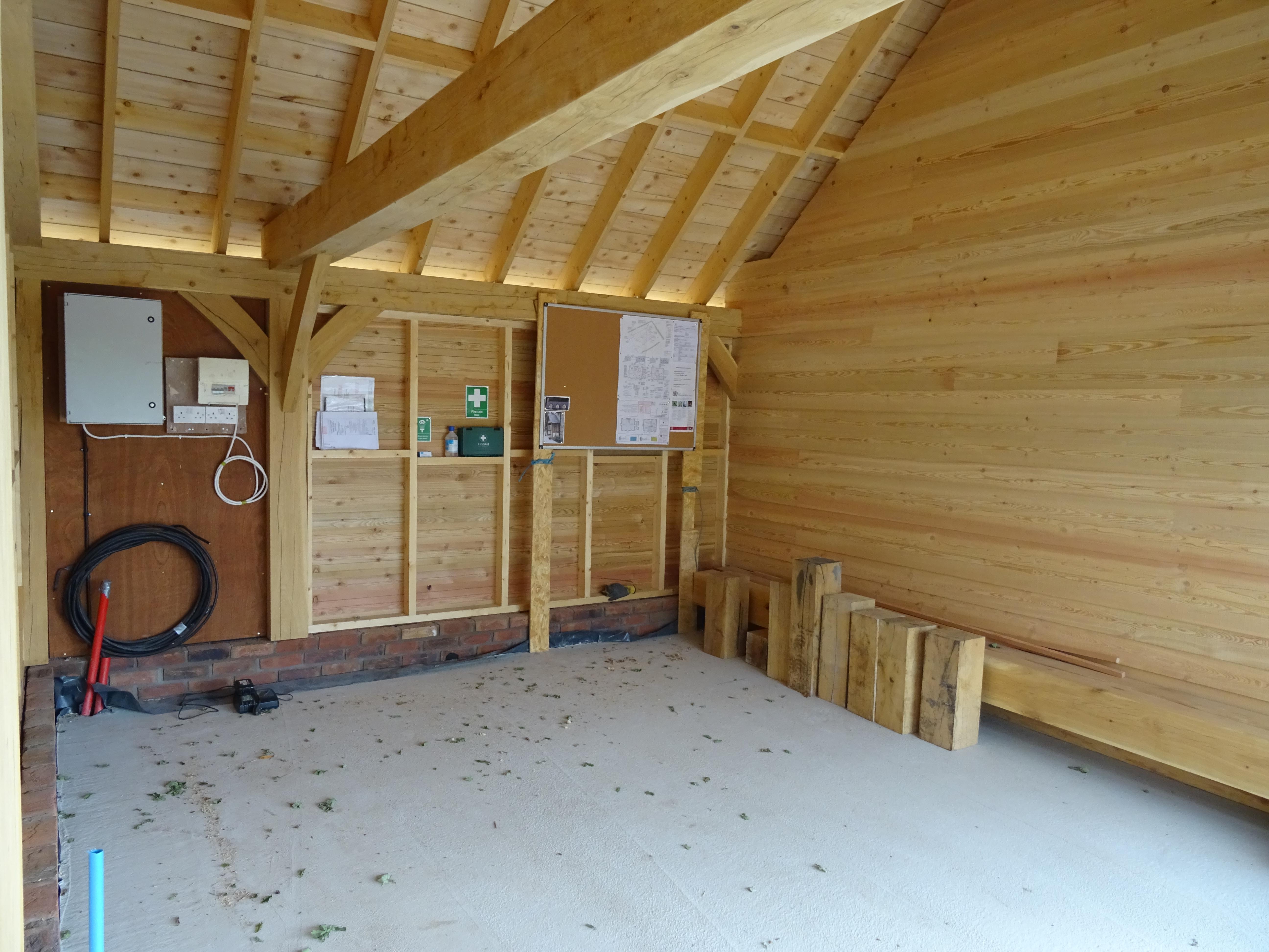

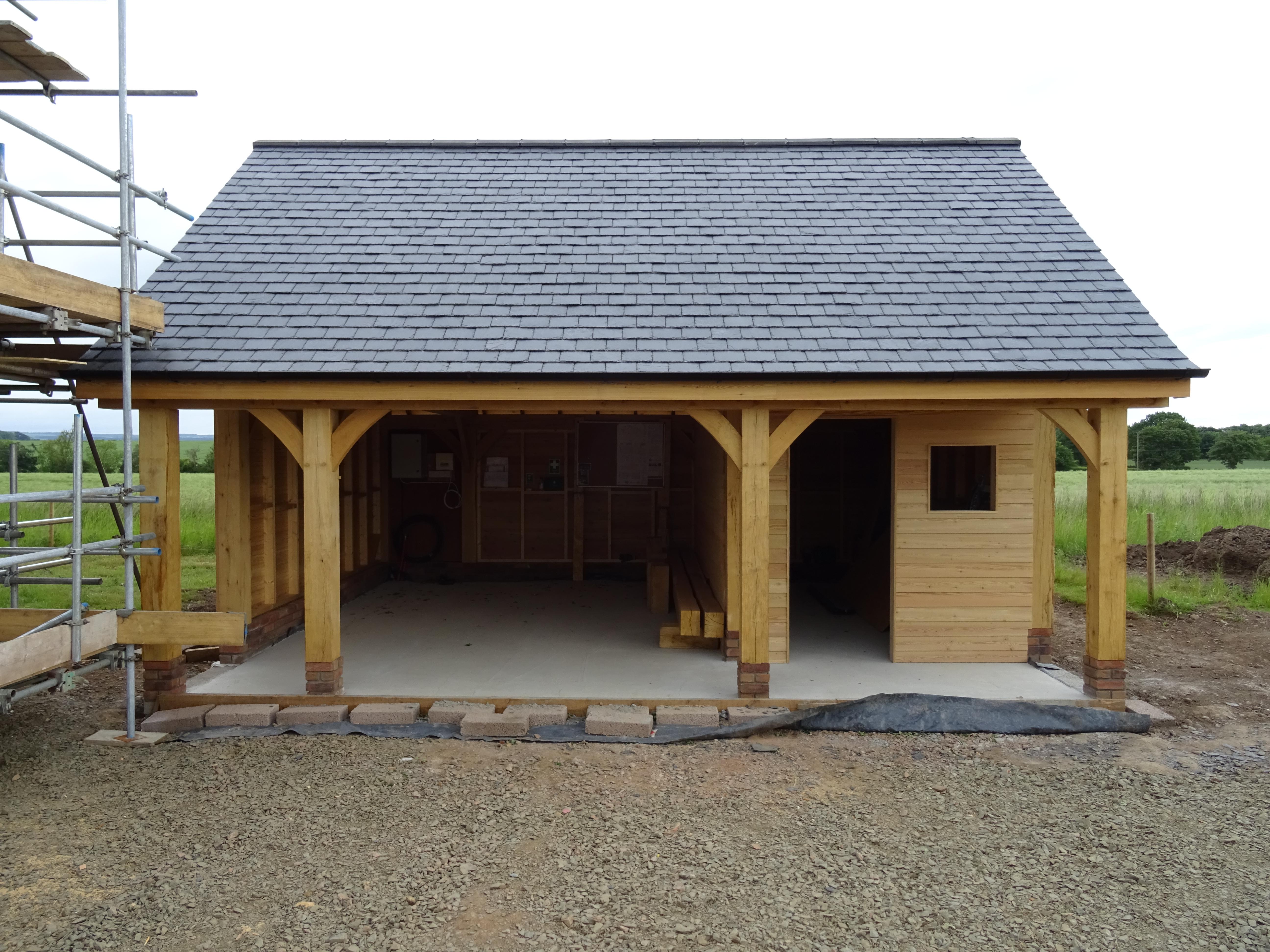

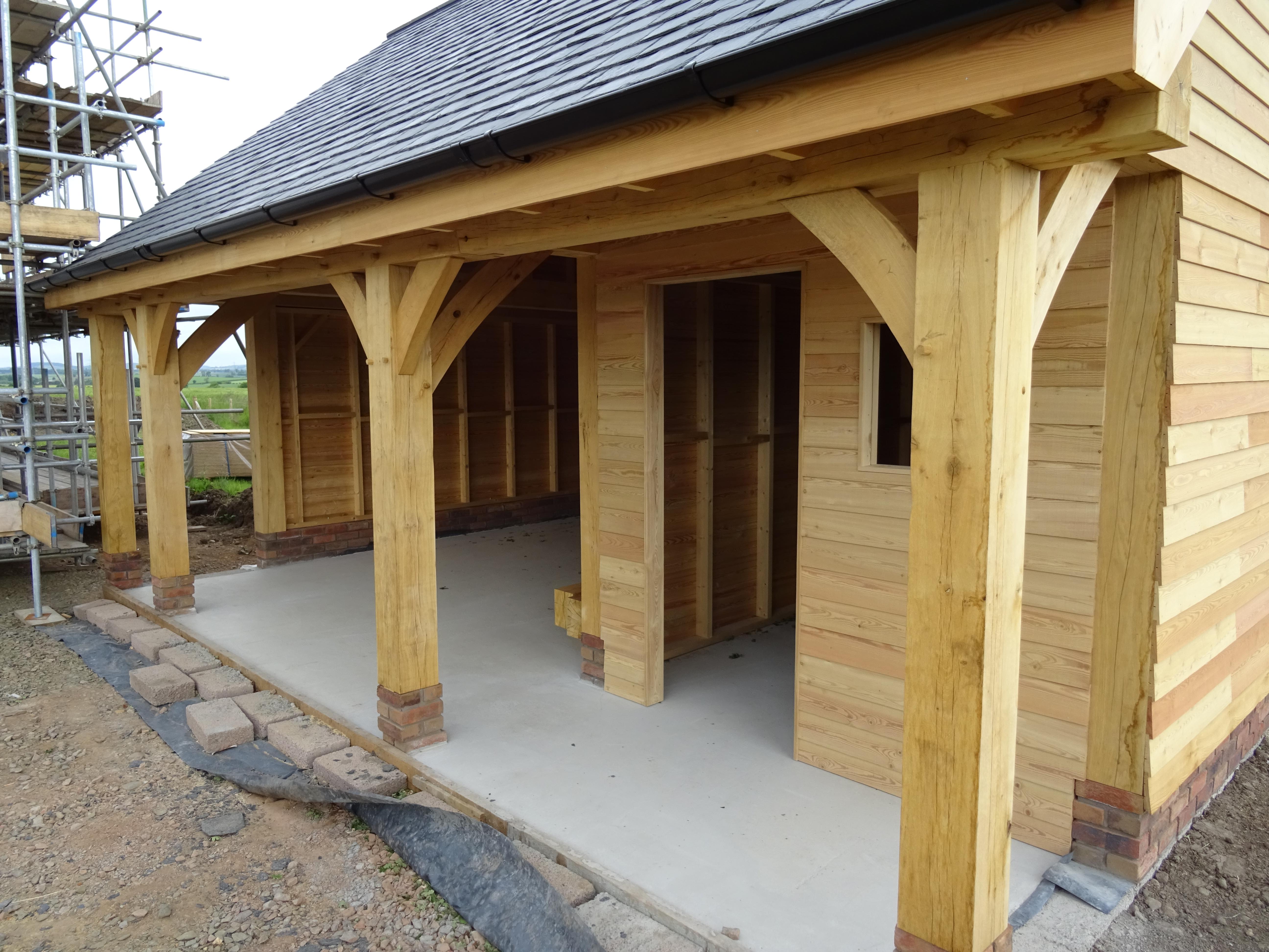

Finally, to conclude on a happy note, I have included some photos of the car port which is now complete apart from the door and window.

I think this highlights "If in doubt, ASK"  Someone on the forum would have been able to tell you about the window positioning for example.

Probably the neatest building site I have seen.  Manifold looks very, timber frame with double noggins.  Did the architect detail where the windows would go in relation to the frame and external cladding?  It is an easy detail to slip up on, but simple enough to remedy.  Are you on a deadline which must be stuck to (tenancy ending or whatever)?  If not, just award the project another few weeks and give yourself a pat on the back for what looks like a first class job.

Thanks for your comments @Mr Punter - No architect on board - a family relation drew up the plans for planning purposes and the TF company took them on for the Building Warrant. You are absolutely right, we are not under any time pressures, happily in rented accommodation and prepared to move in as and when the time comes. Thanks.

On the positive front the build looks great. You have either struck lucky and have ultra neat builders (a rare event indeed) or you are obsessive in clearing the site regularly. I used to go round at the weekends retrieving drinks bottles, sandwich wrappers, general rubbish and 'stuff' left everywhere and it still looked like a mess all the time.
