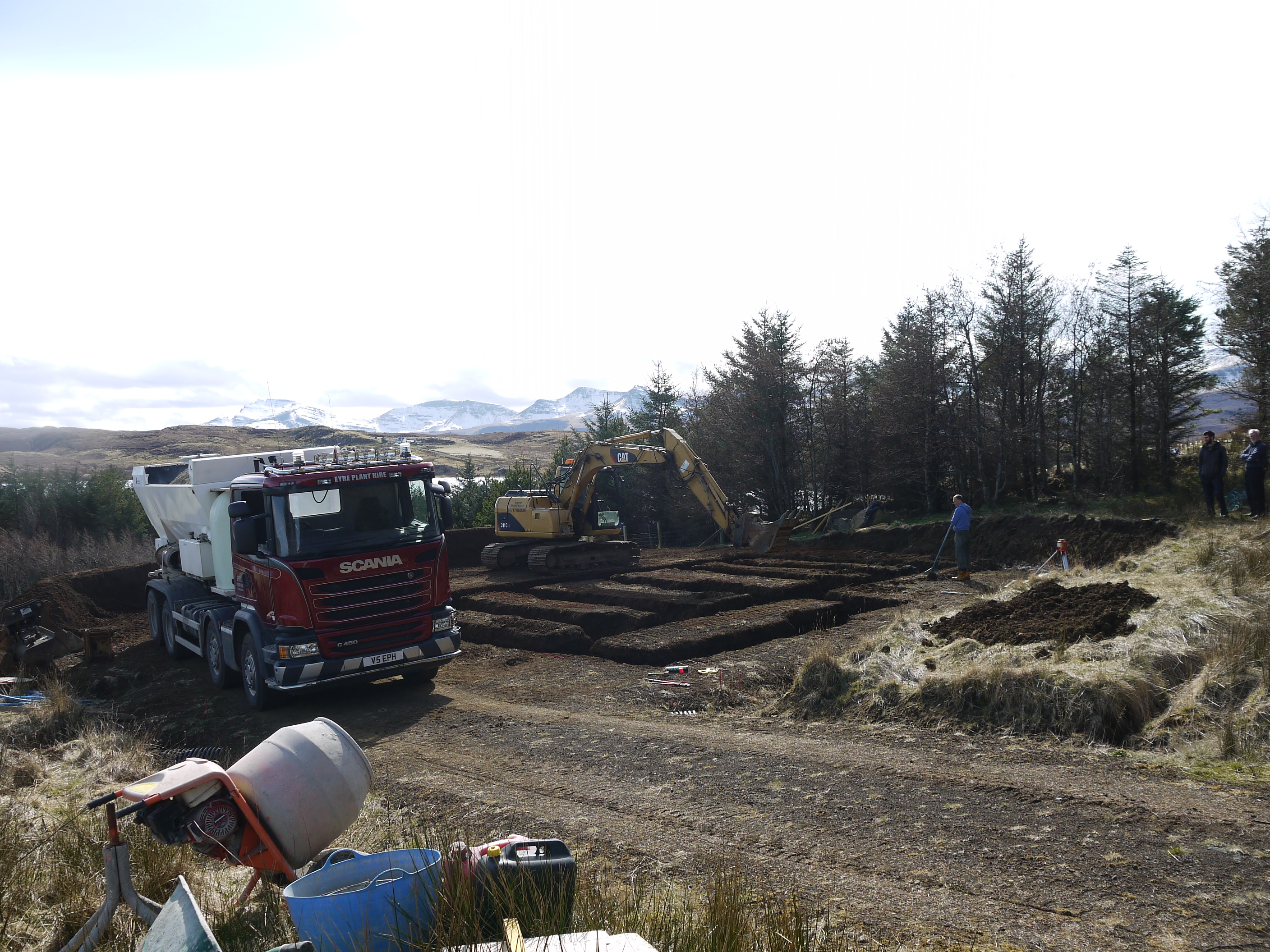

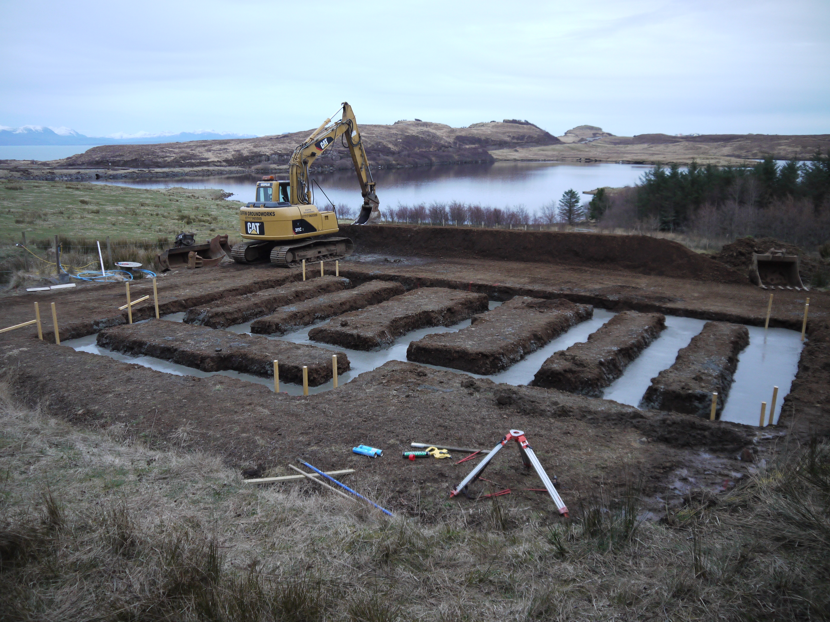

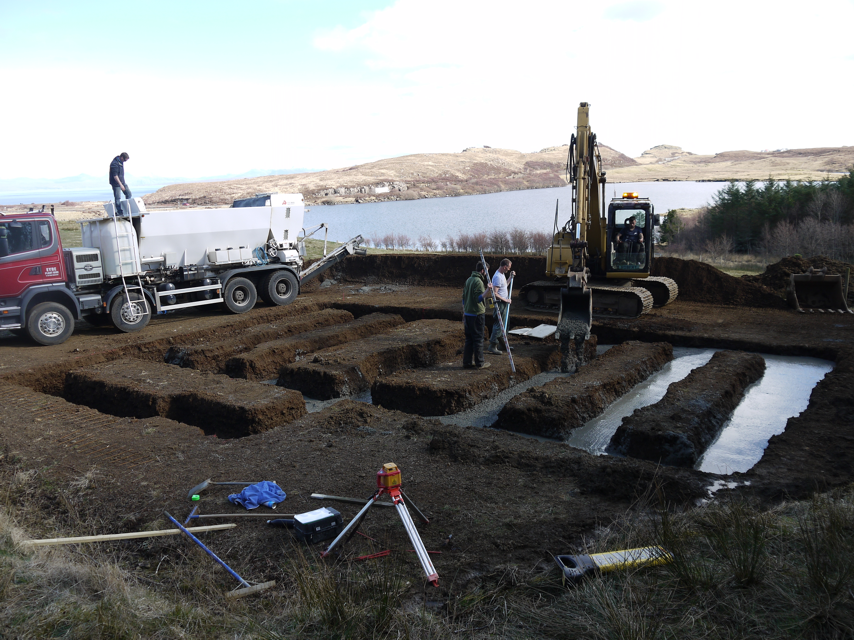

Yesterday we completed the excavation of the trenches. I had a half day at work and came back to the site after lunch to get started on the pour.
I was slightly worried about the heavy concrete wagon coming down our access and over the culvert, but the driver did a great job reversing and the road passed the test with flying colours. Our digger driver than used the bucket to spread the concrete as required.
Half way through.
All done.
We now move onto the blockwork next week.
It was a good day and I'm pleased to get this over and done with. Half a day for excavations and half a day for pouring.

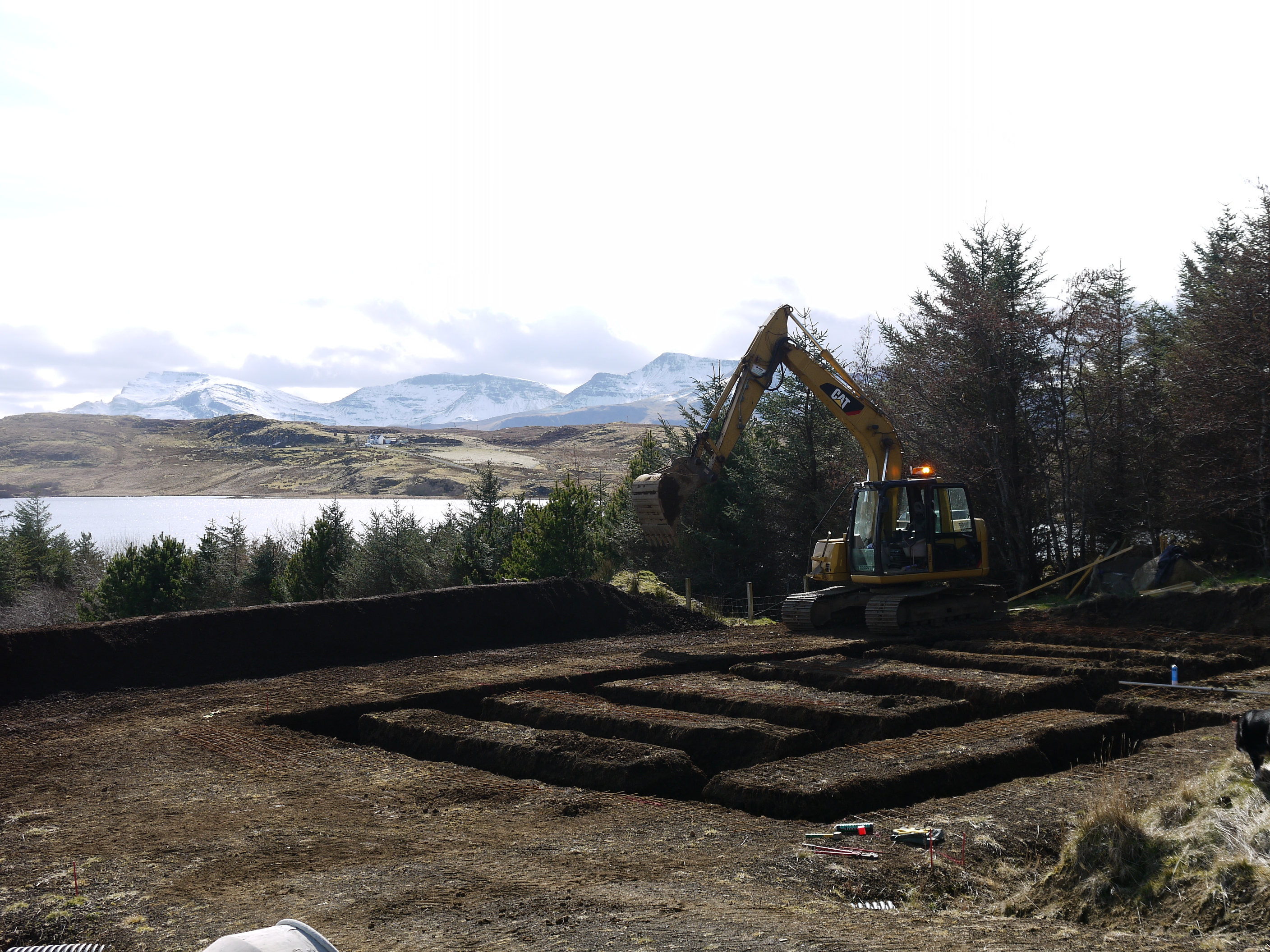

It depends which mountains, one gable side of the house has views of the Torridon mountains (across the sea to the mainland - photo 4) some are munros. The other side has views to the Trotternish ridge (Photo 1) these are not munros but the last one is the old man of Storr, which is popular here on Skye. Depending on the built hope to walk on the ridge on Monday!

@CC45 and @newhome - I was chatting with the brickie whilst we waited for the second concrete pour and he is involved with the mountain rescue and helps folk stuck on the Cullins like where Danny is on his bike. Can you imagine going onto the ridge in the dark and cold conditions?

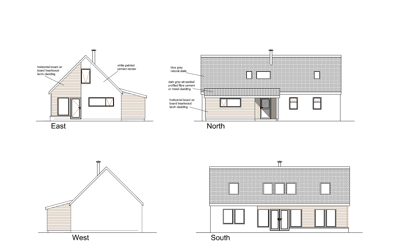

You should post plans or explain the layout more so we can make sense of the foundations and rooms. Which way it faces, enters, views, etc.

Here are the elevations plans.
It's glorious sunshine here today, although I'm in agony. I was too enthusiastic moving blocks yesterday and I've busted my back :( These were bloody heavy, 6 inch solid concrete blocks. Started shifting blocks this morning and had some pain after twenty minutes. Hats off if you are brickie, it's a very hard job.
In terms of the foundations, our structural engineer said because of ground conditions a slab, would not be feasible so we are having a suspended timber floor, so the extra trenches are for the sleeper walls. This will result in the house being slightly higher off the ground, but fortunately I have a pretty much endless supply of sub base so I'll be able to bring the levels up a bit. I might incorporate some decking around the front, although I'll worry about that in 2020.

Plenty of solar gain there :)
Do you have a less desirable view to the West, or is it just the way the layout worked out?
Link to comment
The west is the where the prevailing winds come down of the Trotternish ridge, so I wanted this to well protected against the elements and also no views that side.
Fortunately we have the site sitting slightly lower, then a shelter belt and the neighboring croft has large outcrops of bedrock so we quite well protected. The self build the next croft along must take a really hammering, as it has very little shelter.
