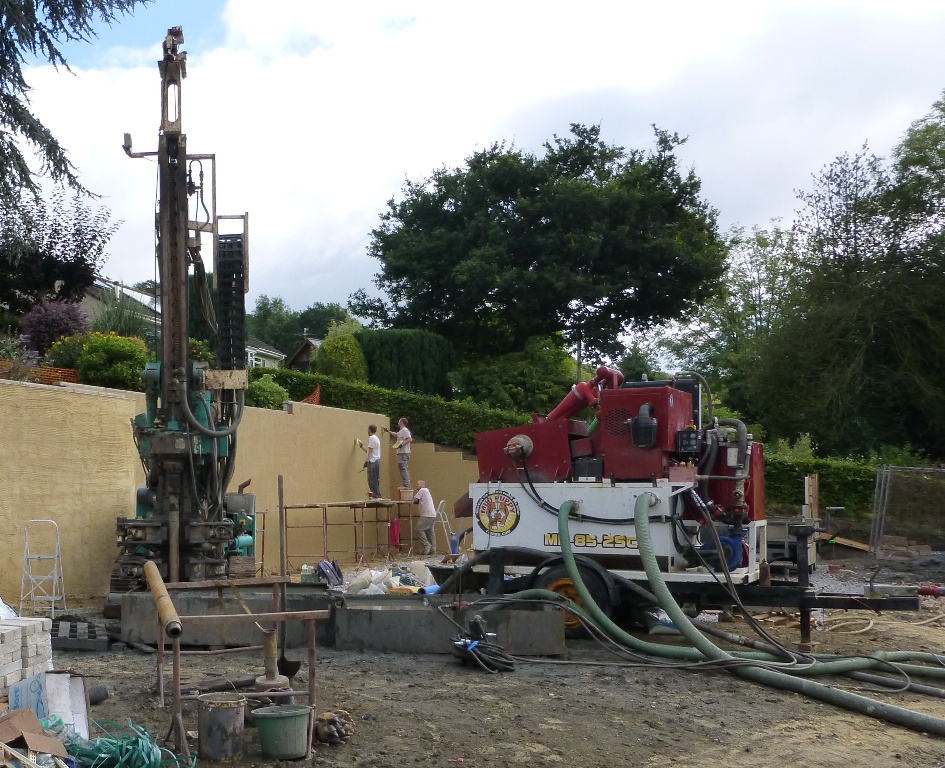

@PeterStarck, It seems to vary a lot from region to region, I think.  I can't remember how many companies we approached to drill our borehole, but it was at least four or five, and the variations in price were pretty wide, from around £8k up to over £12k, IIRC, for a ~50m deep borehole.  I already had a hydrogeological report, with a detailed specification for the borehole, including the depth, type of strata to be drilled through,plus details of the type of lining and packing media needed around the water-bearing section.  £3k would barely cover the rig mobilisation costs, here, I think!

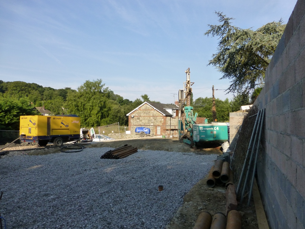

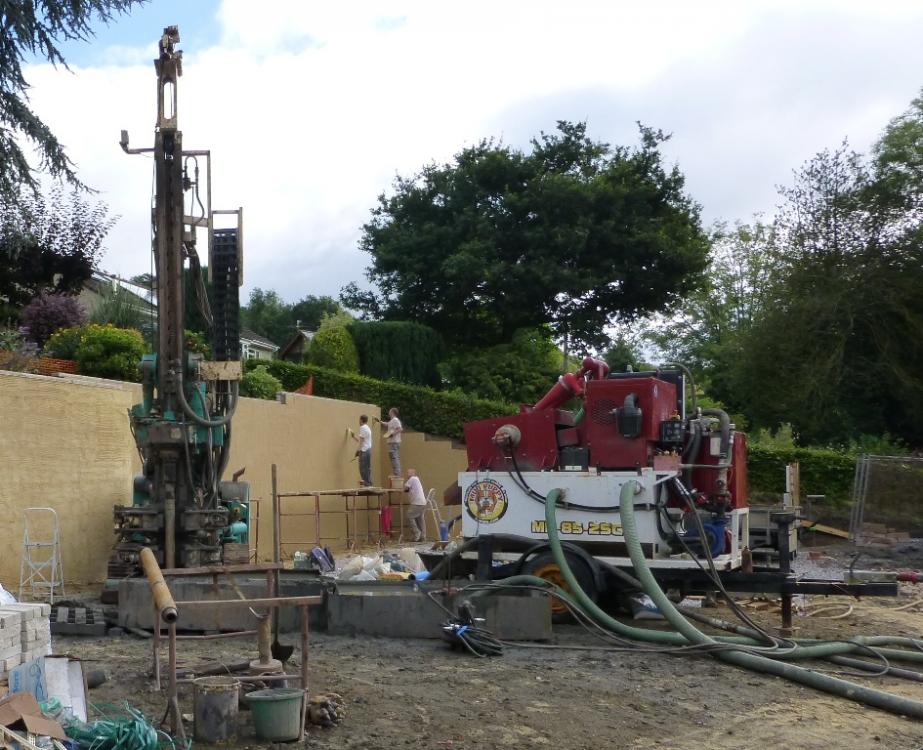

Our rig came on a big low loader, as it was a fair few tonnes of kit, plus a landrover towing a big compressor.  IIRC the rig transport was a specialist heavy plant  transporter, with the tracked rig being able to unload itself a bit like a pretty big (15 tonne or so) tracked digger.

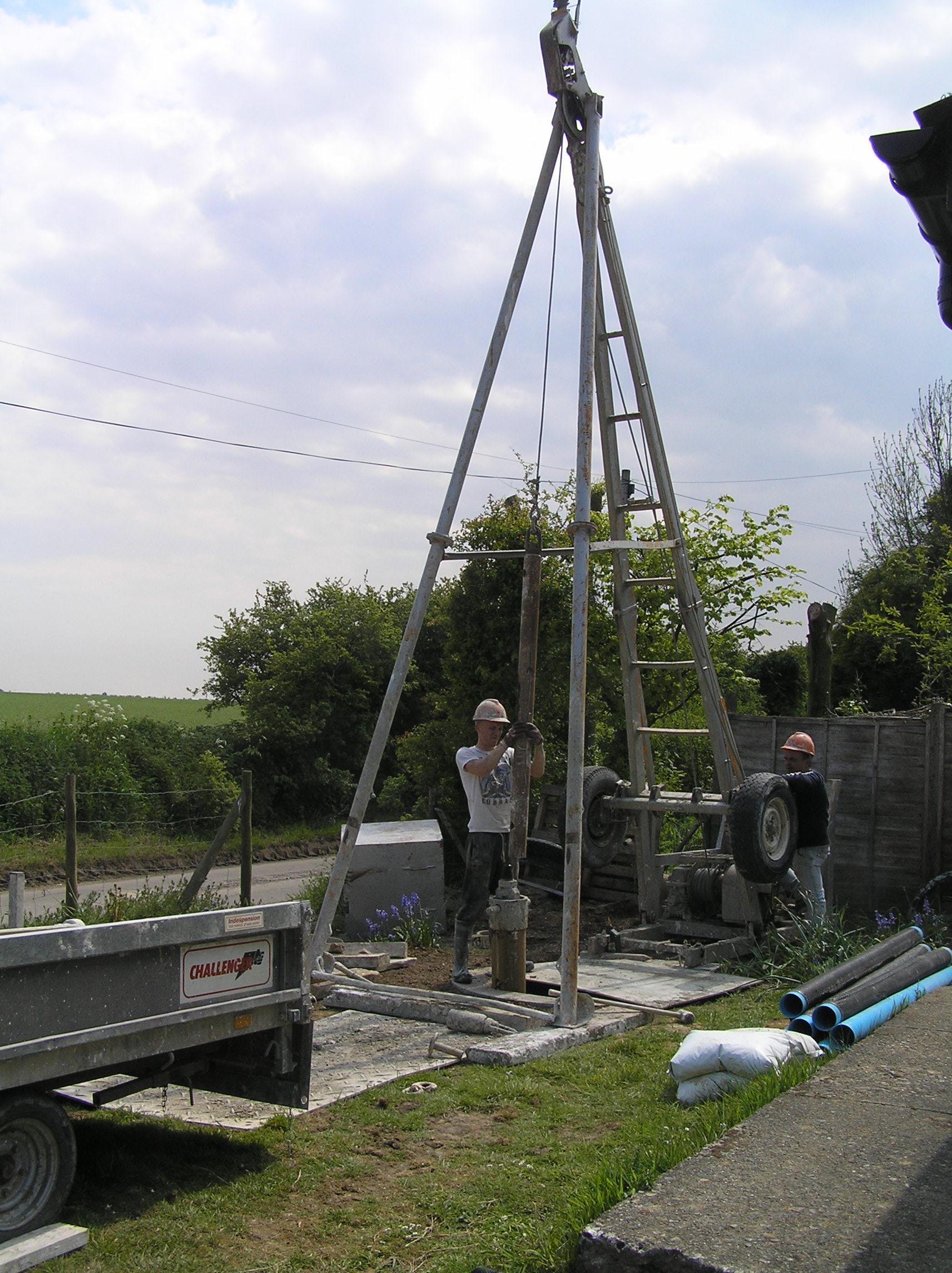

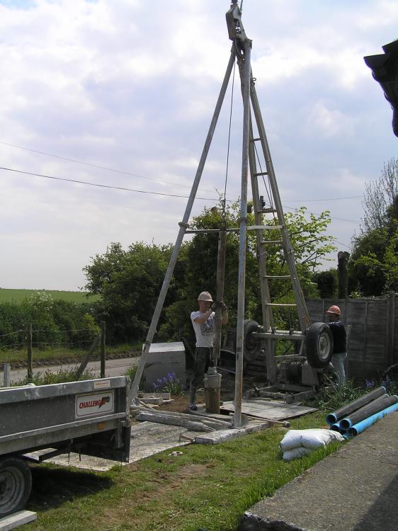

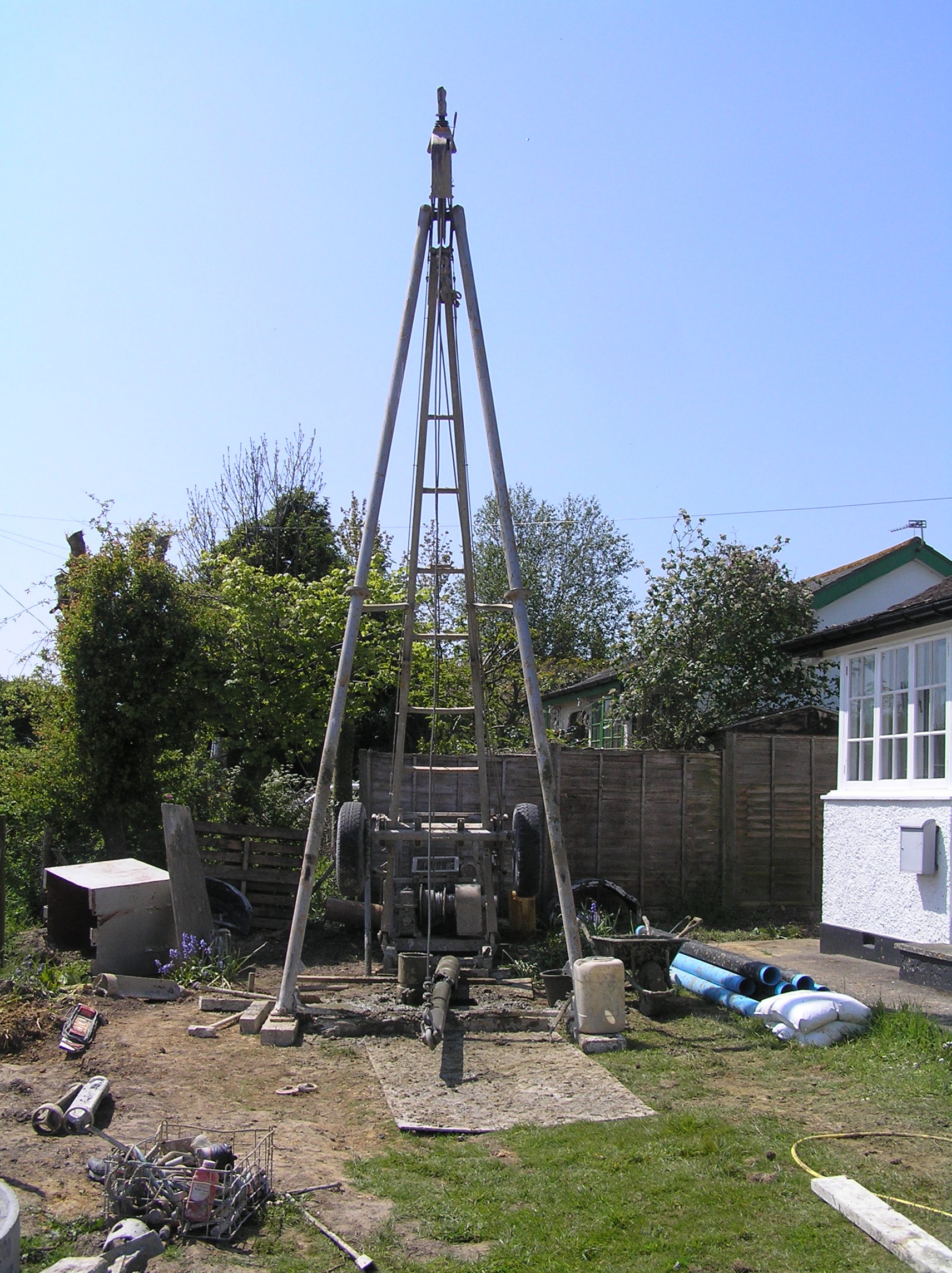

I didn't know anything about borehole drilling before we had ours done. This is the kit they used, IIRC it was a 150mm hole with 110mm sleeving. It was eight years ago, so might affect the price. It was the drillers who told me about the wonders of Bentonite which I have since used around my sewage treatment plant pipes. Sorry, a bit off thread.
Link to comment
That's a shell and auger drilling rig. To get to 47m with one of them rigs is good going. The deepest you would get here would be not much more than 35m before you would hit rock or mud stone.
It's about as basic as you can get. Lift a big weight with a cutter attached and drop it from height. Clear the cutter out and repeat while getting the casing to go deeper and deeper by either lifting it and dropping it or tapping it with the cutter.
Bentonite is some stuff. You can get it in pellet form or powered depending on what you want to do.

On a warm day the compressor goes as far away as it can, on a cold day as close as it can. They give of some heat.
Link to comment
That it does, and a lot of noise!  Mind you, when  that Casagrande rig was running at full tilt through hard rock it made enough noise to make even the compressor seem quiet!

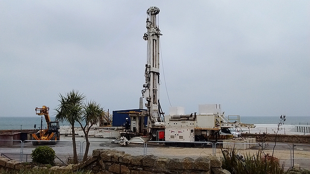

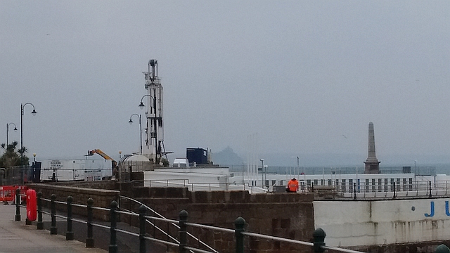

Well the big rig is in place now.
It is bigger than the palms, the obelisk and St Mick's Mound, from the right angle.
