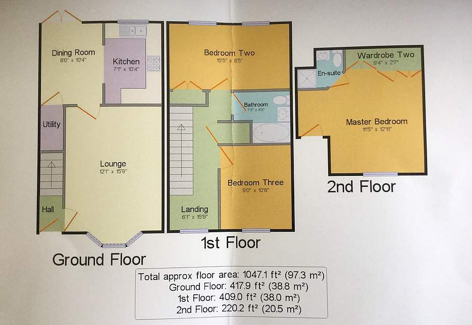

I thought I would post a plan of a terraced house I ran across recently.
The small estate of houses was built in 2004. Typical but pleasant modern houses, but this 2.5 storey terrace has a notably efficient layout.
In the overall footprint of 5m by 9m (including external walls) includes 1047 sqft, and includes:
  • Large lounge 12' x 16'.
  • Dining room 8' x 10' attached to 10' x 7' kitchen
  • Three double bedrooms (one ensuite)
  • Family bathroom
  • Small utility
  • A reasonable amount of storage
Here is the Plan:
I like:
  1. That circulation space is minimised to around 10%.
  2. That each bedroom has space for bed + chair + desk, even though bed 3 at 9' x 11' is tight.
  3.  That there is space for a workdesk on the middle landing should it be needed.
  4. That the layout is reasonably flexible.
Should it be desired, bedroom 2 could be made into 2 singles of 8'5" x 8' each, which is still larger than most 3rd bedrooms even in semi-detached houses, or could have its own ensuite included.
Looking at the plan a decade later, I think there are only three things I would change:
  1. Remove the wall between the kitchen and the dining room to create an open space, and insert a small breakfast bar.
  2. Add a roof window or two to the rear aspect of the Master Bedroom.
  3. Make changes necessary to comply with more recent regs - especially around disabled access.
What do you think?

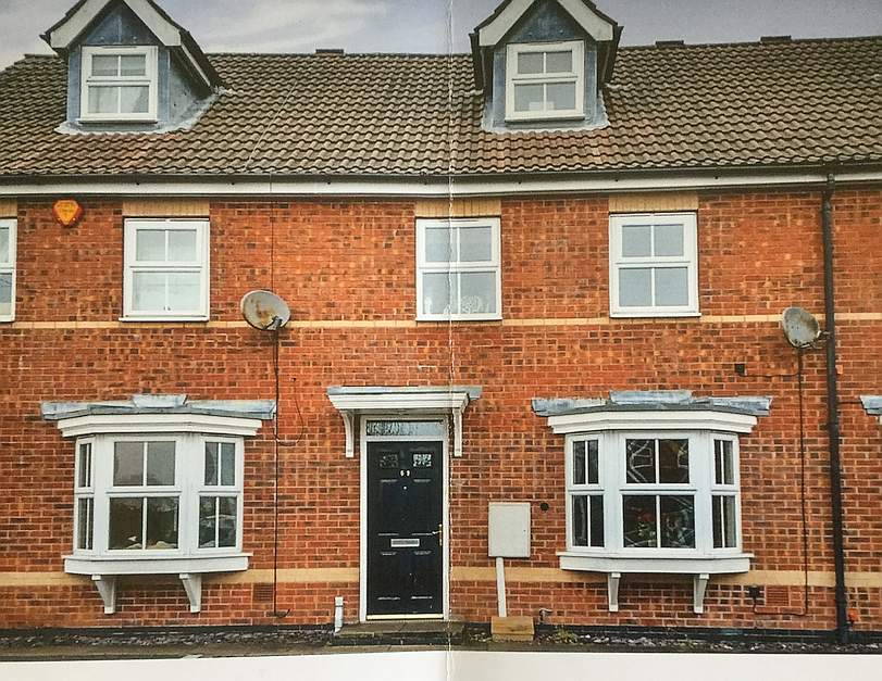

Tennentslager
Roof mounted communal satellite dish?
:o
(edited)

There is no gf wc, so you'd have to replace the utility room if you were building it today
Oz07
Would that hall give enough space with regards to disabled regs. You need the 800mm clearance between doors plus certain allowance to turn? Same issue for gf wc. May just need tweaking with slightly wider stairs and hall
(edited)
Quite possibly not.
I would expect to need a little extra width to fit in the requirements for the latest regs.
Compared to traditional terraces, it is a version of the "corridor" terrace using the attic, without the rear leanto, and with very little unused volume.
Edited by Ferdinand
Quite possibly not.
I'm a fan of the rear lean to as it makes a usable space - you could use it here to provide an extension to the kitchen diner and also house the downstairs WC
Done with a flat roof and a nice skylight it also stops the carbuncles of uPVC conservatories being added to houses that just don't need them ..!
(edited)
As a counter I would say that even a full width leanto will reduce the efficiency of the design ... in terms of amount of structure for the space, and in terms of surface area to volume ratio for thermal efficiency, insulation cost etc. If it is plus half depth (=4m x 5m internal space) you are adding 50% more roof and 25% more wall (both external walls and internal) for the sake of 20% more space. Plus maintaining the upper roof would be more difficult (though there are easy solutions if they think in advance).
For efficiency I might be more inclined to add 2 storeys to the extension and treat the whole thing as a slightly larger house (extra 50% depth makes it 1500-1600 sqft - +200sqft on each floor plus perhaps 100sqft in the master suite), which would be more efficient and manageable (no extra separate roof), but that then brings questions of balance between bedroom space and living space into the equation and makes a fundamental difference to the size of the master suite.
In this design to find the 3 bed efficiency sweet spot for 2016 and to meet regs, I think I might be able just to make it perhaps 0.4-0.6m wider, which would also really help the 1st Floor.
But then as a developer you would only get 10 houses where here you would get 11, which will impact the required selling price by nearly 10%. That might argue for an extra 1m depth instead if the plan can be organised appropriately.
Edited by Ferdinand

I was pointing out that by increasing the width from say 5m to 5.5m there would only be room for (eg) 10x5.5m houses on a plot where there would be 11 of the 5m wide houses, and the impact that would have on feasible selling price. Costs would hvae to be recouped across 91% of the number of houses. Probably a consideration for developers.
The plan as presented is 4.75m internally wide and 5m if we count one wall. See the width of bedroom 2 at 15.5".
Do you think it is an acceptable plan for a terrace? People I have spoken to living there seem to think they are OK. Orientation here is roughly N/S but the estate has no through traffic so kids play in the street.
Agree on your other comments, though there is a bit of debate on crosswise stairs since that can commit you to a front door directly into the front room, which has its own questions.
