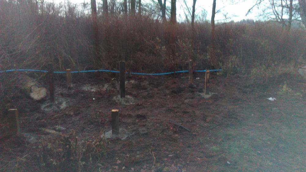

Anyhow, have some time so got the shed under build started.

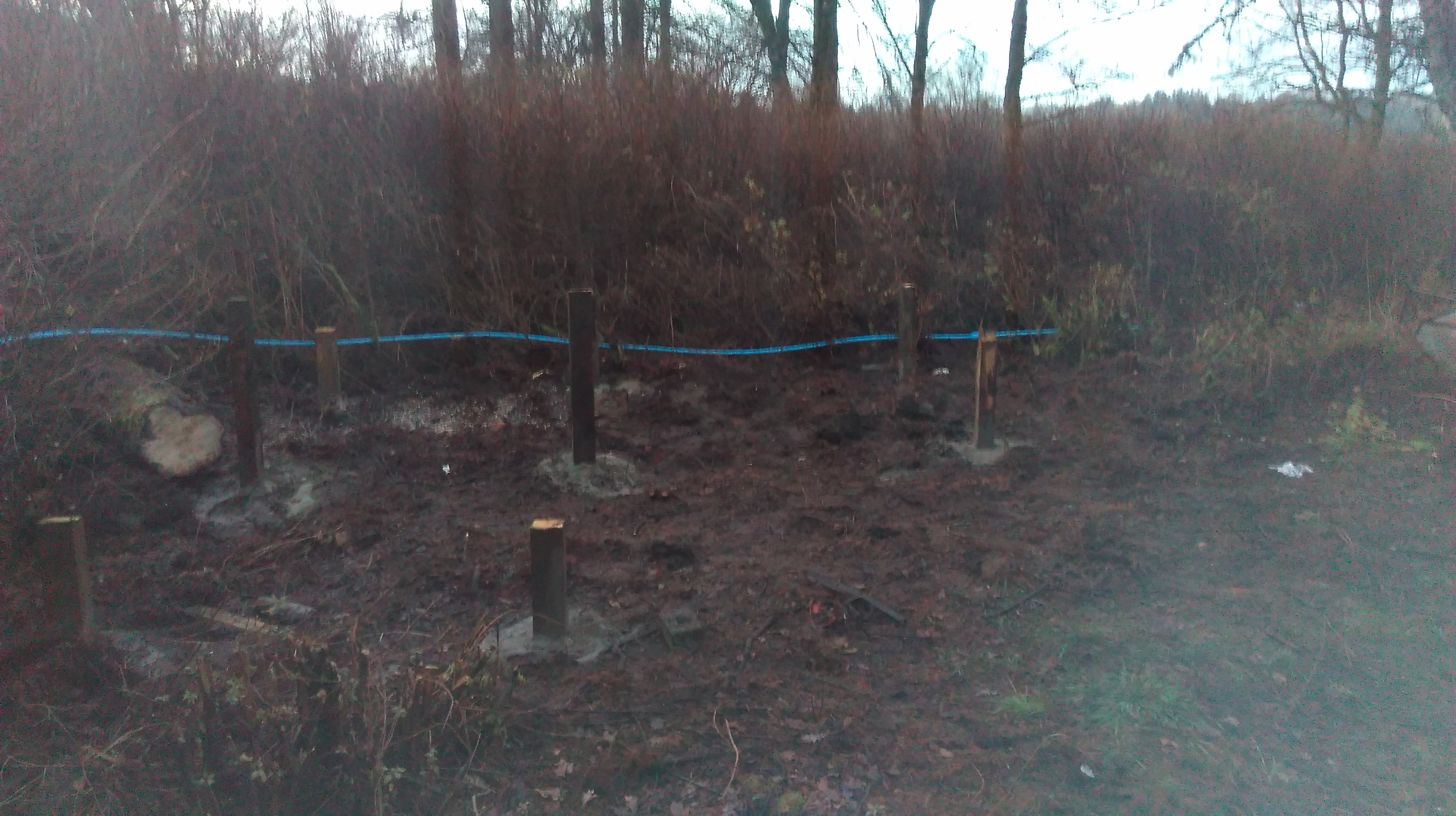

Used some 5" posts and postcrete, very fast and easy to use stuff.
Not so easy however digging out the roots underneath!

Won't those posts be rather short life if direct in PostCrete, even if tanalised? 12-15 years? How long do posts last in Scotland :-).
Can you make a provision to add more in between later ie leave places to attach to the superstructure of your shed. Otherwise you could end up doing repairs over a big distance sideways - looking at the big size of your concrete blobs.
That makes me wonder whether concrete 1200mm repair spurs may be an alternative for me in the future for supporting shed bases on sloping ground.

I've always thought with short timber posts in the ground, that if you were able to drill up the middle with say a couple of inches left undrilled at the bottom you could tap a funnel in and periodically full with "creosote" or old engine oil.

On fenceposts and concrete: Hydro boys have told me that their posts should never be concreted in because it causes faster deterioration (freeze/thaw damage where encased and unable to swell, water-logging of the encased timber which cannot dry out because there is no pathway) and they are forbidden from climbing concreted posts without the use of a cherry picker as they are all classed as dangerous, even if they were installed yesterday. But on the other hand, the crofting grant technical guidance allows you to use shorter strainer posts if you concrete them in.
I tend to prefer surrounding posts by good hardcore, rotten rock if I have any, and pack it down hard. Not as strong as concrete but at let it can drain and allow the wood to breathe a bit.

In the other hand, if the posts are UNDER the shed, they are never going to get wet from rain. The concrete will protect them from water in the ground. so totally different to an exposed electricity pole.
I know it's a totally different climate, but my BIL lives in a 100 year old "Queenslander" wooden house stood on telegraph pole size posts just buried in the ground.

I think exposed telegraph poles wee a different matter to wooden fence posts wince they were deliberately long lasting wood treated with all klnds of luvvly stuff such involving arsenic and tar, which has now been banned.
I am not sure what under-shed shelter will do for posts, but they usually go just above ground as we all know. I suspect some water will seep in somehow.
I either now bash them in sans concrete for 5-10 years, or use concrete posts for 25-50 years.

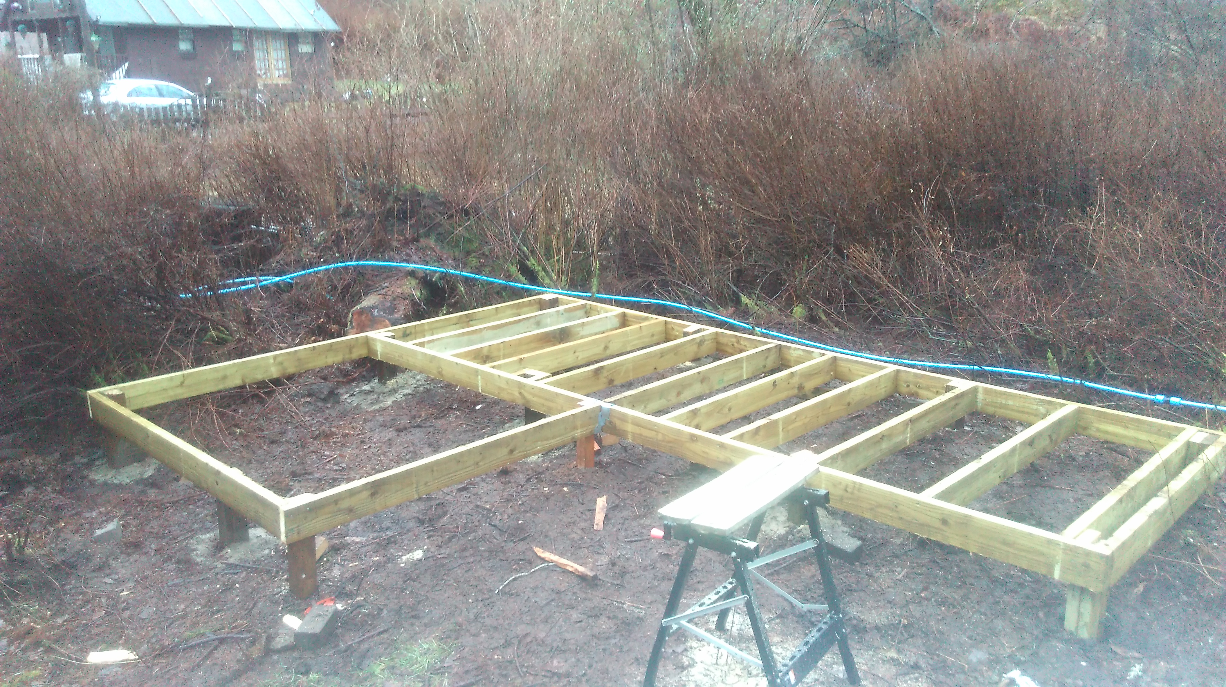

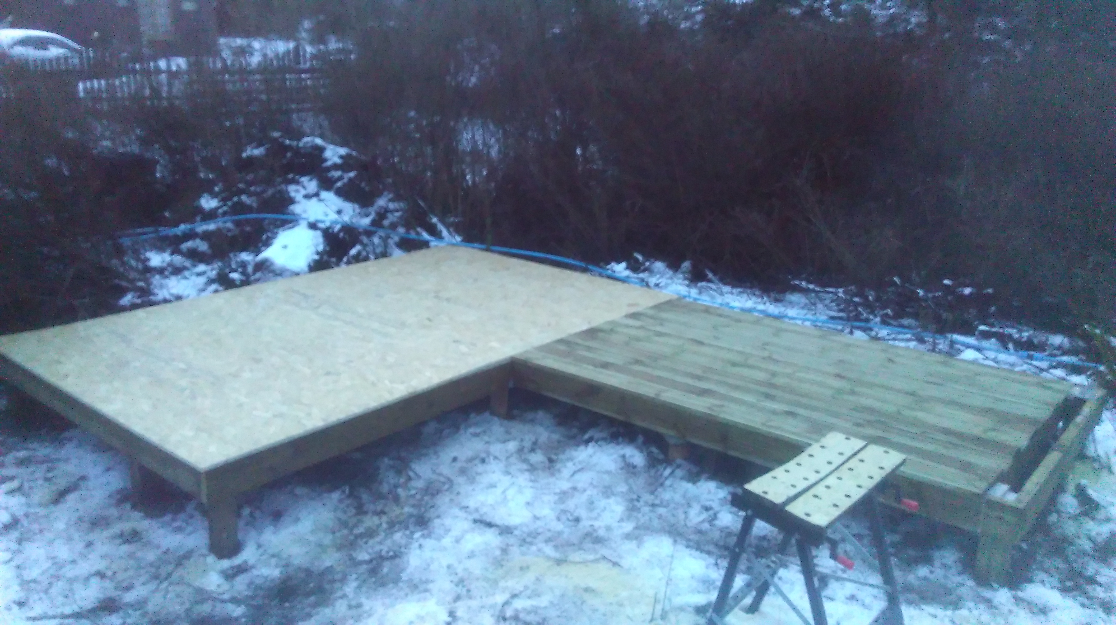

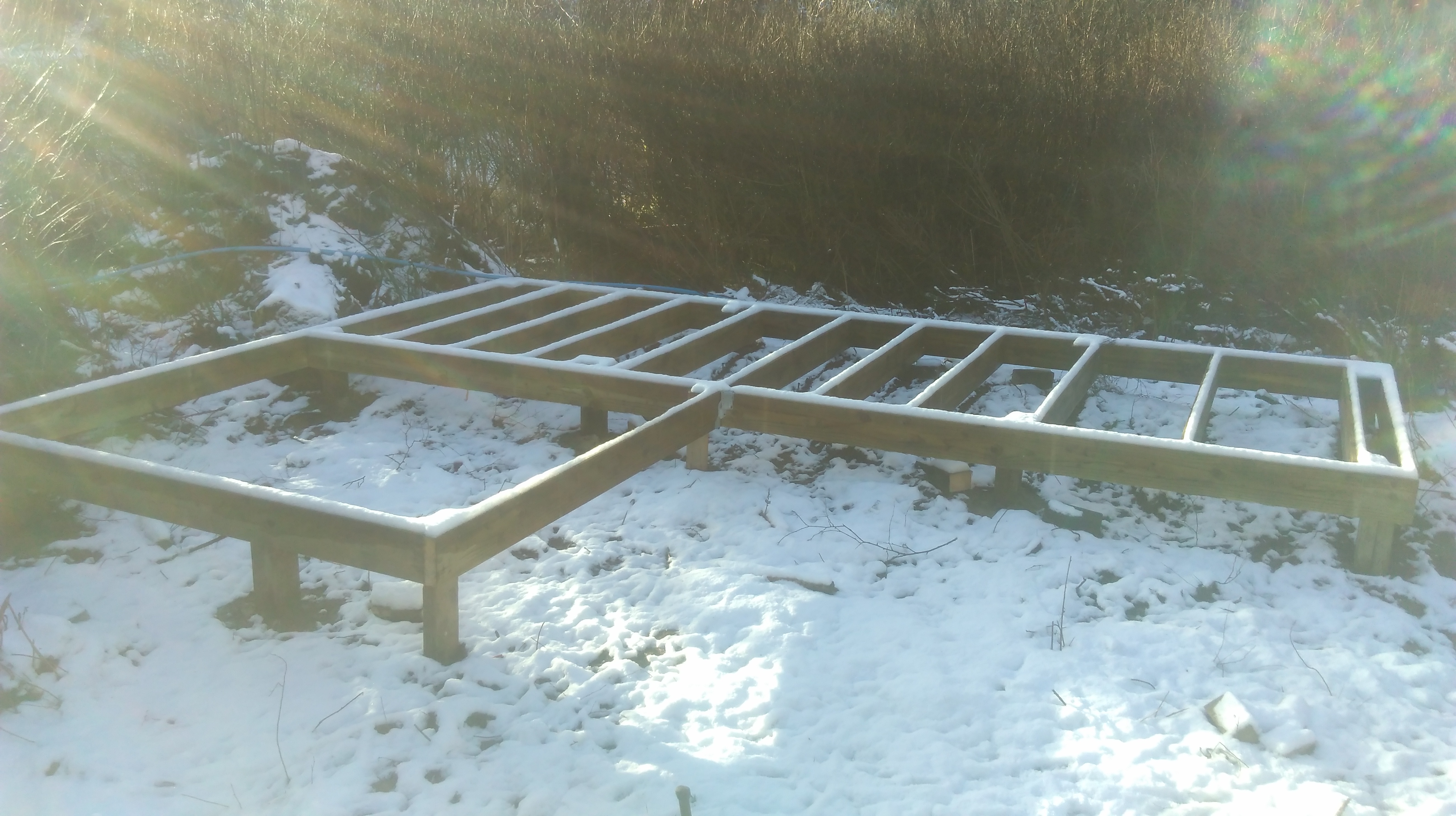

And this was afterwards

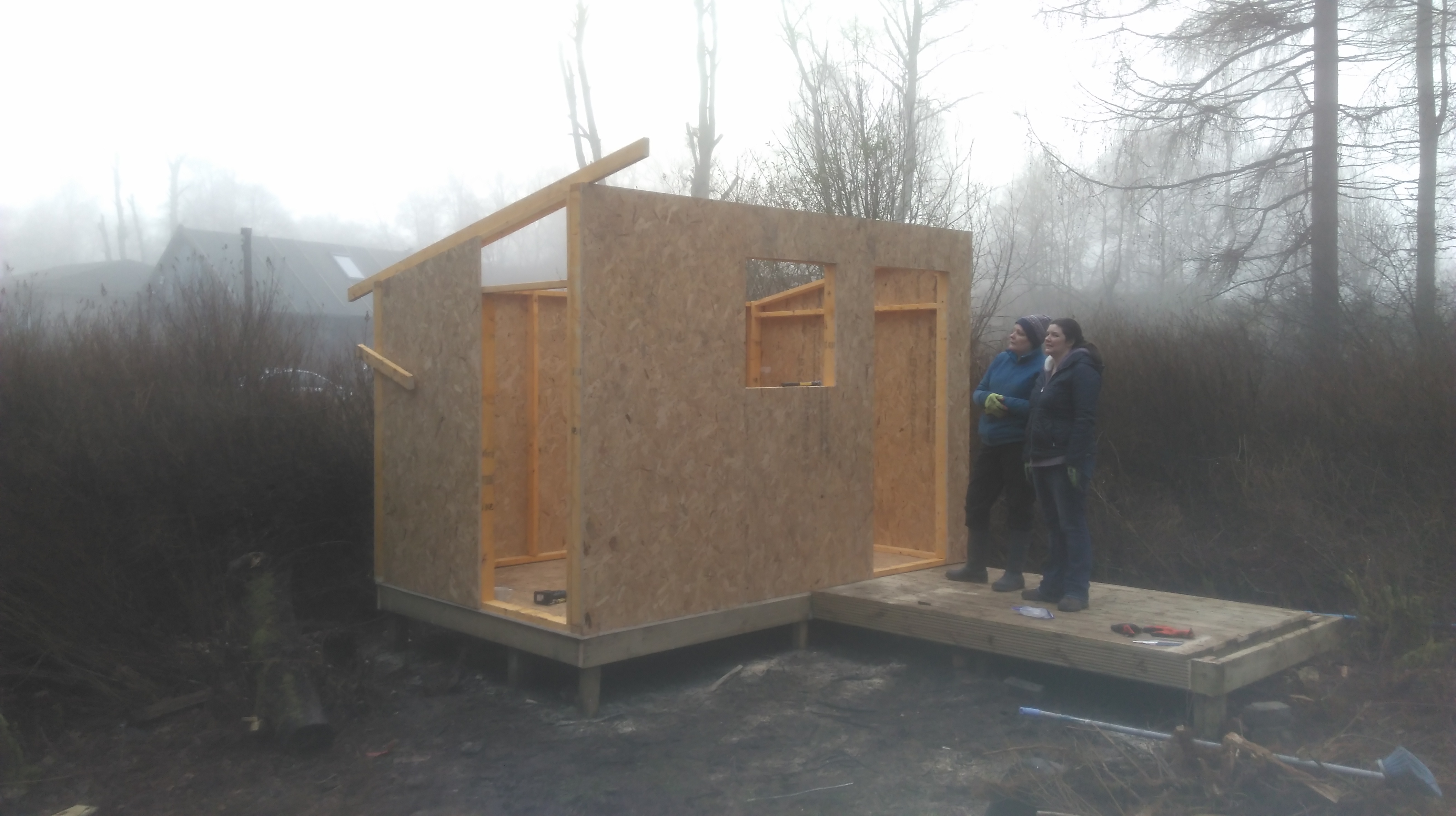

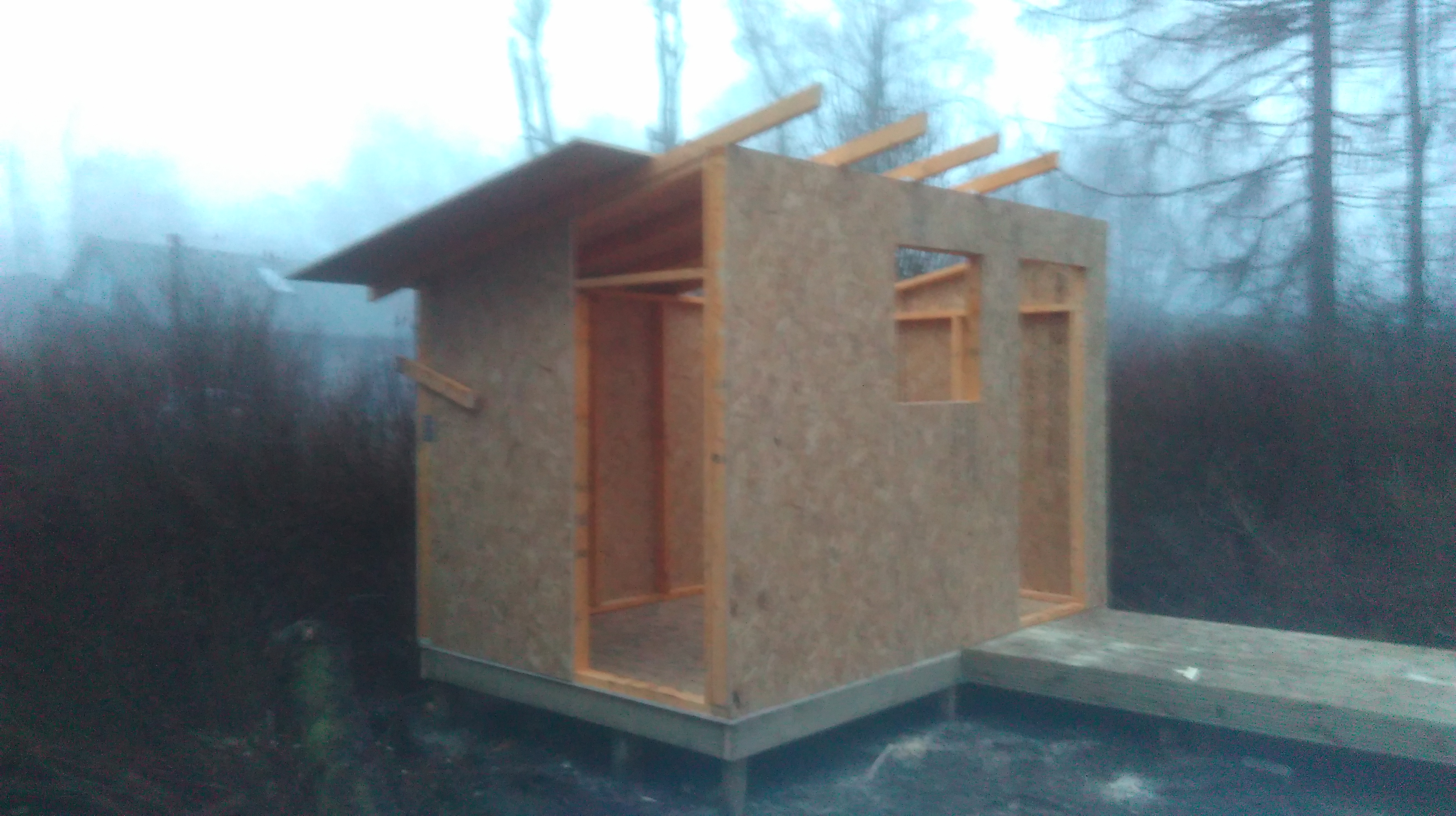

OSB bit is for the shed and the decking part will be open to the front to create a little *bus shelter* area.IMAG0451.jpg

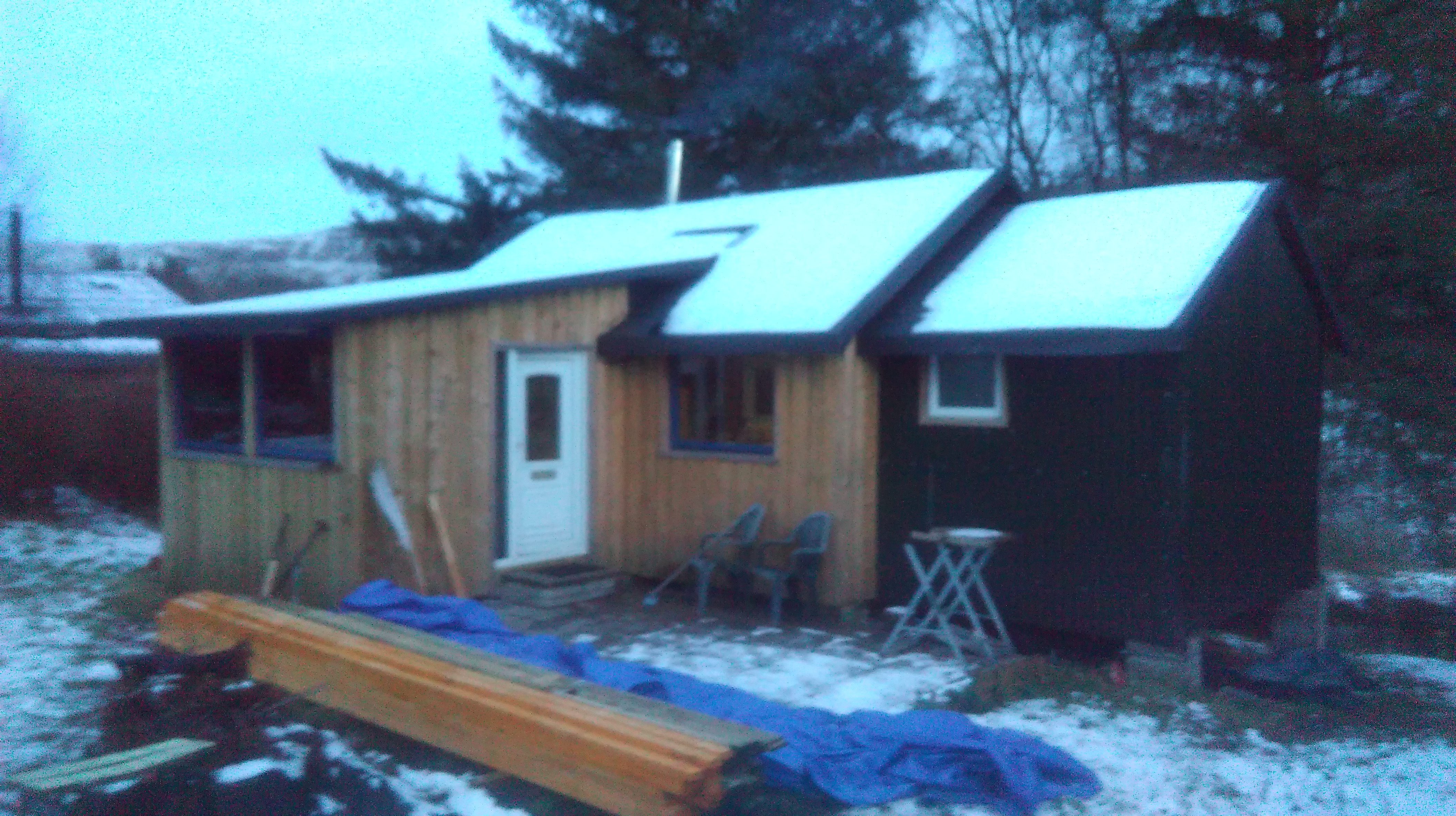

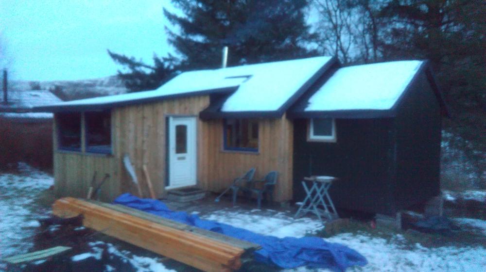

And this is the Hut looking dressed up in the snow?
  • Like 2

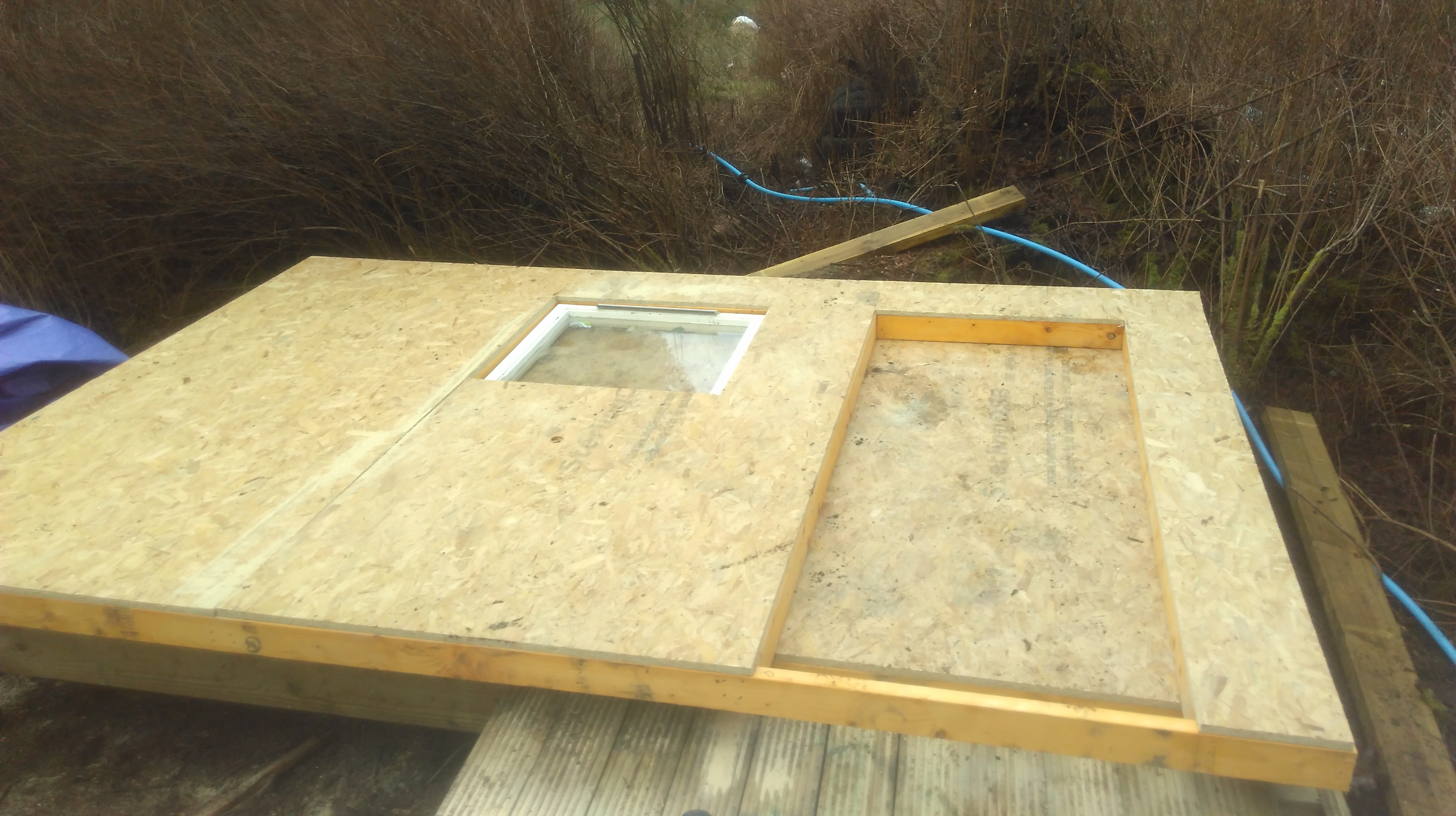

Two half days and two wall panels complete but at 3.5 * 2.4 and clad in 18mm OSB I can't lift it safely?
Need to recruit another helper this weekend and might get the roof on.IMAG0457.jpg
