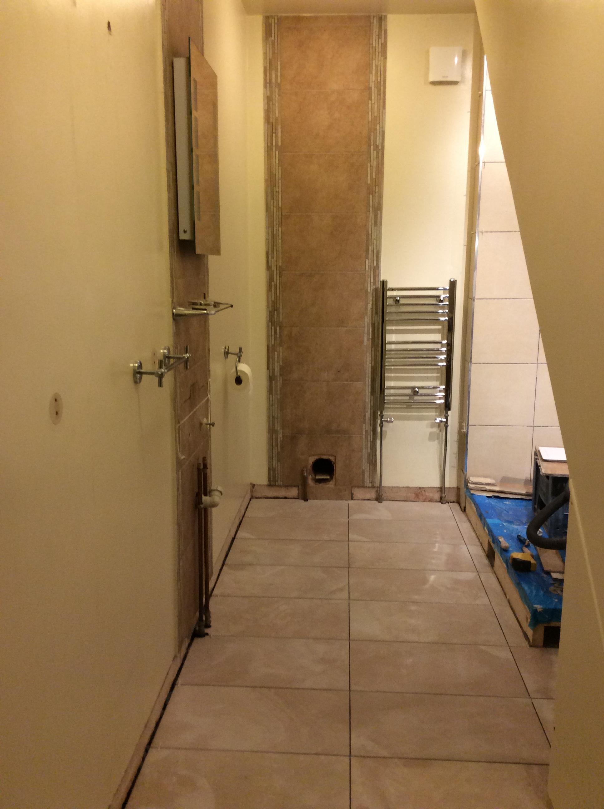

Ferdinand Posted June 6, 2019 Posted June 6, 2019 (edited) In my experience .. ie both bathroom floors have cracked .. trad sand and cement screed is vulnerable to the expansion and contraction due to ufh heating cycles. I know that one crack is in the screen because I have had the bathroom redone this week. I believe that the ufh pipes are in the screed itself but have not dug that up to investigate, as it is not a disastrous crack. Presumably fibres will mitigate (?) Ferdinand Edited June 6, 2019 by Ferdinand

Temp Posted June 6, 2019 Posted June 6, 2019 1 hour ago, Ferdinand said: In my experience .. ie both bathroom floors have cracked .. trad sand and cement screed is vulnerable to the expansion and contraction due to ufh heating cycles. I know that one crack is in the screen because I have had the bathroom redone this week. I believe that the ufh pipes are in the screed itself but have not dug that up to investigate, as it is not a disastrous crack. Presumably fibres will mitigate (?) Ferdinand Not sure what caused that. Looks like quite a wide crack. What's the floor make up?
Ferdinand Posted June 7, 2019 Posted June 7, 2019 On 06/06/2019 at 14:21, Temp said: Not sure what caused that. Looks like quite a wide crack. What's the floor make up? It has some combination of ufh and sand/cement screed, on top of some combination of concrete / insulation. We took the view that the crack is stable and related to the strains imposed by ugh, so did not dig down to find out. It now looks like this 2
