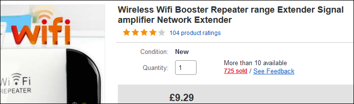

It seems that all I really need is [maybe] a cheapish Repeater, so I have ordered this e'en which seems to work off a network cable
