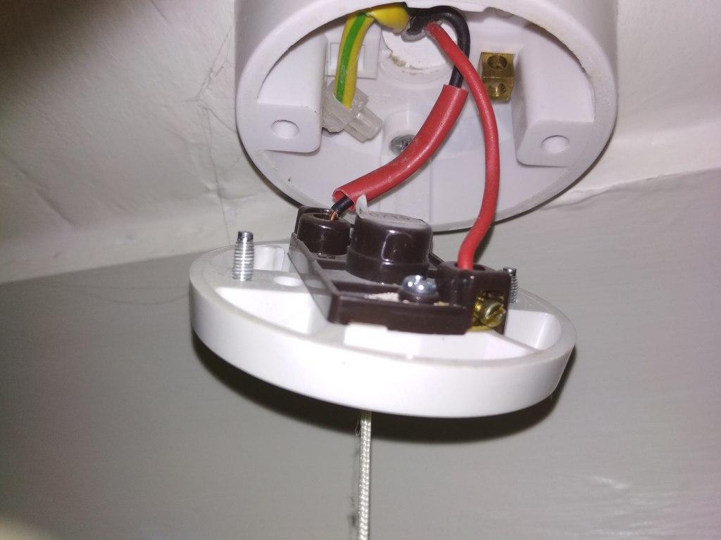

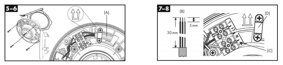

gravelld Posted May 25, 2019 Posted May 25, 2019 (edited) Looks like I'm in over my head again... I purchased one of these: https://www.greenwood.co.uk/product/153/unity-cv2gip to replace an existing extractor fan. I wanted this new unit as apparently it can run in trickle mode then boost when humidity gets too high. The old extractor just worked when the light was on, then had a variable overrun. According to this: https://www.amazon.co.uk/ask/questions/Tx25QNH37J3GAUG/ref=ask_ql_ql_al_hza the new fan should run when the lights are off. I simply rewired from the old extractor to the new one. First time, red into L, black into L1, unsheathed earth into N. I turned the power back on at the fusebox, with the light switch off... The fan turned on as I would expect, but the LEDs either side (coming off the same junction box) also 'glowed' on and off (other LEDs in the room were unaffected). If I turned the light switch on the fan turned off, and the LEDs turned on fully. So - oh dear - not really understanding what I was doing I rewired so black into L, red into L1, unsheathed earth into N. Now, with the light switch off, everything was off. With the light switch on, all lights turn on properly and the fan starts up. However, the fan stops when the light switch is turned off. Which is no good, as per the above requirements. It extracts at the trickle rate when the light is on. Before I check with the manufacturer I wanted to check I wasn't doing something silly with the wiring... or is the junction box setup somehow an issue? The LEDs use transformers to make them low voltage. CV2_Installation_Instructions.pdf Edited May 25, 2019 by gravelld
Jeremy Harris Posted May 25, 2019 Posted May 25, 2019 The wiring's wrong, as the earth should never, ever be connected to a live terminal (neutral is classed as being a live terminal). The earth conductor should be parked in the terminal marked "C" on the right hand diagram. I say parked, as I believe that it's not used, as this fan is probably double insulated (most are). The wiring needs two line connections and a single neutral connection. The two line connections are a permanently on line (via an appropriate isolator switch) and a switched line from the lighting circuit. The neutral needs to be common to both the switched line and the permanently on line, so the permanently on line needs to come from the lighting circuit, but before the switch. With this type of fan it's normal to install an isolating switch that can isolate both line connections and the neutral, for safety reasons. This is the normal type of fan isolator: https://www.screwfix.com/p/mk-logic-plus-1-gang-10a-3-pole-fan-isolator-switch-white/12319 or this one: https://www.screwfix.com/p/british-general-1-gang-10a-3-pole-fan-isolator-switch-white/69862 Your wiring looks to be the old colour codes, so red is line, black is neutral and the bare wire (which must be sleeved) is earth. The permanently on line goes to L, the switched line from the lighting switch goes to L1 and the neutral goes to N. 1
ProDave Posted May 25, 2019 Posted May 25, 2019 +1 to the above, if you only have a 2 core and earth cable then you first need to change that for a 3 core & earth cable back to either the light fitting or light switch, wherever you can pick up a neutral, permanent live and switched live. Where you connect to depends how your lights are wired. 1

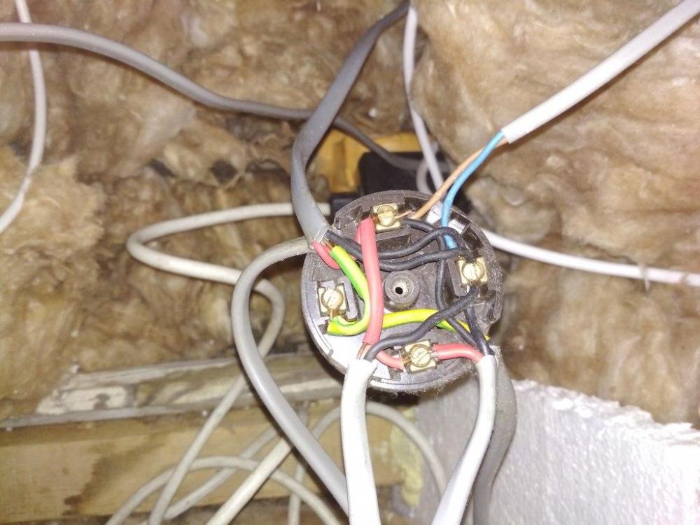

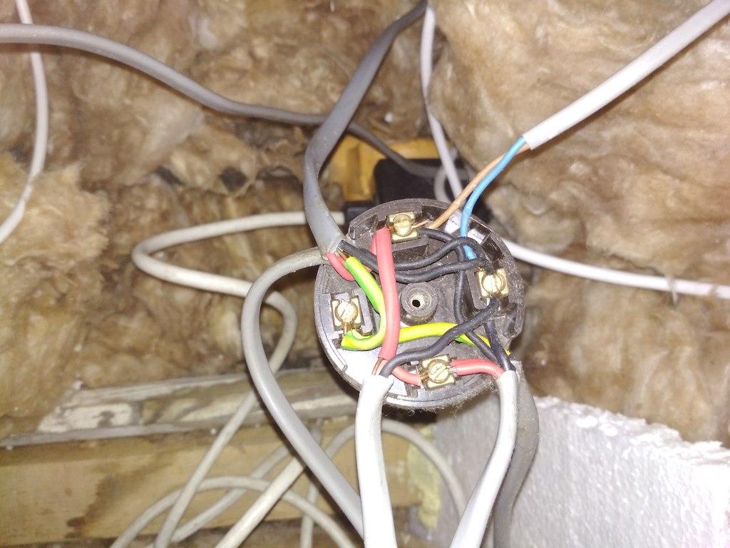

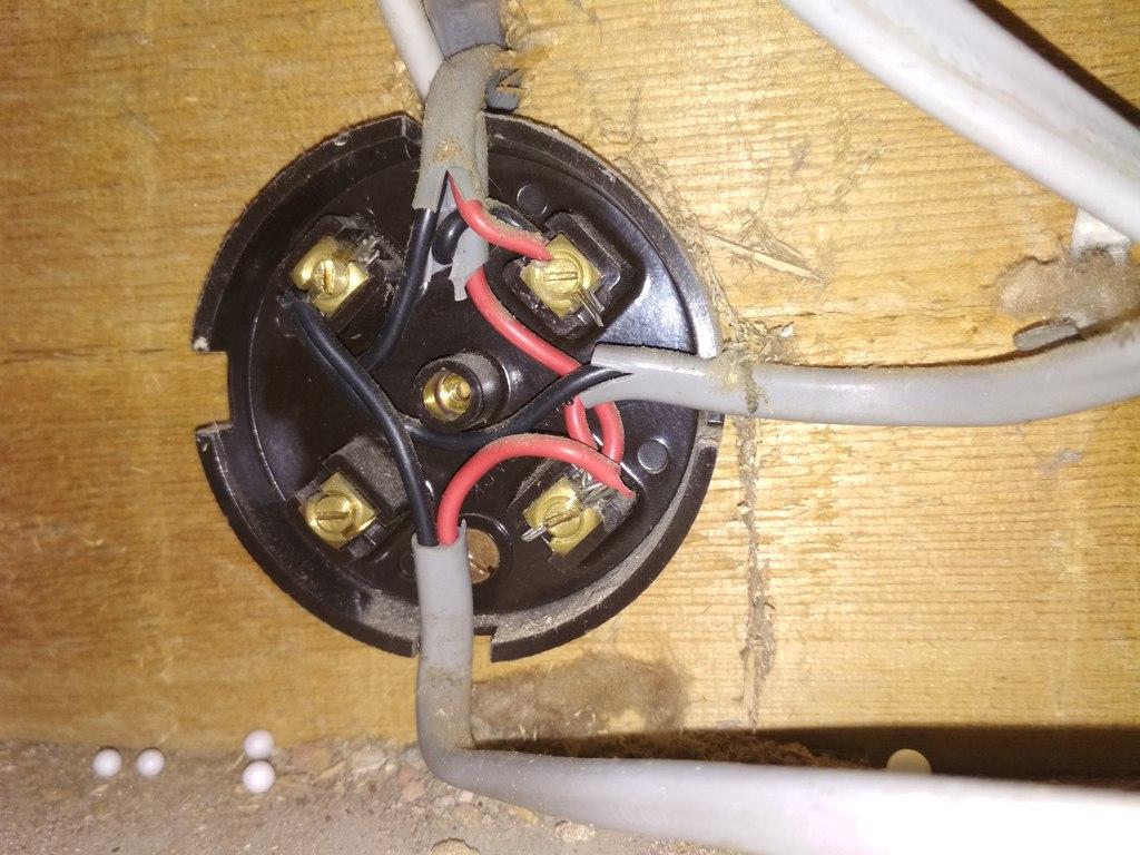

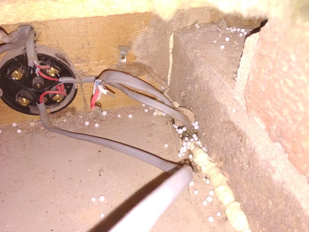

gravelld Posted May 27, 2019 Author Posted May 27, 2019 Ok, just got the chance to trace the wiring. The fan runs into the following junction box: The cable (I'm calling it that because it's stiff, maybe it should be correctly called flex) is the bottom-left cable. The lighter coloured cable to the fore at the bottom right then runs toward the light switch and into this junction box: The cable running into this box from the previous junction box is the one at the bottom. The cable to the right is the one that runs to the light switch. But before I show you that, there's another cable with a different colour code, coming from the ceiling in the general area of the light switch (but not actually visible in the light switch): The cable I'm talking about is the snipped one with blue, red and white coloured insulation. You can see it disappearing into the ceiling. Not shown on the other side of the junction box is a cable with the same colour codes. You can also see the cable from the junction box disappearing into the ceiling to the light switch. To clarify, the junction box you see above is the same one as the previous photo. Finally, the light switch: Are there any obvious strategies from here, do I need to do some more digging?
Jeremy Harris Posted May 27, 2019 Posted May 27, 2019 Going from the bottom photo up, the light switch shows clearly that the lighting is wired as loop in fitting ( https://www.practicaldiy.com/electrics/lighting-wiring/light-wiring-loop.php ). The two conductors in the switch cable are the line (red) and switched line (black with red sleeve). This means decoding the cables going into the junction boxes, which gets a bit less certain to work out by remote control. Dealing with the top photo, with the cable to the fan. First a few observations and questions. Is the flex with the new harmonised colours the drop down to a light fitting? It really needs tidying up so that there are no single insulated conductors exposed, with the outer sheath inside the junction box (or better still made off to a separate junction that includes a cable clamp). I'm guessing here, as it looks like the switched live red sleeve has been left off from the switch cable, and I'm assuming that the switch cable is the one that is coming in at the lower right, with the black conductor (which should be red sleeved) being the switched line, leading to the terminal at the top. Referring just to the top photo, I think that the terminals in that junction box are: Top - Switched line to light (and should go to the fan L1 terminal) Left - Earth Right - Neutral to light (and should go to the fan N terminal) Bottom - Permanently on line to switch (and should go to the fan L terminal) It's good practice to run the feed to the fan (the L, L1 and N) through a 3 pole isolator switch, so the fan can be isolated without needing to isolate the lighting circuit. If you have a meter, then it would be a good idea to test the terminals in the junction box in the top photo to be sure that the connections are as I think they may be. Testing between the bottom terminal and the right hand terminal should show as being live when the power is on. Testing between the right hand terminal and the top terminal should only be live when the light switch is on (with the power on).

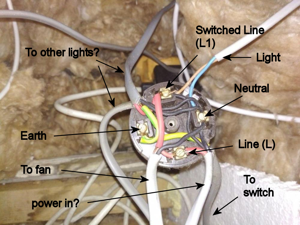

gravelld Posted May 27, 2019 Author Posted May 27, 2019 22 minutes ago, JSHarris said: This means decoding the cables going into the junction boxes, which gets a bit less certain to work out by remote control. Dealing with the top photo, with the cable to the fan. [...] Is the flex with the new harmonised colours the drop down to a light fitting? It really needs tidying up so that there are no single insulated conductors exposed, with the outer sheath inside the junction box (or better still made off to a separate junction that includes a cable clamp). Yes - good point. It's going to a light fitting. 22 minutes ago, JSHarris said: I'm guessing here, as it looks like the switched live red sleeve has been left off from the switch cable, and I'm assuming that the switch cable is the one that is coming in at the lower right, with the black conductor (which should be red sleeved) being the switched line, leading to the terminal at the top. Yeah, the cable from the switch junction box (this is what I will call the "switch cable") is the one at the lower right. There are two cables coming in here - the switch cable and... another one which I haven't traced. However the black conductor does not lead to the terminal at the top, it leads to the terminal on the right. The red conductor leads to the bottom terminal. 22 minutes ago, JSHarris said: If you have a meter, then it would be a good idea to test the terminals in the junction box in the top photo to be sure that the connections are as I think they may be. Testing between the bottom terminal and the right hand terminal should show as being live when the power is on. Testing between the right hand terminal and the top terminal should only be live when the light switch is on (with the power on). I'm not that comfortable using a multimeter on a live circuit but I happened to have a voltage detector easily to hand so I tested for a current with that - it shows all cables into the bottom left and right of the junction box (so those from the switch and from the extractor fan are carrying current (with the light switched off). Let me know if I need more info.
Jeremy Harris Posted May 27, 2019 Posted May 27, 2019 First off, I'd not be that confident about trusting the results from a voltage detector pen/screwdriver thing, as they are notoriously unreliable. Perhaps gain some confidence from trying out the test meter on an easy to access circuit, making sure that the meter is set to measure AC voltage and the test leads are plugged into the voltage sockets on the meter (if there is a choice). If you keep your hands clear of any live terminals the worst that can happen is that you will blow a fuse in the meter if you get something wrong. With luck you should gain a bit of confidence and feel OK with carefully testing the terminals in the junction box. I've been trying to label the various cables into that junction box with where I think they go/come from: Some connections are certain. The earth on the left, the neutral on the right and the switched line at the top (this has to be right as it goes to a light drop). The area of uncertainty is the lower terminal, as it's not clear that the switch cable has a line (red) connection to it, as it's hidden under what I think is the incoming power cable. If you don't want to use the test meter, then I would suggest that you remove the cable running to the fan, with its dodgy earth conductor being used as a switched line, and run a length of 3 core + E so that the earth connects to the earth terminal (with green/yellow sleeving), the brown wire goes to the line terminal at the bottom, the black wire (sleeved with brown) goes to the switched line terminal at the top and the grey wire (with a blue sleeve) goes to the neutral terminal at the right. I know this colour coding seems at odds with what you've got, but under the harmonised rules black can be a phase colour like brown, so shouldn't be used for neutral. 1
ProDave Posted May 27, 2019 Posted May 27, 2019 Your second picture shows a junction box were none of the cables have a CPC. These are old cables before it was normal practice to fit an earth to lighting circuits. You might want to consider getting the lighting circuit rewired or at least a thorough EICR so you know what state it is in. With so much of the lighting circuit having no CPC I would not trust that any earth conductors you do find really are properly connected anywhere, and I would want to be damned certain you have a proper earth connection if you have any class 1 light switches or light fittings. 1

gravelld Posted May 27, 2019 Author Posted May 27, 2019 4 hours ago, JSHarris said: First off, I'd not be that confident about trusting the results from a voltage detector pen/screwdriver thing, as they are notoriously unreliable. Perhaps gain some confidence from trying out the test meter on an easy to access circuit, making sure that the meter is set to measure AC voltage and the test leads are plugged into the voltage sockets on the meter (if there is a choice). If you keep your hands clear of any live terminals the worst that can happen is that you will blow a fuse in the meter if you get something wrong. With luck you should gain a bit of confidence and feel OK with carefully testing the terminals in the junction box. Ok, another step forward, I girded my loins and ran these tests. The bottom and right terminals give 240v. The top and right terminals, with the switch off, give 15v (! not sure if this was the multimeter) The top and right terminals, with the switch on, give 240v 4 hours ago, JSHarris said: Thanks so much for taking the time to label those. It turns out you are one step ahead even on the identification of the cable. The cable you have labelled "power in?" was, I thought, the switch cable. It turns out it was a switch cable, connected as in my previous photos, but to a different switch in the original part of the house (maybe this explains the older wiring). The cable you labelled "To switch" is indeed to the switch I pictured above, in the same room as the fan. 4 hours ago, JSHarris said: Some connections are certain. The earth on the left, the neutral on the right and the switched line at the top (this has to be right as it goes to a light drop). The area of uncertainty is the lower terminal, as it's not clear that the switch cable has a line (red) connection to it, as it's hidden under what I think is the incoming power cable. Do the test results above confirm the lower terminal?
gravelld Posted May 27, 2019 Author Posted May 27, 2019 3 hours ago, ProDave said: With so much of the lighting circuit having no CPC I would not trust that any earth conductors you do find really are properly connected anywhere, and I would want to be damned certain you have a proper earth connection if you have any class 1 light switches or light fittings. All the lights in this room are low voltage fed from an appropriate transformer, but what about the light switch? Thanks for the heads up.
Jeremy Harris Posted May 27, 2019 Posted May 27, 2019 9 minutes ago, gravelld said: Ok, another step forward, I girded my loins and ran these tests. The bottom and right terminals give 240v. The top and right terminals, with the switch off, give 15v (! not sure if this was the multimeter) The top and right terminals, with the switch on, give 240v Thanks so much for taking the time to label those. It turns out you are one step ahead even on the identification of the cable. The cable you have labelled "power in?" was, I thought, the switch cable. It turns out it was a switch cable, connected as in my previous photos, but to a different switch in the original part of the house (maybe this explains the older wiring). The cable you labelled "To switch" is indeed to the switch I pictured above, in the same room as the fan. Do the test results above confirm the lower terminal? Well done! The test results do indeed seem to confirm that the top terminal is the switched line (L1) and the bottom terminal is the permanently on line (L), with the right hand terminal being the neutral. If you connect a 3 core + E cable as suggested earlier then the fan should work as intended. The 15V you measured when the switch was off will just be induction, and is normal. These induced voltages in cables are one reason that the volt pen type detectors are pretty useless, as they will often light up from an induced voltage. A meter discriminates between a low induced voltage and the supply voltage, so is usually more reliable. 1
