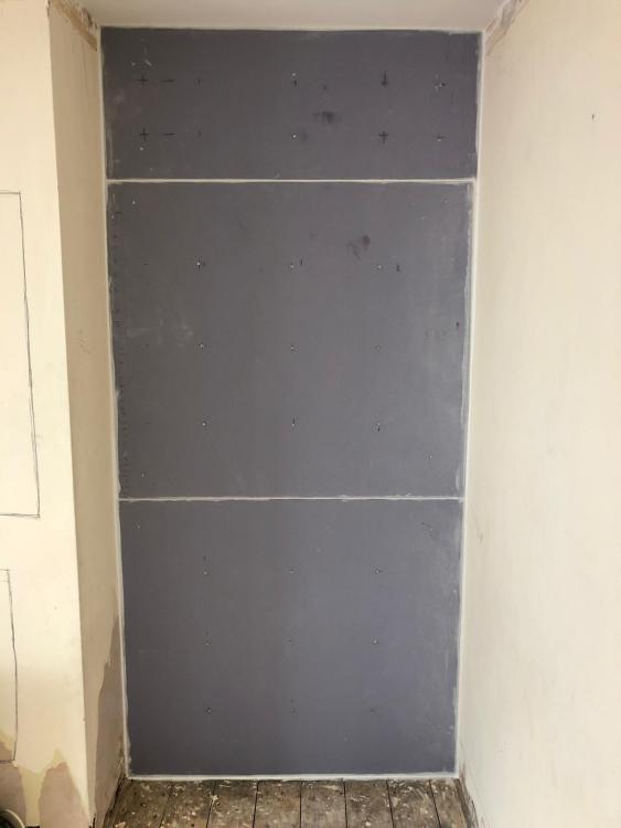

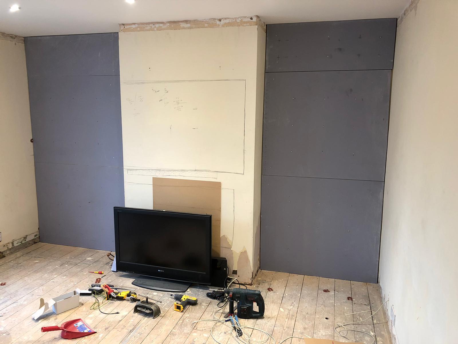

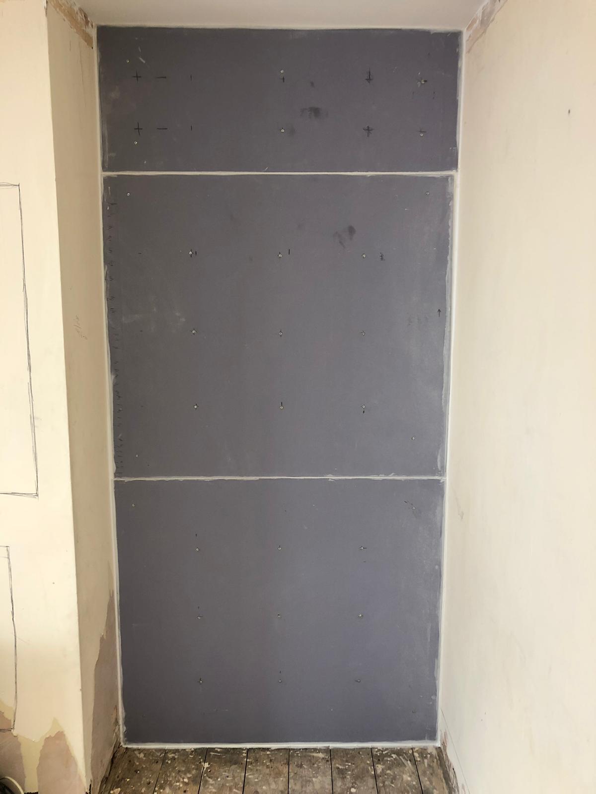

15 hours ago, Onoff said:
Mate has just fitted these in his alcoves either side of his chimney breast:
https://www.soundproofingstore.co.uk/store/SoundBoard-4-1-2m2-30mm-p52219211
If that’s all he’s going to do I would think it wasn’t worth the expense. What about the rest of the walls. Those floor boards will let so much sound through (unless he is using an acoustic underlay), and I assume he hasn’t put anything under them between the joist and part wall? And the ceiling doesn’t look like it’s been touched.
Don’t get me wrong, the acoustic boards are good though!.. especially If they have been installed using an acoustic sealant (like green glue).
