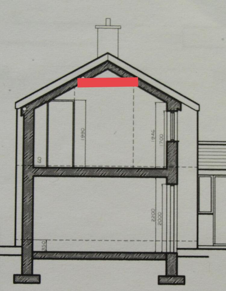

zoothorn Posted June 16, 2019 Author Share Posted June 16, 2019 Hi chaps- anyone know about collared ceilings? I get the idea, suggested by builder (the open to apex not possible he said, structure-wise I think).. looked at google info/ pics etc. But the height of the collars, the position of the raised celing in room2, is critical to the whole extention plan: everything internally (space/ H in room2, floor position between, space/ H in below room1) is relative to their position. Would two additional cross-members (I dont know the term) at each end of the roof..at the level a traditional flat ceiling would be, say just above french windows' frame top/ below the collars, be needed too? I mean one at each end of the room, one french doors' end & one opposite house end. I'm thinking structurally etc. Link to comment Share on other sites More sharing options...
PeterW Posted June 16, 2019 Share Posted June 16, 2019 A collar goes across every pair of rafters - it’s a common detail and pretty easy to design but is usually done as part of a truss if it is being used for an open plan room. They don’t need to be too low, but also they can’t be too high as they don’t work otherwise. The maximum you get away with from memory is 1/3rd height of the roof, so basically if you get a ruler and measure the vertical distance from the apex to the wall plate, you’ll get the maximum height you can get in the roof if you measure 1/3rd down from the apex. Link to comment Share on other sites More sharing options...
zoothorn Posted June 16, 2019 Author Share Posted June 16, 2019 Ok Peter thanks/ understood. Do you know if going Timber Frame walls, will mean any extra roof structure/ bracing is needed, over standard solid walls? & if the 1/3rd rule you mention is the same for solid or TF walls (not say increaced to perhaps 1/2 max for TF)? I'm on the cusp of having a viable sized knock-thru door (into a 1-step down floor position, from main bedroom in house).. or a restricted door H if the collared ceiling level is lower than the top of an average H door frame, even at the highest the ceiling can be.. or the whole idea isn't possible at all. I don't think you see my builder, or my 'architectural consultant', have given this enough thought.. or barely any thought at all tbh. So I think its solely up to me to determine if door frame can indeed just fit in (or its compromised in H, or it just cannot be done). Not easy for me, as I don't know A) how thick the roof would be, & B) exactly what height point the collared ceiling will be. Link to comment Share on other sites More sharing options...
PeterW Posted June 16, 2019 Share Posted June 16, 2019 @zoothorn being very rough and ready I think the lowest the collar will be is as I’ve added here based on 1/3rd down. Link to comment Share on other sites More sharing options...

zoothorn Posted June 16, 2019 Author Share Posted June 16, 2019 Hi PeterW- really appreciate that. Hey looks like I might get away with it.. just! any idea if B.Regs need a minimum H to the door frame? here it says 1990 on plan, but my kitchen door frame (thru to main room, with its very low ceiling beams just above my head) is 1880 x 820mm. Would I be allowed to build a similar sized smaller door for my knock-thru into my extention room2 do you think? Link to comment Share on other sites More sharing options...
PeterW Posted June 16, 2019 Share Posted June 16, 2019 So..... in English and Welsh building regulations, there are minimum widths for doors, but no minimum height ... go figure..!! Link to comment Share on other sites More sharing options...
