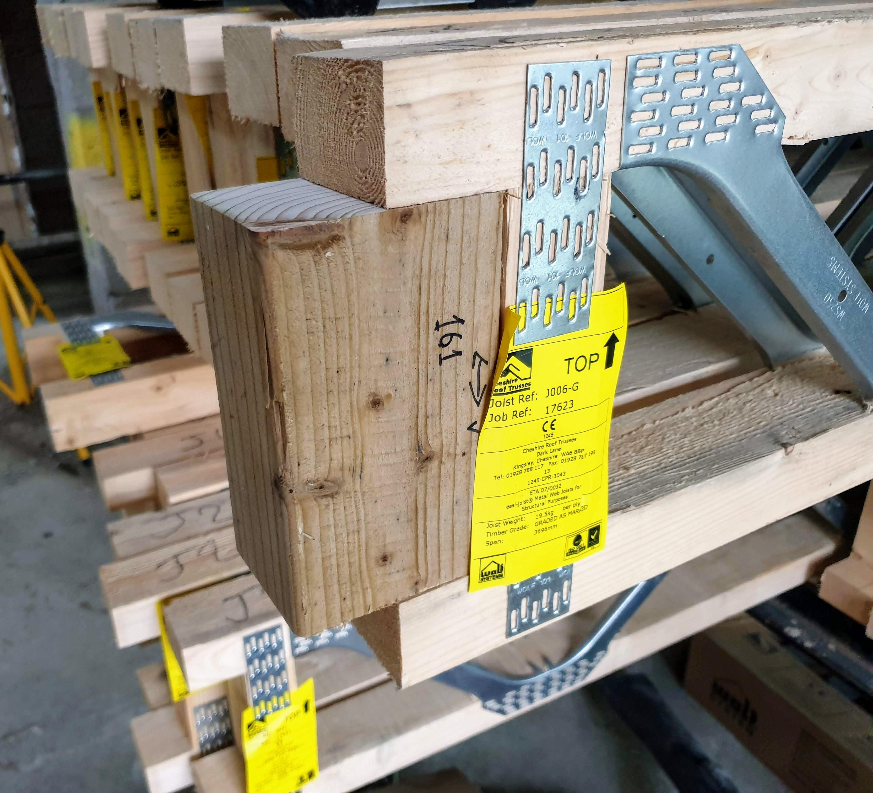

ToughButterCup Posted May 16, 2019 Share Posted May 16, 2019 £1800. Three different specs. and this is what you can do to correct builders' errors ( that is building by eye, rather than with a line and level ) Steve at Cheshire Roof Trusses helped me through that particular trauma. Be sure to specify exactly how the joist is attached to the wall plate, and measure the width at each and every joist station along the wall. Ian Link to comment Share on other sites More sharing options...

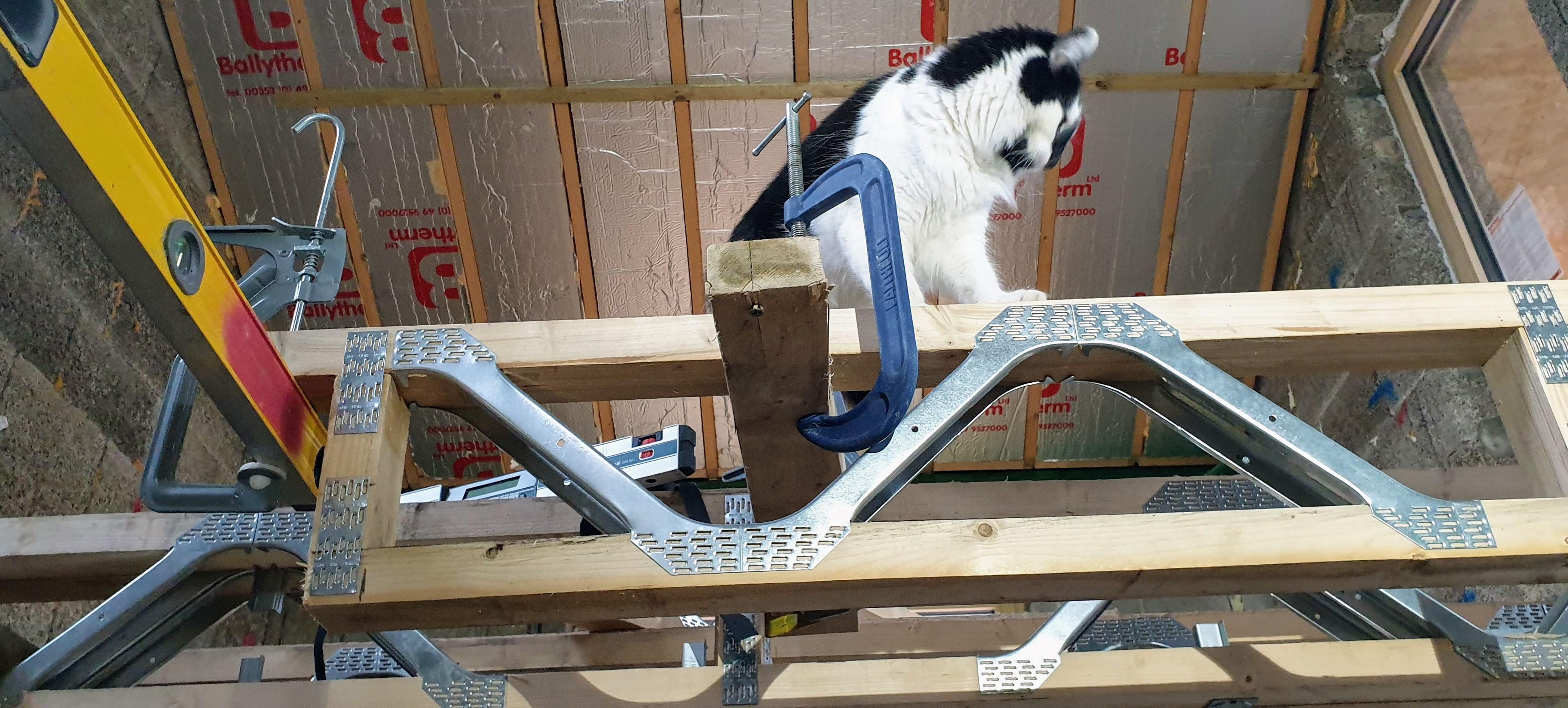

ToughButterCup Posted May 16, 2019 Share Posted May 16, 2019 Just now, Big Neil said: [...] What was your total floor area covered by that? 46 sq meters and a roof of 10 sq meters. Wanna laugh? - I put them up on my own with the following results...... 1 Link to comment Share on other sites More sharing options...
Ferdinand Posted May 16, 2019 Share Posted May 16, 2019 (edited) 16 minutes ago, AnonymousBosch said: 46 sq meters and a roof of 10 sq meters. Wanna laugh? - I put them up on my own with the following results...... As you can see, we are the most supportive (word used advisedly) self-build forum in the world. Nice cat, though. Edited May 16, 2019 by Ferdinand Link to comment Share on other sites More sharing options...

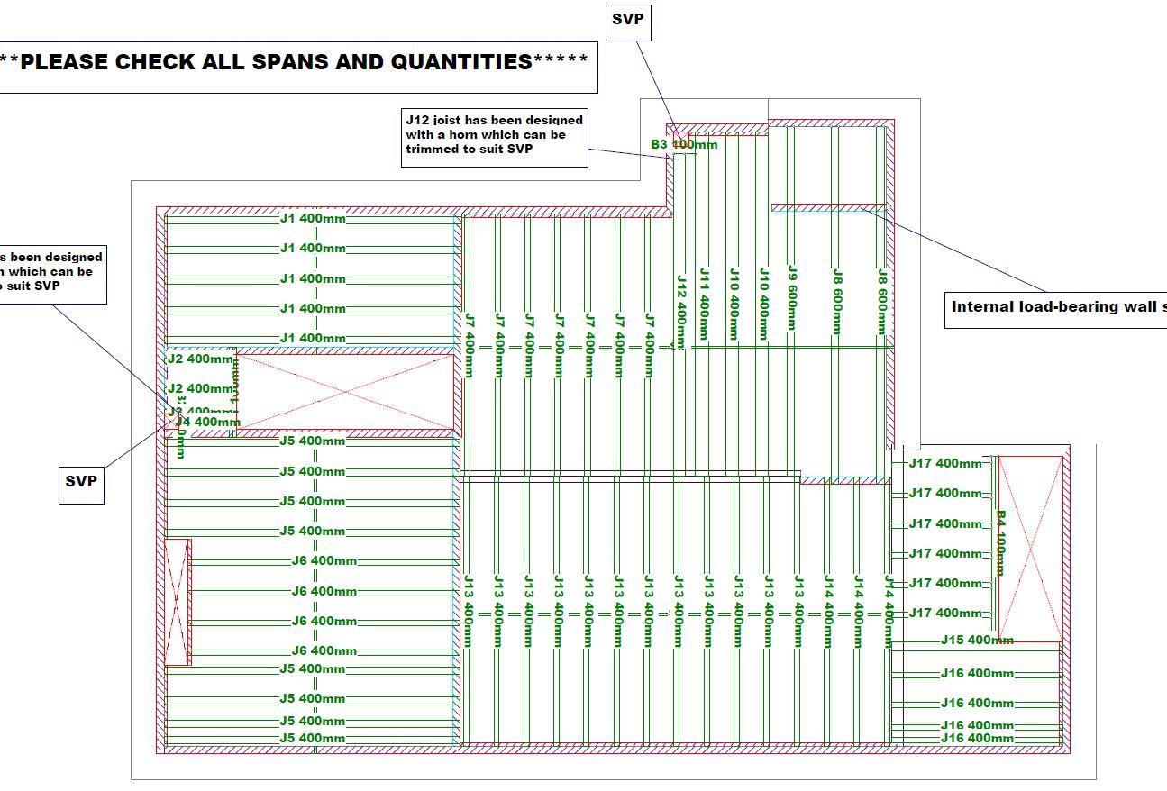

willbish Posted June 8, 2019 Share Posted June 8, 2019 @Big Neil Here's my final Easi Joist plan from Manderwood 59 Joists and a few binders 400mm centers apart from one area which is opened to 600 centers to hide duct cooler in ceiling void Most joists 72mm or 97mm wide, with a couple of real chunkers at 172mm wide. Top hung on pole plates and steel predominantly 7 - 10 day delivery £2611 with VAT (untreated!) 1 Link to comment Share on other sites More sharing options...
