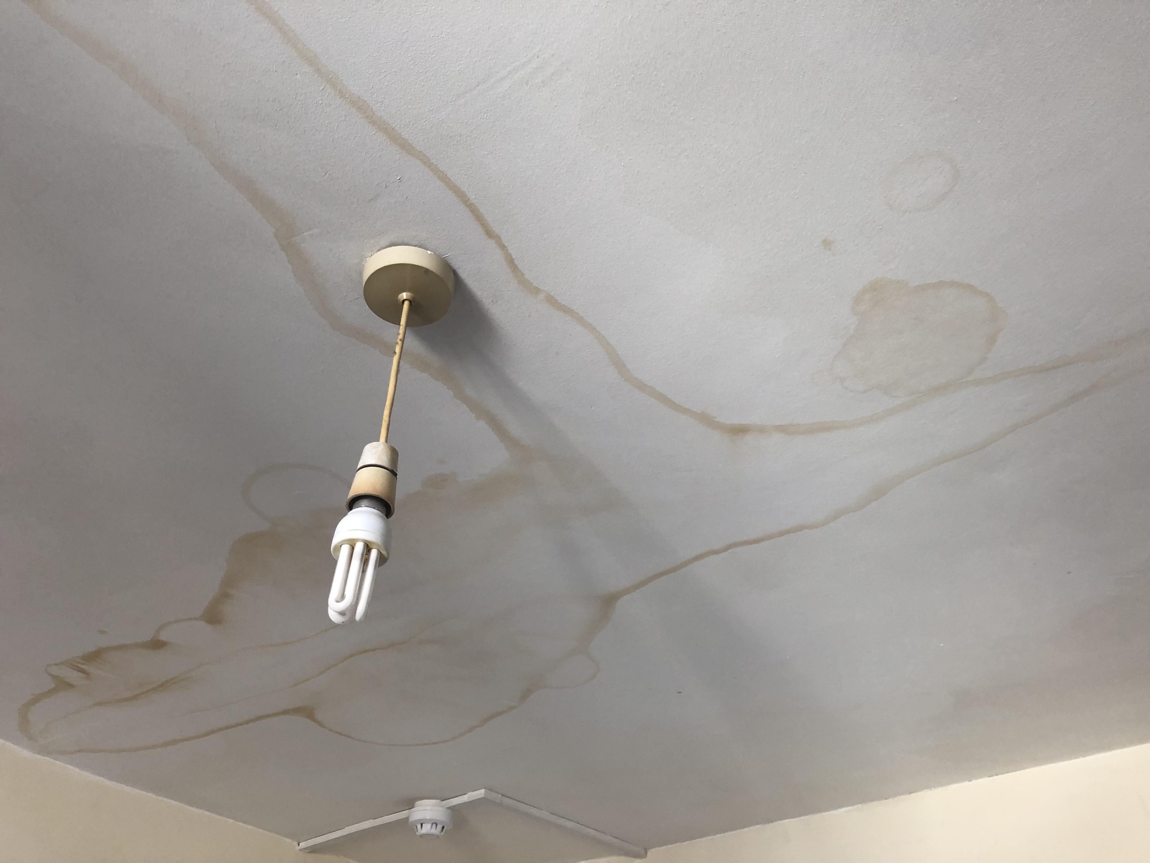

Pocster Posted May 13, 2019 Posted May 13, 2019 Hey Got this on a ceiling Leak fixed but nasty stain . I know most stain block stuff is now water based so pants . Looking for a recommended product; 1 hit job done ! - screwfix link or similar appreciated cheers
ProDave Posted May 13, 2019 Posted May 13, 2019 In the past I have used gloss paint undercoat, which gives a matt finish and covers most things, them emulsion over the top. 1
Temp Posted May 13, 2019 Posted May 13, 2019 (edited) Id go for Zinsser Bulls Eye 123 Primer Sealer Stain Killer.. https://www.screwfix.com/p/zinsser-bulls-eye-1-2-3-primer-sealer-1ltr/10135?tc=IB6&ds_kid=92700030933329085&ds_rl=1241687&ds_rl=1245250&ds_rl=1243321&ds_rl=1245250&ds_rl=1249484&gclid=CjwKCAjwq-TmBRBdEiwAaO1enyt30_81LTfexB9hr5oI9fcvFI9xz_gefInb1VODoGsbf922q35hqRoCpmEQAvD_BwE&gclsrc=aw.ds Someone here recommended their range to me for the ceiling over a shower where the steam was causing paint to peel off. Worked very well. Edit: They also have a "Cover Stain" version. Edited May 13, 2019 by Temp
scottishjohn Posted May 13, 2019 Posted May 13, 2019 I would wait a bit -the marks are where pb joints are --so are you sure the skimming is secure+dry? one hit job?--paint it when you sure the PB is fully dry,right through and secure 2
Pocster Posted May 13, 2019 Author Posted May 13, 2019 1 hour ago, Temp said: Id go for Zinsser Bulls Eye 123 Primer Sealer Stain Killer.. https://www.screwfix.com/p/zinsser-bulls-eye-1-2-3-primer-sealer-1ltr/10135?tc=IB6&ds_kid=92700030933329085&ds_rl=1241687&ds_rl=1245250&ds_rl=1243321&ds_rl=1245250&ds_rl=1249484&gclid=CjwKCAjwq-TmBRBdEiwAaO1enyt30_81LTfexB9hr5oI9fcvFI9xz_gefInb1VODoGsbf922q35hqRoCpmEQAvD_BwE&gclsrc=aw.ds Someone here recommended their range to me for the ceiling over a shower where the steam was causing paint to peel off. Worked very well. Edit: They also have a "Cover Stain" version. Cheers Will try it !
SiBee Posted May 13, 2019 Posted May 13, 2019 Classidur universal xtrem. Job done. Discussed a bit on the painters forums. Old boys do what Dave mentioned as it works? It’s great that a forum exists for most things? 1
