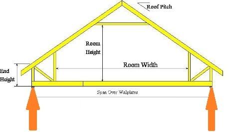

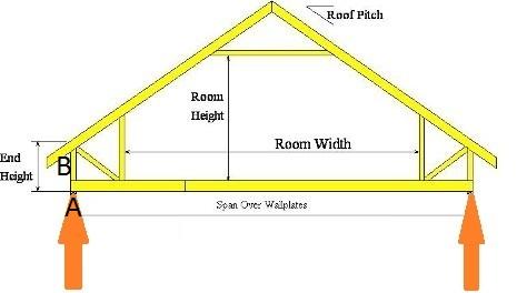

ProDave Posted May 18, 2019 Share Posted May 18, 2019 On 17/05/2019 at 10:56, PeterW said: Wall plates on an bobtail truss always go under A. There is only a cold bridge if you don’t insulate the ends. What carrier system are you using for the slips ..? Interesting. I was doing a garage not long ago so walls built of single skin 6" blocks, room in roof above like this. The trusses were only supported at pint B (with triangles built in at that point to give a flat bearing surface) and point A just hung down between the block walls. I guess there is more than 1 way to do things. Link to comment Share on other sites More sharing options...

ProDave Posted May 18, 2019 Share Posted May 18, 2019 7 minutes ago, Vijay said: Any idea if the truss supplier were ok with that? I am assuming the truss supplier designed it like that, it was they that fitted the triangles to make a flat bearing point at point B. Link to comment Share on other sites More sharing options...
PeterW Posted May 18, 2019 Share Posted May 18, 2019 56 minutes ago, ProDave said: Interesting. I was doing a garage not long ago so walls built of single skin 6" blocks, room in roof above like this. The trusses were only supported at pint B (with triangles built in at that point to give a flat bearing surface) and point A just hung down between the block walls. I guess there is more than 1 way to do things. That is for a garage, there would be no design load on the bottom chord. This is for a a room in roof so the bottom chord is load bearing. Link to comment Share on other sites More sharing options...
ProDave Posted May 18, 2019 Share Posted May 18, 2019 2 minutes ago, PeterW said: That is for a garage, there would be no design load on the bottom chord. This is for a a room in roof so the bottom chord is load bearing. But the garage was designed to have a room above, which is the only reason the walls go higher than the ceiling level. So the bottom chord is taking a load. I can't recall if that bottom chord was really just hanging there, or whether they used joist hangers at the ends (I would have done) for additional support. This is the only time I have seen it done like that and was surprised. Link to comment Share on other sites More sharing options...
Vijay Posted May 22, 2019 Author Share Posted May 22, 2019 I emailed a couple of suppliers about supporting this bob tail roof. First said " We can design bobtail trusses with hangers if required" but the other supplier said "Timber hangers would be an option for trusses with light support reactions, however for multiple-ply girders you’re going to run into problems as face-fix timber hangers can only take up to a certain load. I’d recommend terminating the panel for normal wallplate height so the truss can transfer the load straight down through the wall." I think it makes more sense to keep the wall plate lower, then build up the wall once the trusses are in place with ICF, then if it's ok, I will back-fill the ICF inner core with concrete (so the timber trusses are buried in the concrete) Link to comment Share on other sites More sharing options...
PeterW Posted May 22, 2019 Share Posted May 22, 2019 So get them to do a more complex inbound stub that supports the rafter and only buries the joist end in the ICF. It would probably mean the bottom chord is a composite or metal web with a block in it to transfer loads but should be doable. Link to comment Share on other sites More sharing options...
Vijay Posted May 22, 2019 Author Share Posted May 22, 2019 so not a good idea to bury timber in concrete then? Link to comment Share on other sites More sharing options...
PeterW Posted May 22, 2019 Share Posted May 22, 2019 Only the minimum possible. You wouldn’t want to bury the uprights as it would compromise the concrete strength and thickness and you’d end up with lots of disconnected core segments. Whats the issue with doing it properly and using a wall plate and then cladding the outside of the stub walls ..? Would be easier and less to go wrong. 1 Link to comment Share on other sites More sharing options...

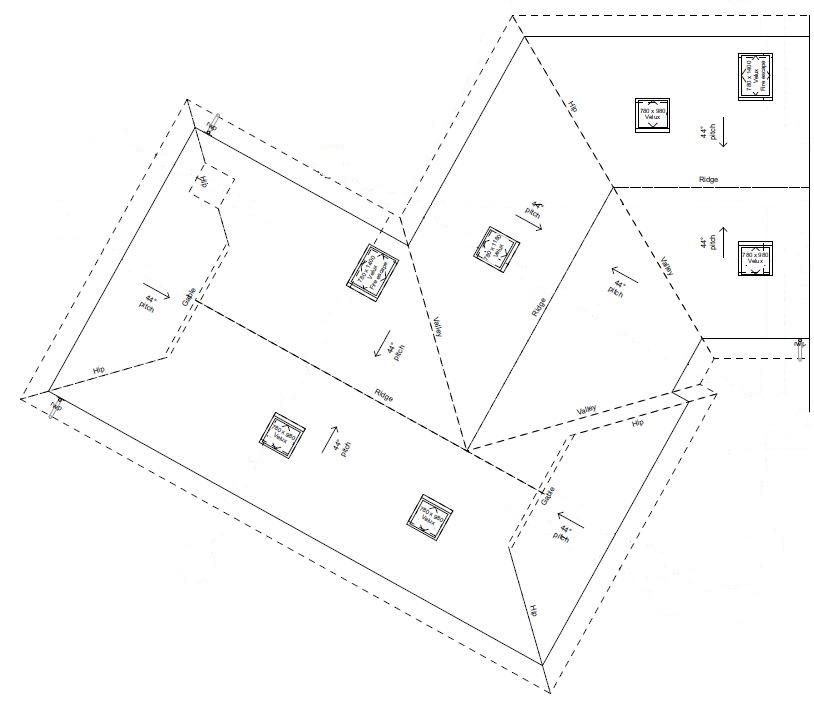

Vijay Posted August 1, 2019 Author Share Posted August 1, 2019 Does anyone know why suppliers don't seem to do attic trusses with Posi joists for the floors? I'm waiting on the Wolf system suppliers to get back to me as they may be the only ones who do Link to comment Share on other sites More sharing options...
Oz07 Posted August 1, 2019 Share Posted August 1, 2019 4 hours ago, Vijay said: Does anyone know why suppliers don't seem to do attic trusses with Posi joists for the floors? I'm waiting on the Wolf system suppliers to get back to me as they may be the only ones who do Connection detail I'd imagine. If you have gables you Could have gantry beam/truss gable to gable within proper attic area then mono trusses off each side of this down to wall plate. With posis for your floor Link to comment Share on other sites More sharing options...
Vijay Posted August 4, 2019 Author Share Posted August 4, 2019 Here's a simplified pic of the single storey roof. It joins the house on the right hand side. I do have 2 Dutch gables, so not sure how they would work to support a beam. Also I think the issue would be where the roof joins at an angle (the 30 odd degree one). Who would design a cut roof? Link to comment Share on other sites More sharing options...
Oz07 Posted August 4, 2019 Share Posted August 4, 2019 (edited) You're near me aren't you @Vijay? Try Harlows or Donaldsons. They would usually design based on providing the timber. Who's doing your main roof? Scrap that just seen location as london! Edited August 4, 2019 by Oz07 Link to comment Share on other sites More sharing options...
