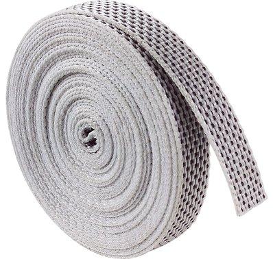

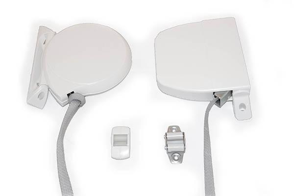

13 hours ago, Nick said:
I take it the cord is on the outside of the building then? Is there a solution for windows higher than the ground floor?
No the cord is like a wide ribbon and it is also rolled into spring-loaded cassette. This Youtube is pictorial

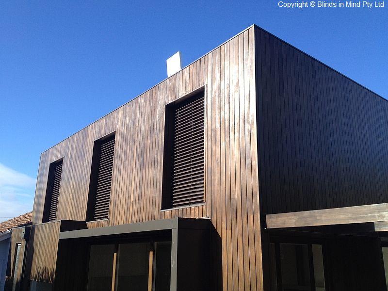

1 hour ago, puntloos said:
Do you have some pictures for us? (either yours, or just brochure pictures is fine)
I'm trying to imagine this, but my gut feeling is it wouldn't look 'elegant', but it sounds like a great solution for our front. (our plot is SE facing, if that matters)
Happy to be proven wrong. Although I'm 99% certainly going for awnings in our back yard because they also provide a great 'living area'.
I don't really share pics of my house on t'internet, but they look something like this (albeit with horizontal larch cladding, and with the windows/blinds recessed about another 400mm inwards):
In the white-painted brick sections of the house, they're set back about as much as in the photo above. As shown in this photo, you don't need to close the blinds completely to get most of the benefit. I prefer them slightly open like this, and only close them when it's very hot and the sun is directly on them, and at night.
I think they look "elegant", as you put it, but our house is extremely modern, so I think it works.
I can't see how awnings are a replacement for some sort of per-window solution like blinds or roller shutters in all but very limited areas. There are about three places in our house where some sort of awning might work. One of those is outside a big south-facing slider, but the height of the slider means that the awning would need to be huge to keep out the spring and autumn sun. We're lucky to have a tree that provides some shade in this area, so for the moment we don't have any shading treatment on that opening.
The other two points have 1.2m overhangs due to balconies above them, so already have a decent bit of solar control. They also have blinds, which helps on summer mornings (they're east-facing).
I can't see how awnings are a solution for first floor windows, windows along the side of a property or street-facing windows.
If you don't much like the look of blinds, that's fine - just leave them fully retracted (they're invisible) unless you actually need them.
