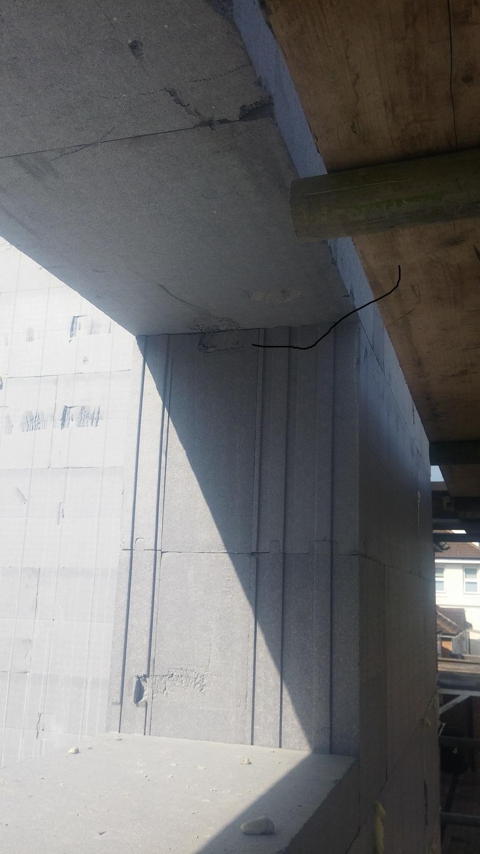

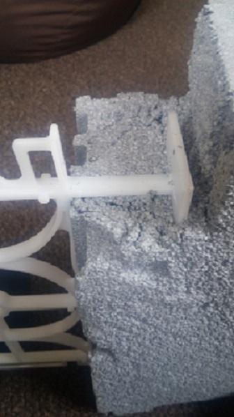

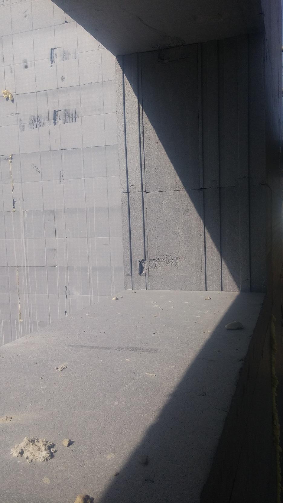

ToughButterCup Posted April 30, 2019 Posted April 30, 2019 On 28/04/2019 at 18:05, Simon R said: We've just finished the ICF work using the JUB block system. [...] Expand I'm nosey. Simon, could you post a picture of a corner and a window head / cill , and a normal run please?

Simon R Posted April 30, 2019 Author Posted April 30, 2019 On 30/04/2019 at 04:57, AnonymousBosch said: could you post a picture of a corner and a window head / cill , Expand A couple of photos added as requested. It's a really clean solution, hopefully won't cause any problems when it comes to putting the windows in.

PeterW Posted April 30, 2019 Posted April 30, 2019 On 30/04/2019 at 16:44, AnonymousBosch said: Erm...... Photos ? Expand In the original post ...
