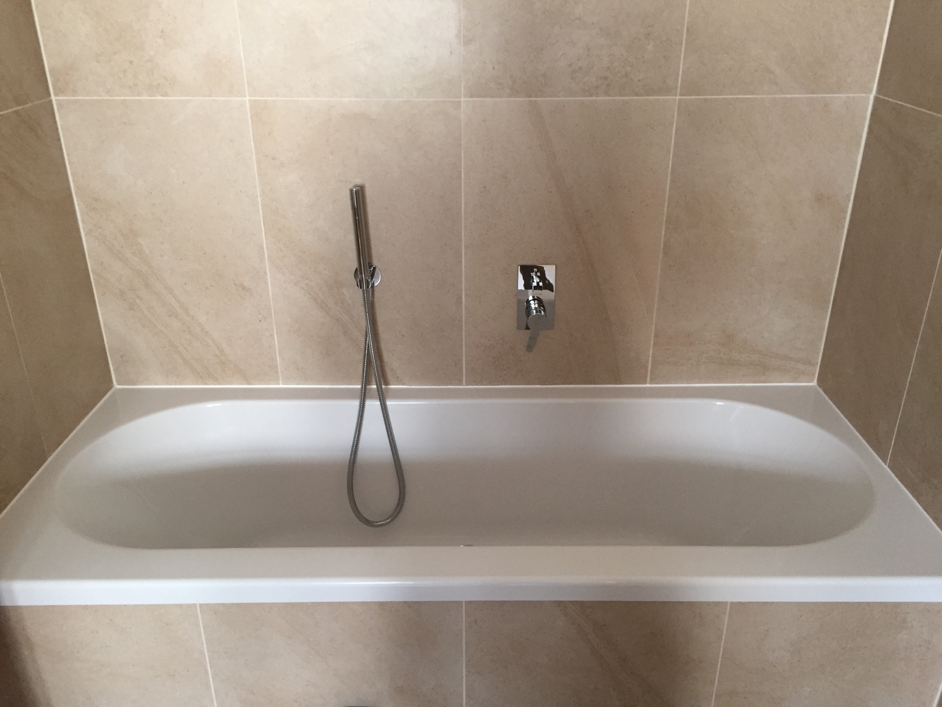

AliG Posted August 31, 2016 Posted August 31, 2016 We have the first system on a bath we just installed. I feel it was much neater as well as cheaper than wall mounted taps so a win win. Unfortunately I am not at home so can't post a picture, but as Barney said there is a separate valve. We mounted it on the wall in the middle of that bath. I used one with a diverter and put a hand held shower on the wall too for hair washing, but that does add to the cost. So something like this on the wall, note this is just the first one that came up in an Ebay search. http://www.ebay.co.uk/itm/New-Square-Tap-Wall-mounted-Shower-and-Bath-Mixer-Faucet-Tap-Control-Valve-/261503697880?hash=item3ce2d5c3d8:g:ICIAAOxyjxlTO94S Ours is more like this with a diverter http://www.ebay.co.uk/itm/Wall-mount-2-Ways-Shower-Faucet-Control-Valve-Single-Handle-With-Diverter-Chrome-/321738874326?hash=item4ae9219dd6:g:Rv4AAOSwv0tVPg30 I think a lot of people on here would warn you against buying cheap plumbing fittings though. You are probably looking at more like £100-150 for a brand name valve or valve plus diverter. Wall mounted taps though can easily stretch to £300-400

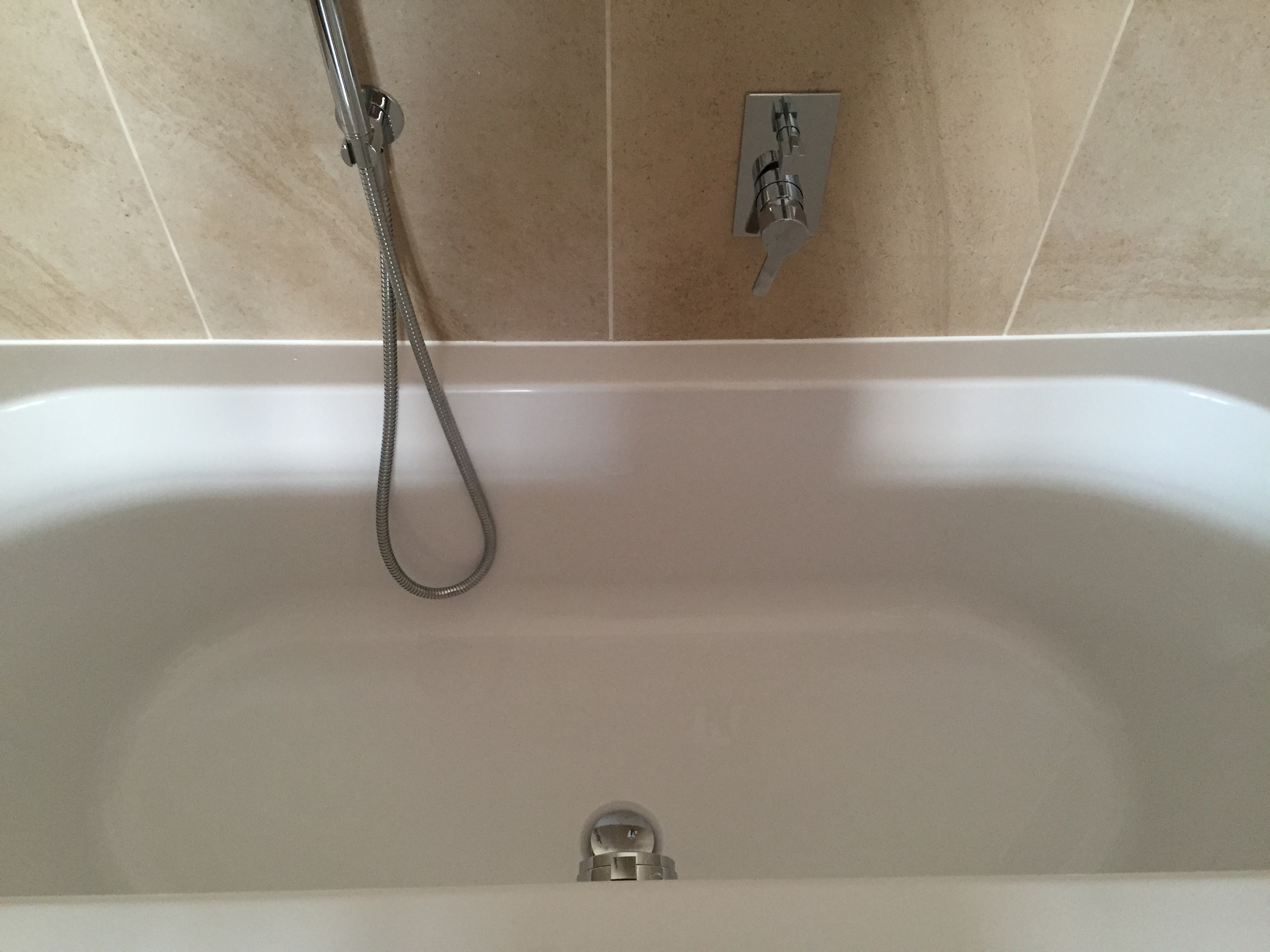

AliG Posted September 24, 2016 Posted September 24, 2016 Finally took a pic of new bath we just put in with overflow filler and wall mounted and help spray plus controls. The stud was right in the centre hence the control and spray are a little further apart than I planned, but I think it is so much neater than what we had before which was a set of the telephone style taps. 1
