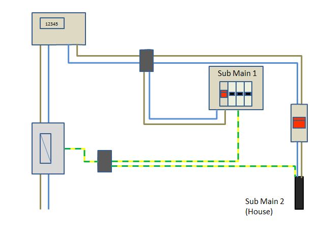

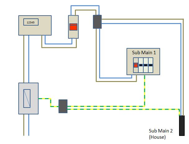

PeterW Posted August 31, 2016 Share Posted August 31, 2016 Just looking at the meter box wiring for WPower and I've got a quick question that I'm prepared to put to the collective experience..! House will be wired with a remote meter box at the boundary, followed by a sub-main providing gate power and lights, and a separate house sub main. Query is - if I put a 100A isolator into the box, which position does it go in..?? I can either put it before the Henley which splits the load into the gate sub-main and the house sub-main, or just on the feed to the house. I guess the safest way is to isolate everything after the meter which means that both boards can be worked on fully isolated, but I've also been told that some companies don't allow this despite being advised that both methods meet 17th Edition. Can one of our resident sparks @Onoff @ProDave make any sense of this...? I want it to be as neat as possible so its laid out prior to install of the meter and there are no issues. 1 Link to comment Share on other sites More sharing options...
ProDave Posted August 31, 2016 Share Posted August 31, 2016 My set up is like your first picture. BUT you don't want just an isolator switch, you want a switch fuse. The reason being is the DNO's regs only alllow "their" fuse to protect up to 3 metres of cable. Your house supply will be a LOT longer than 3 metres so it needs it's own fuse. I fitted an 80A fuse into mine in the hope that will blow before their 100A fuse in the event of a fault. Some DNO's (e.g. SSE) fit meters with an inbuilt isolator switch so isolating to work on the consumer unit is not a problem. Link to comment Share on other sites More sharing options...

PeterW Posted August 31, 2016 Author Share Posted August 31, 2016 (edited) Lots to consider ..!! Sparky is suggesting that we use 16mm 2 core SWA with a 10mm Earth in the same duct - does that sound right ..?? Will terminate the SWA at the back of the board as it runs on the outside of the wall and run the two cores to the switch. Edited September 1, 2016 by PeterW Cable Sizes corrected... Link to comment Share on other sites More sharing options...
