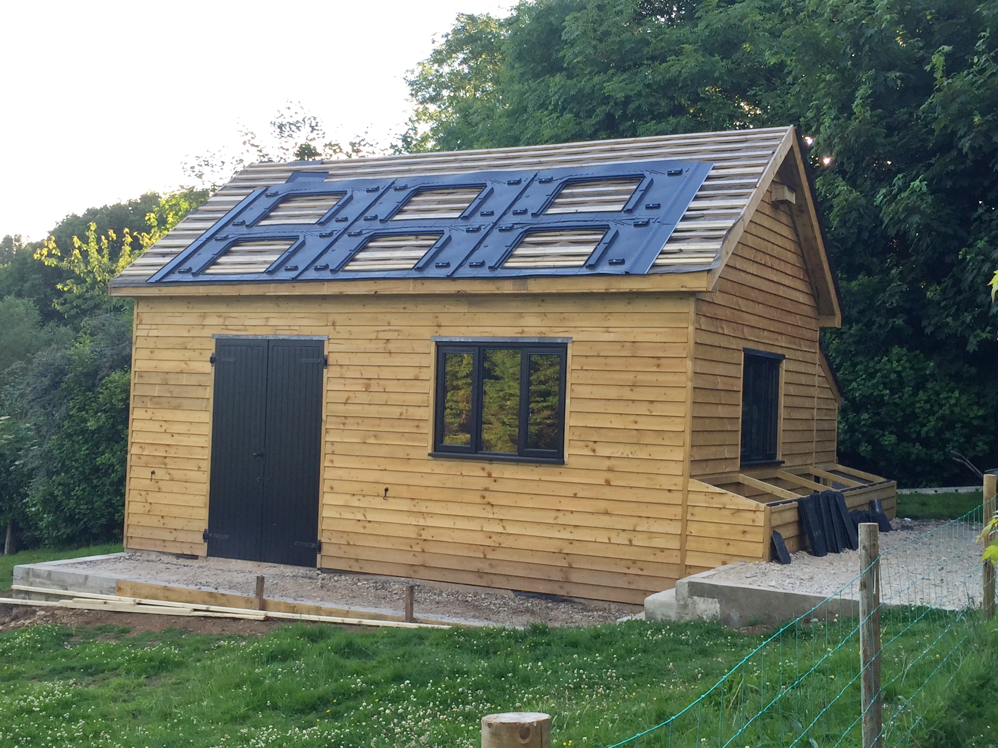

Barney12 Posted July 5, 2016 Author Posted July 5, 2016 Quick update: The doors are painted and on. The GSE roof trays started tonight. 1
Nickfromwales Posted July 5, 2016 Posted July 5, 2016 Those trays are a wonderfully simple and practical solution. Looking damn good so far

Barney12 Posted July 5, 2016 Author Posted July 5, 2016 28 minutes ago, Nickfromwales said: Those trays are a wonderfully simple and practical solution. Looking damn good so far They are indeed. We battened and screwed down those trays in a matter of a couple of hours and had never done them before. The flashing is very similar to the slate flashing kits you get with a Velux.
Barney12 Posted July 5, 2016 Author Posted July 5, 2016 28 minutes ago, Onoff said: Cheap enough too: http://www.windandsun.co.uk/products/PV-Mounting-Structures/GSE-Integration-Roof-Integrated#.V3wYTNIrJdg We got them down to a little under £19 each. All the flashing trays, clips etc do add up though.
Jeremy Harris Posted July 6, 2016 Posted July 6, 2016 When I compared the cost, because people were bleating on about in-roof being so much more expensive than on roof, I concluded that the complete GSE frame, fixings and flashing kit was just about exactly the same price as an on-roof frame kit, but that the in-roof system saved the cost of slates/tiles underneath and so was actually cheaper. Given that an in-roof system is a lot quicker and easier to fit than an on-roof system (no need to get inside the roof to secure through bolts etc) then PV installers should really be offering them at lower prices than they do.

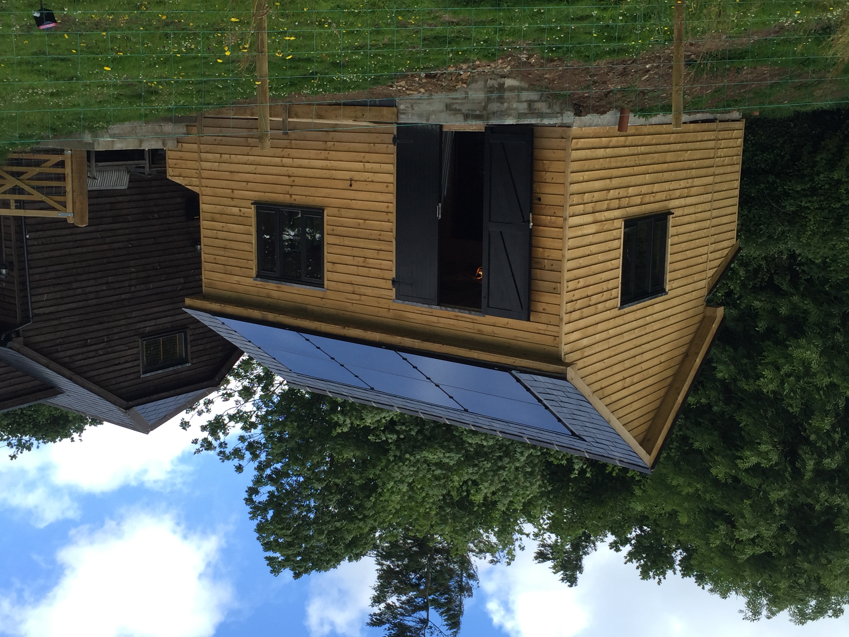

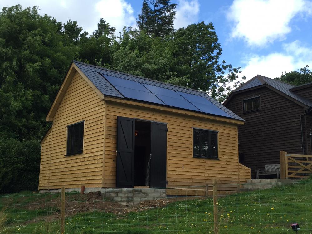

Barney12 Posted July 10, 2016 Author Posted July 10, 2016 So more progress this weekend. PV panels are all ready to be wired up by the sparky on Thur. Slates all finished. Anyone thinking of using the GSE panels and all black PV's should definitely do it. They look so smart. They're also incredibly simple to install. Still numerous jobs to do inside and out but on we go 2
Onoff Posted July 10, 2016 Posted July 10, 2016 The word "shed" doesn't really do it justice does it? 2

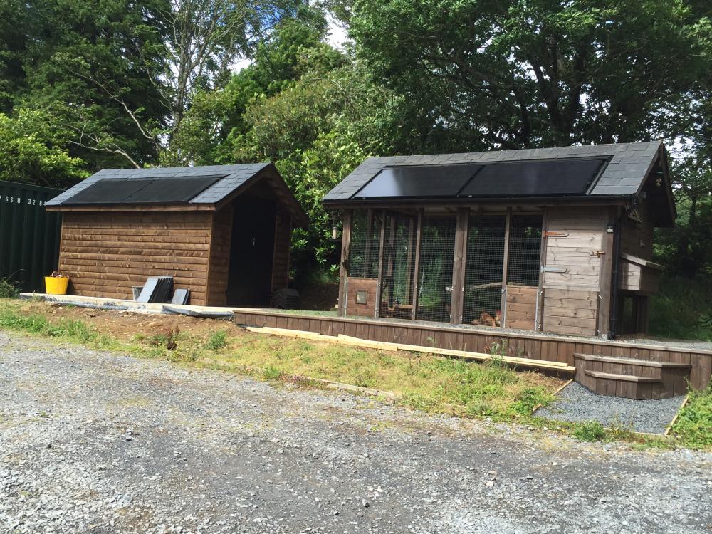

Barney12 Posted July 10, 2016 Author Posted July 10, 2016 Yes, I think I did post it on eBuild. It's currently looking a bit tatty and is in desperate need of a coat of stain and the weeds have taken over! We now also have a "recycling store" (aka shed!) next to it. Both have been fitted with 500w solar arrays now. You can just see the other "shed" in this picture which is our shipping container!

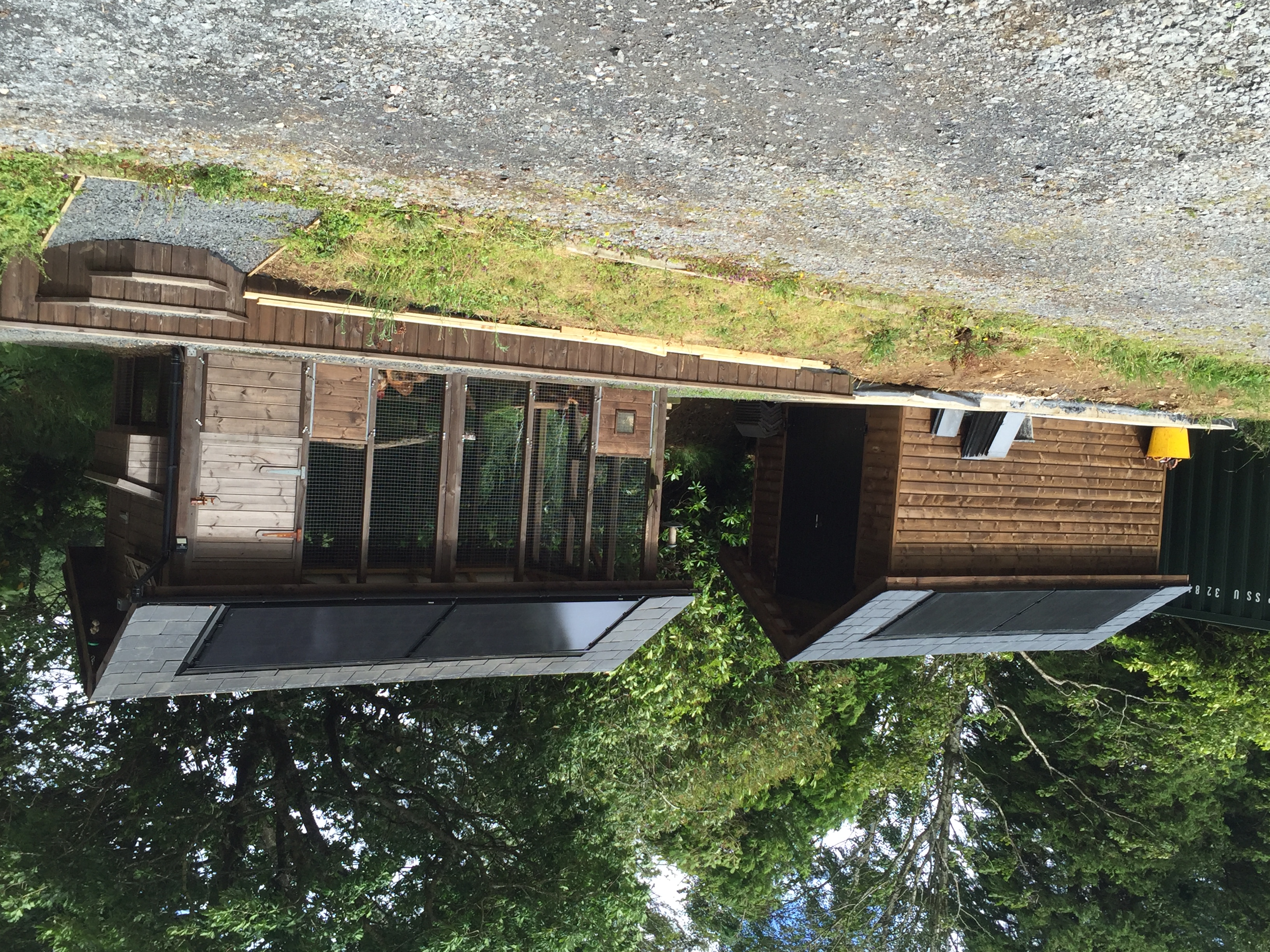

Barney12 Posted July 11, 2016 Author Posted July 11, 2016 9 hours ago, Ferdinand said: What is the solar setup? Are these really battery hens? They are just two small solar arrays connected to the main house circuit. Those roofs face South so it seemed a no brainier to do it. And yes they are indeed battery hens Well actually ex-battery hens (now called colony hens as more than one is kept in each cage to get round the rules) as my wife re-homes chickens from the Hen Welfare Trust 1
Onoff Posted July 11, 2016 Posted July 11, 2016 (edited) 11 hours ago, Barney12 said: Oh and we are currently having "shed wars". SWMBO has decided that the shed next to the chickens is "her" shed. A shed for a woman, have you ever heard anything so daft You sound "hen"pecked..... So you've trenched (& ducted?) your PV cables from the sheds to the house? Edited July 11, 2016 by Onoff
Barney12 Posted July 11, 2016 Author Posted July 11, 2016 2 hours ago, Onoff said: So you've trenched (& ducted?) your PV cables from the sheds to the house? Sort of! Its like this........... We have one domestic supply (albeit carried on a 3 phase cable due to the distance from the nearest supply point). From there we have three SP&N switches to consumer units: No.1. House CU (although currently a site supply) No.2. Bat Roost / Workshop CU No.3. Garage/Flat/Coach House CU (which also has a sub-feed to an outside consumer unit by the chicken house) So the solar is (or will be from Thursday!) connected as follows: 6 panel array on bat roost is connected to a single inverter into the Bat Roost / Workshop CU. The shed and chicken house arrays are on micro inverters with a 240v SWA between the two sheds. Then connected to the outside CU. I've lost count of the meters of trench and SWA we've run so far. My most recent effort was running a 4mm cable from the outside consumer unit up to the electric gate control panel at the end of our drive. Close to 80m of trench dug by hand and re-filled by hand. I REALLY need to buy a digger. Now I bet you wish you hadn't asked BTW. Huge plug to this and the past forum. I worked all this out from various previous posts and help from the collective here! I knew nothing about Solar before that. This place is just great!!
