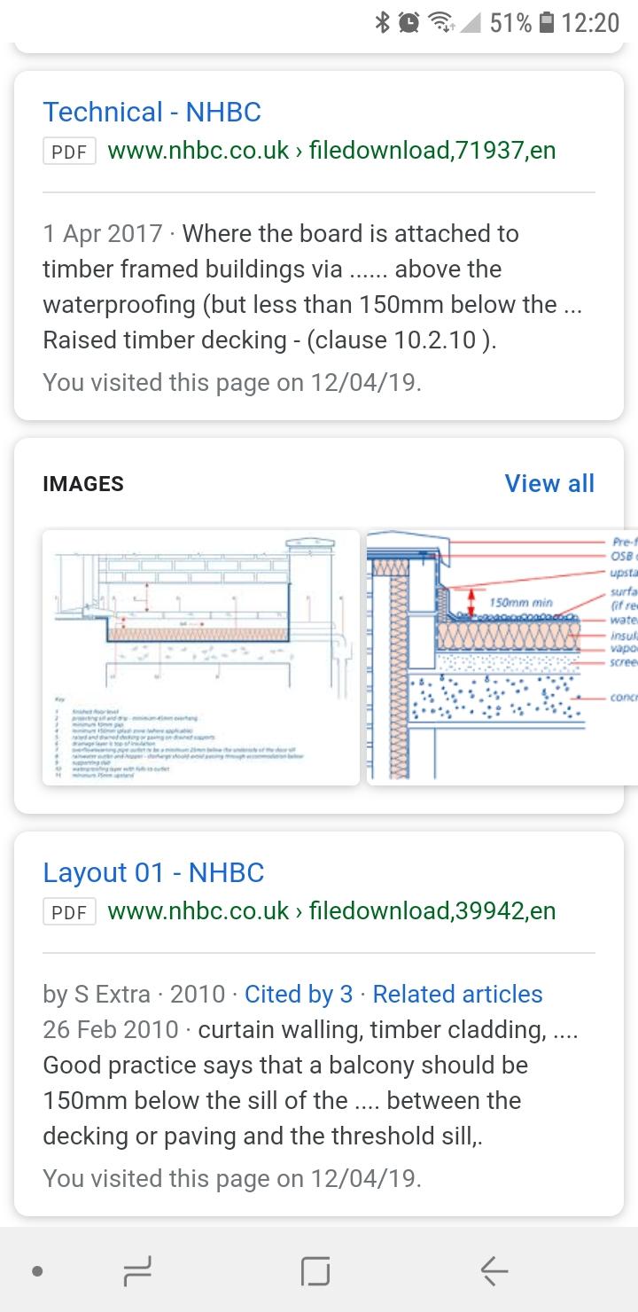

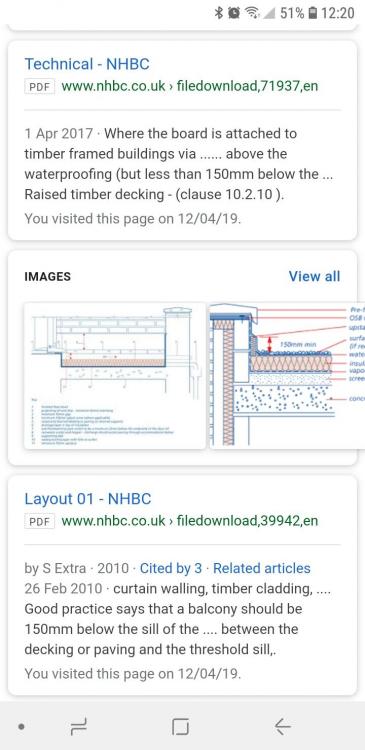

Onoff Posted April 13, 2019 Share Posted April 13, 2019 I've been searching the term "NHBC timber decking 150mm" hoping to find specifics regarding decking installation. Thinking if the builder is promoting their adherence to NHBC guidelines and they're clearly not, you might have more recourse in getting it sorted: Seems mainly to relate to balconies so far. Been finding NHBC technical documents that point to the Timber Decking & Cladding Association, like this: TDCA_Builders_Guide.pdf I wonder if the Code of Practice 0801: Raised Timber Decks to meet NHBC standards if you can lay your hands on it might help prove what a crap install you have. Link to comment Share on other sites More sharing options...

Bri44 Posted April 13, 2019 Author Share Posted April 13, 2019 1 hour ago, Onoff said: I've been searching the term "NHBC timber decking 150mm" hoping to find specifics regarding decking installation. Thinking if the builder is promoting their adherence to NHBC guidelines and they're clearly not, you might have more recourse in getting it sorted: Seems mainly to relate to balconies so far. Been finding NHBC technical documents that point to the Timber Decking & Cladding Association, like this: TDCA_Builders_Guide.pdf I wonder if the Code of Practice 0801: Raised Timber Decks to meet NHBC standards if you can lay your hands on it might help prove what a crap install you have. Thanks Omar, I will try but I'm with LABC Link to comment Share on other sites More sharing options...

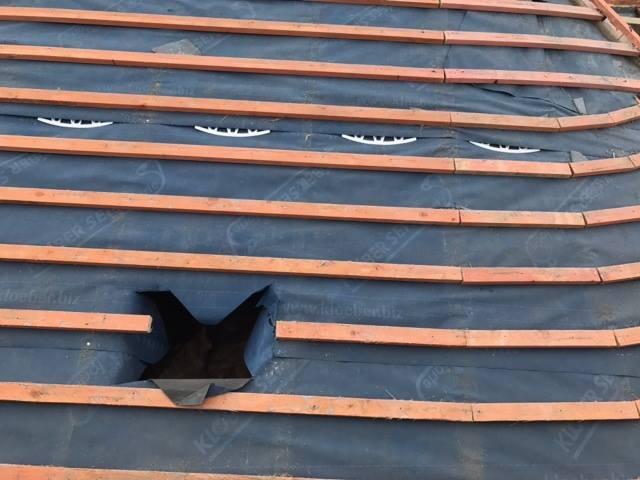

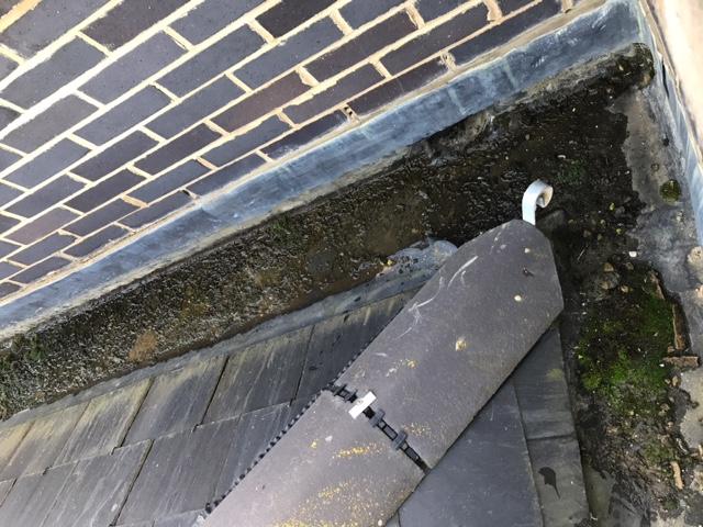

Bri44 Posted April 13, 2019 Author Share Posted April 13, 2019 (edited) I totally agree with you. They are forcing me to resort to having my own surveys etc which will all cost me quite a bit, and then they will still deny liability. It is their customer services who will deny everything, then their management backs them up. Some of the rubbish they spew at me in emails is laughable. My roof leaked the first day I moved in, site manager said it was because the lead was being replaced which was a lie. It then leaked in three places which made them investigate and fix. I climbed up the scaffold and took pictures after the fix, water pooling on the roof still, tiles sticking out and rattling in the wind. The developer saying it's fine even though they never inspected the work, then I got LABC involved who said water pooling is a fault. Next roofer said the first one did a bad job and it all needs ripped off and done correctly. If I had not climbed up, took pictures and videos, I`d be none the wiser until it leaked again. This is the hole in the roof that was simply tiled over when I bought the house. This is after first rookers removed tiles. This what the roof looked like before the first repair. This is the water pooling up after the first repair, the roof was lower than the exit point by an inch and a half for the drainpipes so the water had nowhere to go and they said it`s not a fault. Edited April 13, 2019 by Bri44 Link to comment Share on other sites More sharing options...

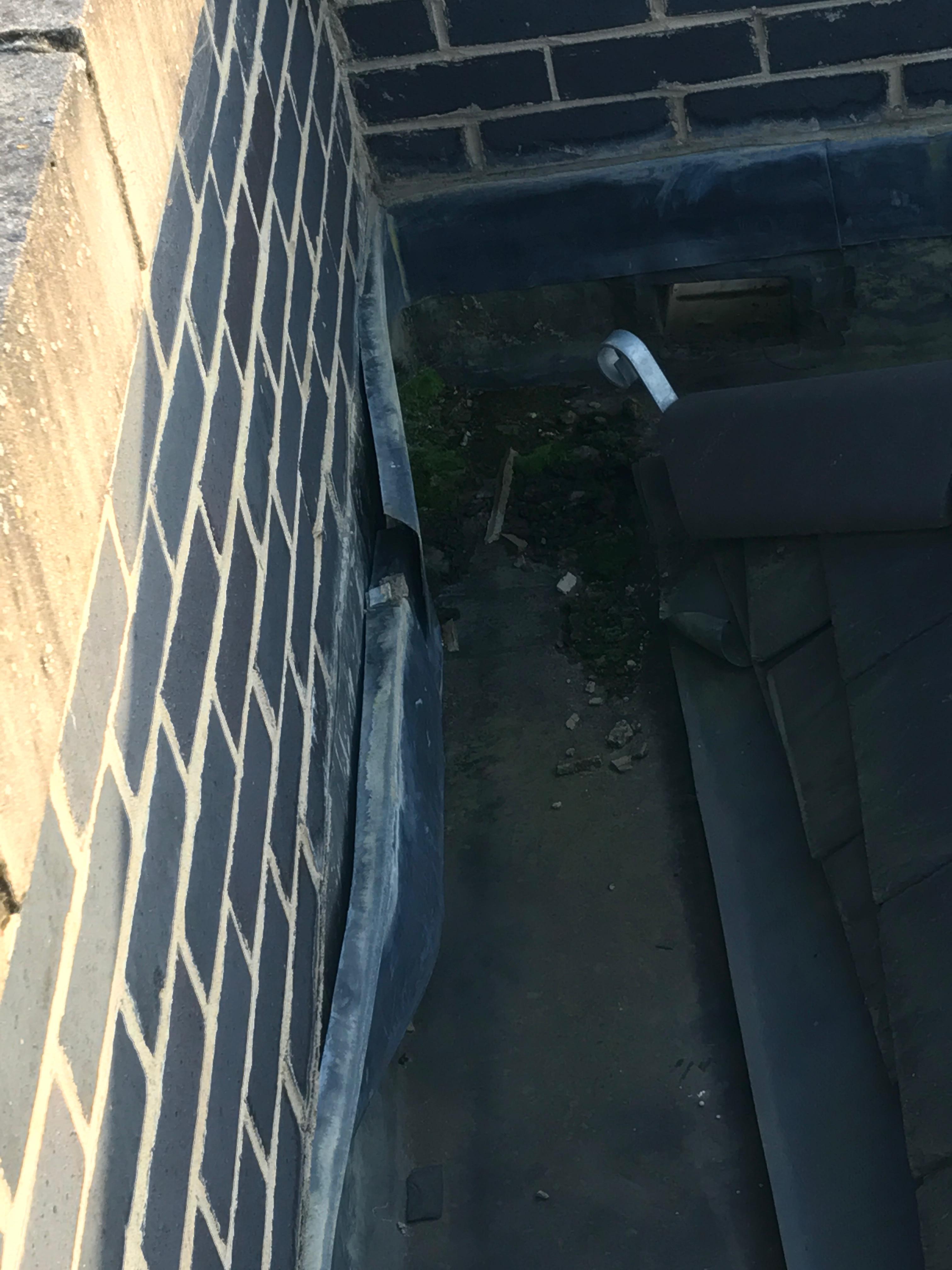

Bri44 Posted April 13, 2019 Author Share Posted April 13, 2019 Lead before the first repair, this was not long after site manager had said they replaced the lead. I`ve had a nightmare with this company and it is ongoing. Link to comment Share on other sites More sharing options...
