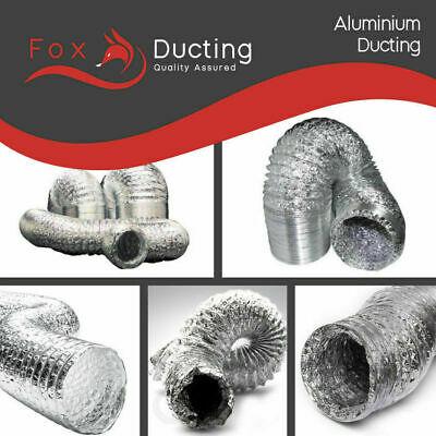

Onoff Posted December 11, 2019 Author Posted December 11, 2019 If I were to run this stuff (is this convoluted aluminium duct?), through a good length of soil pipe could that act as the basis of a DIY heat exchanger? Thinking because of the undulations it would retain heat (to exchange) better than a straight through, smooth sided metal tube. Thanks
Ed Davies Posted December 11, 2019 Posted December 11, 2019 To get appreciable heat exchange you need a lot of area. Some arithmetic is called for. Here's some I did earlier: https://edavies.me.uk/2014/03/mhrv-area/ which might give you an idea.
