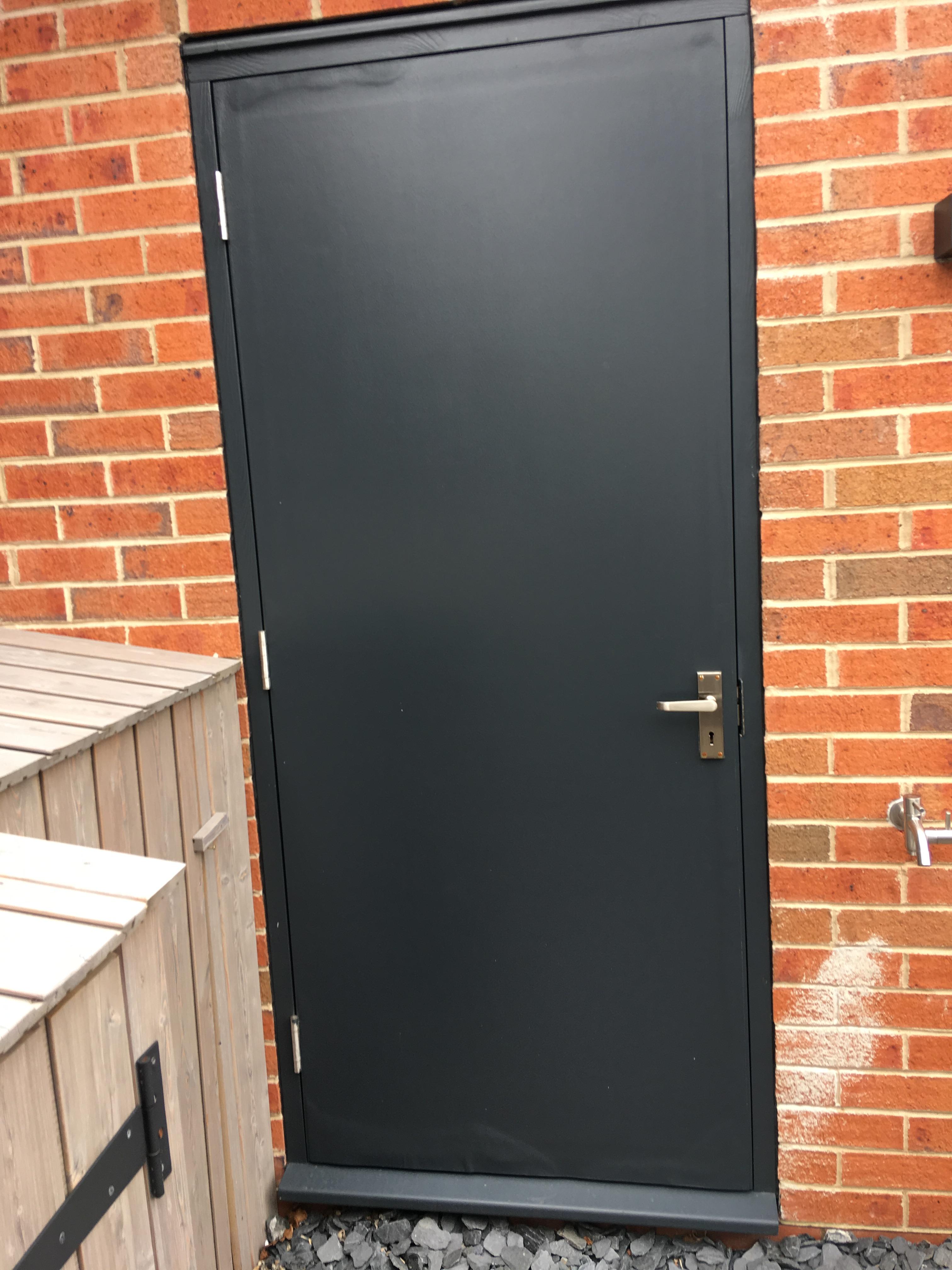

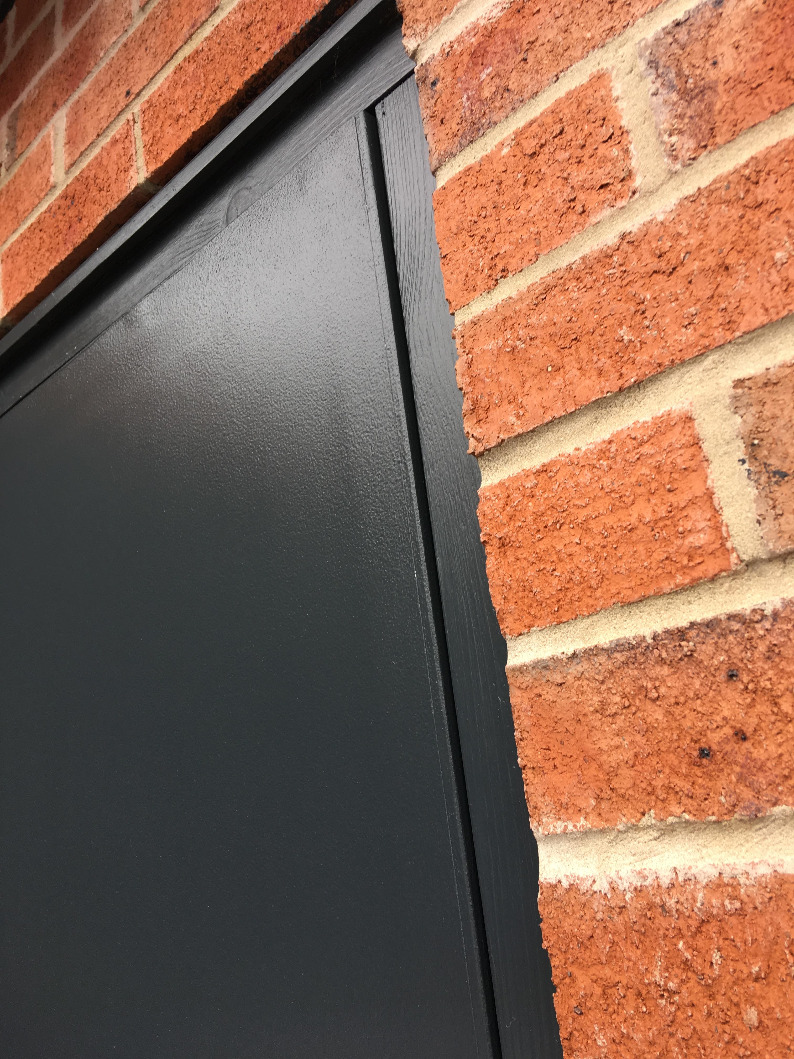

We have a side door into the garage.  It has a timber door on it, door only went on last autumn was brand new and was painted here on site. I’m not clear exactly what the door is made from.

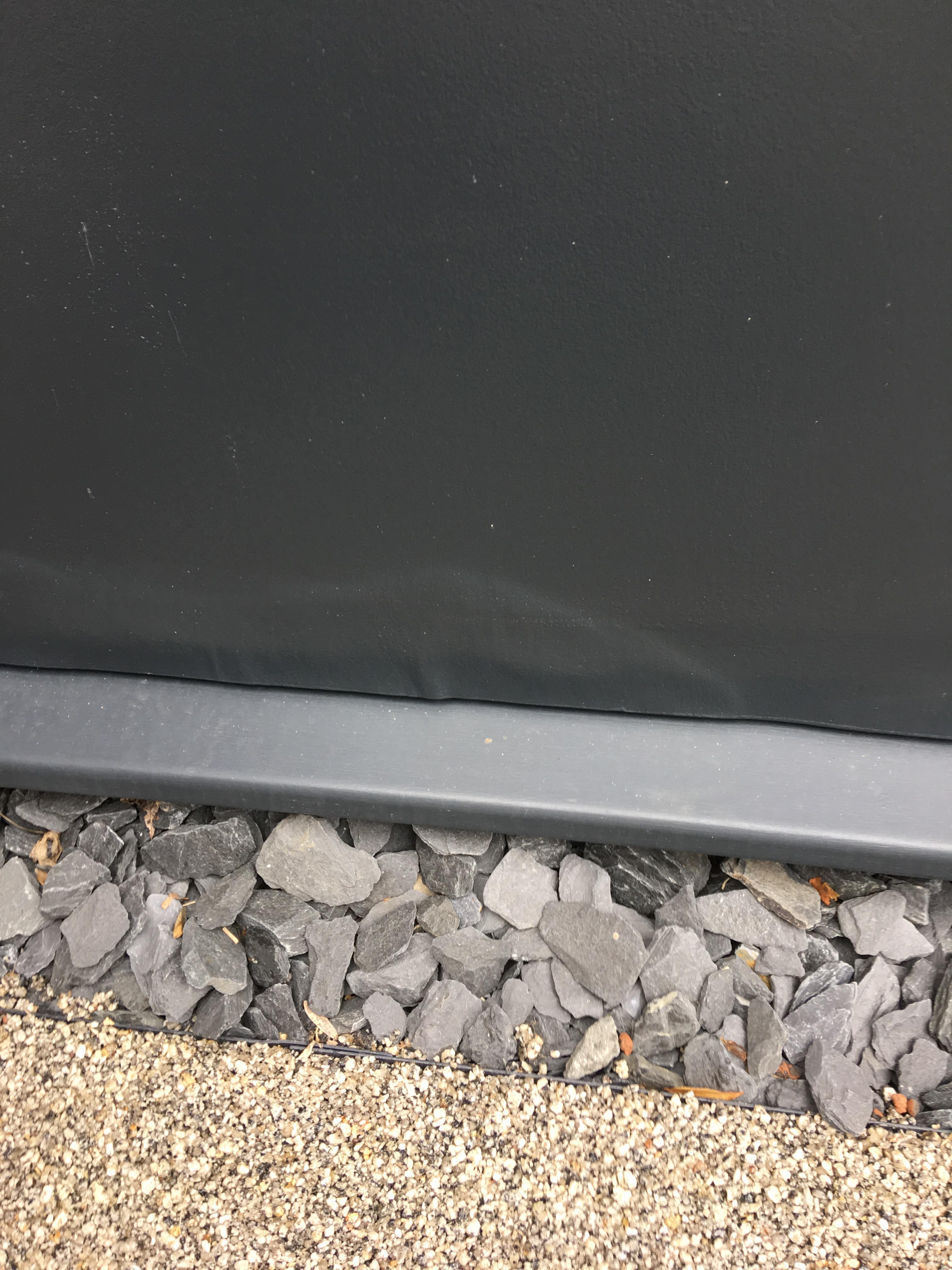

Over the winter the door appears to have warped and looks like some sort of delamination going on at the bottom. I have not dared to try opening it as I doubt I would get it closed again.
Less than 6 months seems a remarkably short life span for a door.
Think I need a new door.  Any suggestions.....I dont want this happening again in a few months.  Will need to find a local company to do it.
Who fitted it?
I strongly suspect looking at the state of it, that it was an internal door.  We have a timber external door on the garage of our old house that has been there since 2004 and is still in good condition with no warping or no de lamination.
Our new house has a second hand SwedeDoor front door that our neighbour removed, Again about 15 years old and still in good condition.

it was my carpenter.... he got it and fitted it.  He got it and I reimbursed but cant find invoice to see what sort of door (and so work out if is faulty) Given the state of it my first thought was an internal door......it is quite exposed too.... He was so good with everything else hard to think he would have fitted the wrong type of door its just as much work to fit the right one.
Does anyone know if I go for one of the steel ones above (thank you @Ferdinand) do I need the surrounding frame and thresholds too. Its fixed onto an uninsulated cavity brick wall. Currently it is a timber surround and threshold I dont want new door and then get problems later with frame etc

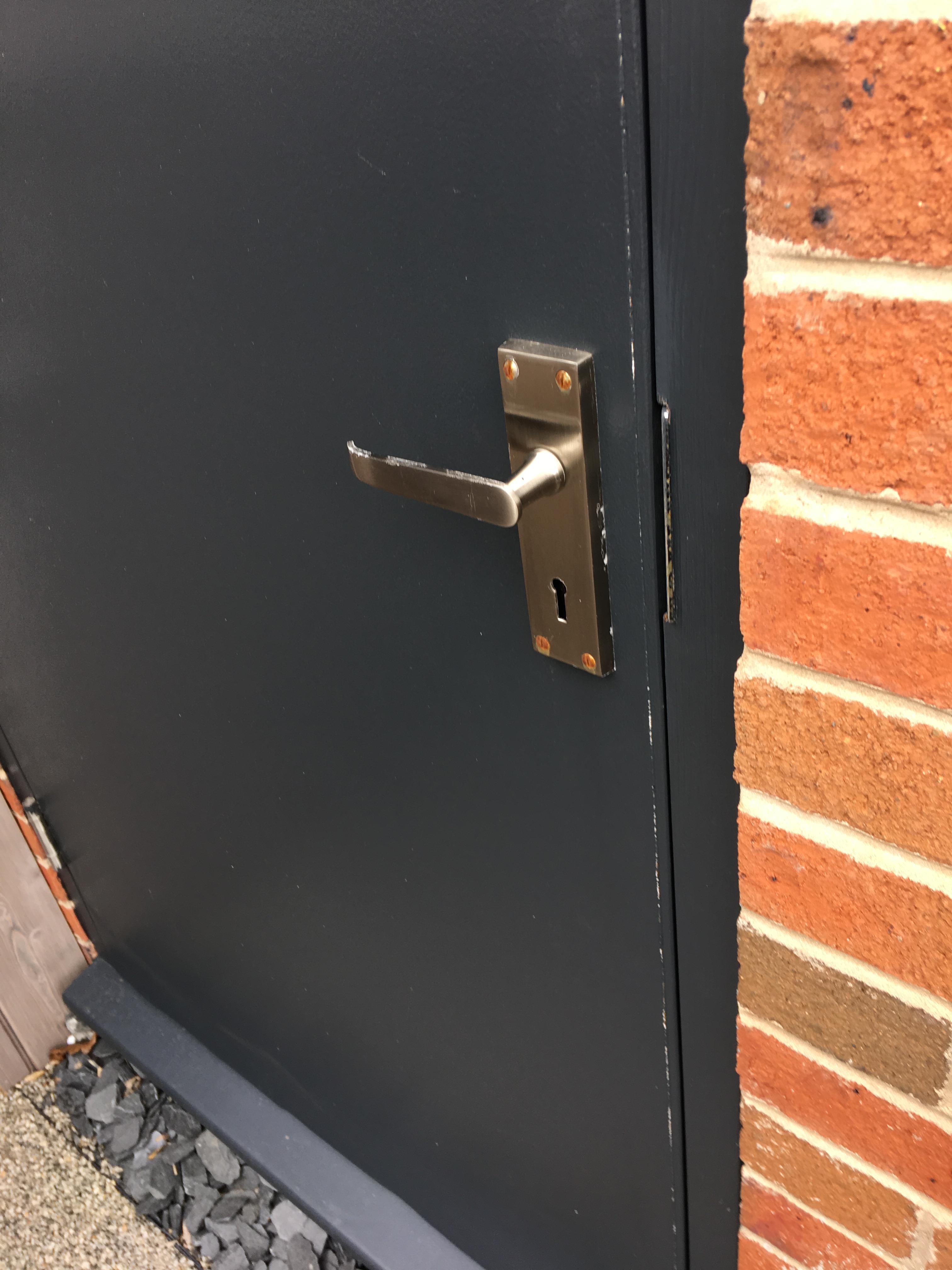

Definitely looks like an internal door, and internal door furniture too, judging by the corrosion on the screws holding the handle on.

Yep the fittings are corroding...whole thing is very unsightly. Wil have a look at door/window companies too thank you.

whole opening is roughly 2060 high x 925 wide. then there is a threshold and habing just tried to measure that (about 60mm) it seems to be sitting in thin air I can get my hand underneath and put my fingers into the cavity.... is it supposed to be open underneath like that?
